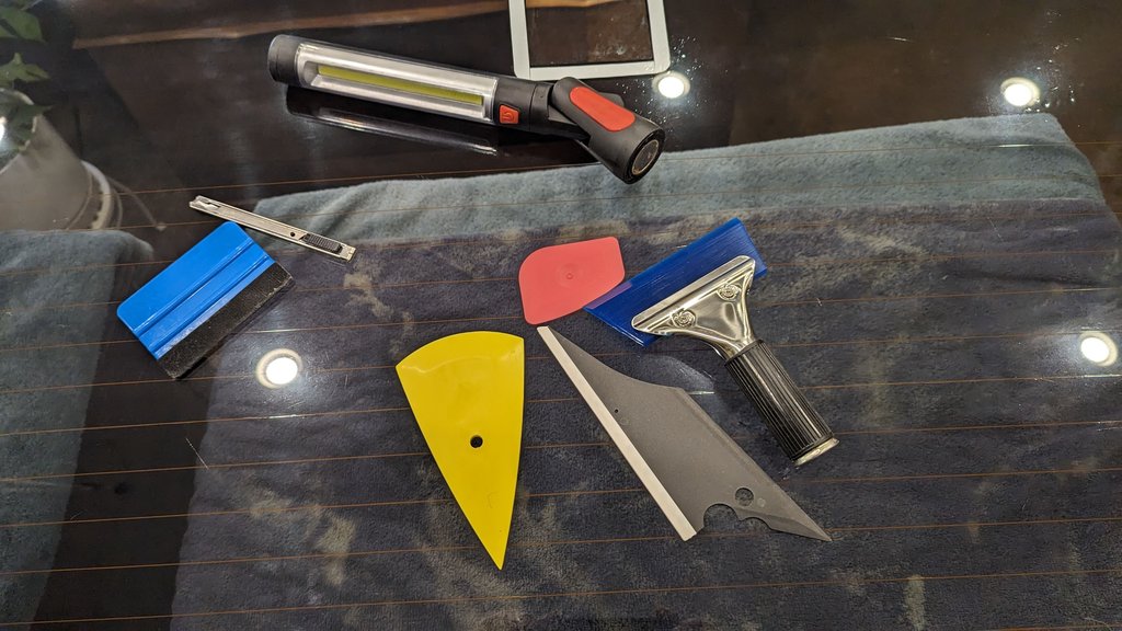

However, the part that ended up being the most difficult (for me) was tinting the da*m window. I went to YouTube University and ordered genuine film from a supplier on eBay. I bought the window tinter's starter kit from Amazon. I already had a heat gun. I thought I'd give it a shot. I mean, how hard could it be.

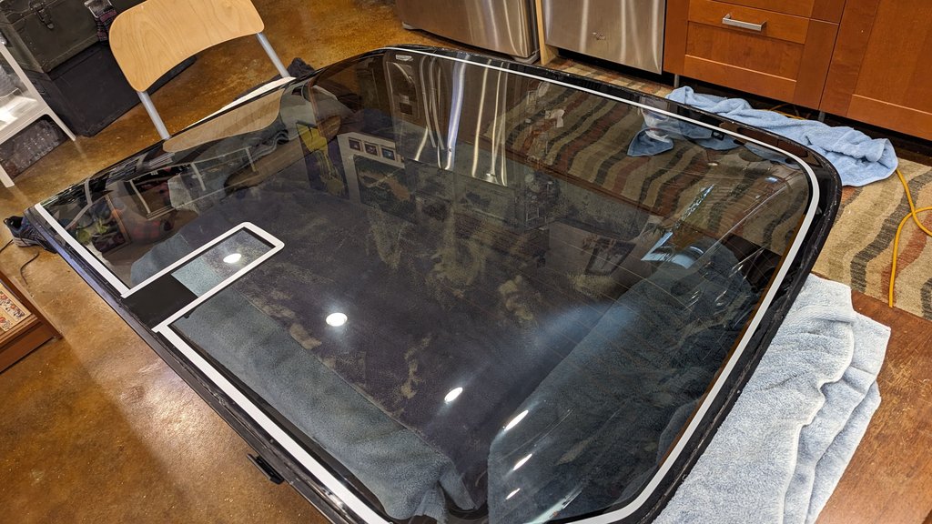

I tried to do 2x 20" sections of film, hiding the split along one of the middle defrost lines. I got the top section shrunk without too much problem. But I just couldn't get the bottom section shrunk. I resorted to 3x sections. The 20" top section, and 2x smaller sections to cover the bottom.

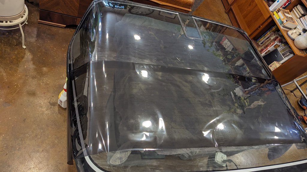

Top section of tint already shrunk. Seam with next section will be at the 7th defrost line from the top, iirc. The white border you see is narrow vinyl electrical tape to serve as a high-contrast aide when trimming the film to the desired final size.

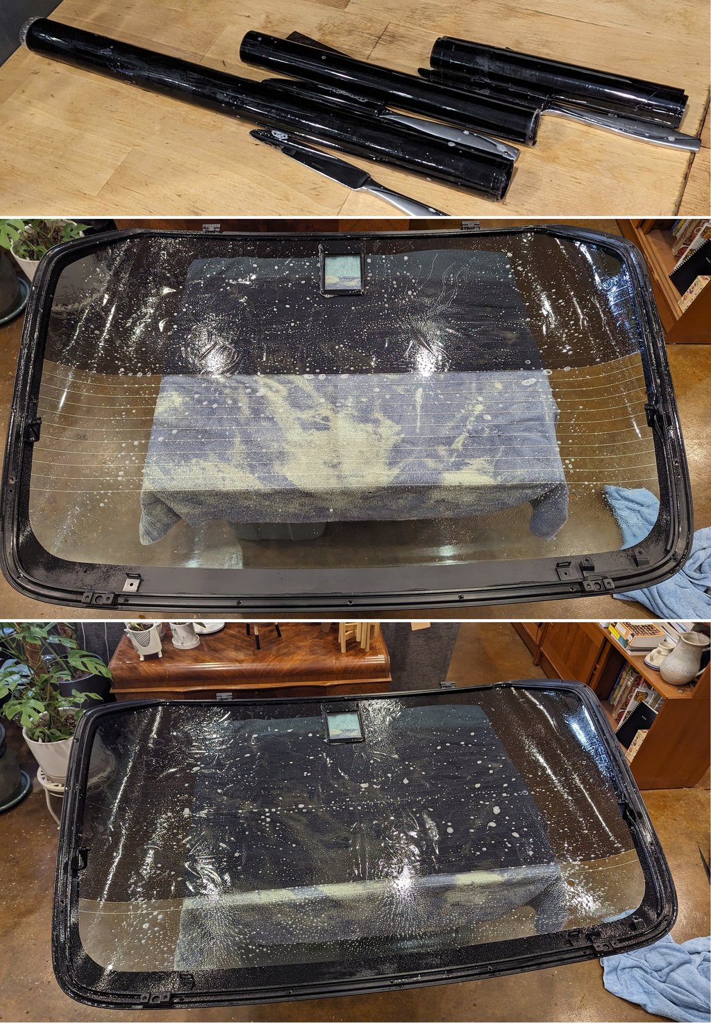

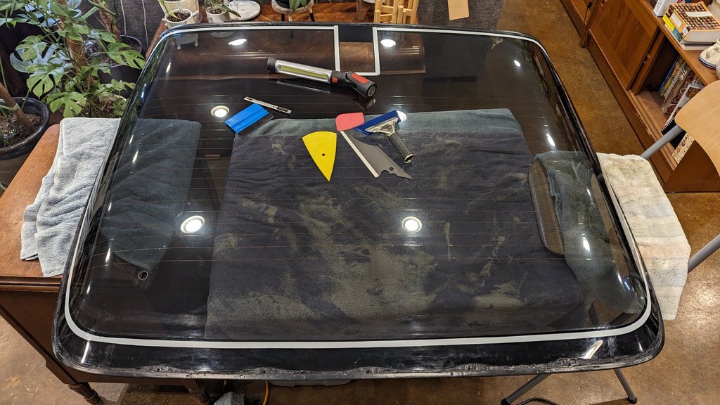

Working on middle section of tint film. Seam with final section will be at 2nd defrost line from the bottom.
Working on bottom section of tint film.

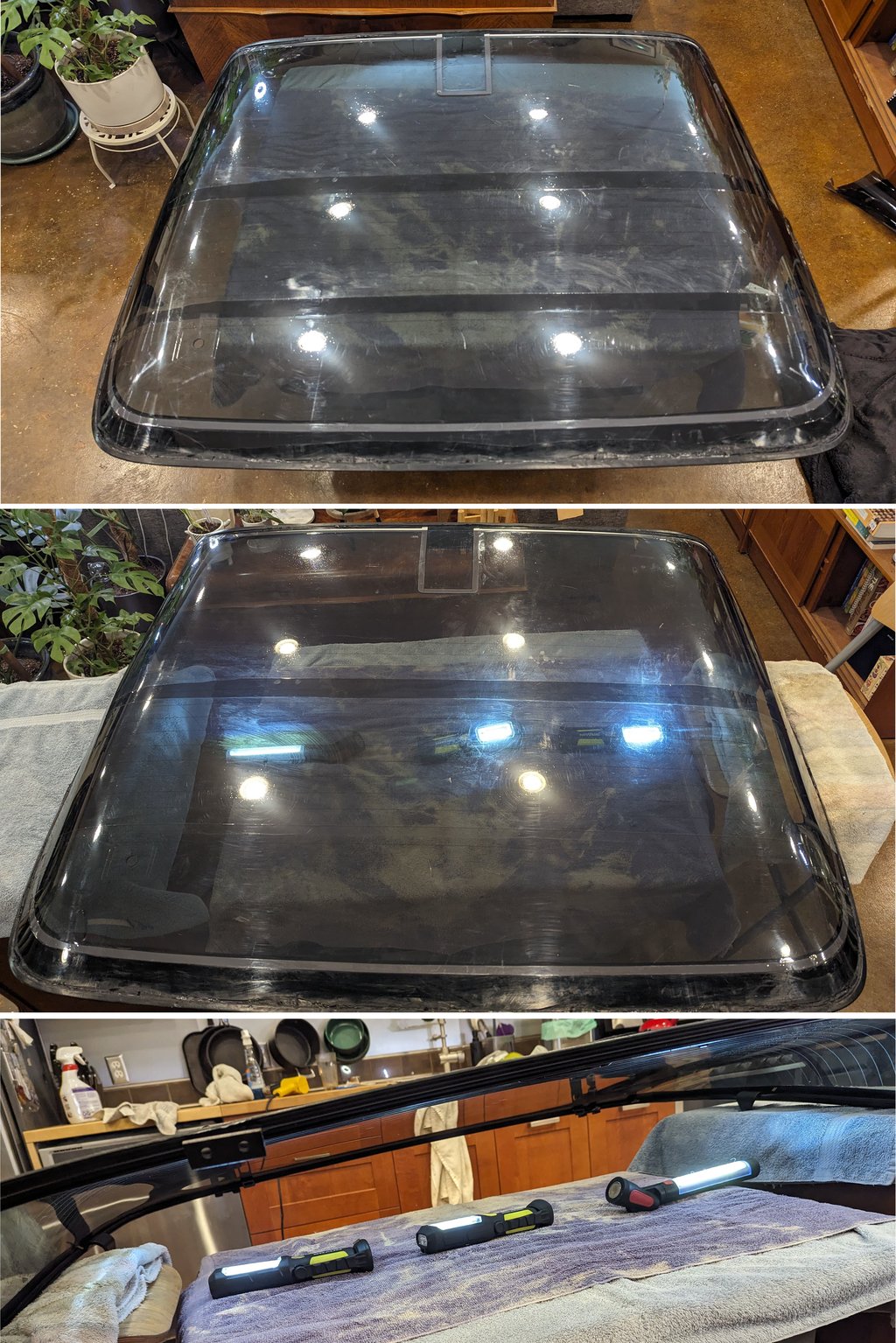

Tint sections all shrunk. Dark bands are where they are currently overlapping and need to be trimmed with a sharp razor tool along a defrost line. I elevated the glass and put a number of flat flashlights under it to help visualize the defrost line.

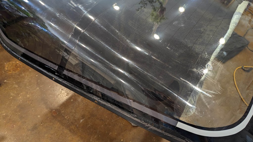

Overlapping sections trimmed.

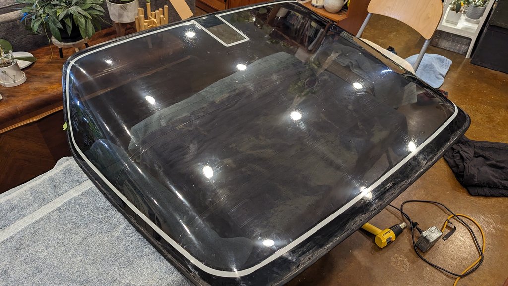

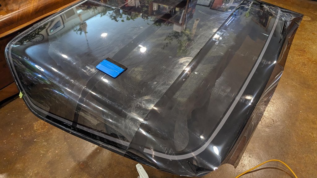

Sections of tint "reverse rolled" (with protective clear film still attached), then installed on the inside of the glass.

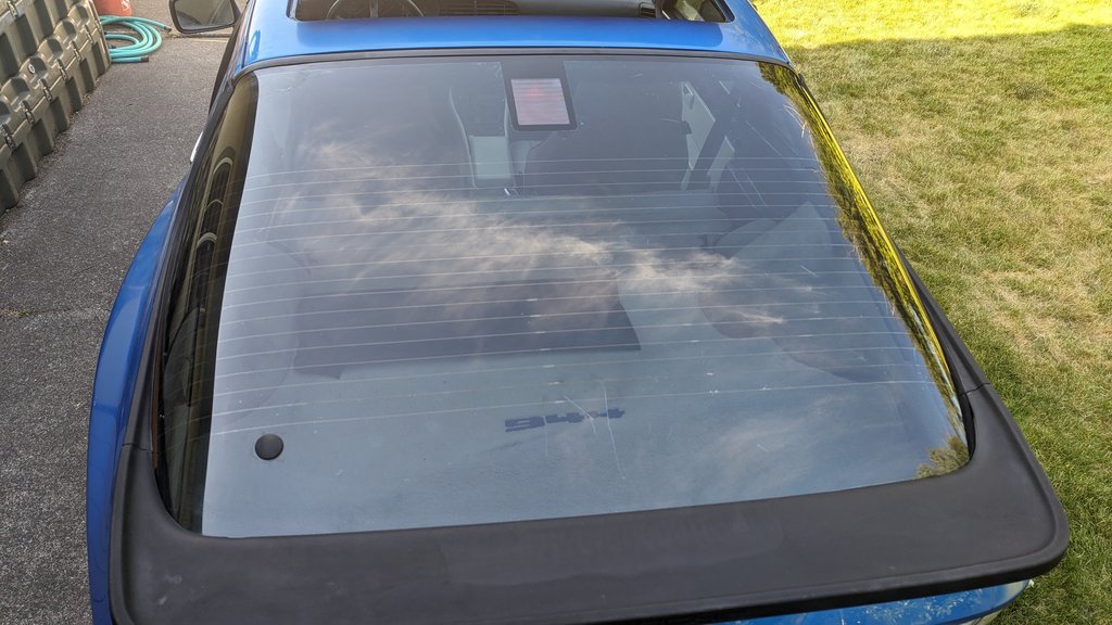

Tint installed!
Done!

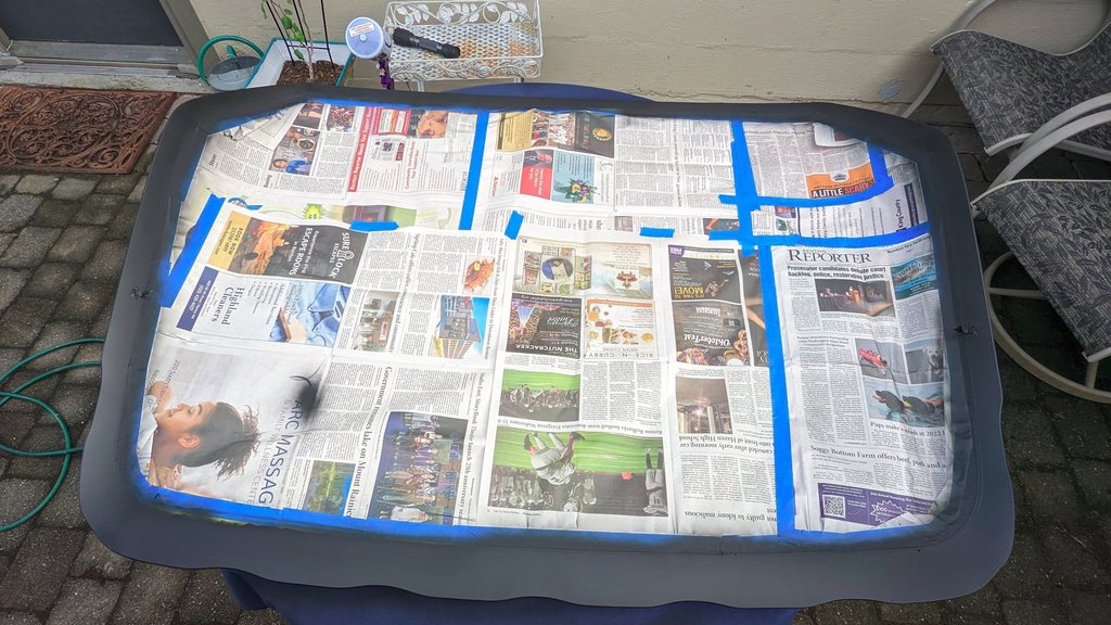

In a nut shell, after removing the glass from the frame and painstakingly cleaning the old adhesive, I wire brushed, acid etched, primed and painted the frame. Nothing special for paint. Rust-Oleum Satin Black Enamel over Rust-Oleum self-etching primer.
I also removed *all* the old black "fritting" from the glass (I think that's what it's called). Much scraped off with fingernail pressure. The rest required a dull razor blade.
I masked the glass and applied completely new fritting using 3M #08682 primer with my Harbor Freight HVLP, thinned 2:1 with acetone. Many light coats on the glass and on the frame where it interfaces with the glass.

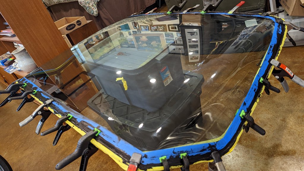

I used 3M #08609 "Window Weld" as the adhesive and every freakin' spring clamp I could find or borrow. Probably should have used even more.
Then I left it alone. For at least a week.
Then I removed the spring clamps and the masking tape that prevented the urethane from getting absolutely everywhere. Probably should have used even more masking tape, too.
