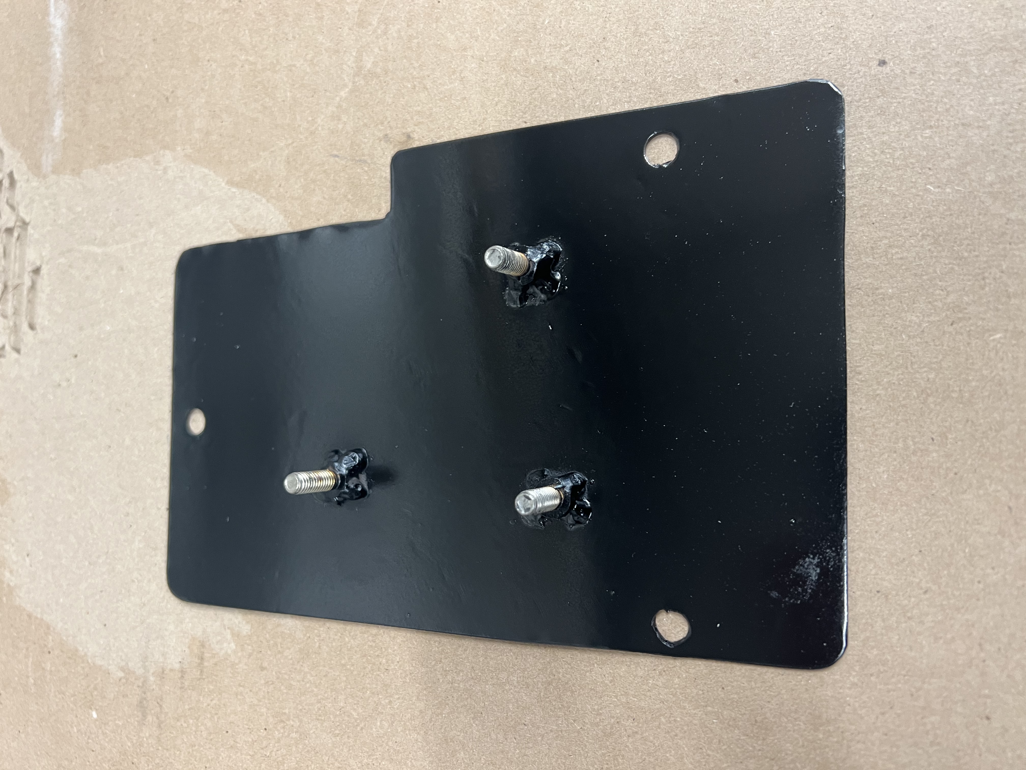

Can you figure out what this is???
Posts: 9090
Been thanked: 4078 times
I think we need a hint :)
chris white
Posts: 434
Been thanked: 175 times
it supports the most important new and improved go fast part. cant go fast without it!

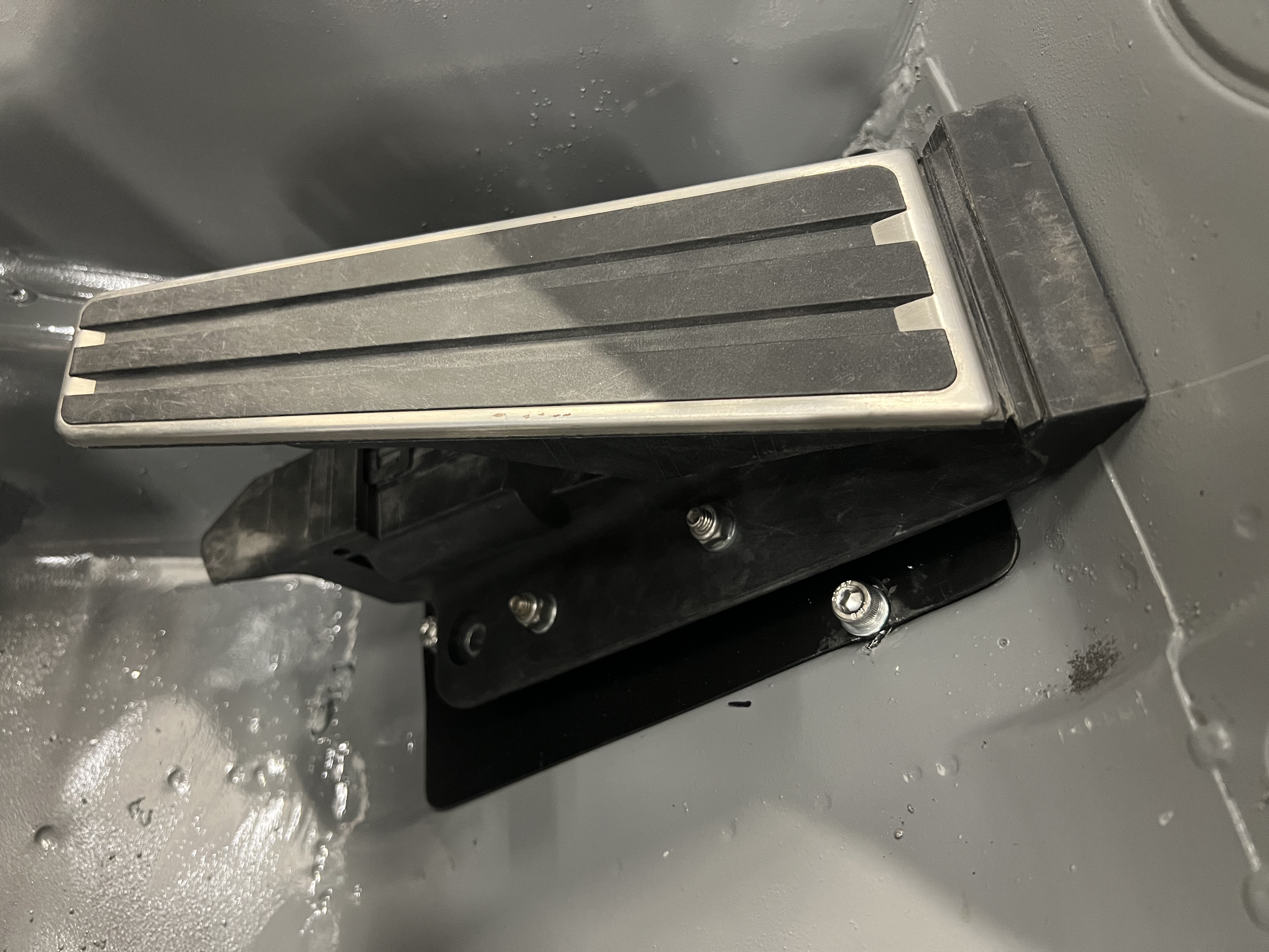

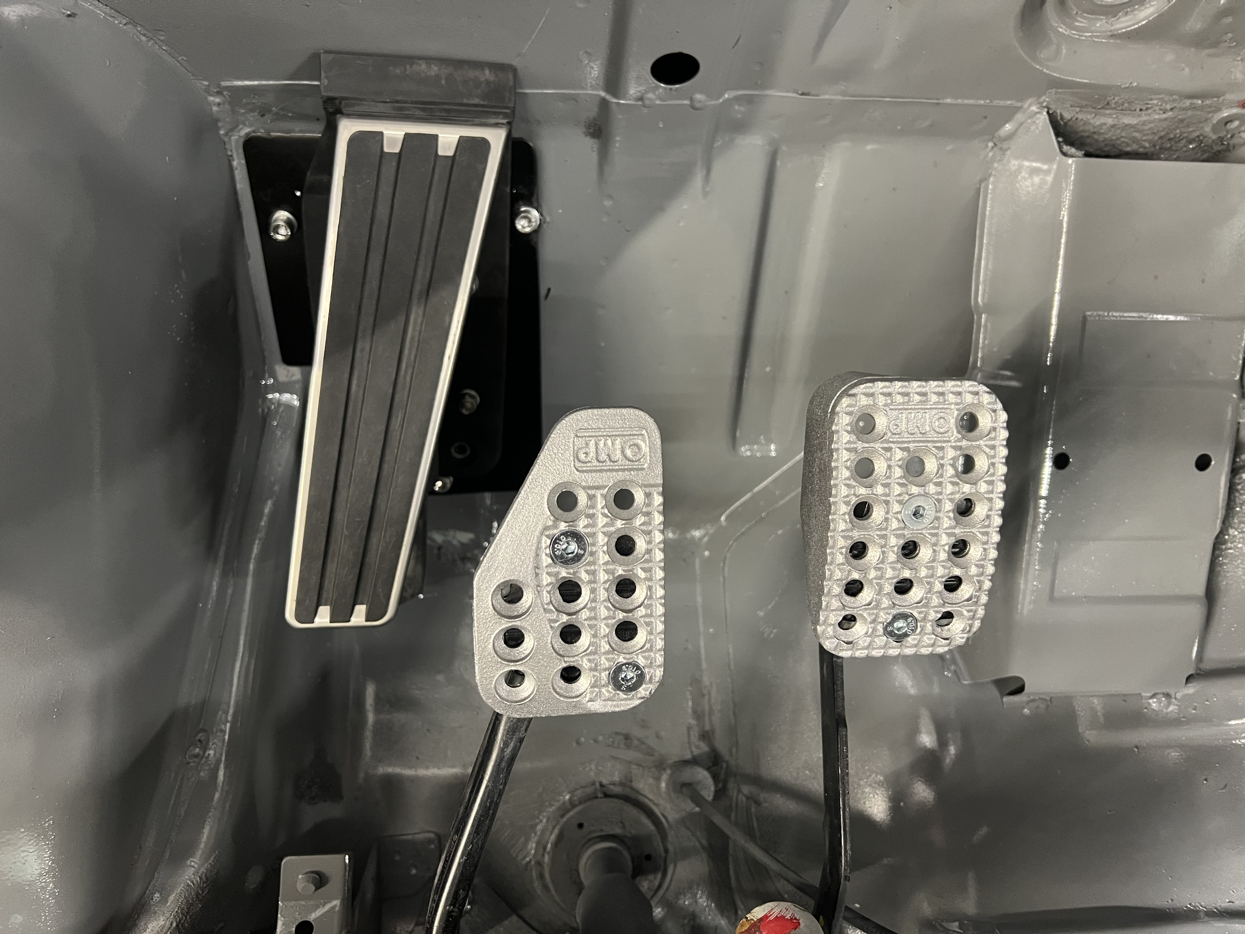

Ok, it’s an adapter plate to mount an e throttle pedal, going to e throttle on the track car.

Interesting. Quicker response and definitely more precise I would think. Similar to what is in cars now? (Dumb questions Chris, but if I don't ask I'll not know for sure!)

944s have old school cable throttle linkage. This is for a track car with full standalone ecu so I can add a bunch of stuff like auto blip down shifts, traction control and even no lift shifts ( good for turbos)
