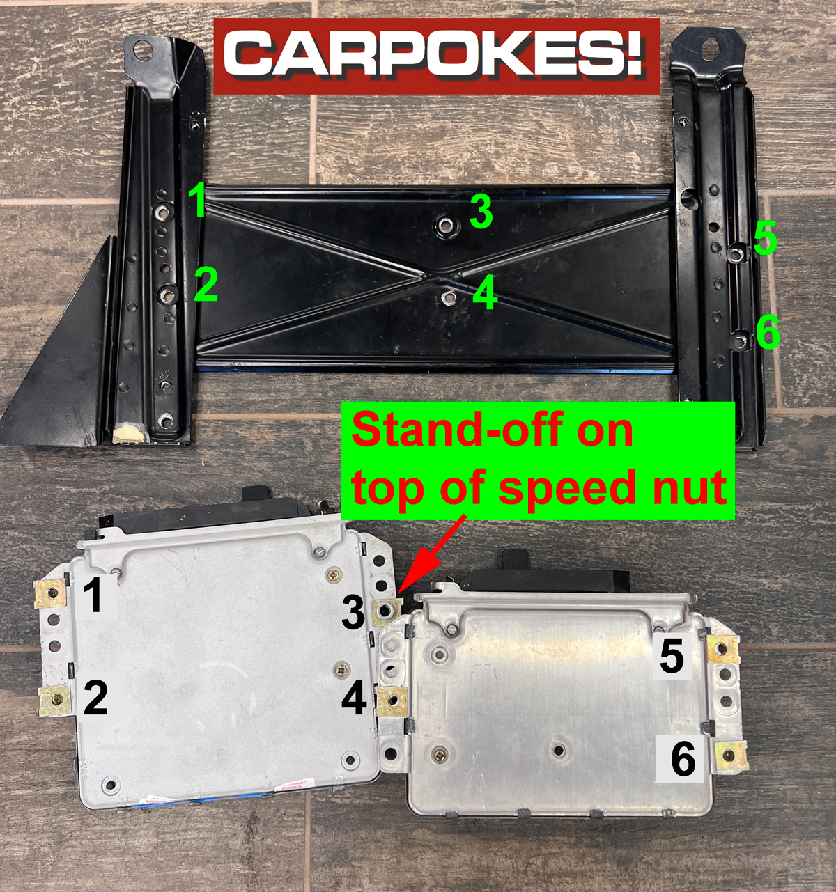

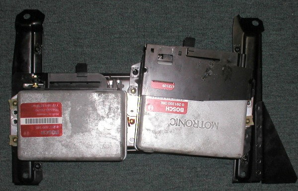

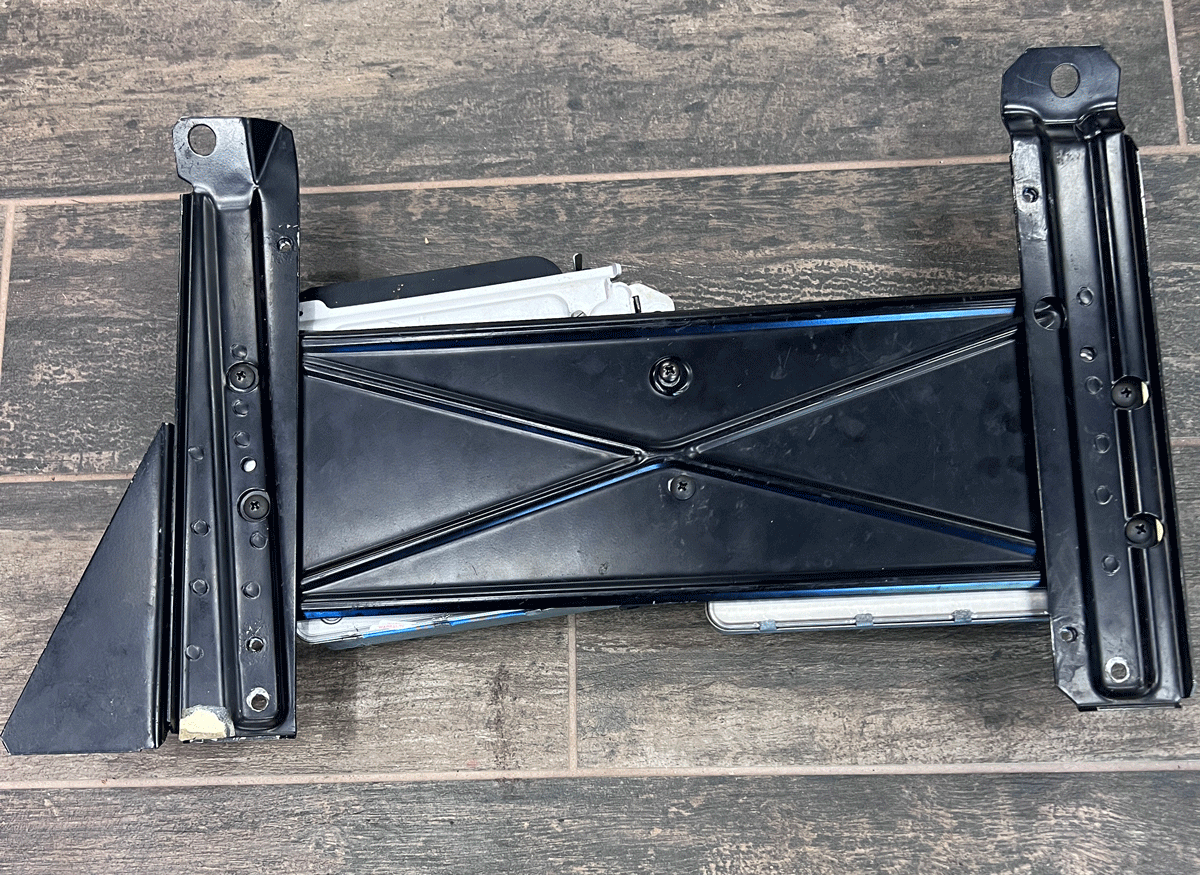

I recently discovered that if you google how to position the DME and KLR, most of the pictures posted elsewhere actually show it wrong. Lindsey has a picture that shows it right, but has even more that show it wrong. Not that it's mission critical, but thought worth posting. It doesn't help that there are so many holes on the DME/KLR case flanges, for reasons unknown, and that the speed nuts can fit over any of them. So anyway, here is the definitive Carpokes guide on how to position and/or orient the DME and KLR on the metal frame. :)
The picture below shows where the 6 speednuts 'should' be, with the screw holes on the frame numbered to match their corresponding speednuts. Note also where the metal spacer goes. (Feel free to copy and post the pic elsewhere if/as helpful.)

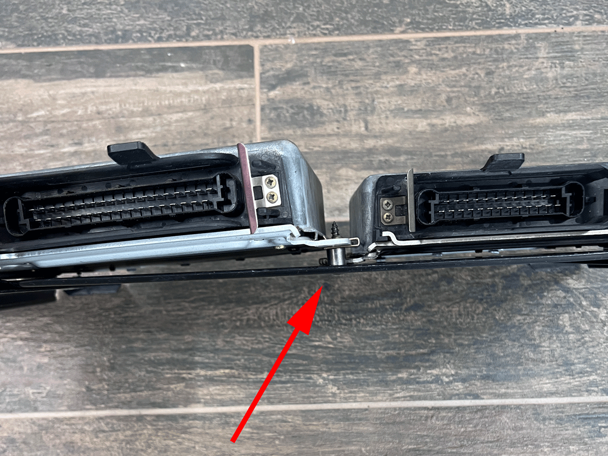

Once installed, the DME sits taller than the KRL and on an angle like this.
The DME also sits tilted away from the frame and KLR, thanks to the stand off.
