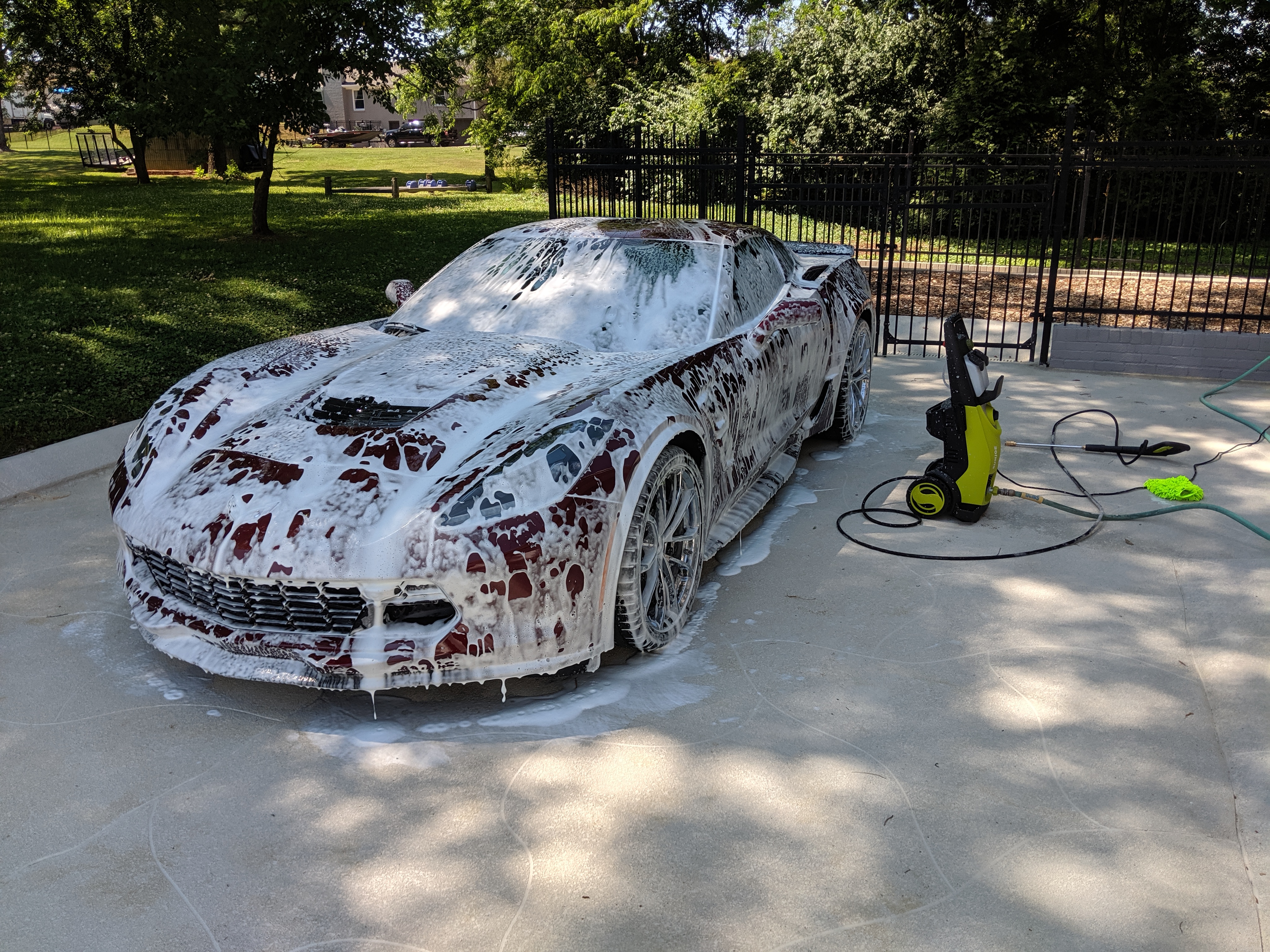

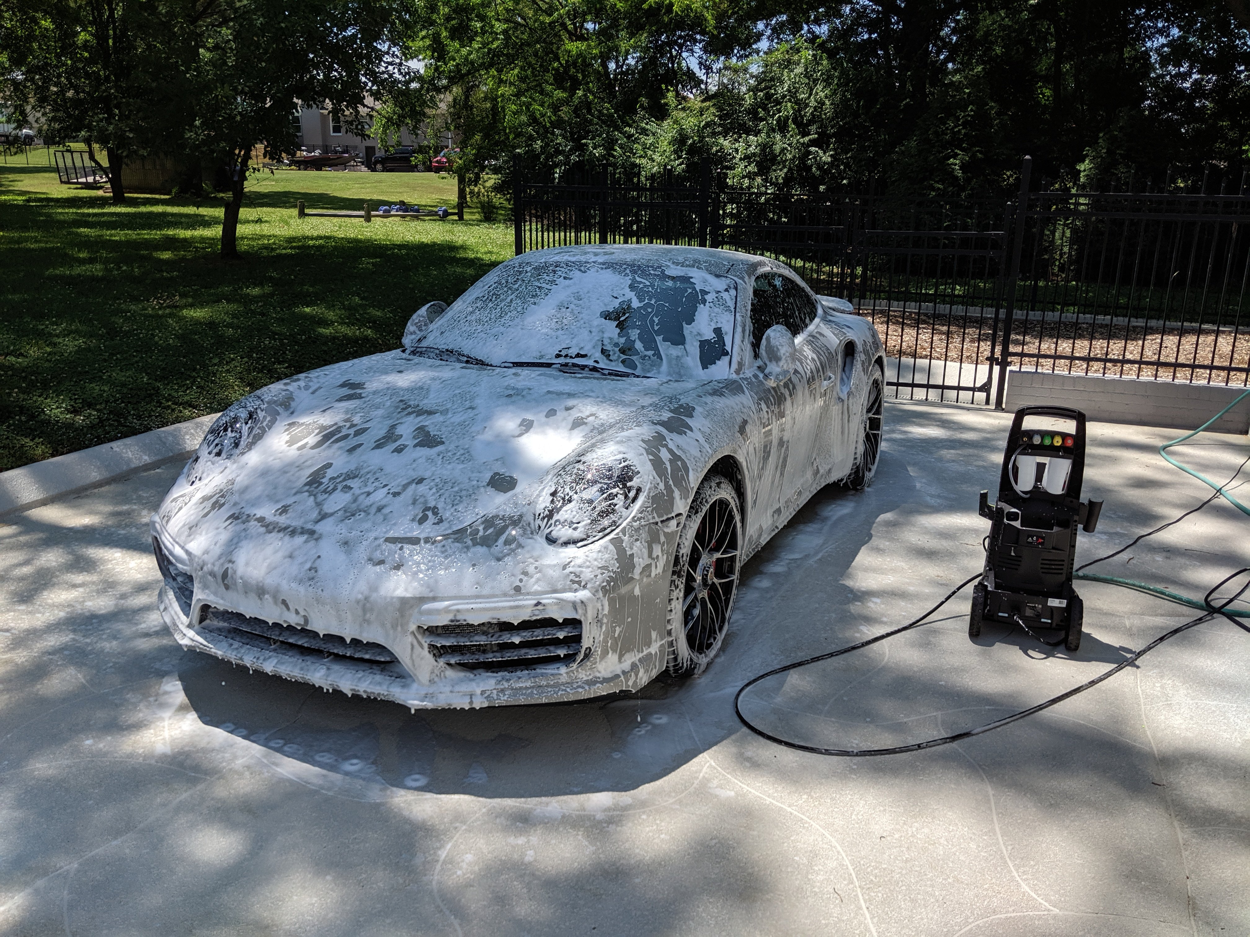

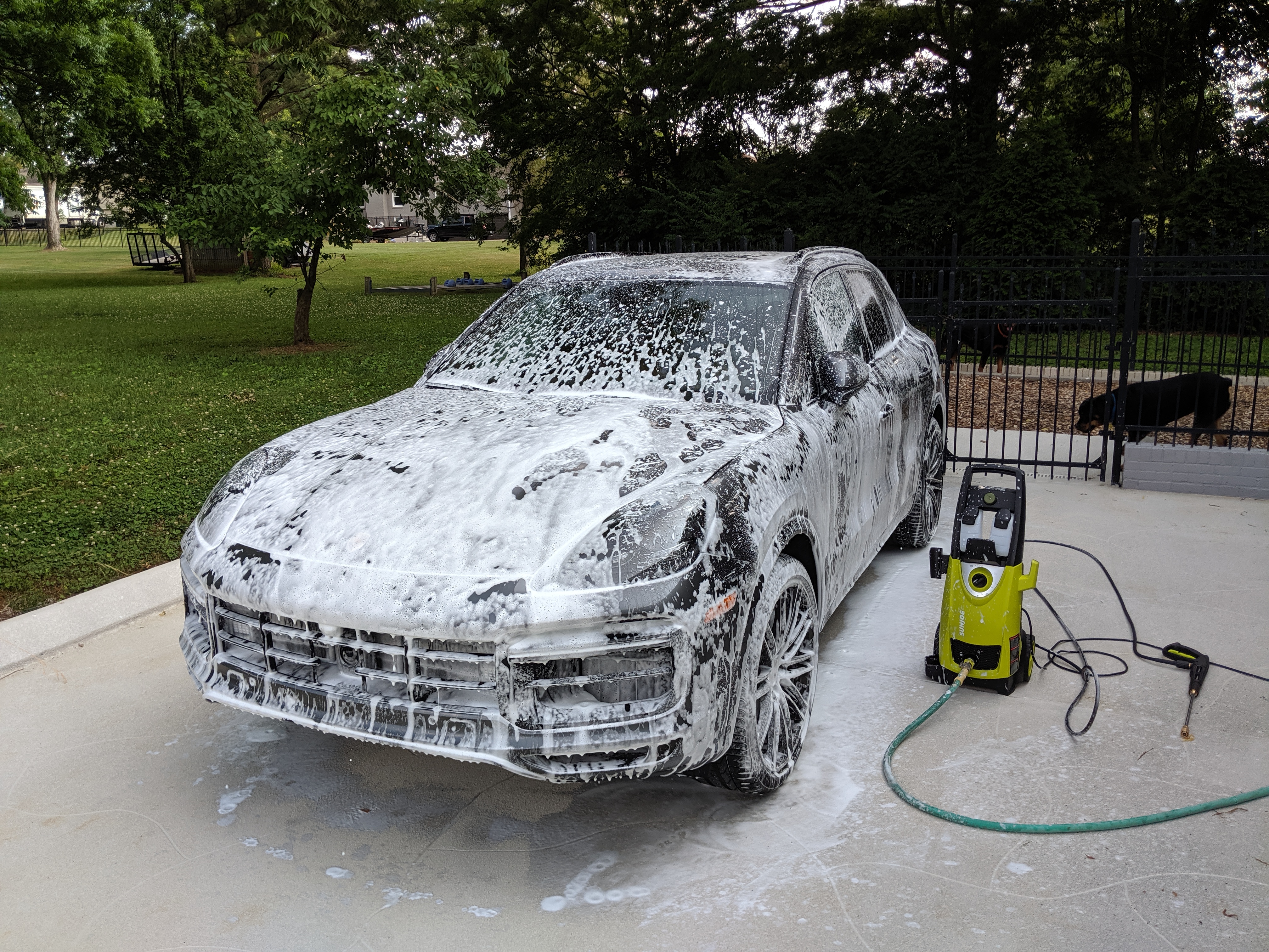

No risk lifting PPF unless you use crazy high pressure and point the wand vertically at an exposed film edge or point the wand at a spot where the film is already lifting. Staying mostly perpendicular to surfaces with a wide, lower pressure nozzle meant for car washing ensures no issues. That's been my experience anyway.
Foam works pretty well although you'll still usually need a bit of hand washing unless the vehicle is already mostly clean. (IE: all you have to clean is heavy dust.)
It does tend to dry nicely with little to no spotting if well rinsed, but maybe that depends somewhat on the foam product you're using.
As far as using a pressure washer for cleaning regardless of foam, I think they're great - they can really help as you said for initially removing big dirt. Of course, a pressure washer won't get the car clean on its own - gotta go back to good old elbow grease if you want it really clean.
Time for me is tight and winter washing of any type at home is out too, so my cleaning is usually of the simple maintenance kind of an already basically clean car using Griot's Speed Shine (excellent for that with its high lubricity). For a really dirty car I am fortunate to have an outstanding detailer and PPF installer. Too little time and other priorities dictate that in my case, especially since the cars get driven as often as possible.
Foam is fun however and interesting to look at! (Pics from June 2019.)
