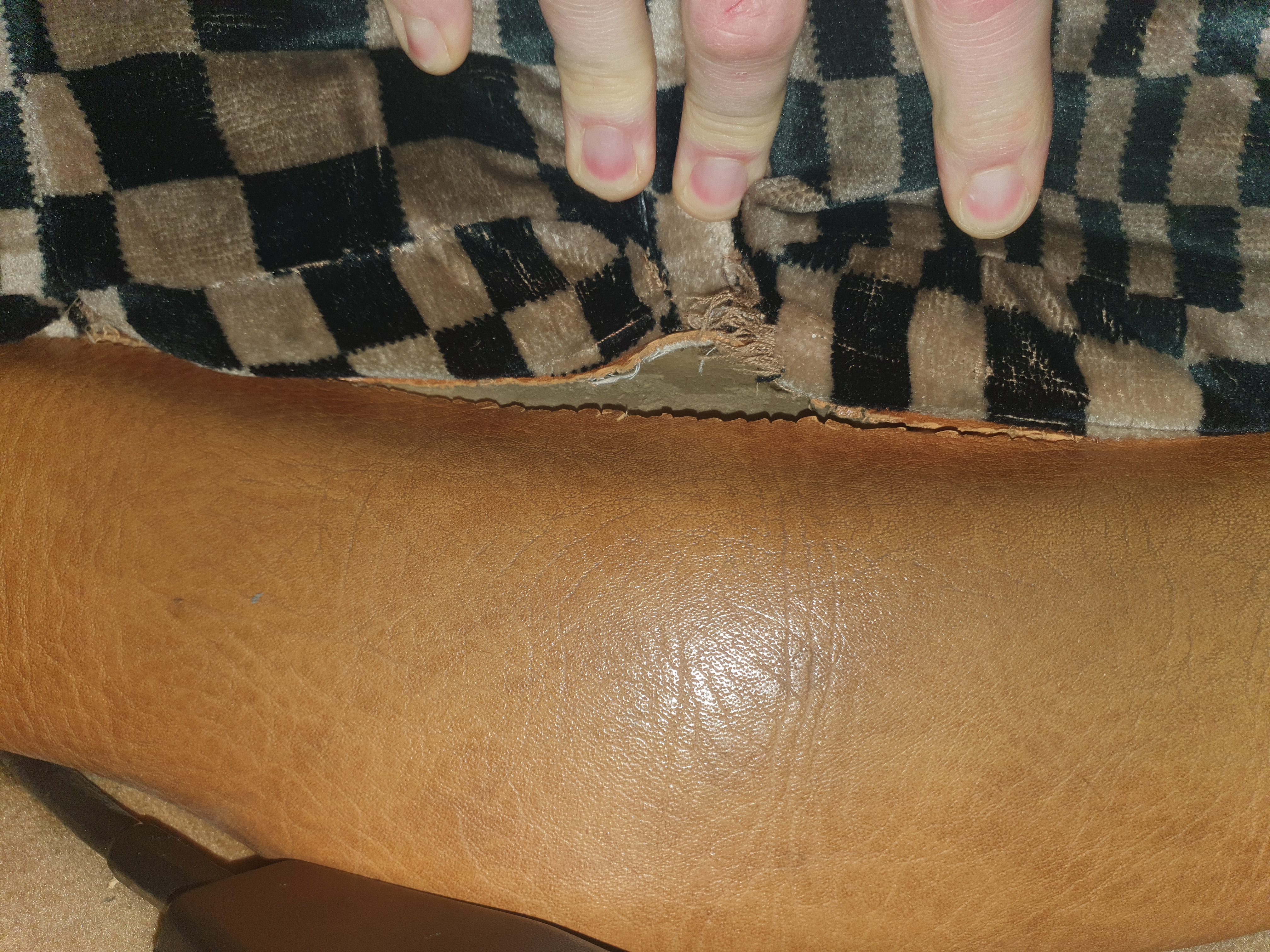

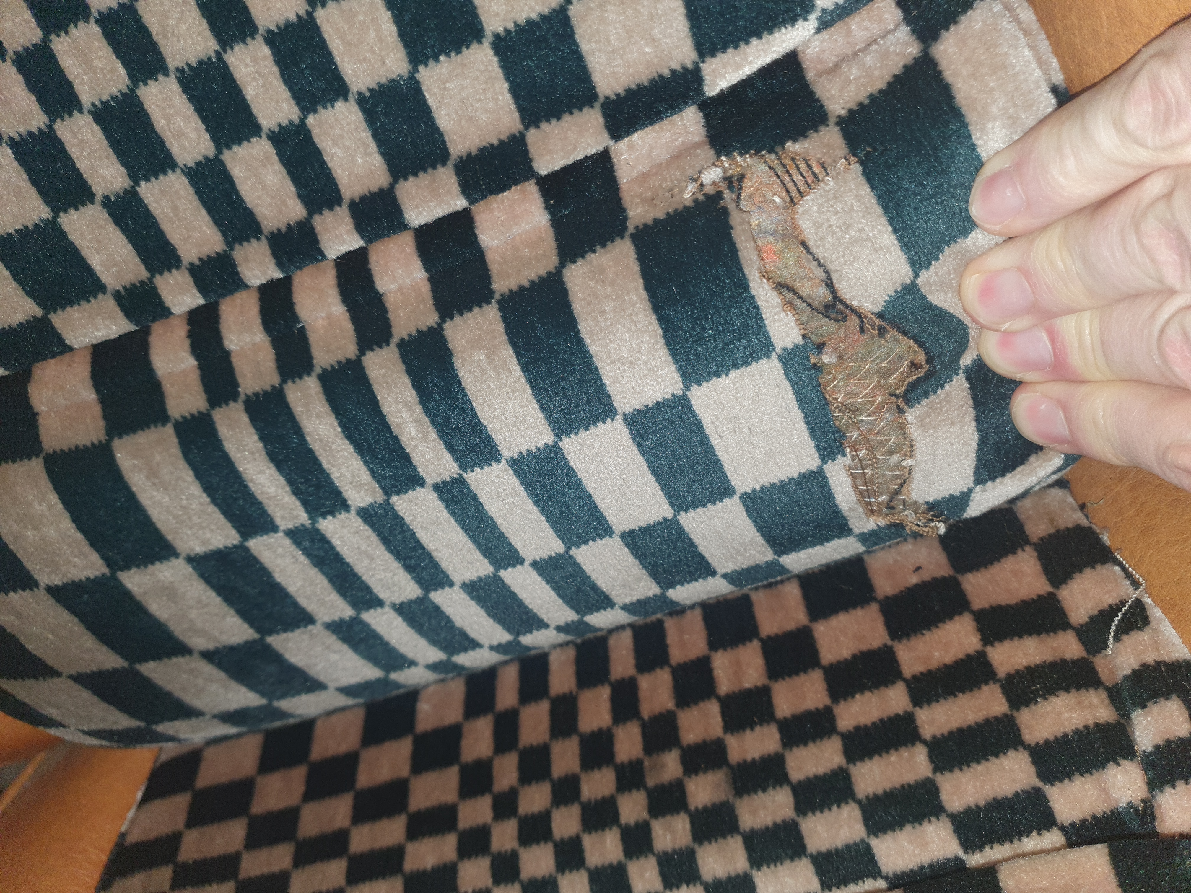

The front seats vinyl and fabric is cracking and falling apart. Rear seats and the rest of the interior are in pretty good condition.

Looks like a very fun project! If there's much refreshing due in the interior, you are certainly a candidate for removing everything in the car, and everything in the engine bay. Then clean prep paint while the seats and interior are refurbished and the engine refreshed. Know that the engine bottom end pieces are pretty durable. With the few miles on the engine and driveline, the focus should probably go to having the heads cleaned and maybe refreshed, and reassembled with new gaskets and seals.
With the early cars like yours sneaking up on 50 years old, look very hard at the rubber pieces especially in the suspension. New pieces will make the car a lot more enjoyable to drive.
The Pascha fabric panels in the seats may or may not be hard to find. Original stock has pretty much disappeared at this point, so you'll likely be hunting for a good replication. A decade or more ago, I looked at having some produced, but the minimum run volumes were way beyond my hobby budget, and there's more than one Pascha color. My later ('89) car doesn't have Pascha, so it would have been even harder to justify the spending.
Share project and progress pictures as you dive deeper into this project. I'm sure the car will be a rare treat to own when it's finished.

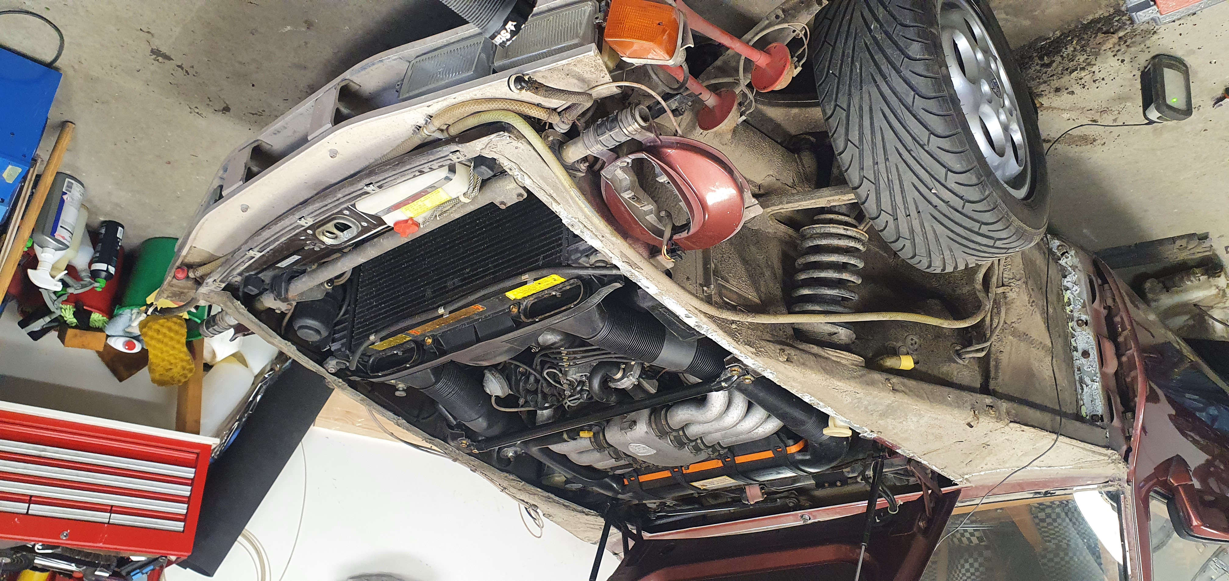

There's an inspection-list item that grabbed my attention
in your front-apron picture, and that's the missing washer and circlip on the link for the headlight motor. No worries if you aren't going to be driving the car before the repaint, as the headlight motor and the crossbar and links will be removed anyway. If you do decide to drive it now, putting a new washer and clip on that link will keep it from coming off and puncturing the radiator. For cars with AC, the condenser is usually the first victim of a stray link. At least yours is missing just the bottom-end pieces, so less risk of serious damage.
Enjoy the project!
Enjoy the project!

dr bob wrote: Thu Aug 26, 2021 8:39 am Sounds like you have a good handle on the scope of the work.
There's an inspection-list item that grabbed my attentionin your front-apron picture, and that's the missing washer and circlip on the link for the headlight motor. No worries if you aren't going to be driving the car before the repaint, as the headlight motor and the crossbar and links will be removed anyway. If you do decide to drive it now, putting a new washer and clip on that link will keep it from coming off and puncturing the radiator. For cars with AC, the condenser is usually the first victim of a stray link. At least yours is missing just the bottom-end pieces, so less risk of serious damage.
Enjoy the project!
Nice catch! I have not seen that, will fix it. Thanks

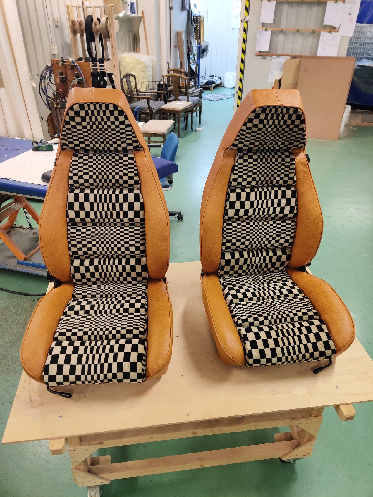

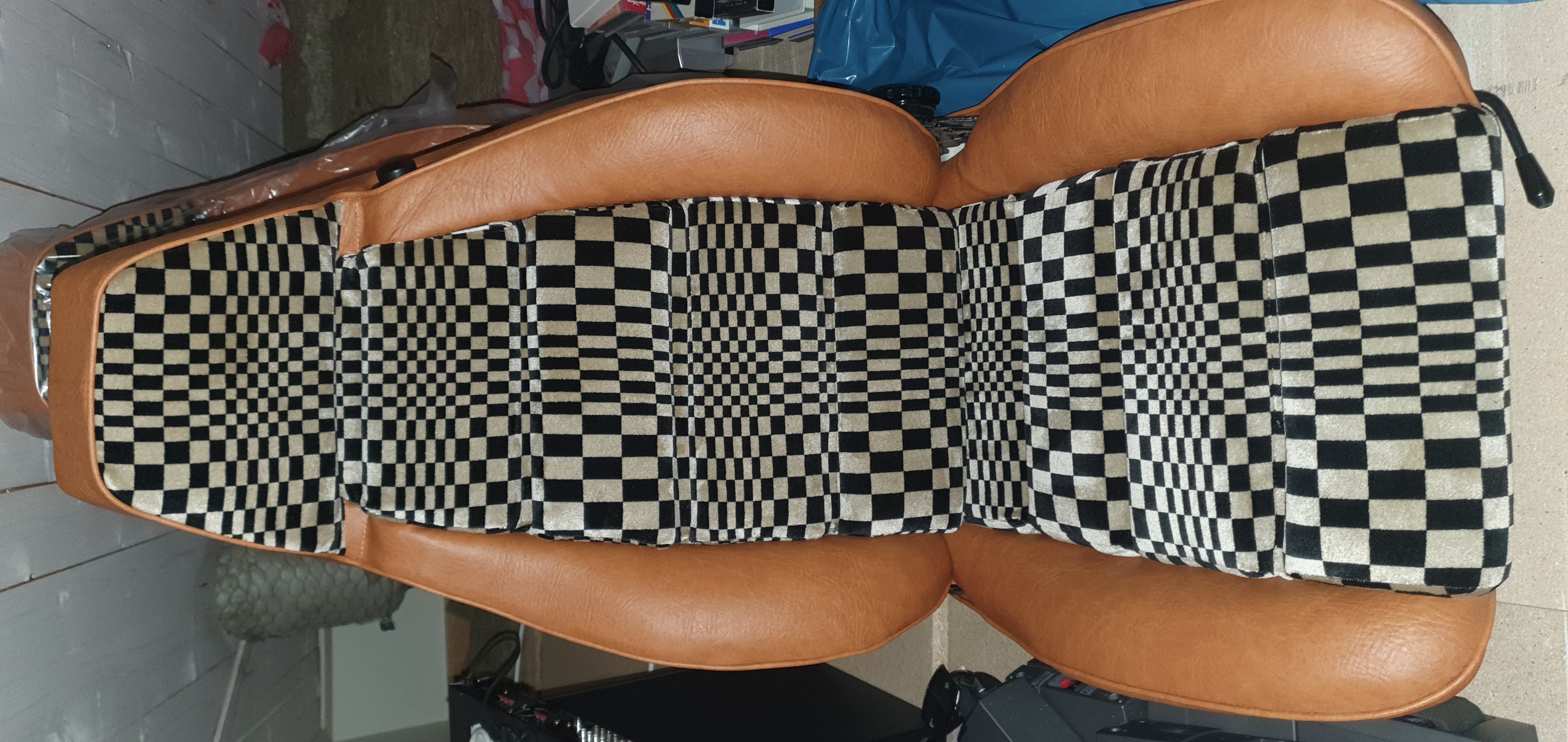

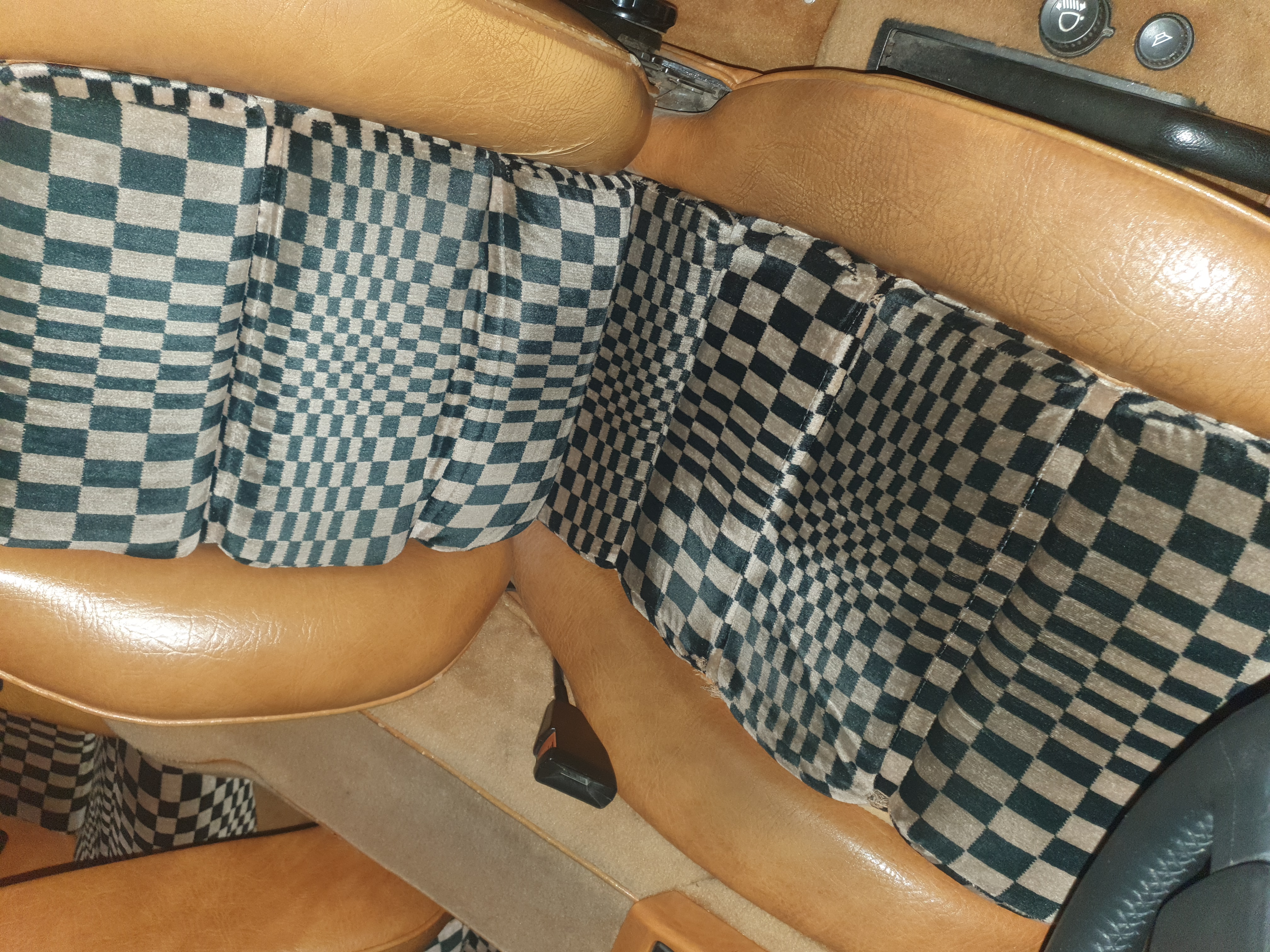

Ok so I got the front seats back from the trimmer
I am very pleased with the result and the new Pascha and vinyl matches up well with the rest of the interior

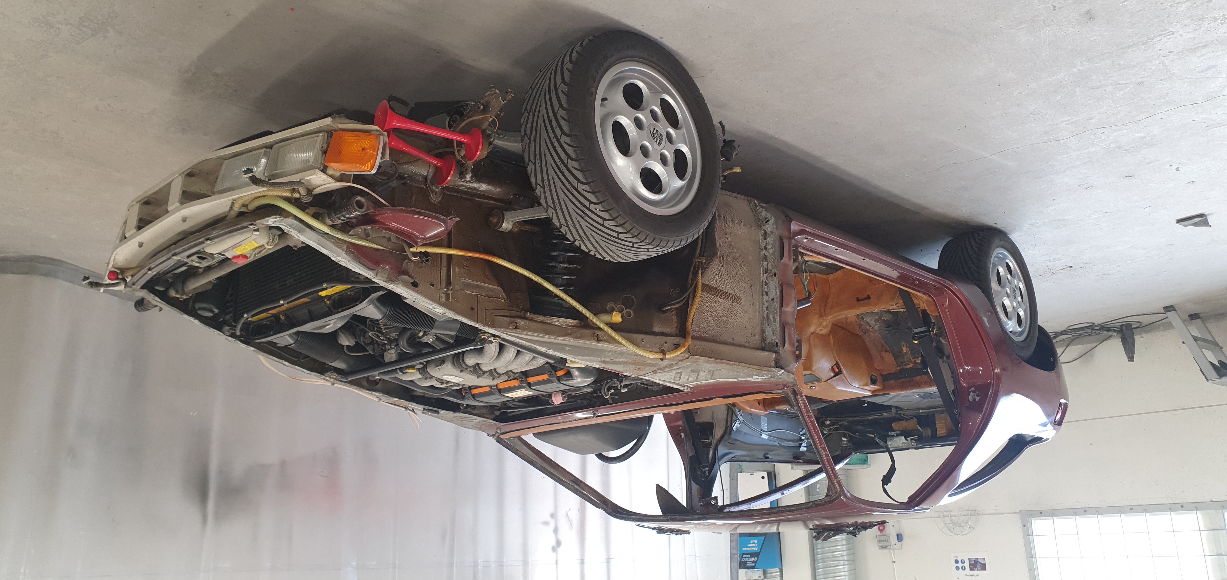

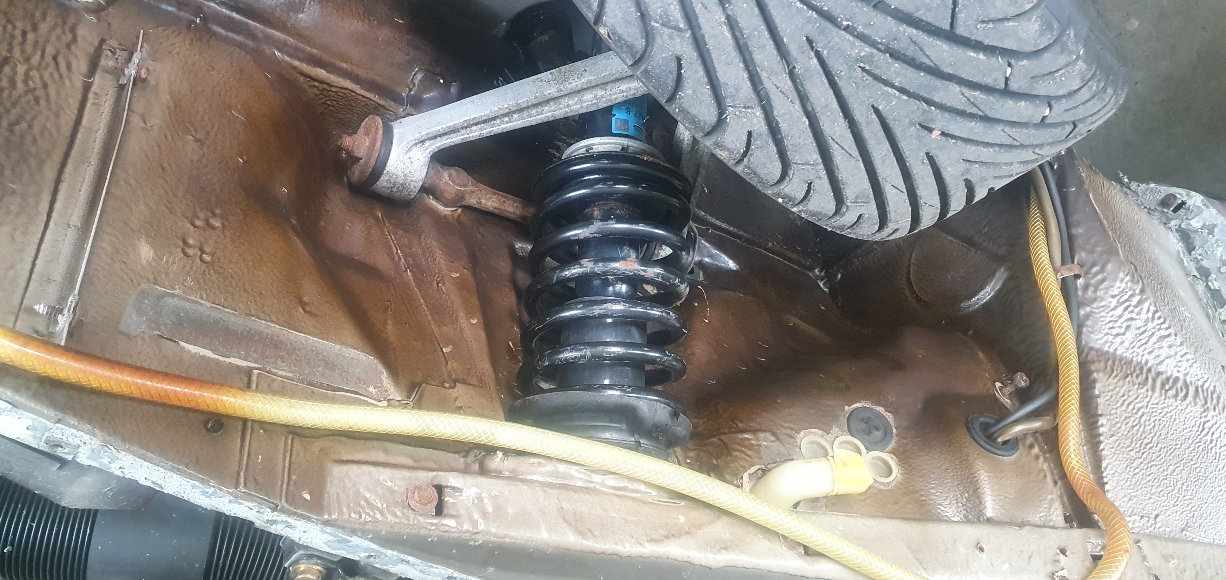

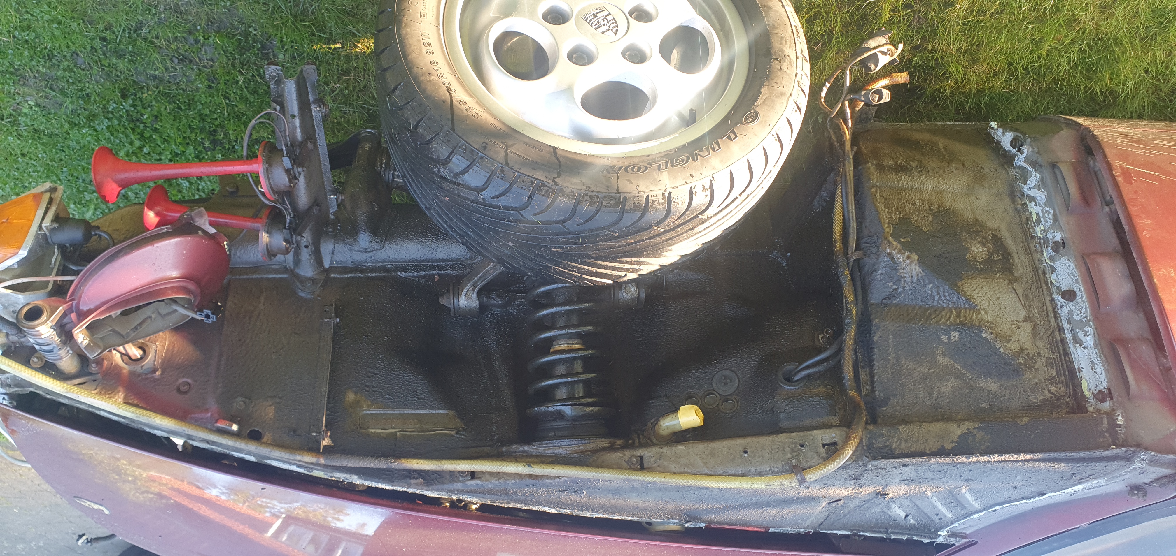

The car is coming apart for repaint and this is also a very good opportunity to clean areas that is hard to reach normaly.
The car is in good shape underneath with minimal corrosion on the body.
Mechanical bits here and there will need replacing.
Wheelareas very dirty in these pics.
