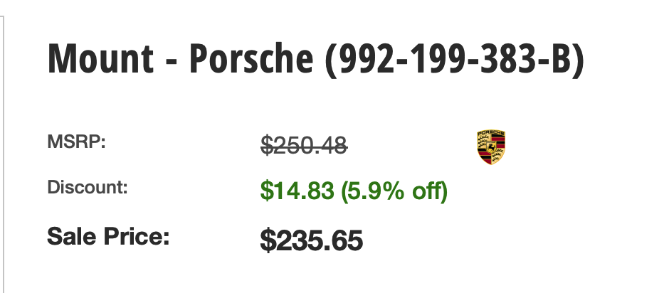

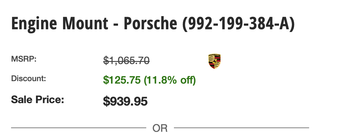

I did some digging in the PET diagrams and the 992 version of the mounts is $939 each. That would be a huge savings If they are plug and play. The 991 part numbers are not superseded by the 992 part numbers.
The non PADM mounts are cheaper.
