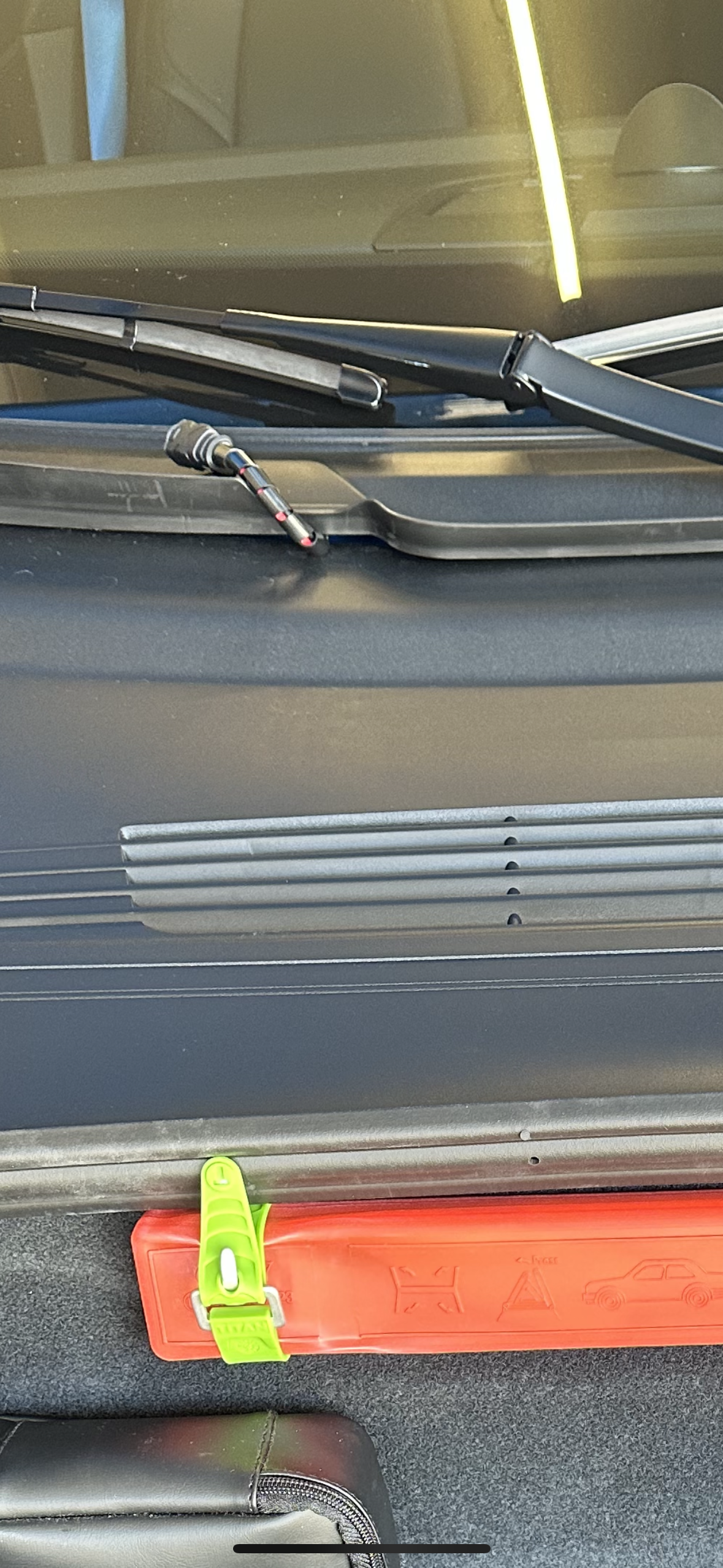

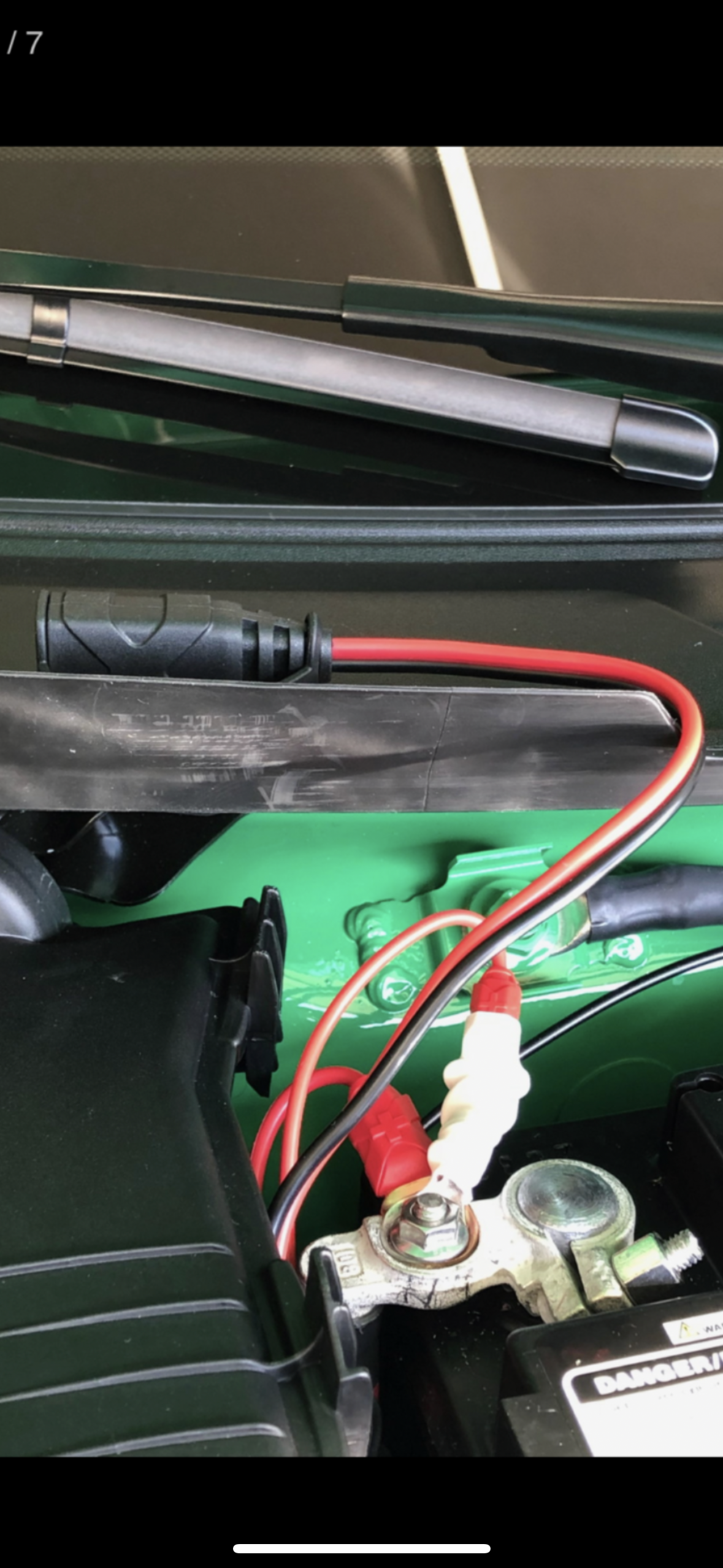

Regardless of Charger I suggest you consider installing a polarized tap connector at the battery to allow connecting with the frunk lid closed

That's a great way to hook up if one prefers that over the foot-well outlet. Definitely agree that it's best to have the lid closed if you go that route.audi4t wrote: Mon Jan 30, 2023 6:32 pm Regardless of Charger I suggest you consider installing a polarized tap connector at the battery to allow connecting with the frunk lid closed52EADC7F-C4B2-4878-A8F8-37A74965312D.png[attachment=0]310AA3C9-45B9-4CEC-94BC-5A6B329C7CD4.png
Where did you find your tap?

It’s NOCO - available on Amazon
Also if the doors and frunk are locked you can access the battery positive an negative without having to access the fuse box
