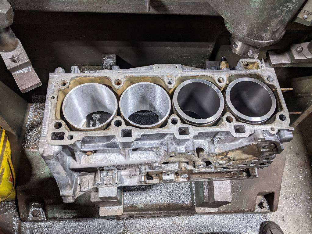

We all like pictures!
New Darton sleeves being installed. Should have recycled the aluminum shavings!
