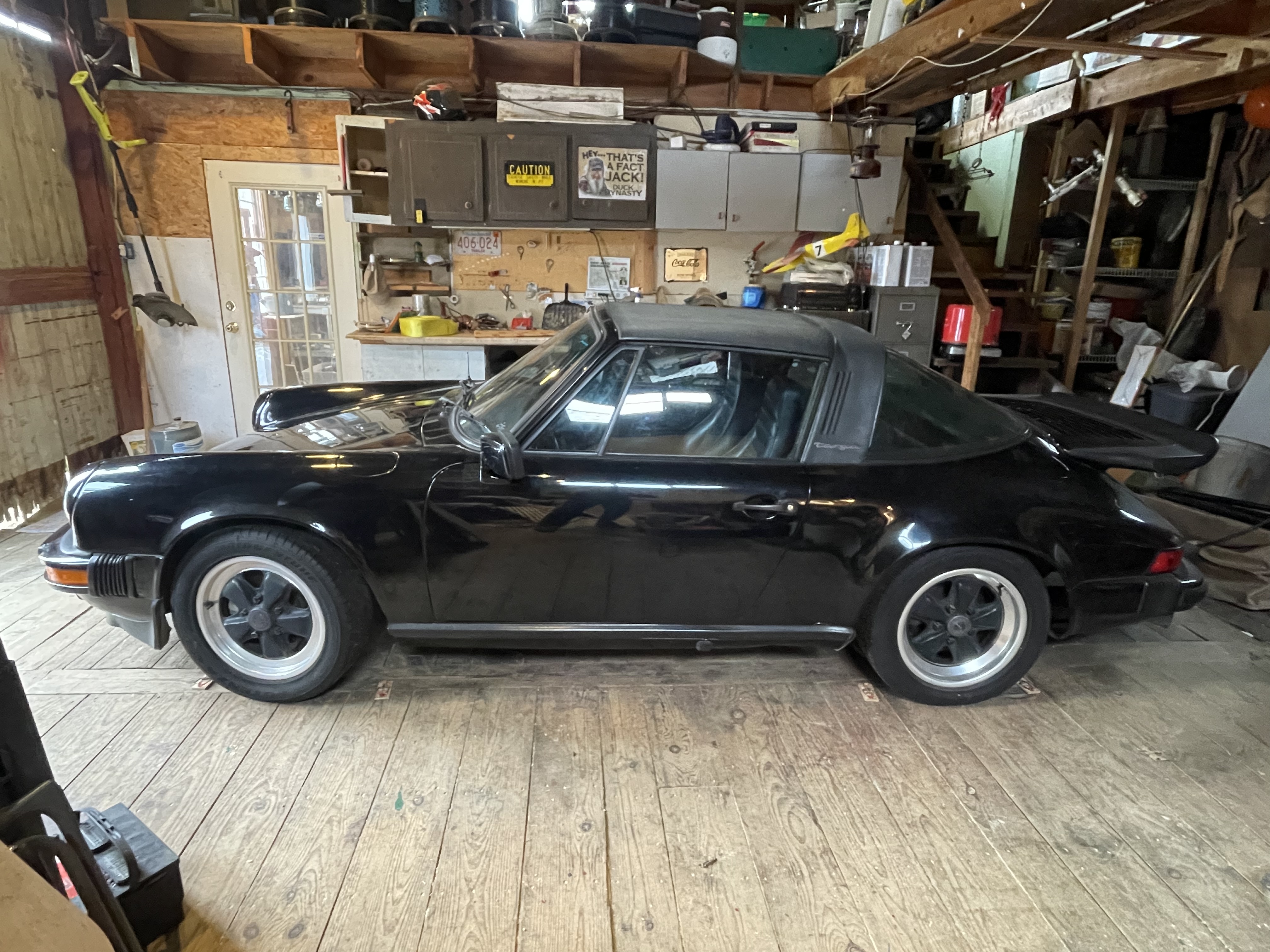

I have inherited my FIL’s 84 Targa 3.2.
It sat in a garage not run for about 2 years
I turned it over just to make sure it still would turn and it started but with a hiss sounded like air in the strokes almost like a missfire. Hard to explain. I didn’t continue letting it run.
Wasn’t smooth. I didn’t also want to run it due to the oil sitting in just the sump. How quick does it get to everything to protect. Do you bump it many times to get the oil up? I mean I’m sure people just start their 911’s after sitting all winter
Could it be vacuum leak from a hose? Maybe mouse chewed through? I just hope not a stuck valve or something. I’ve a valve sticks on the 3.2 will it hit the piston? There was no sound like that just the hiss and rough run in the short time i let it.
Engine start after sitting a few years 84 3.2
