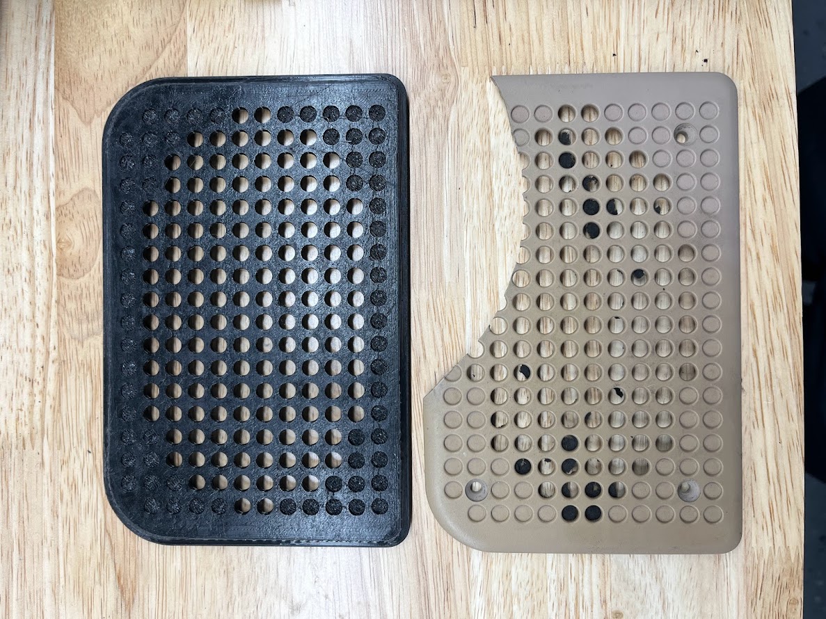

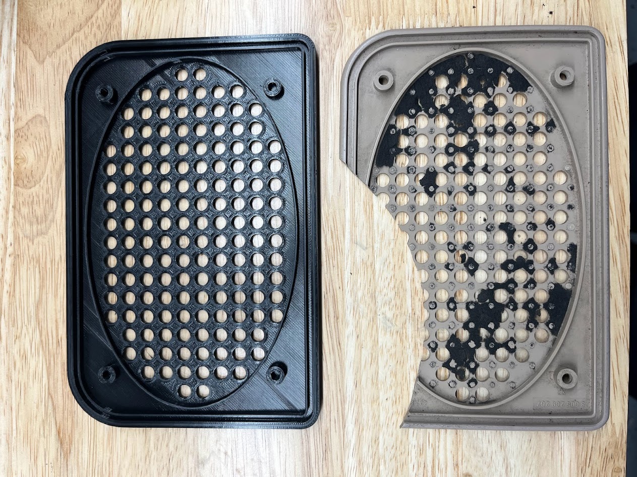

Over the holidays I had some free time and also was in need of new speaker covers for my late model 951. I drew these up in CAD and printed them. Turned out great and thought I would share the file here if anyone else wants to use it. For some reason I cant attach the 3D-Model file but if you PM with your email address I can send it to you.
I'll probably end up sanding and painting them before installing but that shouldn't be too much work.
Print Specs:
Ender 3 Printer
Black PLA
Bed Temp: 220C
Extruder Temp: 60C
Print with supports with the outside facing down on the print bed

Wow, those look great. Thanks for posting. You can post the .stl in the dedicated .stl section below.
