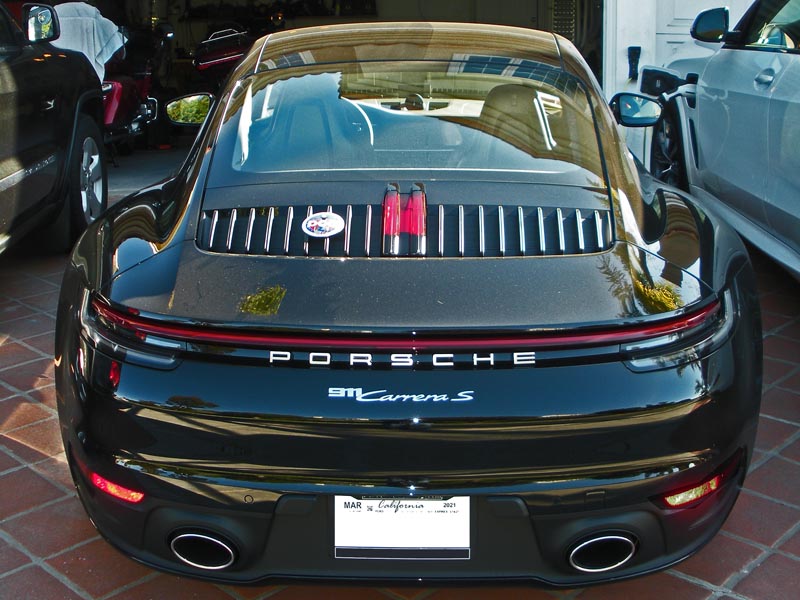

Here is where I placed mine on my 2021 C2S.

Bluehighways wrote: Mon Jan 02, 2023 9:50 pm Here is where I placed mine on my 2021 C2S.
Curious to know how that badge is attached to the plastic grill?

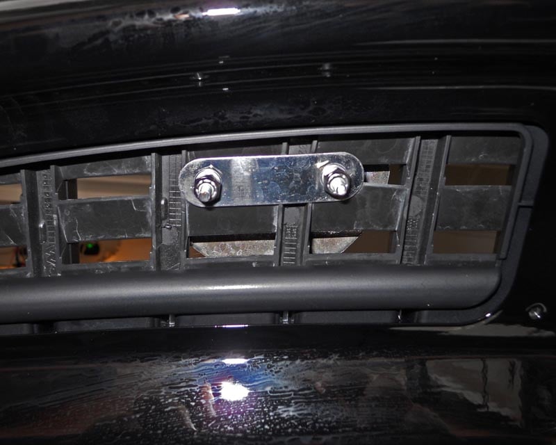

Q.) Curious to know how that badge is attached to the plastic grill?
A.) The Roundel comes with two rather long threaded bolts and a metal backing plate. The location shown on my grille is really the only place where the spacing of the bolts can get past the grilles and the louvers without drilling any holes.

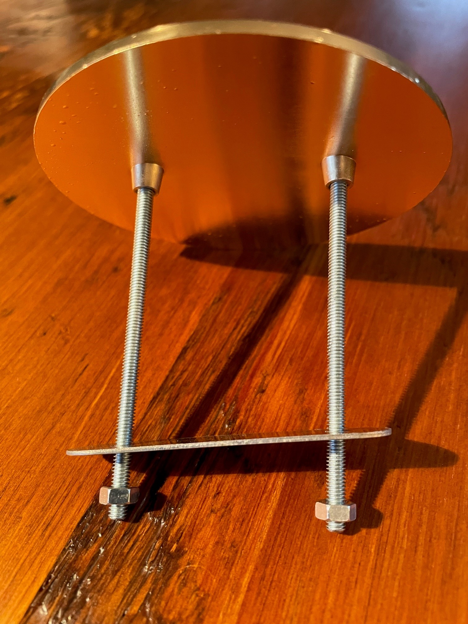

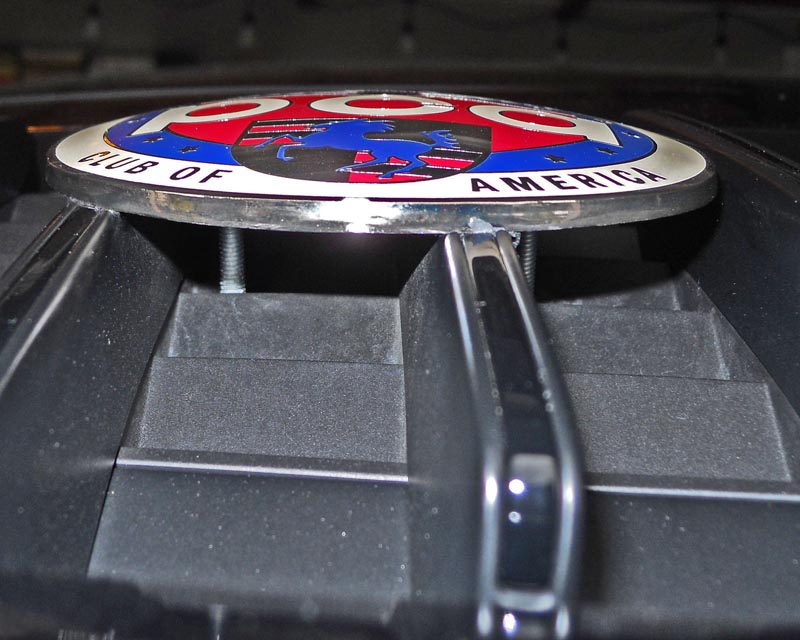

Here are a few more pictures that show how I installed it on my C2S.
Rondel - LR3.jpg (107.28 KiB) Viewed 3380 times
Rondel - LR2.jpg (88.98 KiB) Viewed 3380 times
Rondel - LR1.jpg (94.11 KiB) Viewed 3380 times

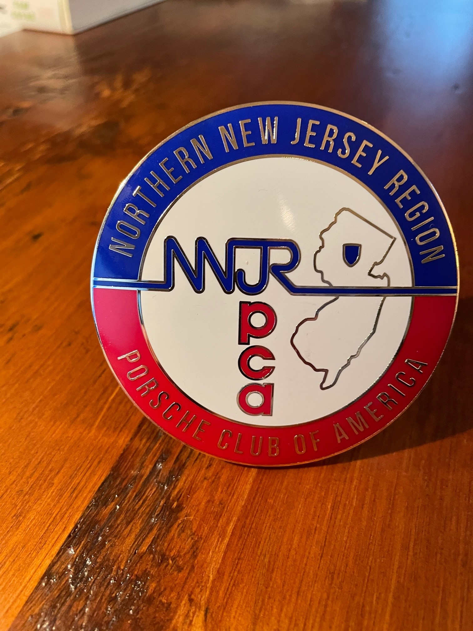

Mine looks the same, Did you use any washers? I can't seem to copy an image of my Badge.
Dduck911
Posts: 5
Joined: Sun Jan 01, 2023 12:01 pm
Figured it out.
PCA Badge.Front.jpg (703.38 KiB) Viewed 3376 times

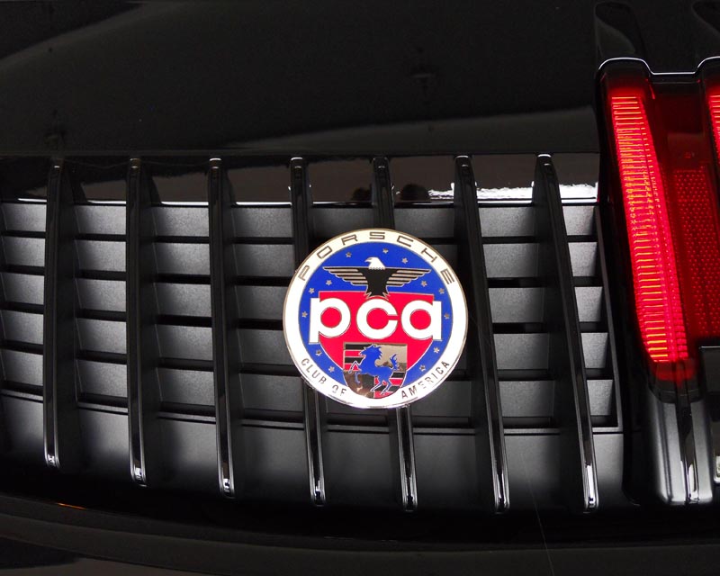

Here's the underside of my 'hood' -- not a lot of room for badge hardware and unfortunately the only spots are right above the fans. I spoke with another Carpokean today who tells me Porsche put a badge on the Sports Classic (i.e., the manual transmission capital-T turbo car). He tells me Porsche added some type of bracket to hold it so it doesn't sit against the plastic and potentially scratch it; and they installed it up and away from the fans. He promised to post pics soon, so am looking forward to seeing that. My plan is to come up with some kind of mount that keeps the badge from contacting the car (or maybe a rubber-pad to protect the car) and keep it away from the flow of the fans. Stay tuned on that.

Tom,
The pictures of the Grill Badge mounting on the Porsche 992 Sport Classic (SC) are below. This should provide a good look at the SC Factory Grill badge mounting platform that we discussed. It appears the SC badge is fastened to the platform with double sided tape or possibly with a small bolt that mounts to the underside of the Grill badge.
As we discussed the Porsche Heritage badge is a smaller diameter than the standard PCA Grill badge. If say the platform diameter was the size of the PCA it would be large enough for most of the round Grill badges that folks may want to mount.
Dave
