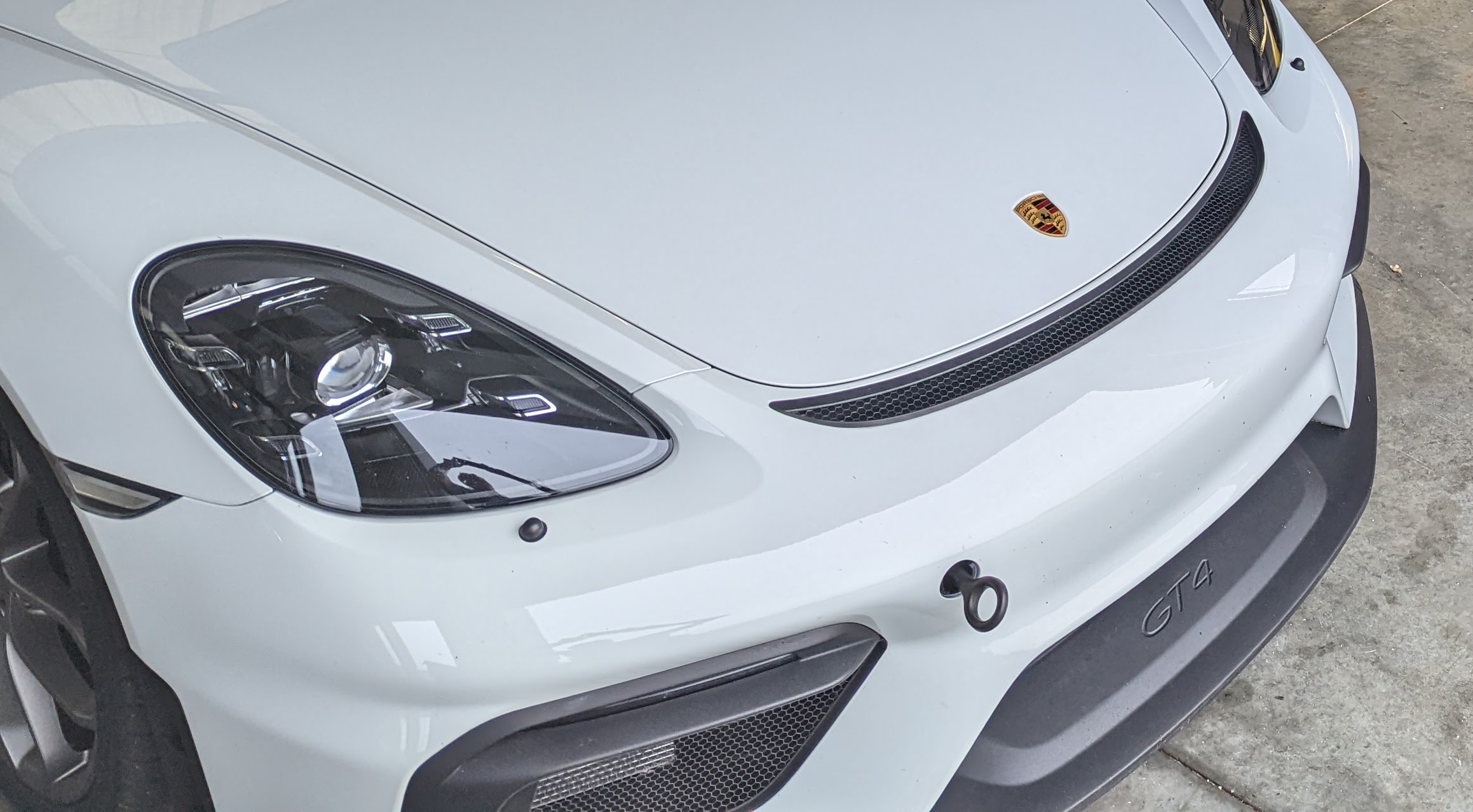

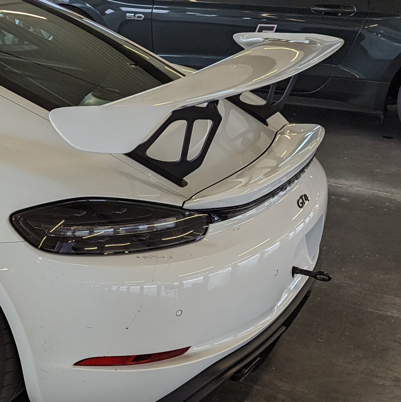

I would definitely use tow hooks. If you don't and you require a tow while on track, the resulting potential damage will buy a lot of Porsche tow hooks. And no, you'll look wise, not at all like a poseur.

Front & rear.
And in case you don't already know and so you don't get frustrated trying to screw them in, they are threaded backwards!

- PXL_20220528_135458266.jpg (337.51 KiB) Viewed 604 times
- PXL_20220726_124609956.jpg (479.82 KiB) Viewed 604 times
