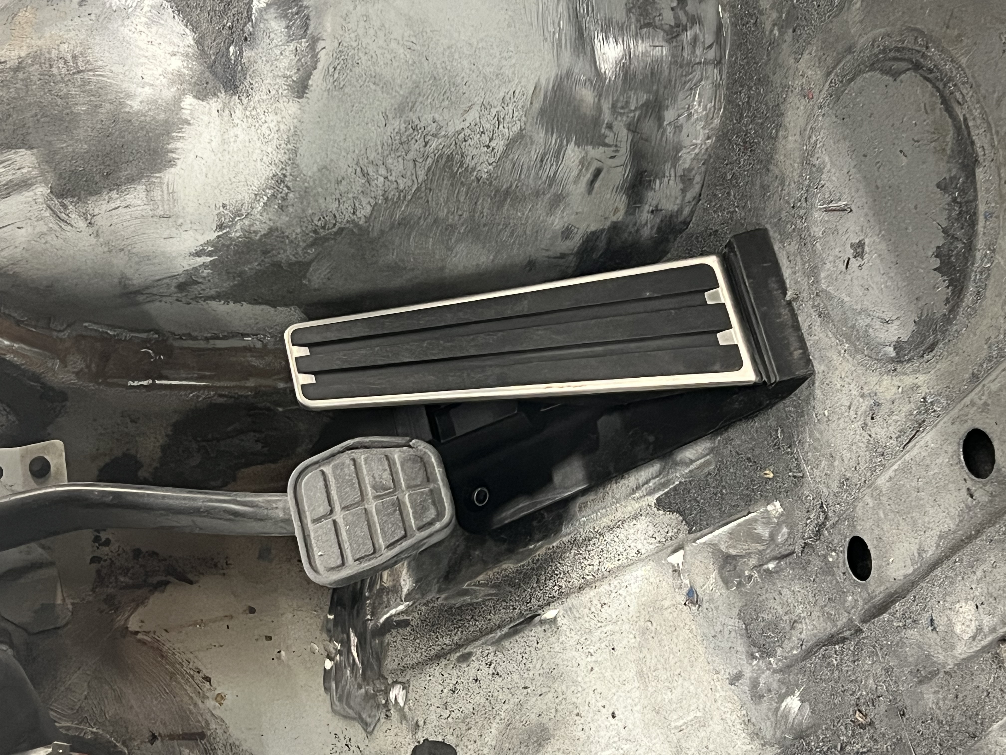

New throttle pedal for the track car, no cables!

DBW?

But even if you have DBW, how do you modulate throttle...dial, trigger, twist grip, mind control?

That’s a late model 911/panamera throttle pedal. Hooking it up to my Link ECU and using a cayenne throttle body. By using inputs from clutch switch and brake light switch I can have it auto blip for downshifts while braking
