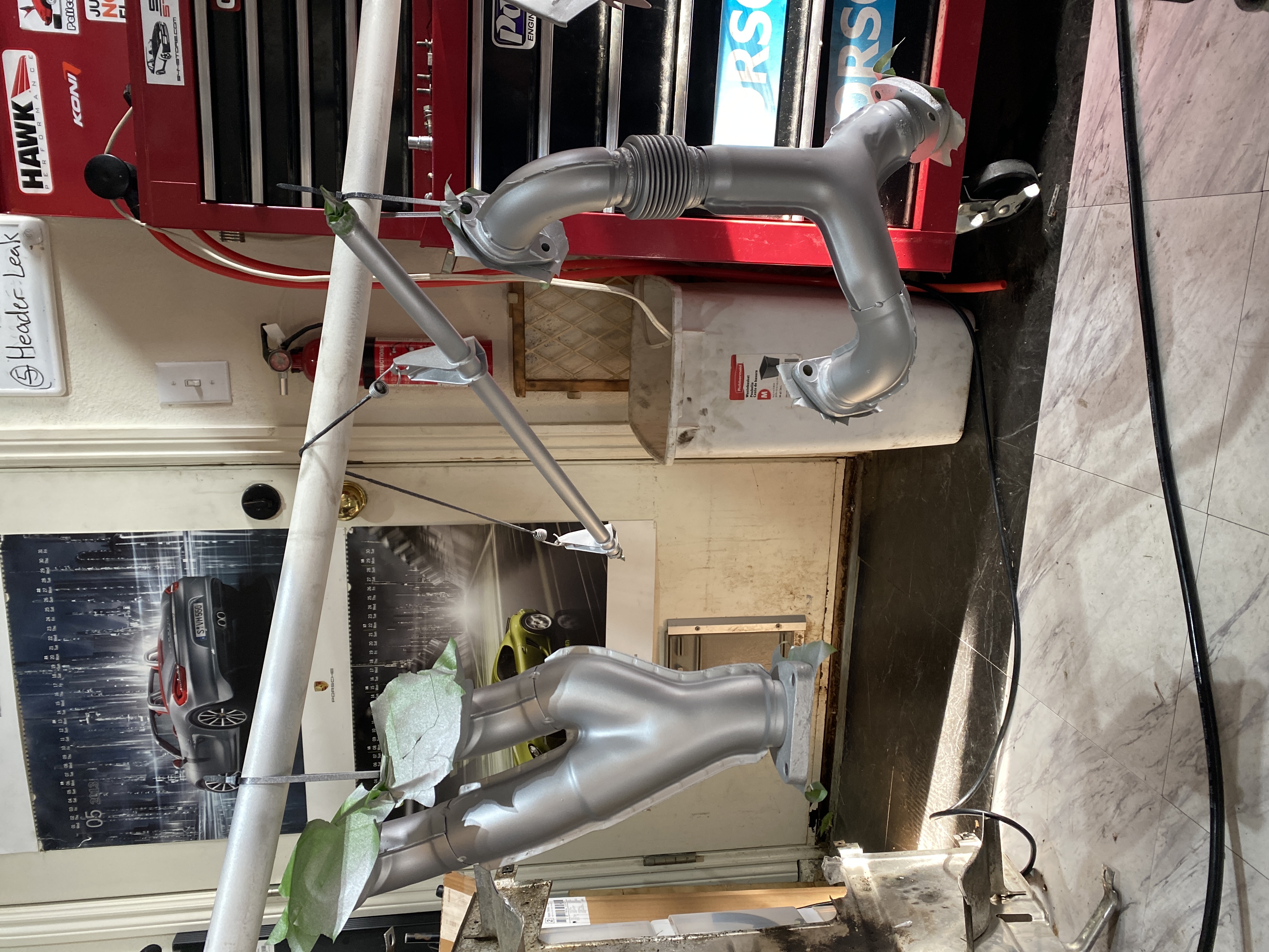

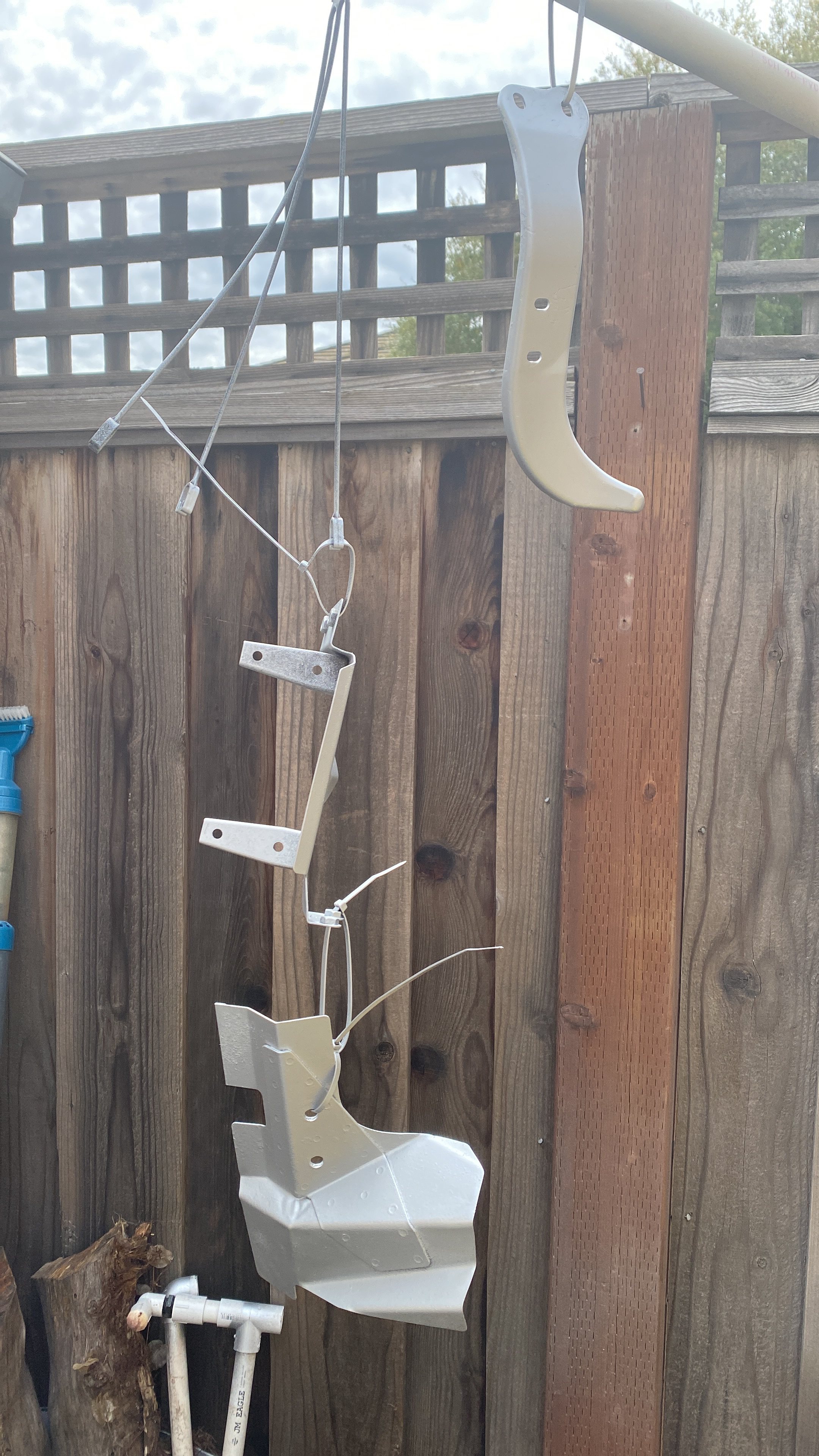

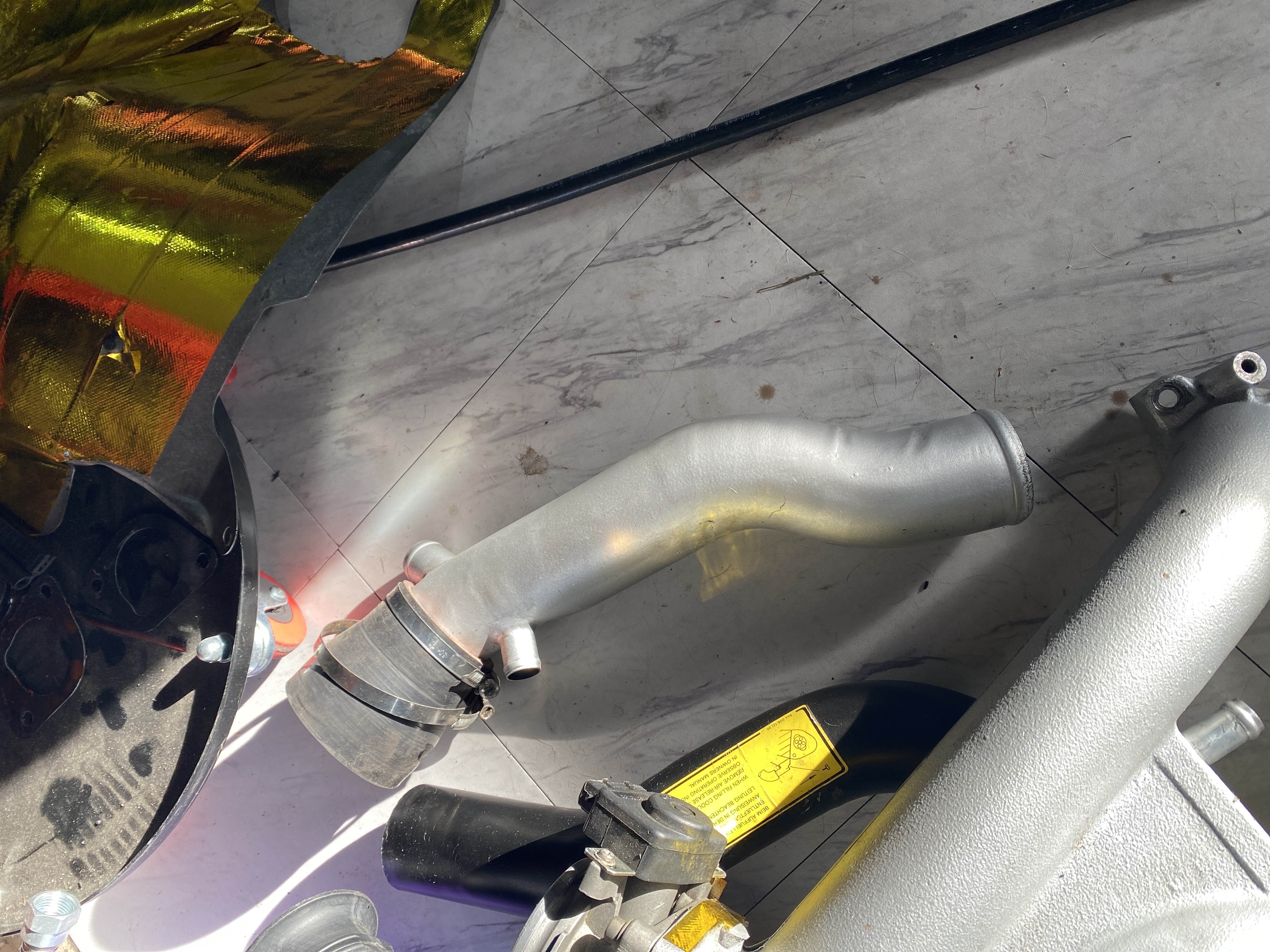

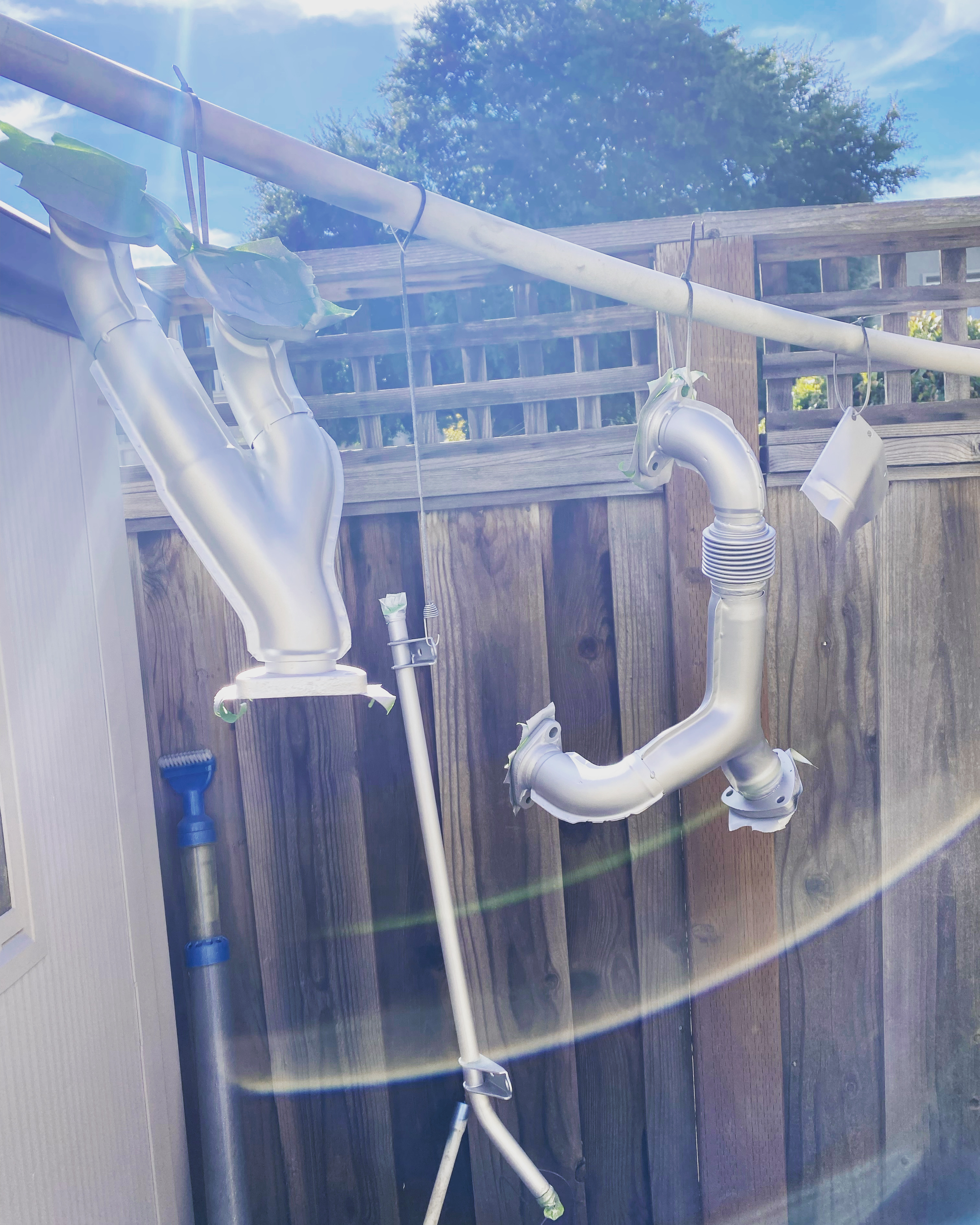

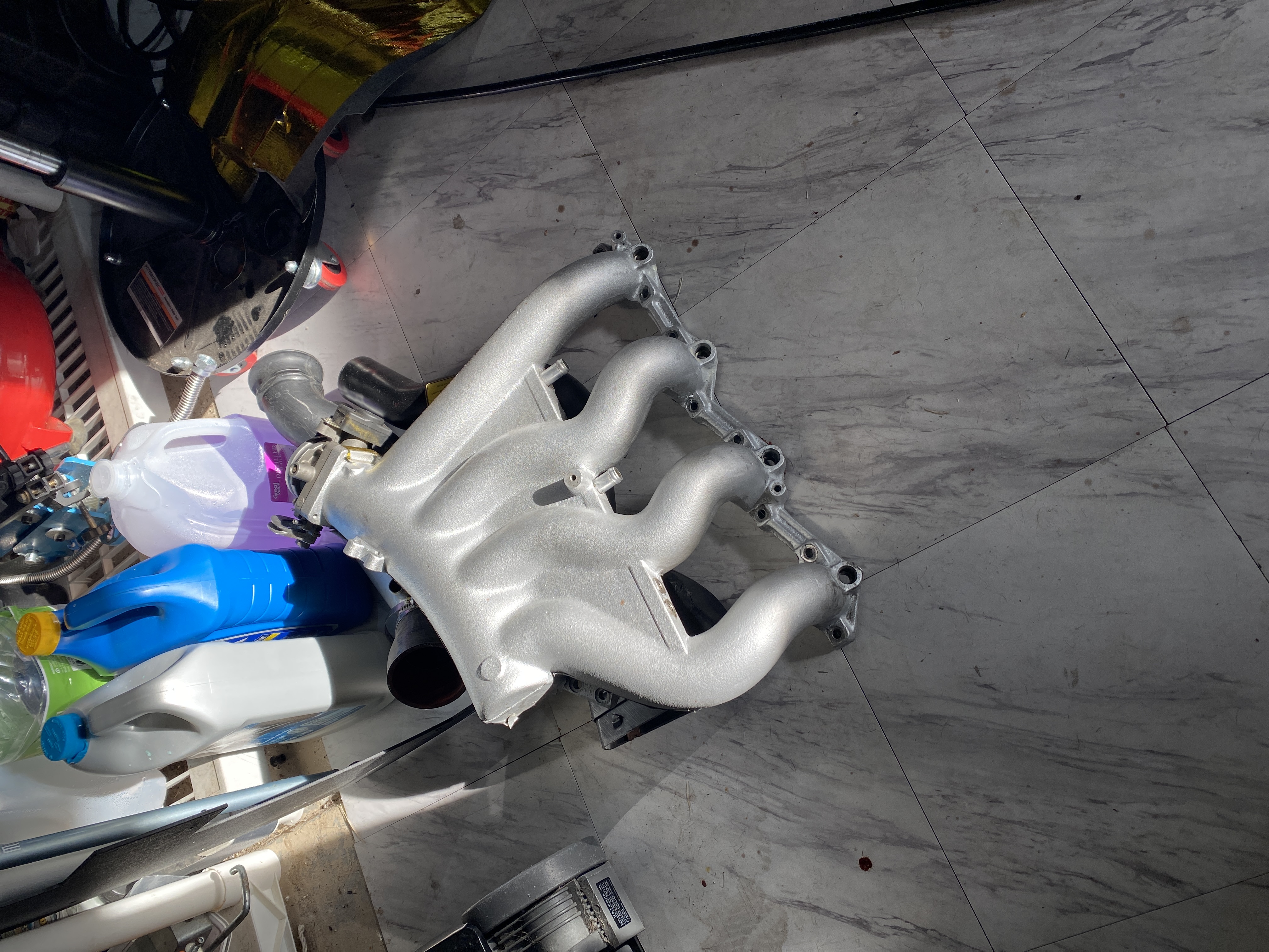

I have been ceramic coating various parts with Cerakote silver. It takes 5 days to cure 100% and so far so good. Anyone else using this?

I forgot one

I've eyeballed it a few times but never used it - do you have to bake it or just find a place to hang it for 5 days?

Just find a place to hang it for 5 days.

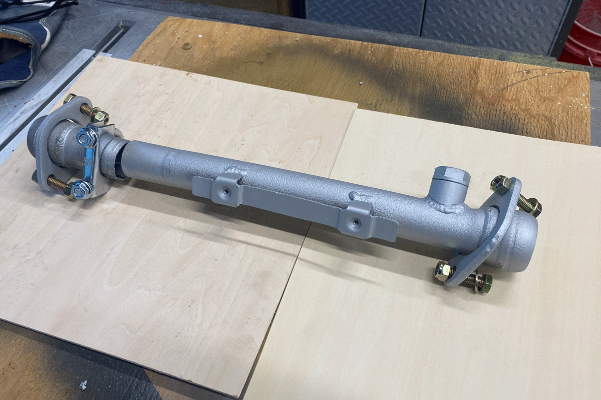

That looks great. I've been using POR 15 High Temp for exhaust lately, which has a similar look. The POR 15 HT seems to hold up very well, but you do need to cure it in an over. Would love to compare it to Cerakote someday. I was lucky to get an old HF powder coating oven, but unfortunately they've stopped selling them. :( Here's an old Mercedes part I sandblasted and covered in the POR 15 High Temp stuff.
