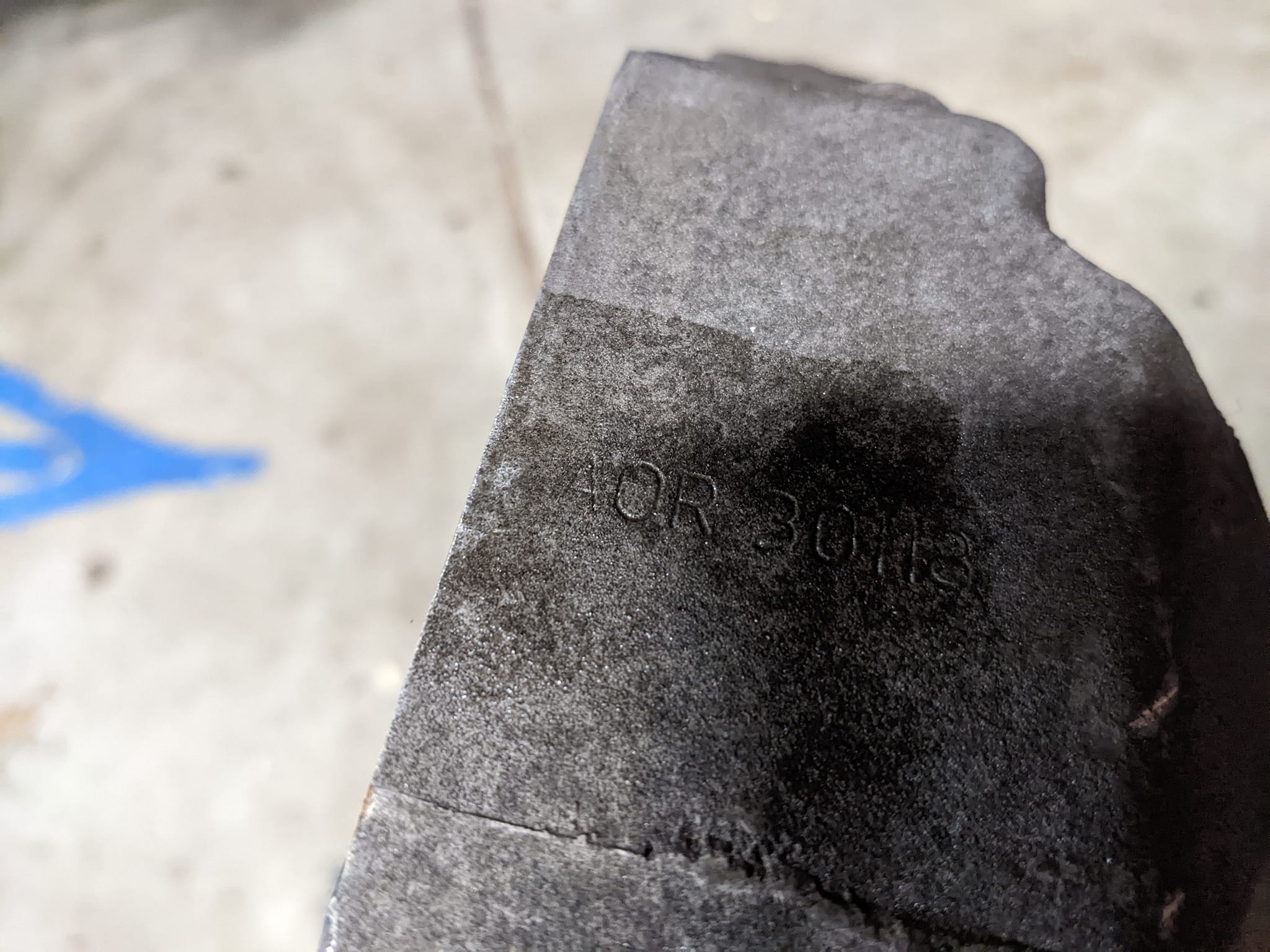

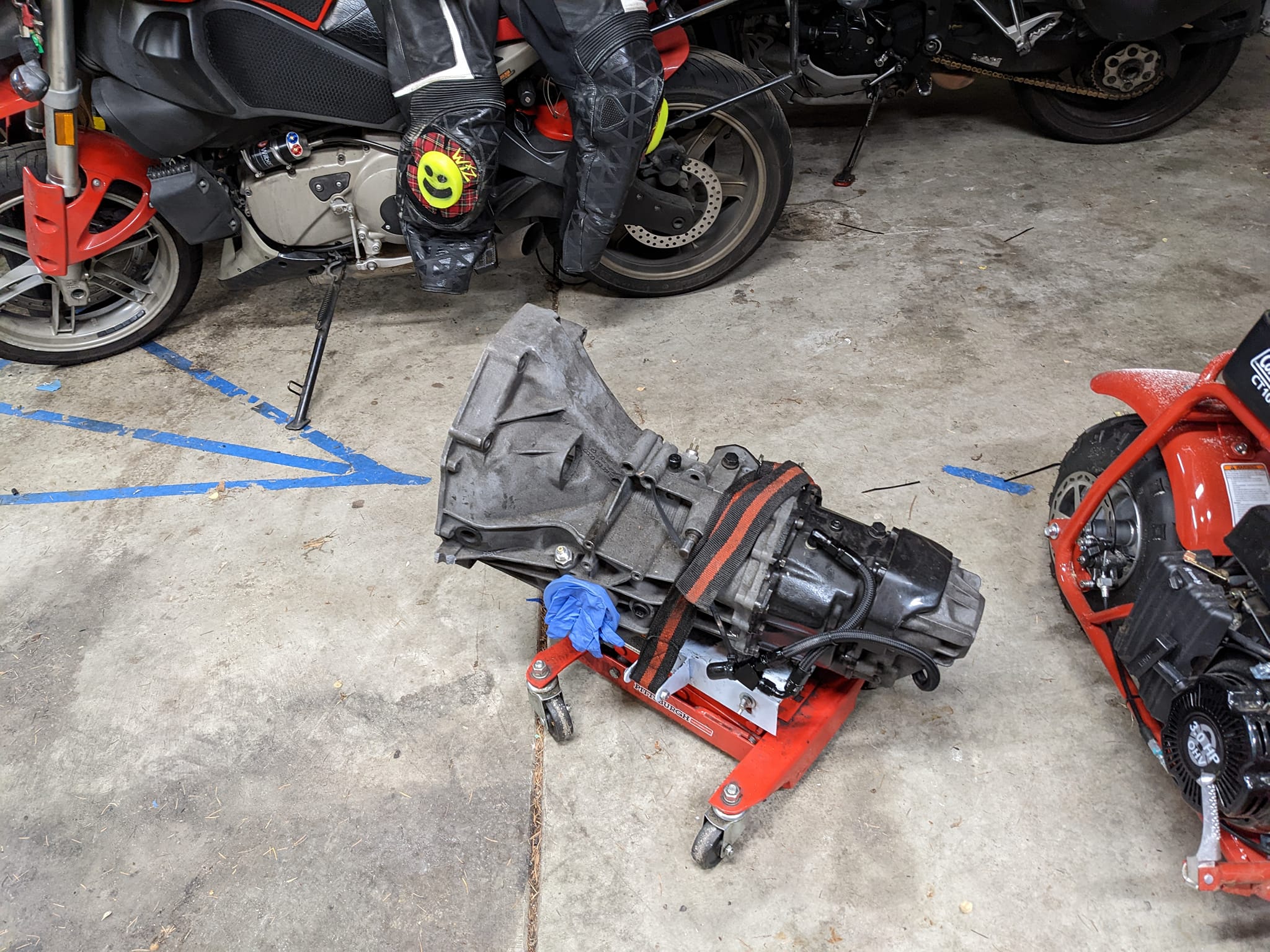

My new (to me) AOR showed up today :)

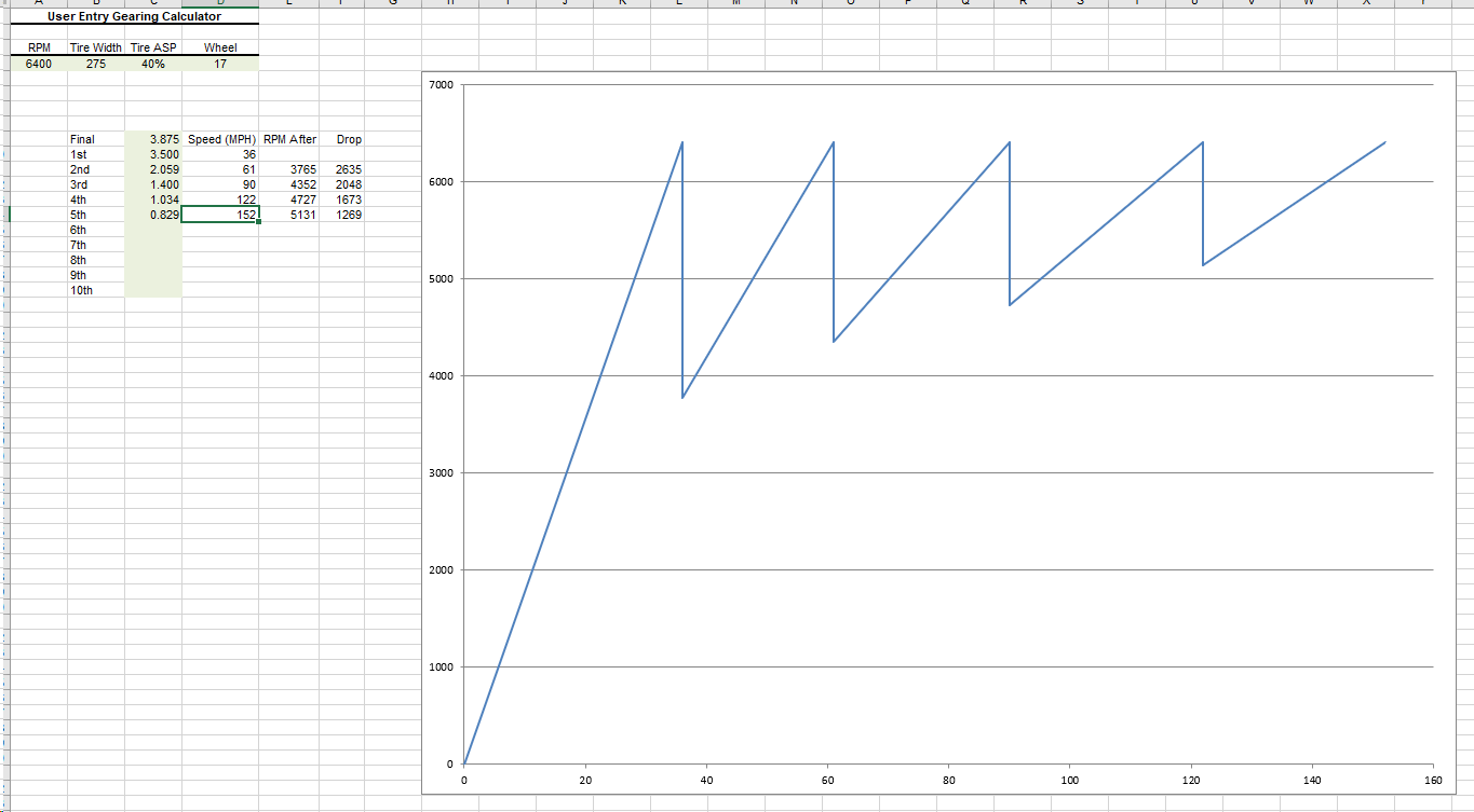

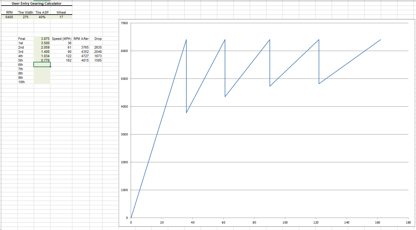

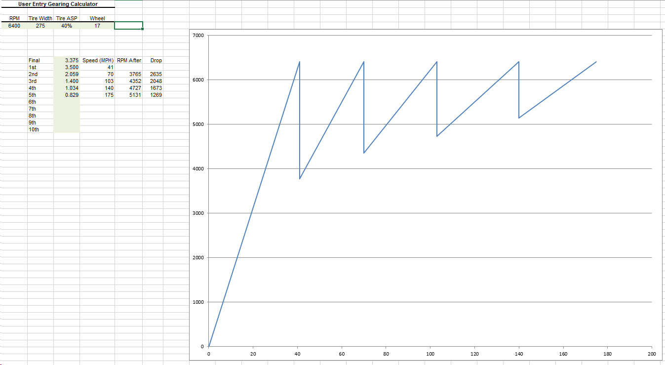

The AOT (S2) ring and pinion is a shorter final drive of 3.875 vs the AOR (Turbo) final drive of 3.375. Basically trading some of the top end for acceleration. The S2 does have a taller 5th gear, so I'll be revving slightly higher on the highway but I think it'll be worth it.
Turbo transaxle with standard final drive Turbo transaxle with S2 ring and pinion S2 Transaxle with standard final drive

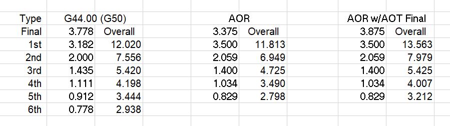

I'm going a different route that should yield comparable results. I'm getting a 968 6MT (G50 Differential), which has the following ratios compared to the standard AOR and AOR with AOT Final: The trans I'm getting has the M220 option with Torsen differential, but I'll probably have the Torsen pulled and replaced with a Wavetrac torque-biasing diff (have two of them in my A4, which I like a lot), or bite the bullet on the Guard GT2 Pro G50 ($$$).crackership wrote: Thu Nov 10, 2022 9:27 pmThe AOT (S2) ring and pinion is a shorter final drive of 3.875 vs the AOR (Turbo) final drive of 3.375. Basically trading some of the top end for acceleration. The S2 does have a taller 5th gear, so I'll be revving slightly higher on the highway but I think it'll be worth it.

BTW, I downloaded a gear ratio spreadsheet from GBox and if I plug in your 17" tire specs, I get the exact same results you posted.
