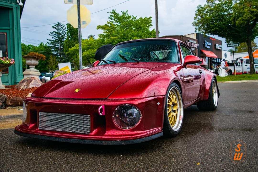

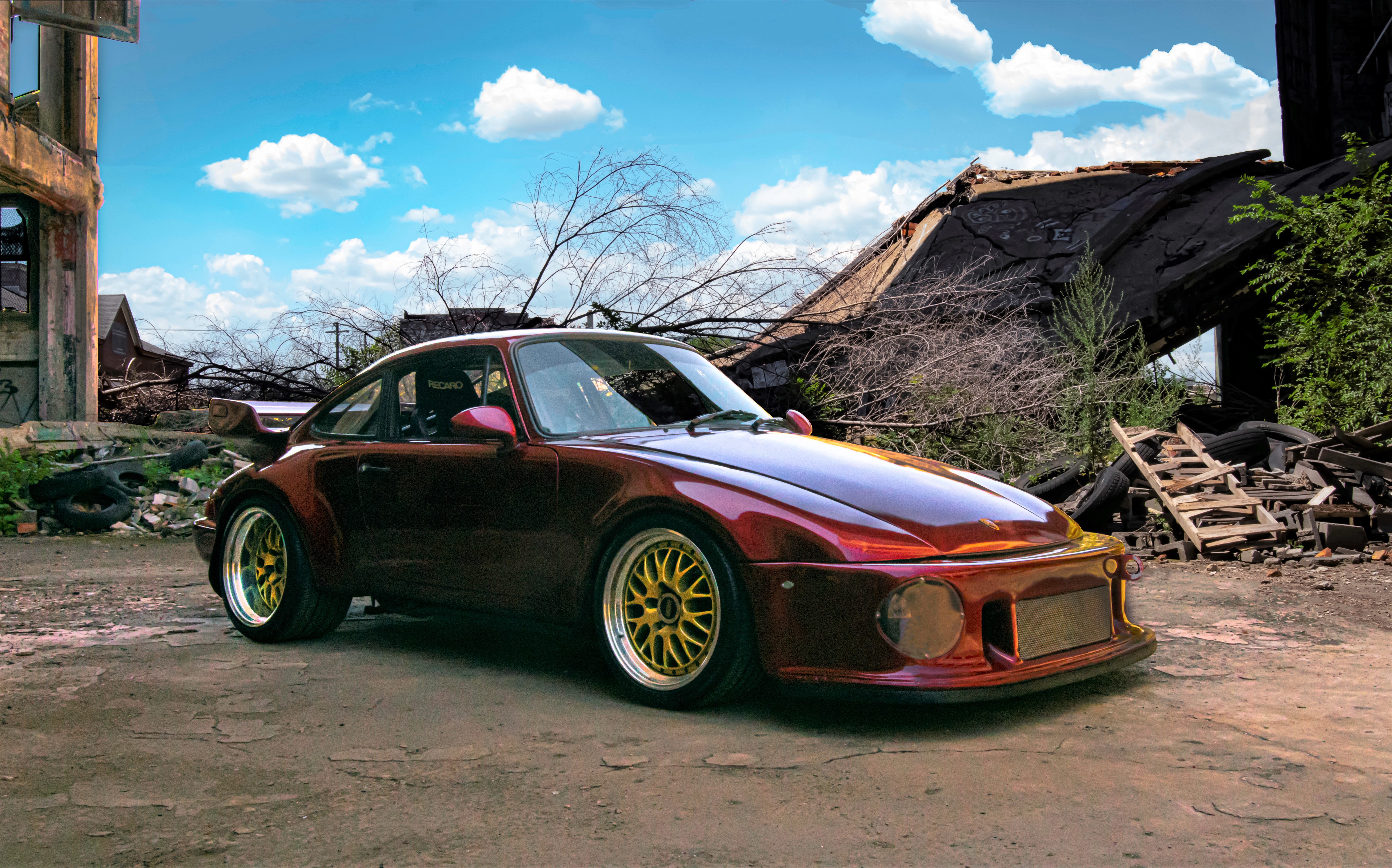

This car is a two-owner effort. The first owner sought to recreate a 935 racing Flachbau. My effort has been to civilize the car for street use, while losing only minimum track capability. This car began life, like all 935's, as a 911 SC. It was initially stripped and triangulated, and then provided a new heart and lungs: A 3.6 liter dry sump rebuilt with Pauter rods, Porsche comp pistons, titanium valve train and more, plus a G50 five-speed transaxle upgraded with Albins ring & pinion and Guard LSD, a Kennedy clutch pack, lightened Patrick flywheel, Hargett shifter and much more. The sunroof was deleted in favor of a lightweight fiberglass GT Racing roof panel. The rear seat was deleted and a Safety Devices super-touring roll cage with low removable sidebars installed. Off went the front clip, in favor of a Rennspeed 935 executed in carbon fiber and fiberglass, and sporting bumper-mounted headlights like the originals. The rear clip was similarily excised, and replaced with Turbo 930 quarterpanels, Rennspeed fiberglass Turbo 930 / 3.8 RS 993 decklid and “tea-tray” spoiler. BBS Gold alloy wheels in 18" x 9 and 11" were fitted, along with Michelin Sport 2 tires. The front torsion bar suspension was replaced with a Tarrett 935 coilover setup, and the front seats replaced with Recaro Profi's. In place of the widowmaker turbo, a TPC supercharger was fitted, with linear throttle response the result. The list of further modifications goes on for pages. I evantually nominated the car "FLAKBAU", as only 7 characters fit on Michigan plates. Comments and discussion???
Following are some of the best pix:
My 935 tribute
- Flakbau
- Posts: 36
- Joined: Sat Oct 22, 2022 9:43 pm
- Location: Shelby Twp, MI 48315
- Has thanked: 7 times
- Been thanked: 22 times
- Eyes on Design concours July 2022 BEST.jpg (3.17 MiB) Viewed 1823 times
- my porsche @ the 100 yr old packard plant ruins, blue skys BEST SHOT FULL FILE SZ LIGHTENED.jpg (4.81 MiB) Viewed 1823 times
- my porsche @ the 2022 Woddward Cruise BEST SHOT (1).jpg (118.11 KiB) Viewed 1823 times
- my porsche @ the 100 yr old packard plant in detroit (3) - edited by bak - CROPPED, LIGHTENED.jpg (314.23 KiB) Viewed 1823 times

As for the 935 tribute, it's spectacular. Both the color and the rear spoiler give it a bit of a 993 vibe -- is that Arena Red from the 993 Turbo? Would love to see build pictures and hear more about the motor. 3.6 from a 964+ car or did it start life as a 911SC motor? Engine management? Details on the supercharger? I'm a boost junkie, and love conversions from n/a motors that actually work!

As for the color, the car started life as a Wine Red Metallic 1982 911SC. The paint was "tweaked" by Auto Associates of Canton, Inc (Canton, Connecticut) to inject just a bit more pizzazz into the new and improved slope nose configuration.
The engine upon which the supercharger was installed was a 964 3.6 liter twin plug version.

The precise color chosen to tweak the Porsche wine red (aka Weinrotmetallic, Paint Code # 895) was very similar, but with the additional “pop” noted by Barry: Chrysler PRP “Deep Cherry Red Crystal”. The Chrysler color contains more metallic and deeper cherry than Porsche “Wine Red”. The Porsche paint has less metal and more purple and black pigments. For anyone interested, I have ATTACHED the history and build journal for Flakbau.

The color is Chrysler Deep Cherry Red Crystal, which was chosen by Barry (the car's first developer) because it is close to the original Porsche Wine Red, but with spicier metallic and a bit more pop (I've nicknamed it "Adult Candy Apple Red"). The shape of the car's exterior most closely resembles the second generation 935's, before Gen 3 and the ultra-wide rear featuring steamroller 14" rubber and extended kammback (see the middle car in the accompanying image). The later look is neither as pretty nor as practical as Gen Two. Like most of the privateer 935 builds, my car is fitted with later-issue heart and lungs. The motor is a performance-built dry-sump twin-plug 3.6 liter, and the transaxle is a built Getrag G50 5-speed, with ratios adjusted to provide a tick over 30 mph per gear. That's one shift to 60 - right where you want it. The Turbo 930's nom de guerre was "Widow Maker", because of wicked turbo lag that often resulted in uncontrollable spins. Thus, Barry opted for a Gen 3 TPC supercharger, transforming the horsepower graph into a straight line and providing a veritably linear throttle. I added a water-to-air intercooler for additional power and cooler running. I am not certain if the engine was originally boosted or not - I will find out from Barry. The boost level is a modest 7 pounds tapering down to 5, as Barry's development criteria placed a high priority on component longevity.
