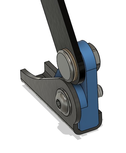

I developed/made my own... They can be installed without removing the seats, just undo/remove the front shoulder bolt and reposition the other way around with a couple of new bolts.
I have not seen any of the commercial ones in the flesh but assuming they work in the same way, I can confirm it makes a much more comfortable ride.
