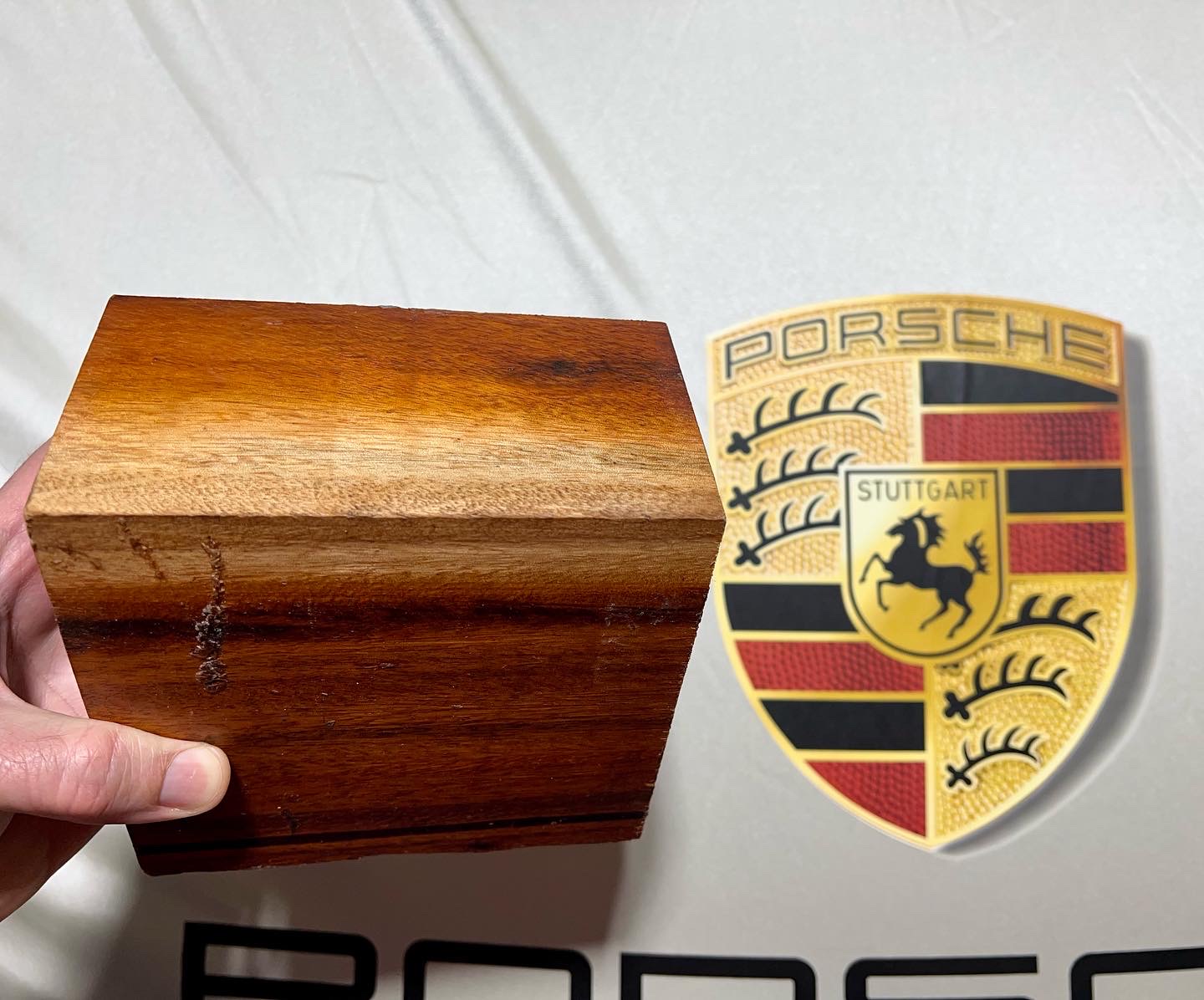

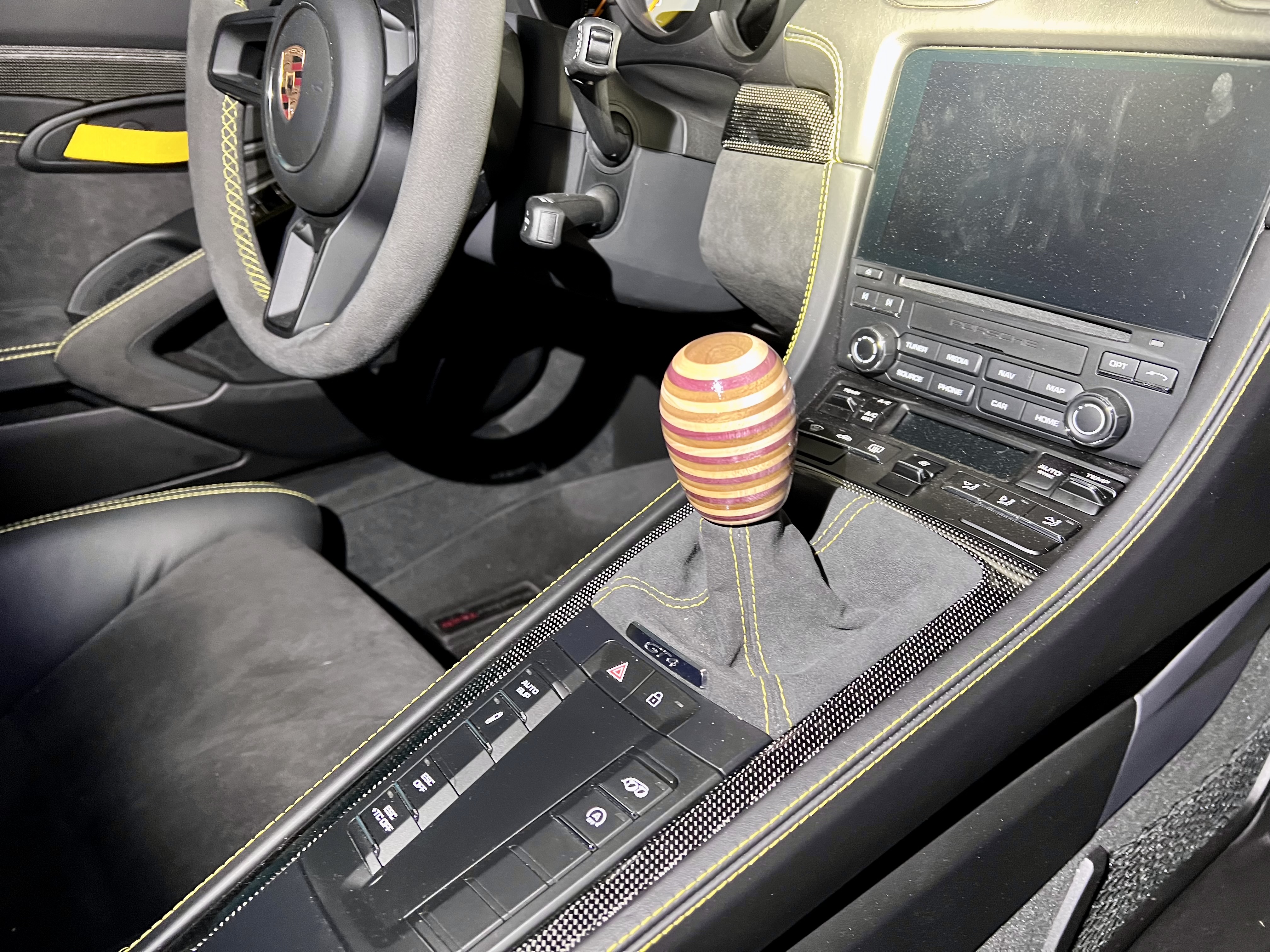

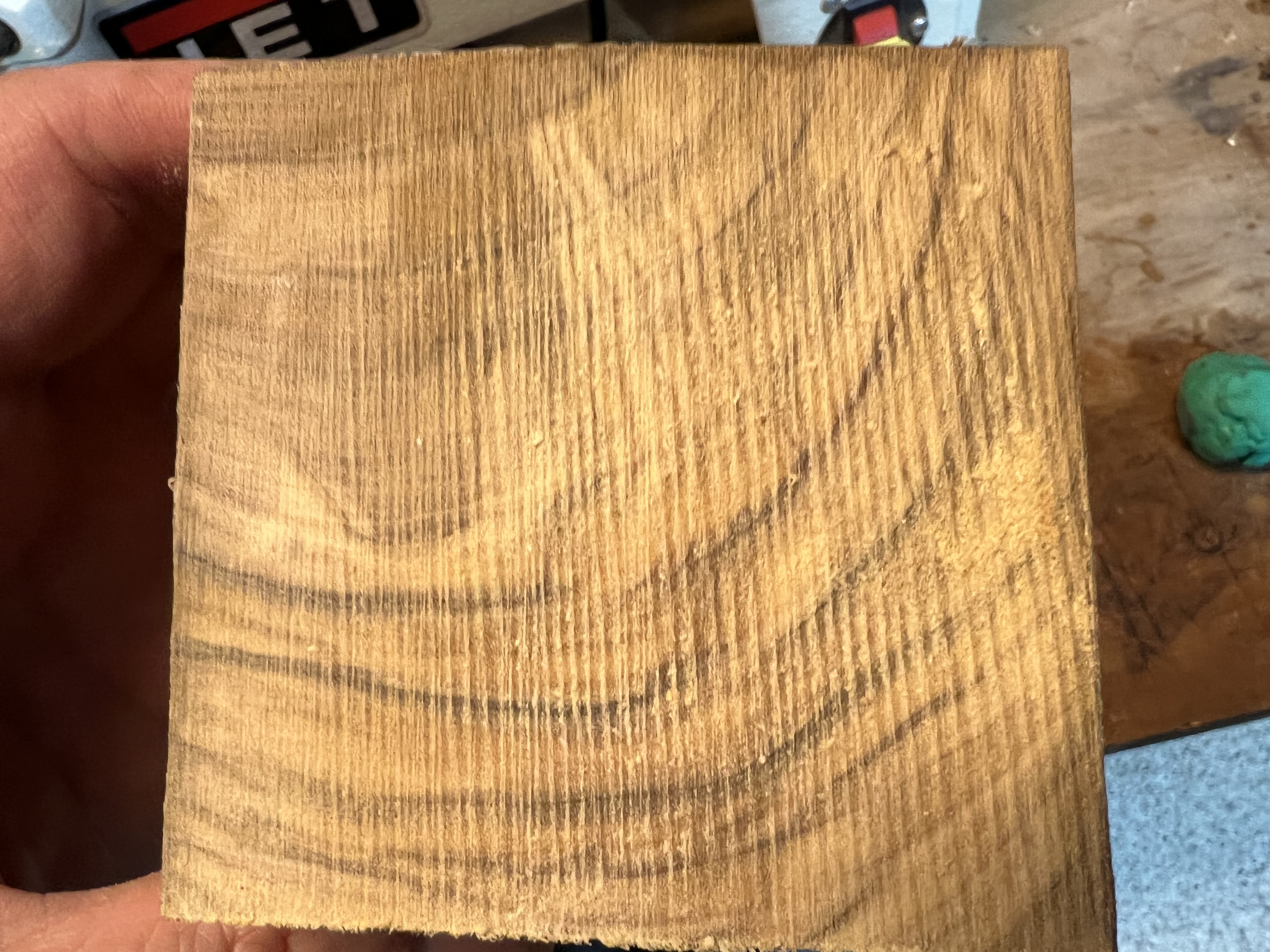

I wanted to make a new shift knob for my GT4. Something special as a dedication to my father.

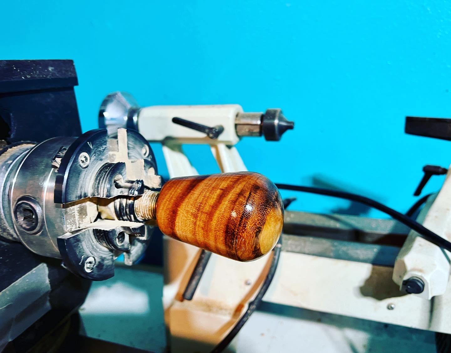

So I ordered a beautiful piece of Goncalo Alves and cranked up the wood lathe. I used the Raceseng shifter adapter which is 19mm fine thread. I drilled a 19mm hole in the wood for the adapter shaft. Then used a 32mm Forstner bit to make room for the 19mm nut. Little Epoxy and she was ready to be turned. I finished the wood in Odie's Oil since it has zero chemicals. I used two large rubber O rings to secure the boot on the adapter. It seems to hold really well and not damage the alcantara material.

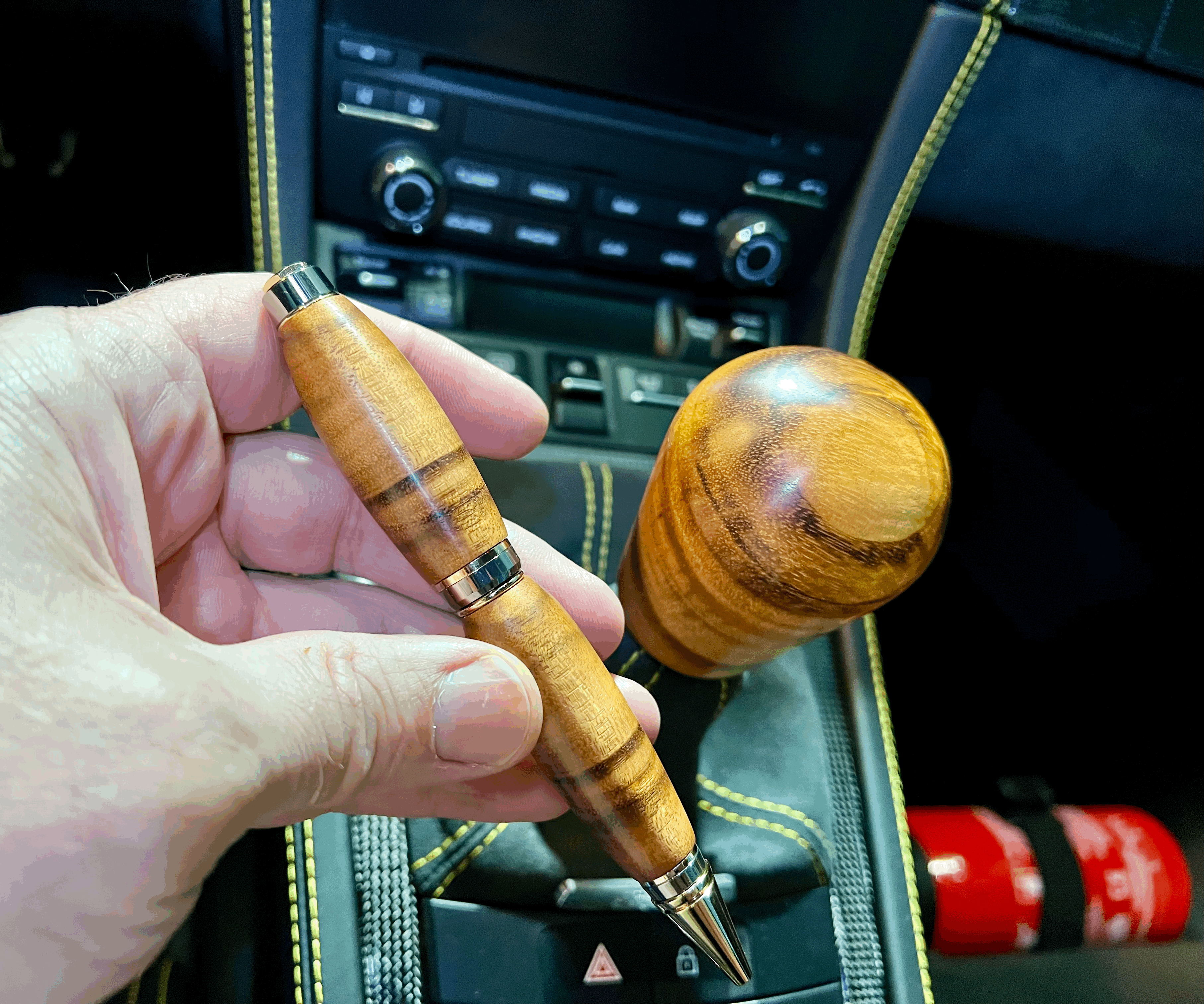

Little more weight and no plastic to mute the feeling when going through the gears. And the shift knob fits my Ape Hand really well!
It was a blast driving this car last night with the new shift knob.
The pen was made from the same piece of wood. Thought it was cool to have a pen to match my shifter.
Hope you enjoy the pics.
Brian
Posts: 8955
Has thanked: 936 times
Been thanked: 4018 times
Very nice! Kind of like the laminated 917 shifter, but a bit more elegant with the naturally layered wood. I must admit, I've never heard of Goncalo Alves...(aka Tigerwood per google), but it's a perfect choice for this.... I bet you could sell those if you wanted. :)

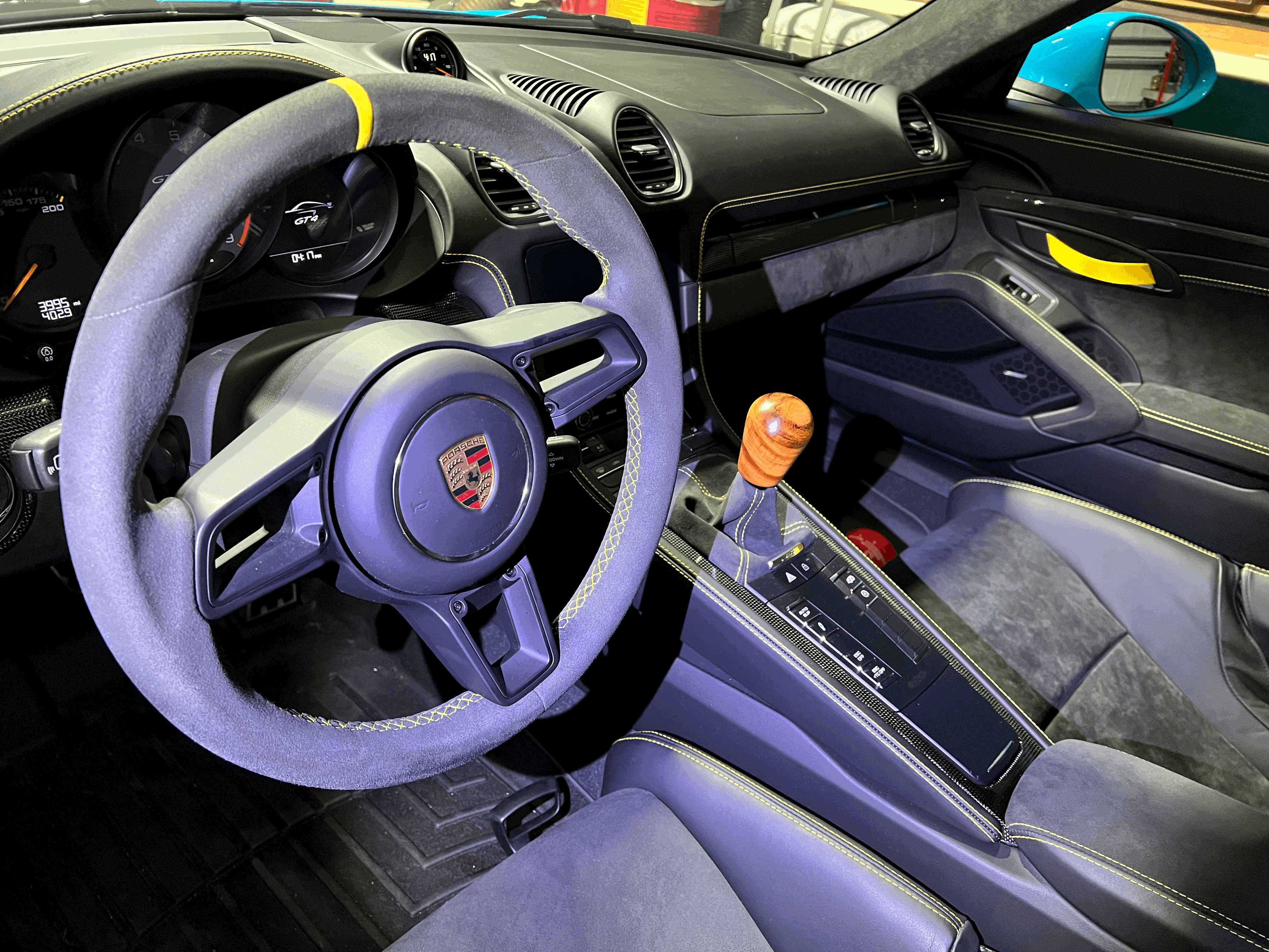

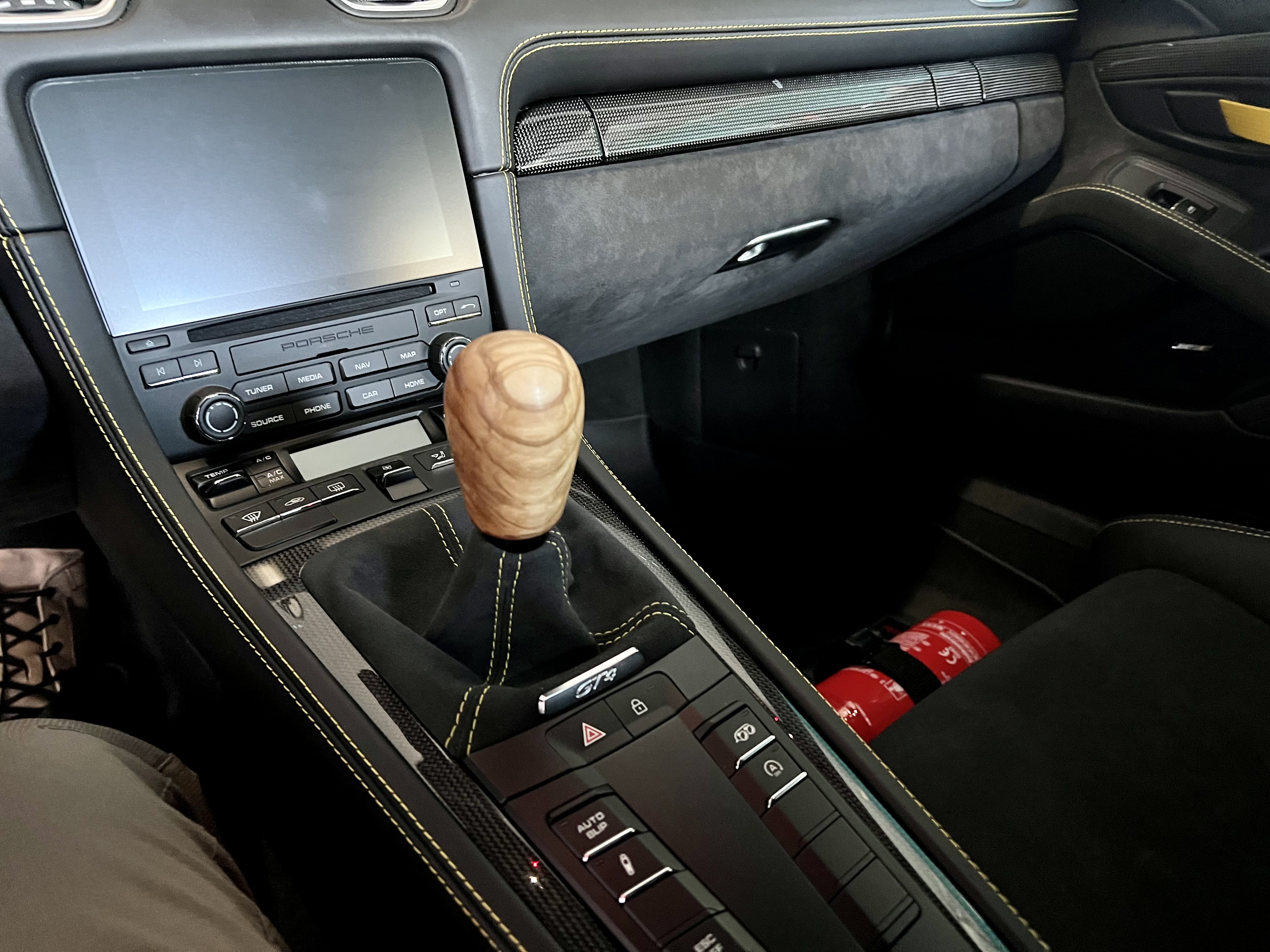

I found some pretty OliveWood to make a little smaller shift knob. Love turning OliveWood. My garage smelled like a restaurant.
I also lowered the mount a little for shorter throws.
Really pleased with this set up now.

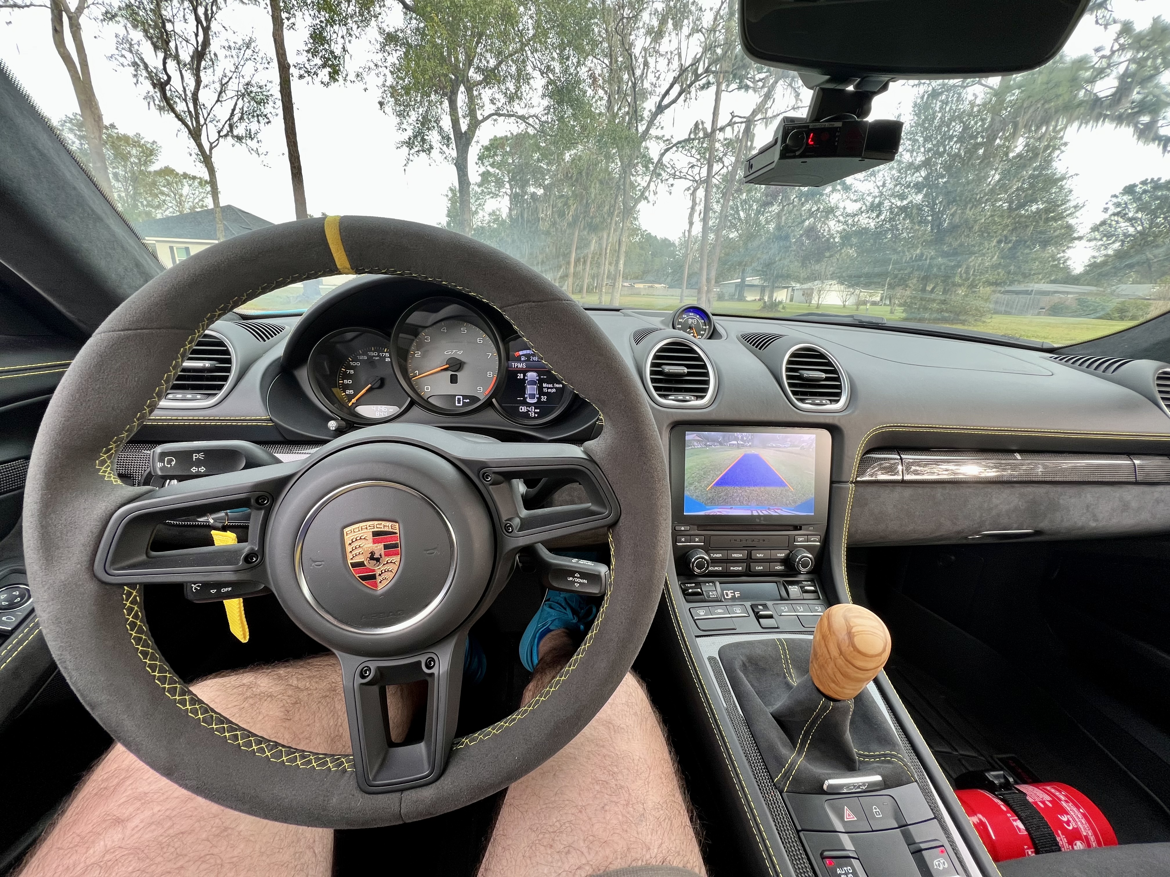

Making her a little different.

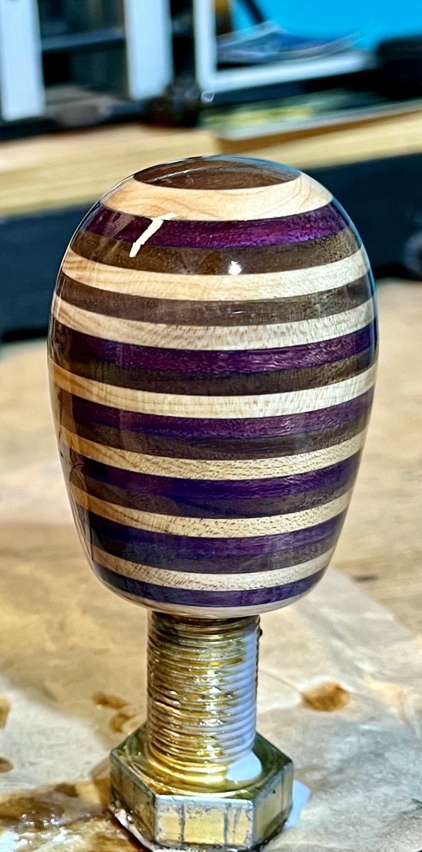

Still having fun making different shift knobs for my 4.
After Derek Bell signed my car at the Werks Reunion at Amelia, I decided to do a tribute to the 917 knob using Maple, Black Walnut and Purple Heart.

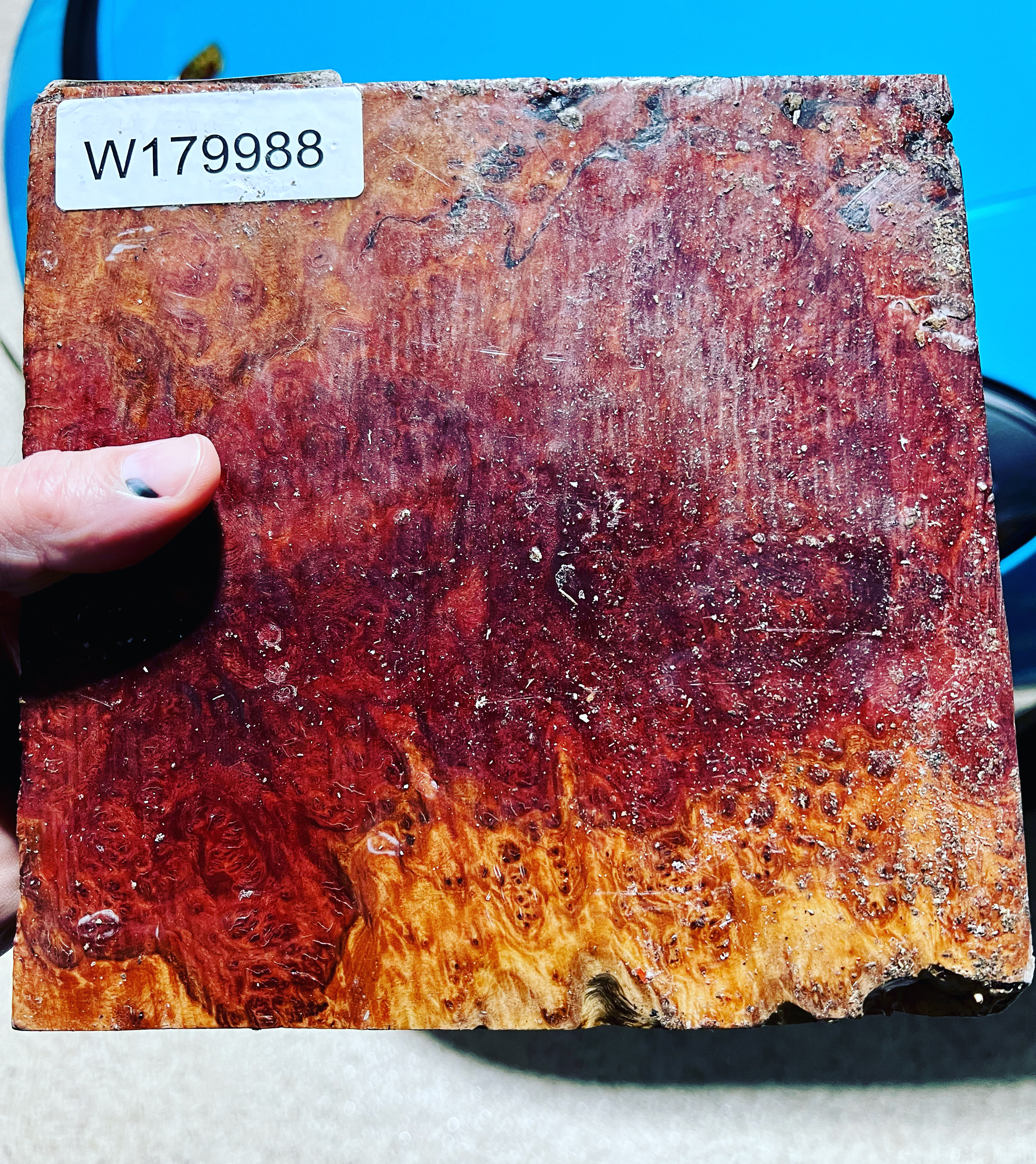

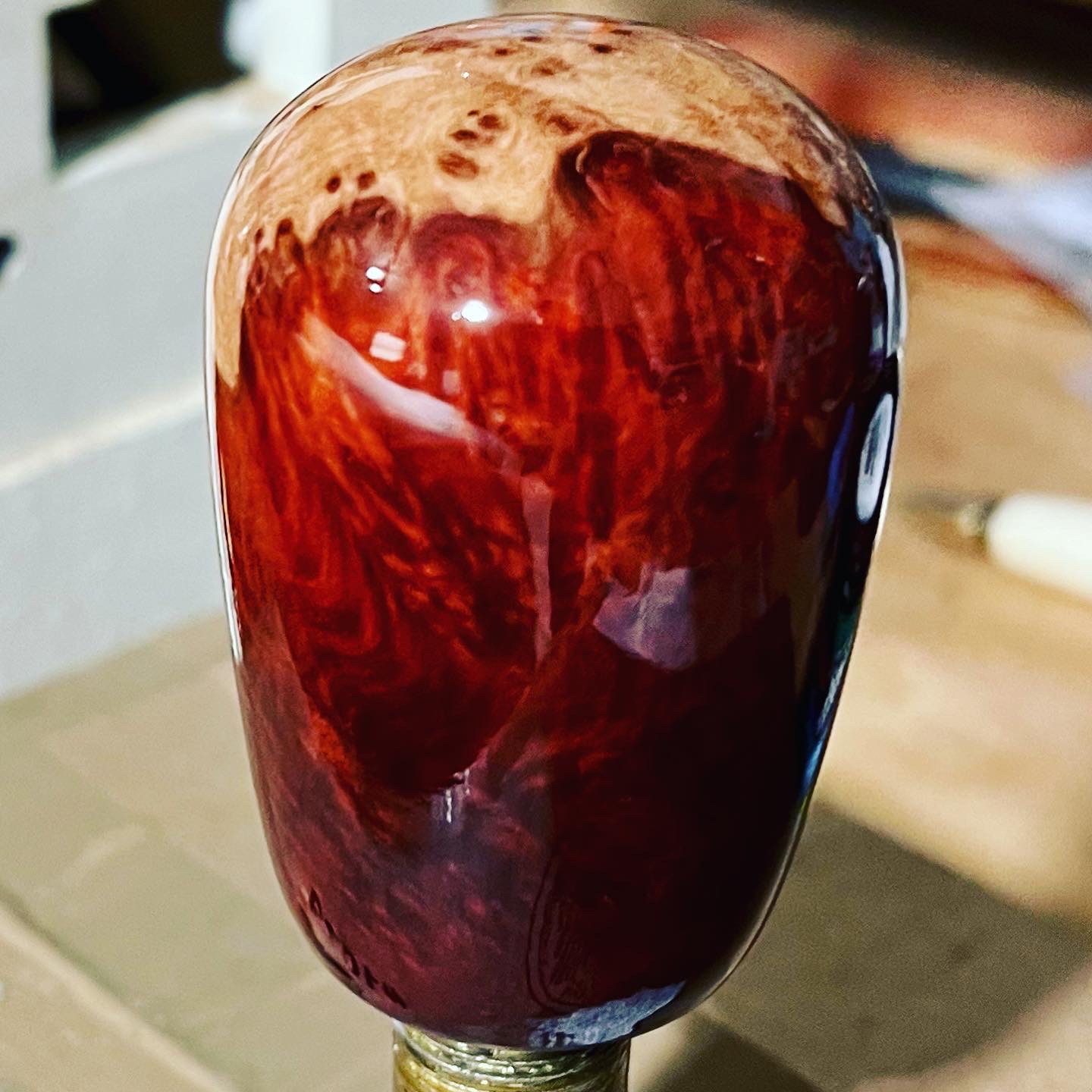

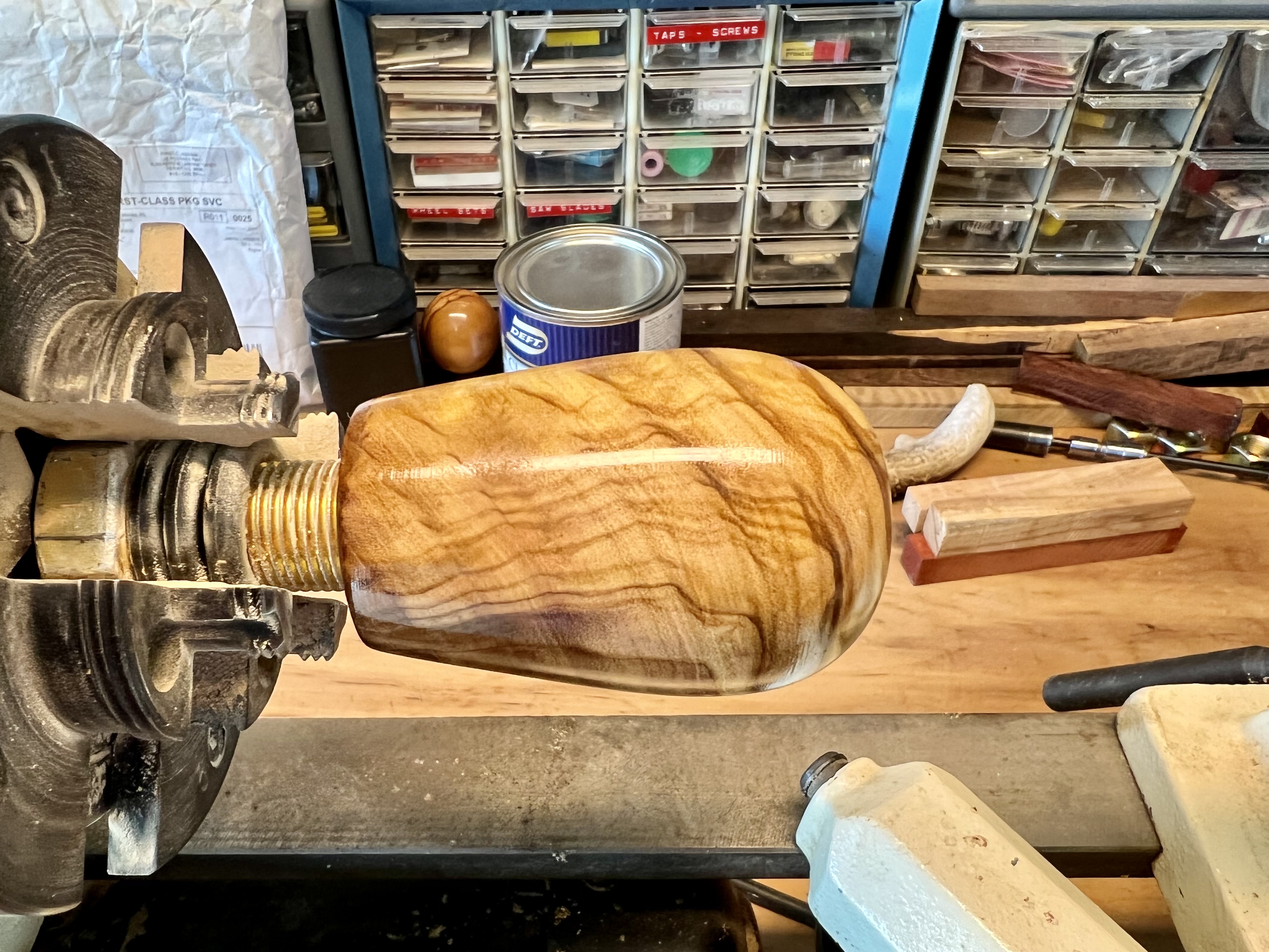

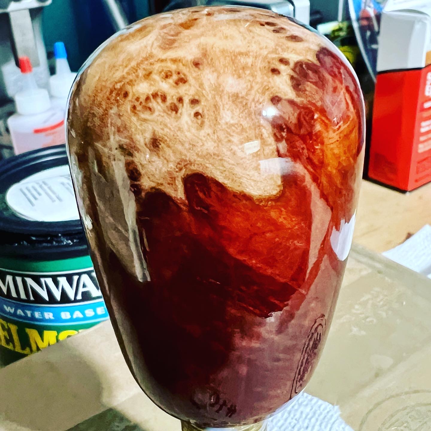

A few weeks later I found some beautiful Red Mallee Burl.
