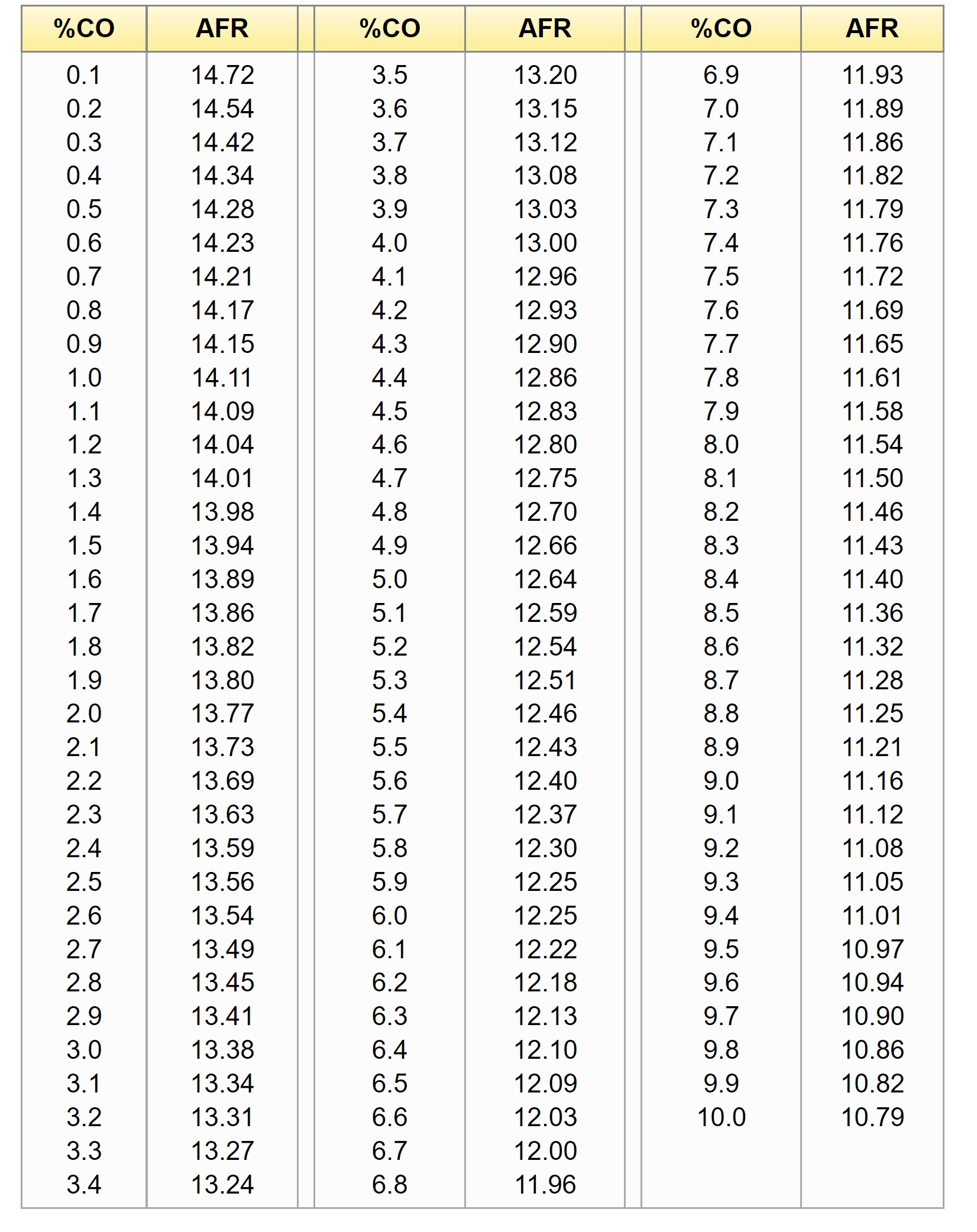

As some may know, I tend to obsess on CA smog and feel like I have a pretty good handle on getting the 951 to pass. Lately, I've been trying to get my old 450SL to pass (CIS, no computer), and came across some interesting data that was new to me. With our cars, a decent O2 sensor will keep the car very close to 14.7, so that part of the equation is fairly simple to nail down. On non-O2 cars, however, it can be more of a challenge. See, e.g.,
viewtopic.php?f=6&t=222
I never really knew how close to 14.7 you needed to be in order to keep the emissions within limits. I discovered with the old mercedes that the CO% goes up very fast in response to fairly small changes in the AFR. In CA, the car needs to have a CO of roughly .6 to .8% or lower to pass. See the chart below, but that means you need to be running about 14.3 or leaner in order to pass smog (although a fresh cat may help cheat those numbers a bit). That's a much narrower window of success than I realized, and means fresh O2 sensors, good grounds, etc. are all pretty important. Just FYI for those interested. :)
afr to copercent table.jpg (597.72 KiB) Viewed 2365 times

This chart is EXTREMELY useful. Thanks for all the help!
