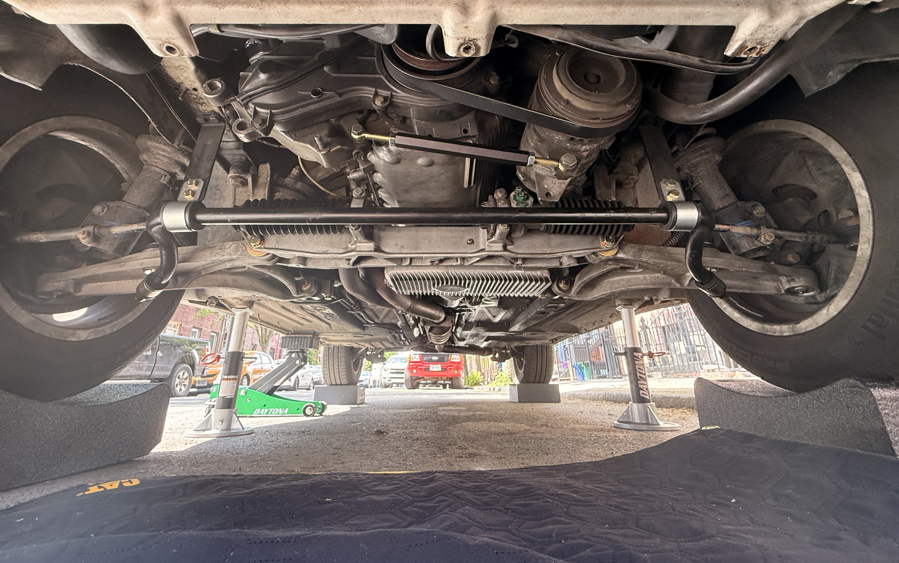

walfreyydo wrote: Fri May 08, 2026 5:51 am Your sway bar supports appear to be bent forward, you may consider repositioning them so they are perpendicular to the frame, as they are supposed to be. That may also provide you more clearance between that AC compressor and the bar...
I wondered that. From under the car they look perpendicular, but yeah, in the photos look bent forward. I actually ordered a pair of braces. Im going to try and straighten them when I install those.

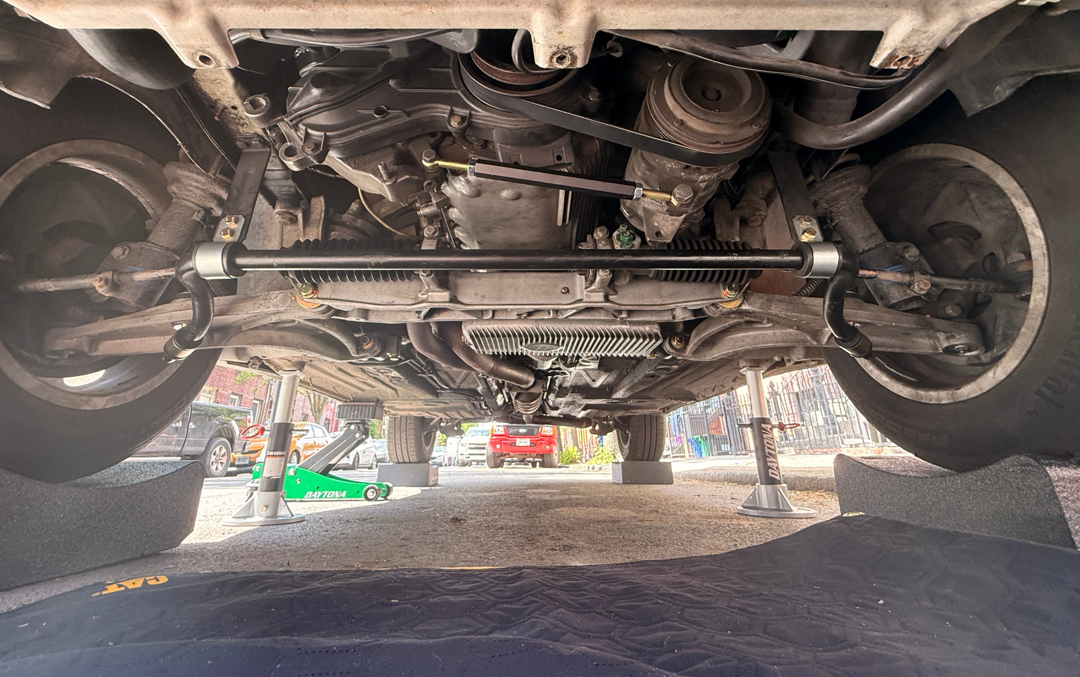

I think my front sway bar is upside down :lol:
Something looked off to me and I found this thread: viewtopic.php?t=2139
Looking at photos, I have it it wrong.

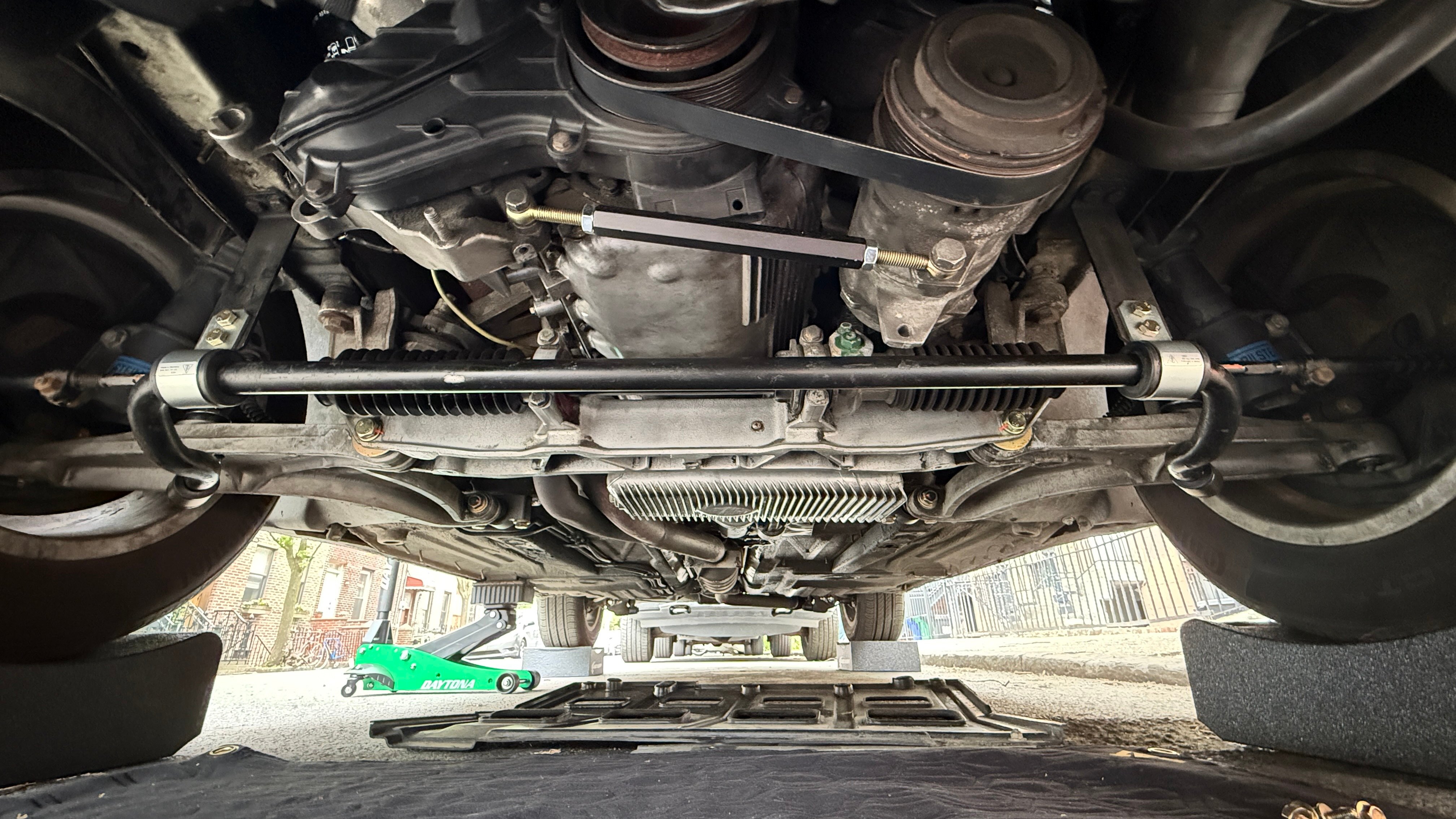

Oh yeah it was upside down. :shh:
Before
Rotated
