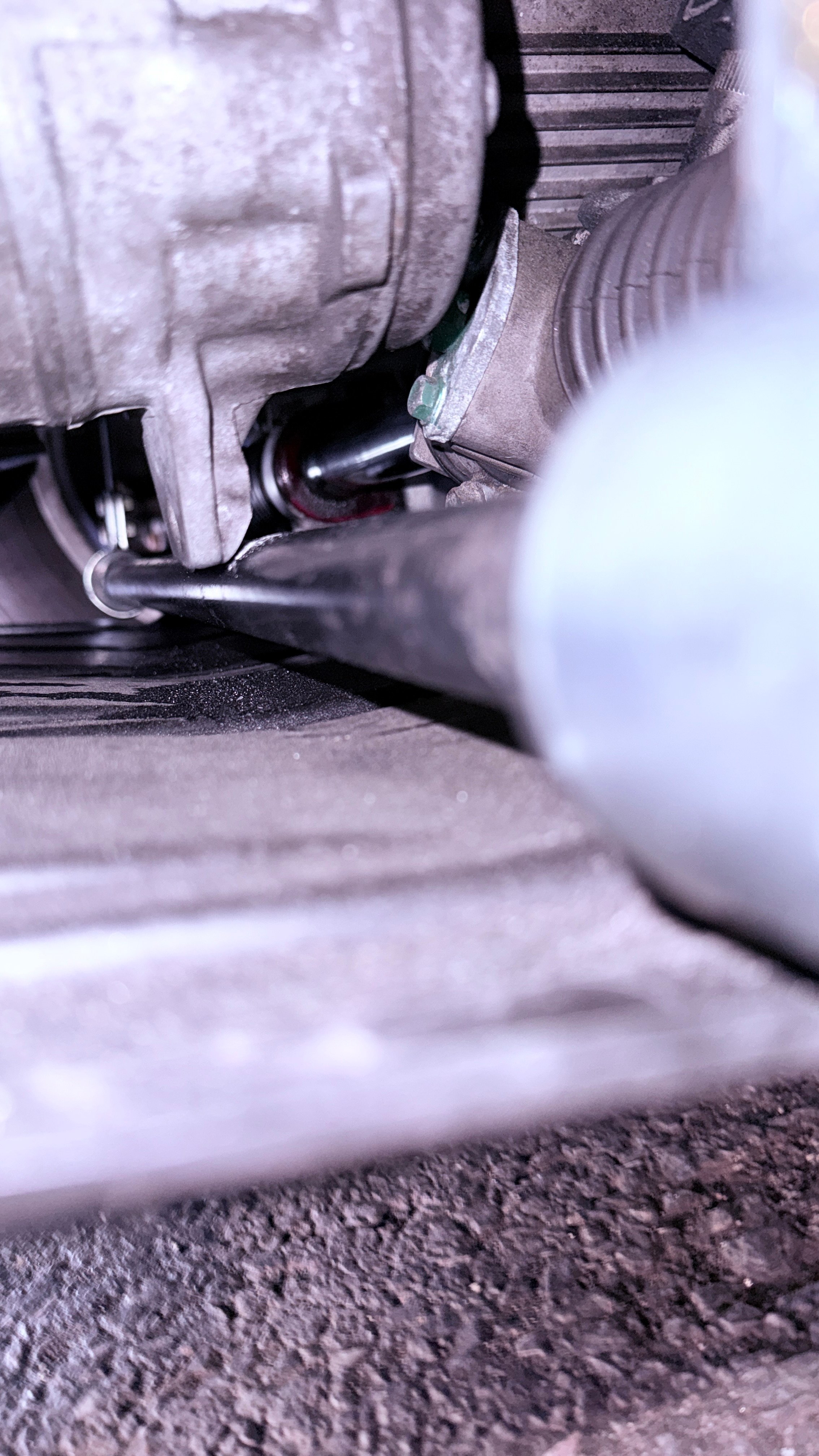

Crawled back under the car to remove the sway bar and remove some ear. Im not getting the vibration now, but its very interesting how much tolerance and gap exists at different points.
This was before removing some material, there is a very tiny gap, which wasnt there yesterday.

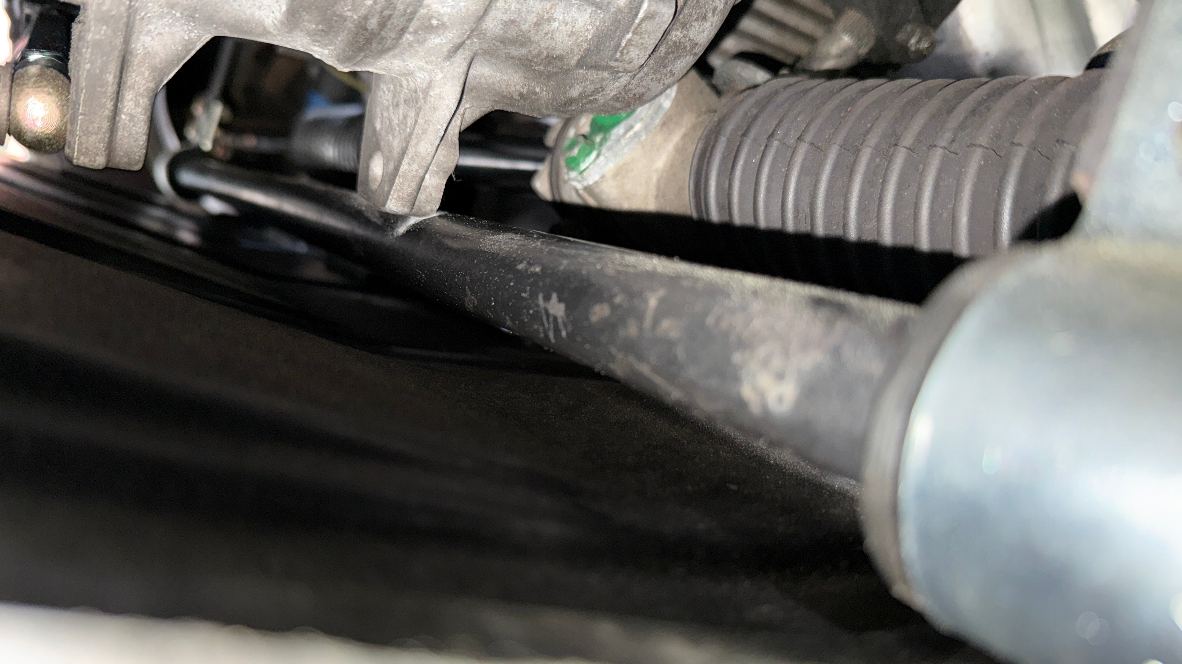

Material removed, much bigger gap. The car is on blocks, the suspension is loaded and level.

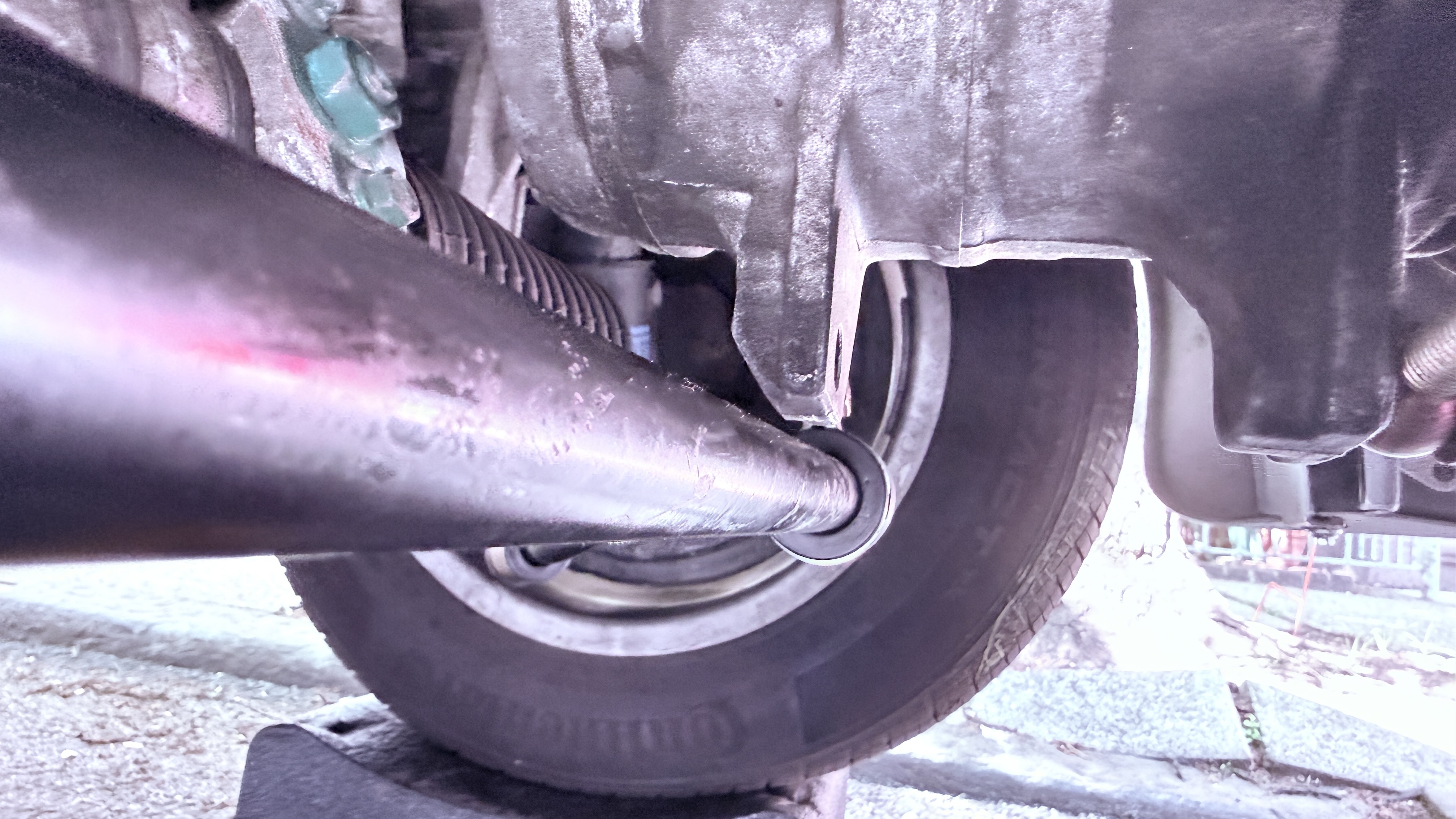

After a test drive, and the sway bar settling, much less gap.
Im not getting any of the vibration/chatter I was yesterday... so the redneck in me wants to call this "fawkin mint" until I swap the motor mounts... but the OCD in me wants remove more material lol.

Your sway bar supports appear to be bent forward, you may consider repositioning them so they are perpendicular to the frame, as they are supposed to be. That may also provide you more clearance between that AC compressor and the bar...
