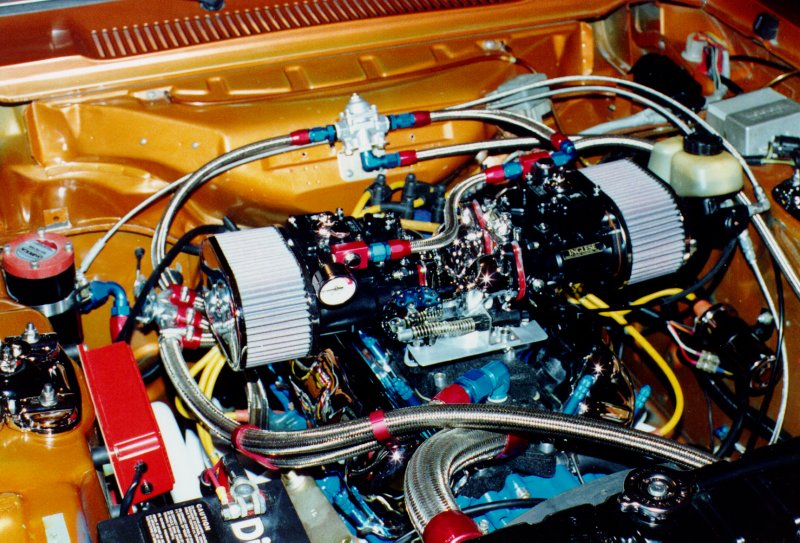

Just found this thread. Wow does this bring back memories. I owned a 1976 Capri II Ghia V-6. Everything about that car was highly modified. The engine ran a 2.9 crank and rods, so with the overbore was 3.0 liters. The cam was a pretty potent Isky with lots of overlap, so the idle was a bit "racy" ha, ha. The exhaust ran through hooker headers (still have them as a keepsake), dual CATs, and Borla mufflers. Carburation as shown was via a custom Inglese Inductions manifold adapter using Weber DCOEs, feeding an Offenhauser manifold. I still have the carb setup. Also shown is the remote Canton Mecca oil filter. Still have that too.
The throttle response with this setup was amazing and the engine would easily pull 7000 rpm and would probably go to 7500 if the tach went that high, LOL. MPG was pretty bad, maybe 15-18, but it was great fun.
Sadly, with all these engine mods the Capri had great difficulty passing WA smog, so it just sat outside, slowly deteriorating. After pulling off all the parts I wanted for keepsakes, it finally got towed away in 2008. Another keepsake I never got around to installing was a new aluminum waterpump; it's still in the box.
Regarding those cam gears... yes, they did have an issue with the early gears and many people, including me, changed to aluminum, but I eventually changed back to stock due to the recommendation of a Capri racing mechanic. It seems the aluminum gears are OK for normal street cars, but when used in racing, they can set up high rpm harmonics and also self-destruct.
Thanks for the memories, your Capri looks fantastic!
