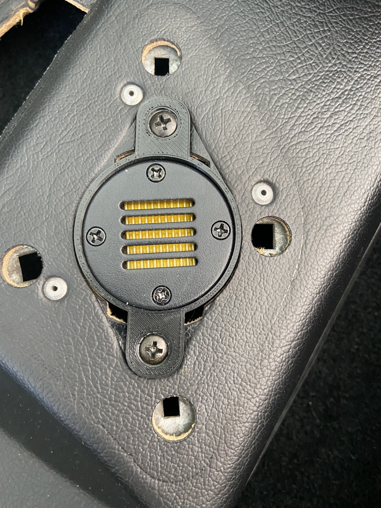

Tom, that’s insane! They look far better than anything I pictured when we first started this. A testament to your attention to detail, no doubt. I can’t wait to finally have a fully functional sound system again!

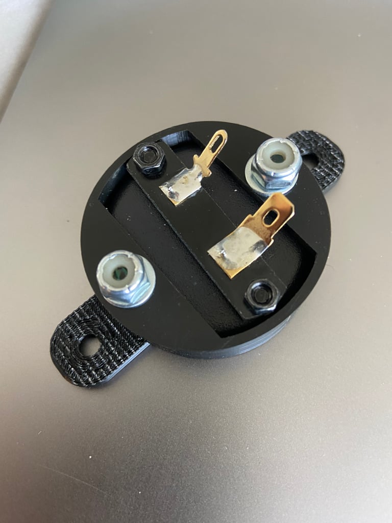

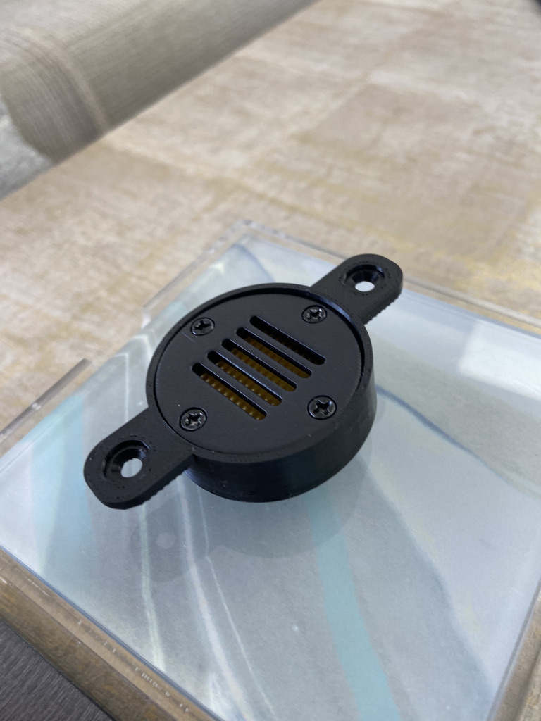

The fitment is absolutely perfect! The rear mounts are even better with the .5mm decreased width, and the fronts fit exactly like they are supposed to! My metal mounting plate is a little deformed from PO shenanigans, but it will work perfectly!!!!
I can’t thank you enough!!

That's awesome Darwin!!! Imagine if they had a 3D printer on Apollo 13! You'll have to post video of it playing some tweeter-intensive song when it's all buttoned up. I've been using the Formlab Pro Grey for other things lately too and am thinking it's plenty strong and heat resistant for most car parts. Once printed, it gets baked for 15 minutes at 176F, so it's oven tested to at least that. :)

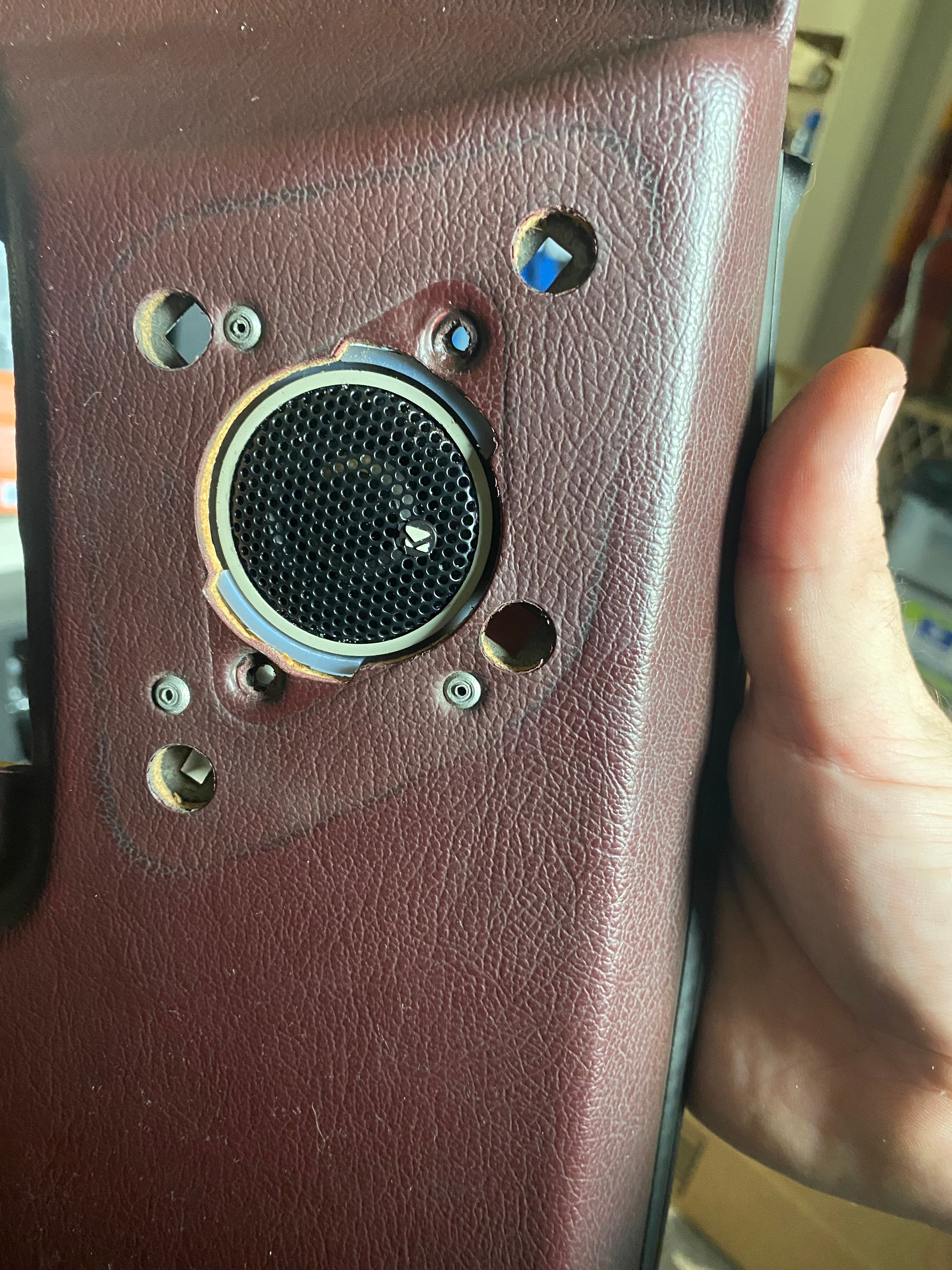

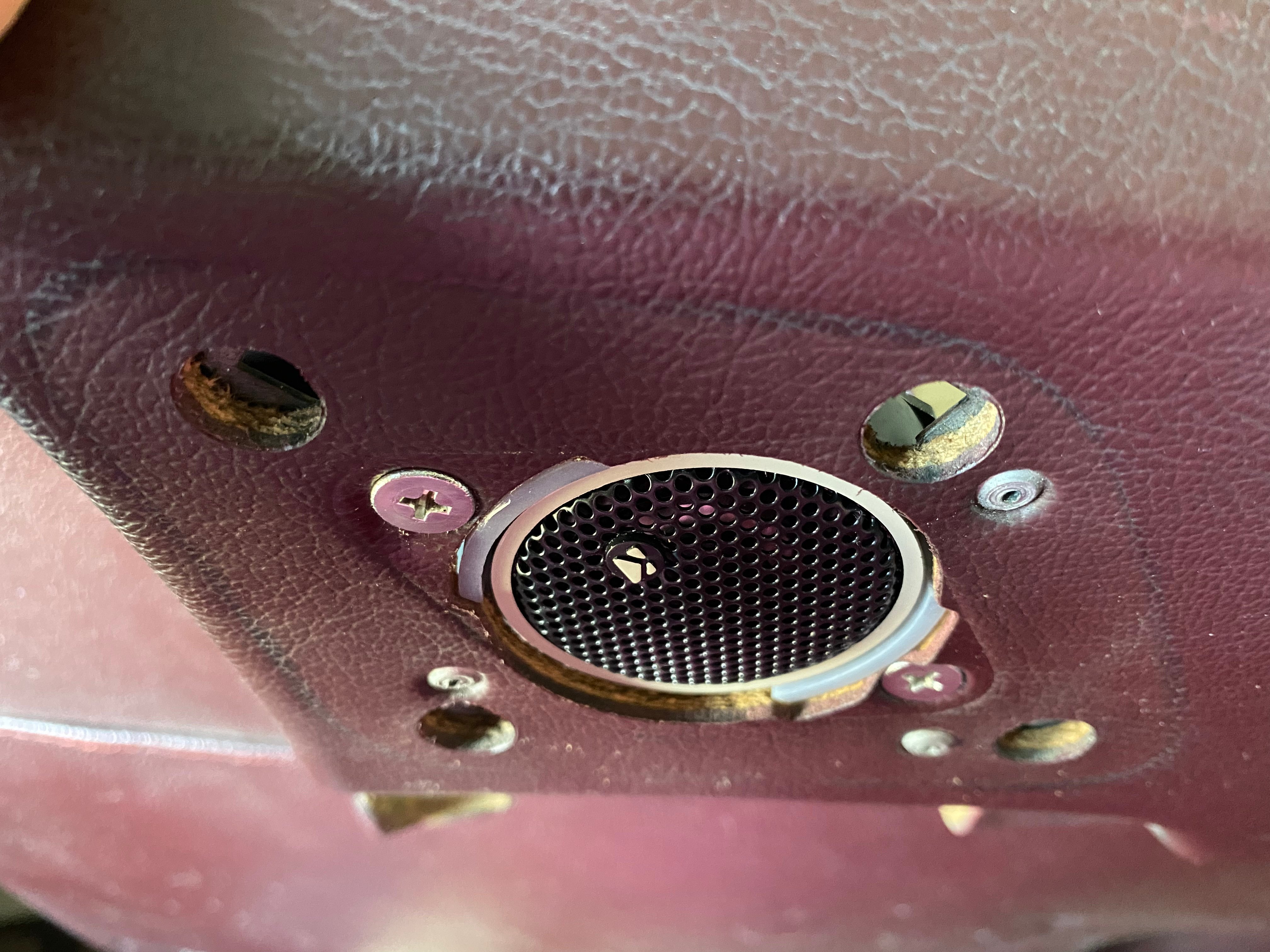

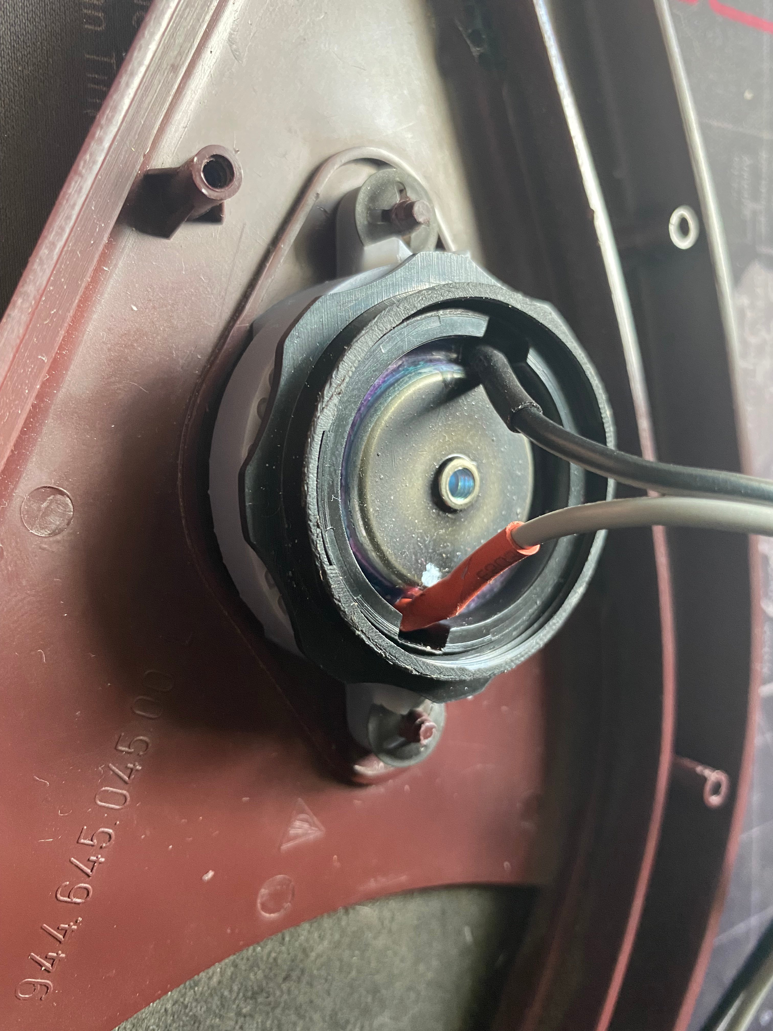

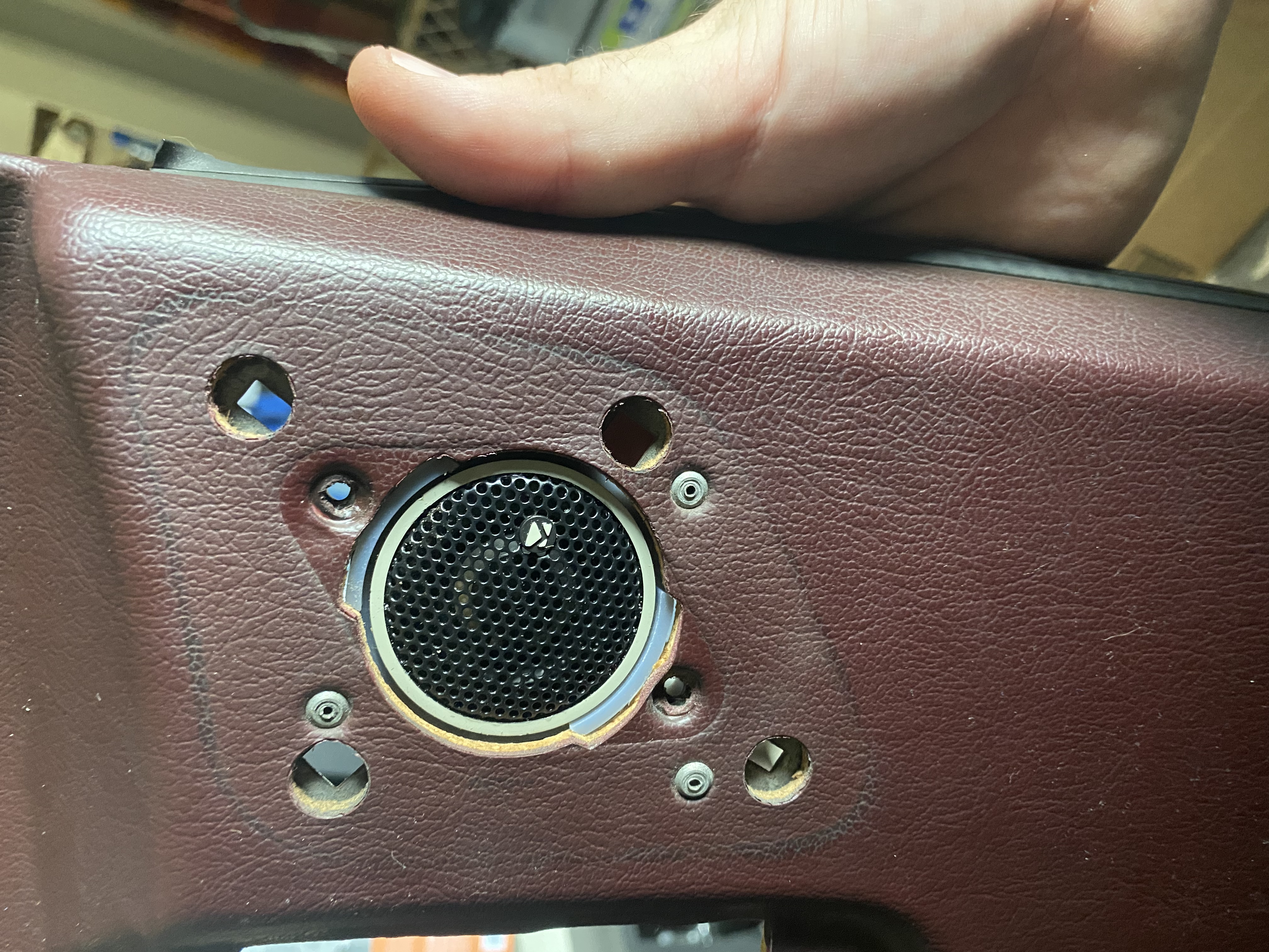

Finally got some time to start on tweeter mounting! The rear will be easy because I used existing hardware. For the front, I had to drill out the original mounting hole because it wasn’t designed for a bolt or screw to pass through.
