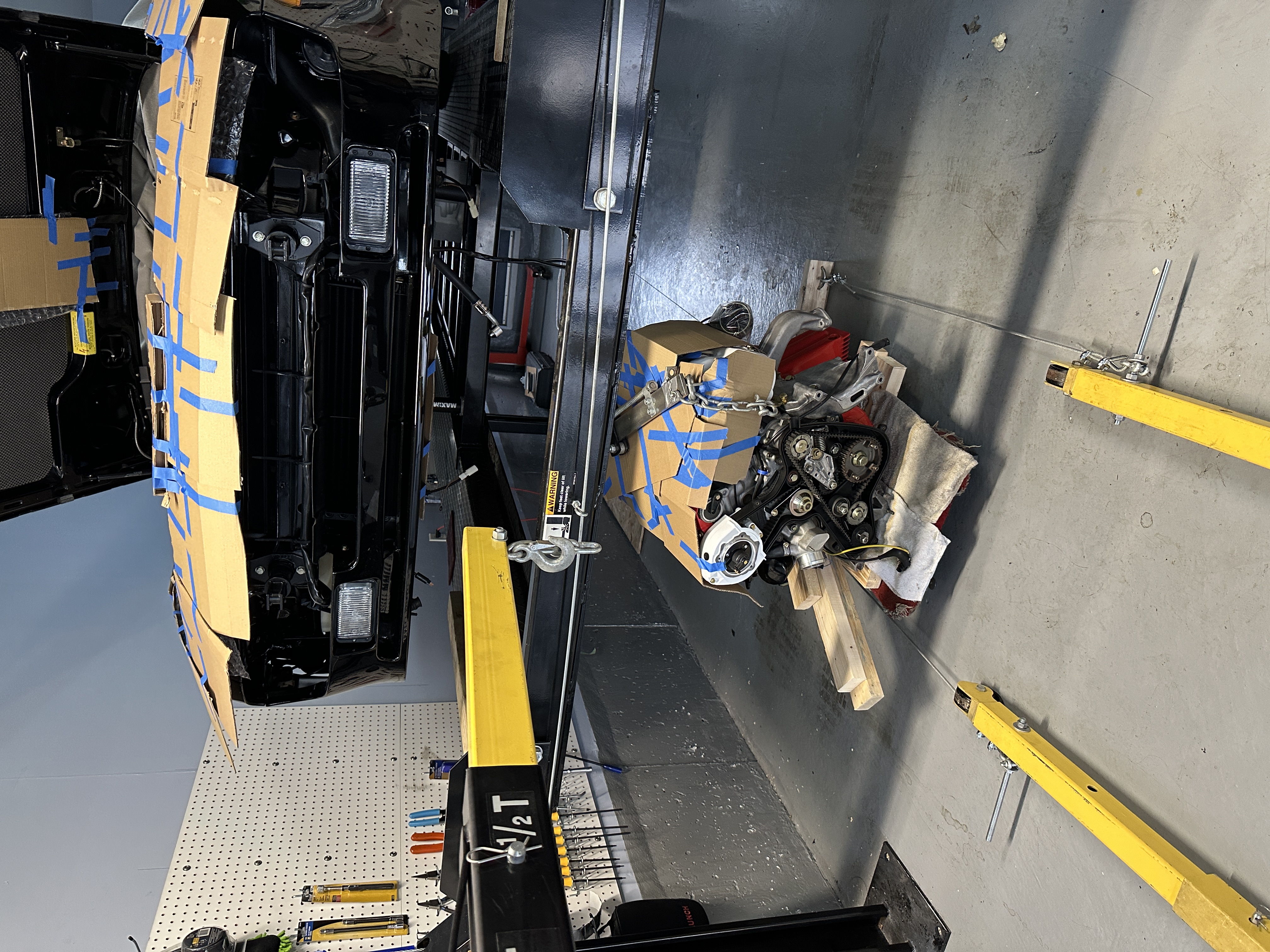

Got a cr*pton of preparatory work done over the weekend to get ready for the engine installation next week. The main items were finishing up the winch assembly for controlling the engine hoist (the garage floor has a lot of slope) and dismantling the wood “dance floor” I built around the car to allow me to work on it while it was up on the hoist.
It looks like everything is on track to put the engine in next weekend, which is a big milestone in my brain for some reason!

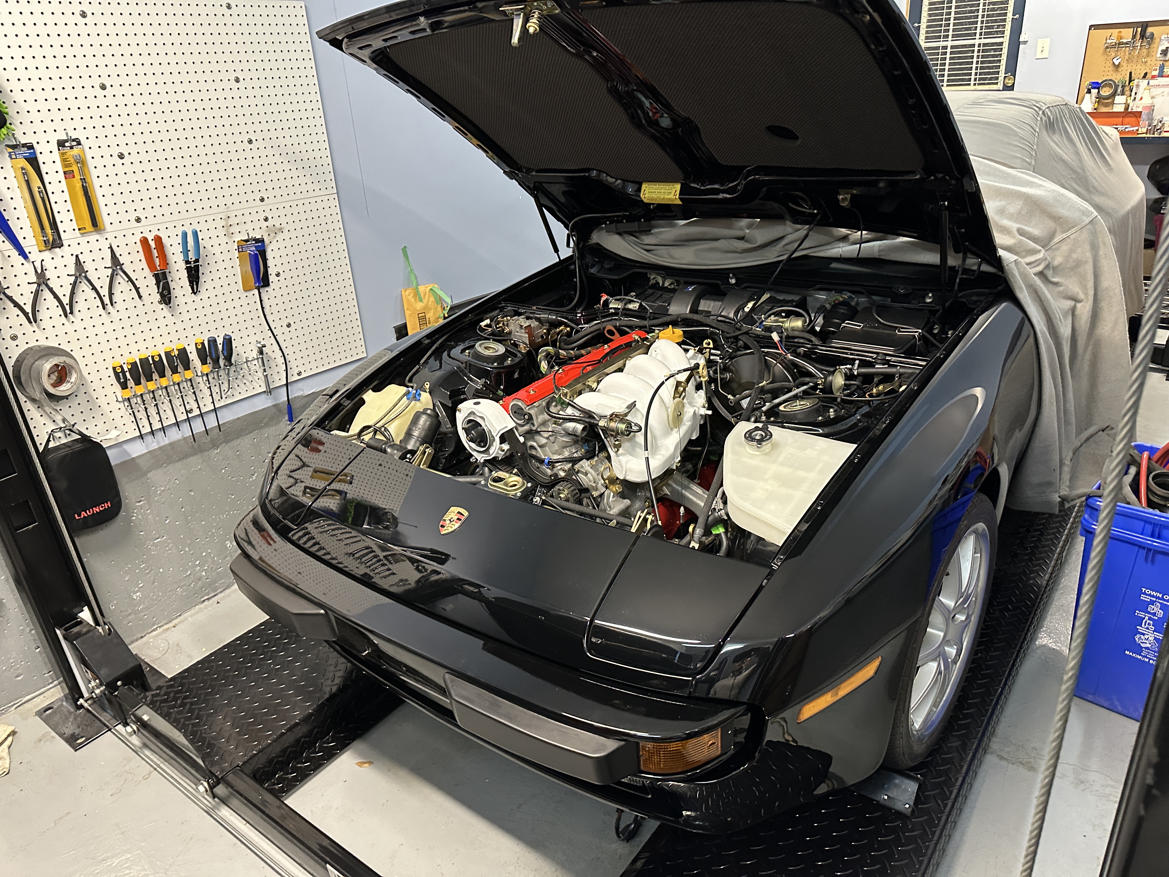

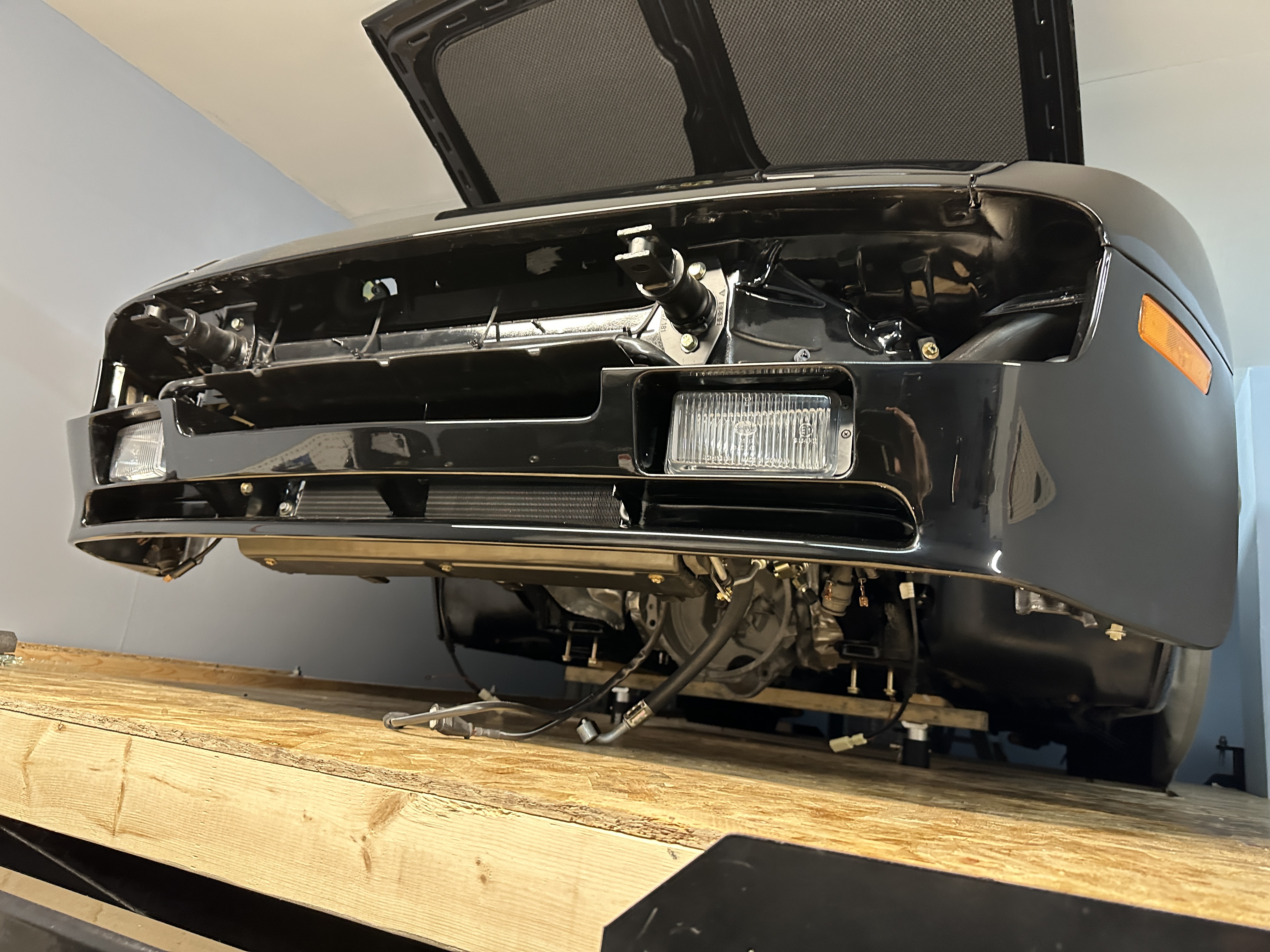

One thing I did manage to do on the actual car was put in the fog lights with new lenses and bulbs:

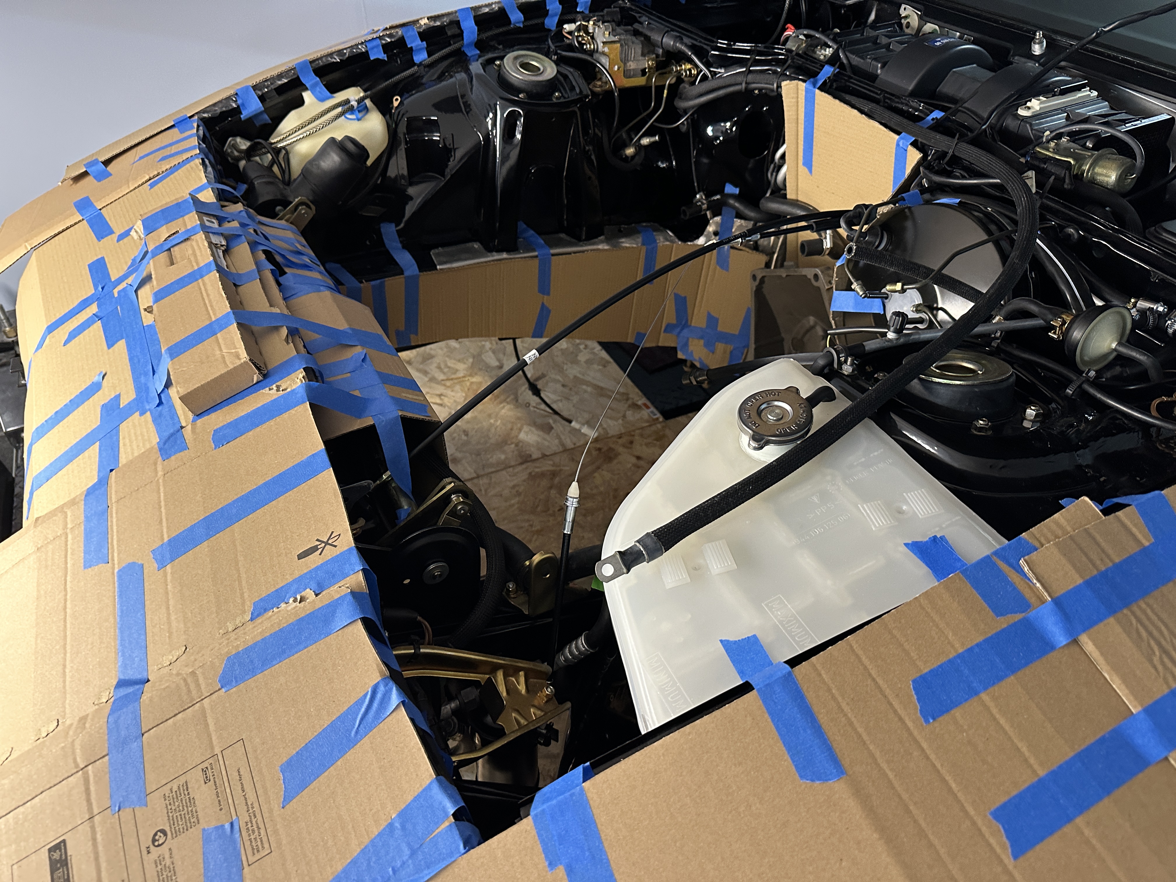

I also layered bubble wrap and scraps of cardboard over much of the engine bay and surround since there will be a lot going on during installation day.

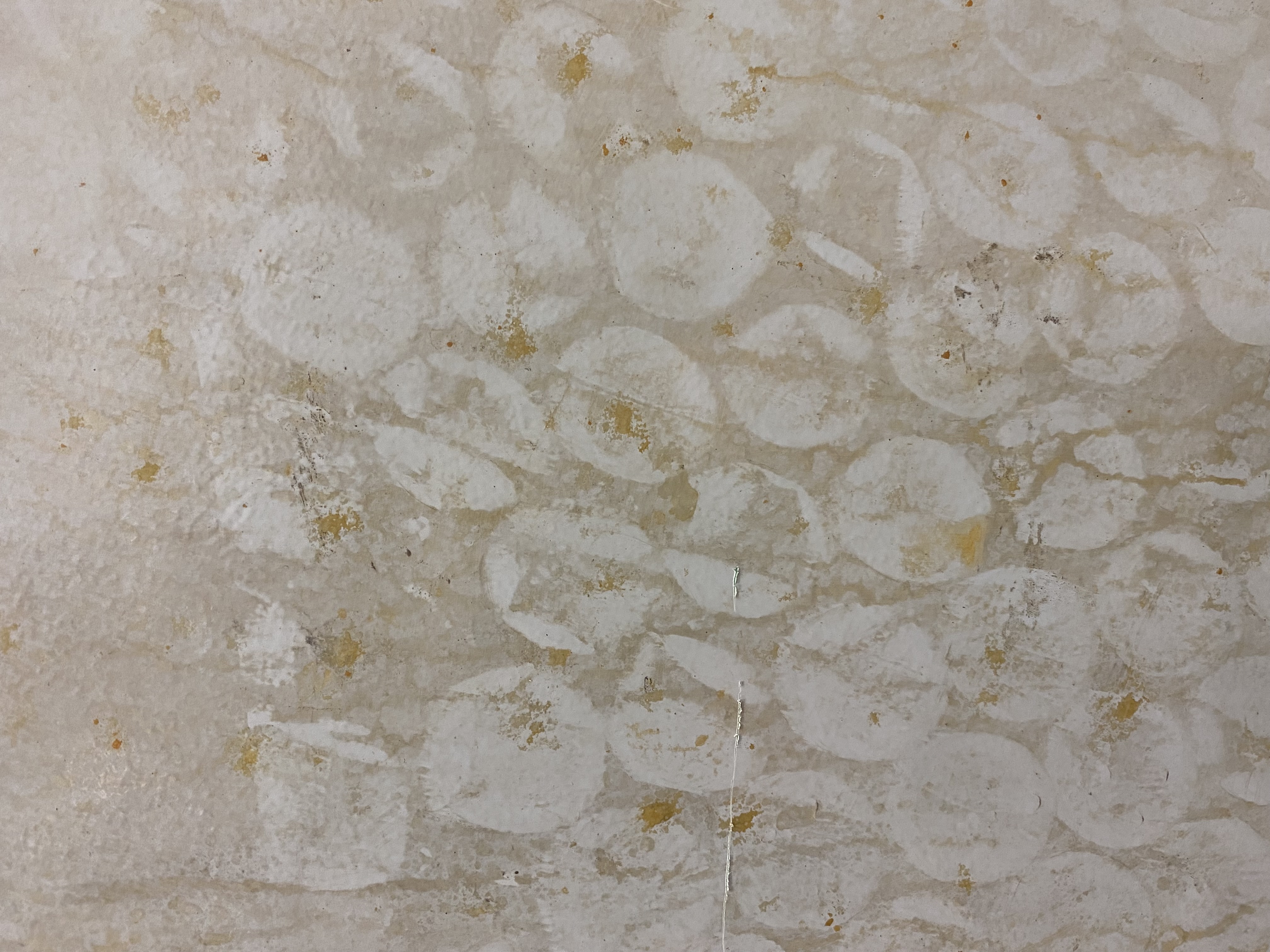

Careful of bubble wrap.
The aircraft paint on the systems I work on can be permanently “damaged” by bubble wrap.
It stains the paint with permanent impression of the bubble wrap.
This is new Akzo Noble aircraft paint applications. Mil-spec on military stuff.
Yes there isn’t any clearcoat in our application so I can’t speak to your paint work but something to watch out for.

Thank you for the heads-up. I have not encountered any issues in the past, but I haven't left bubble wrap on paint for long durations either. I think the activated two-component clears are pretty stout, but I will take your caution on board and get that stuff off as soon as I get the engine in on Saturday.

The engine went in as scheduled.

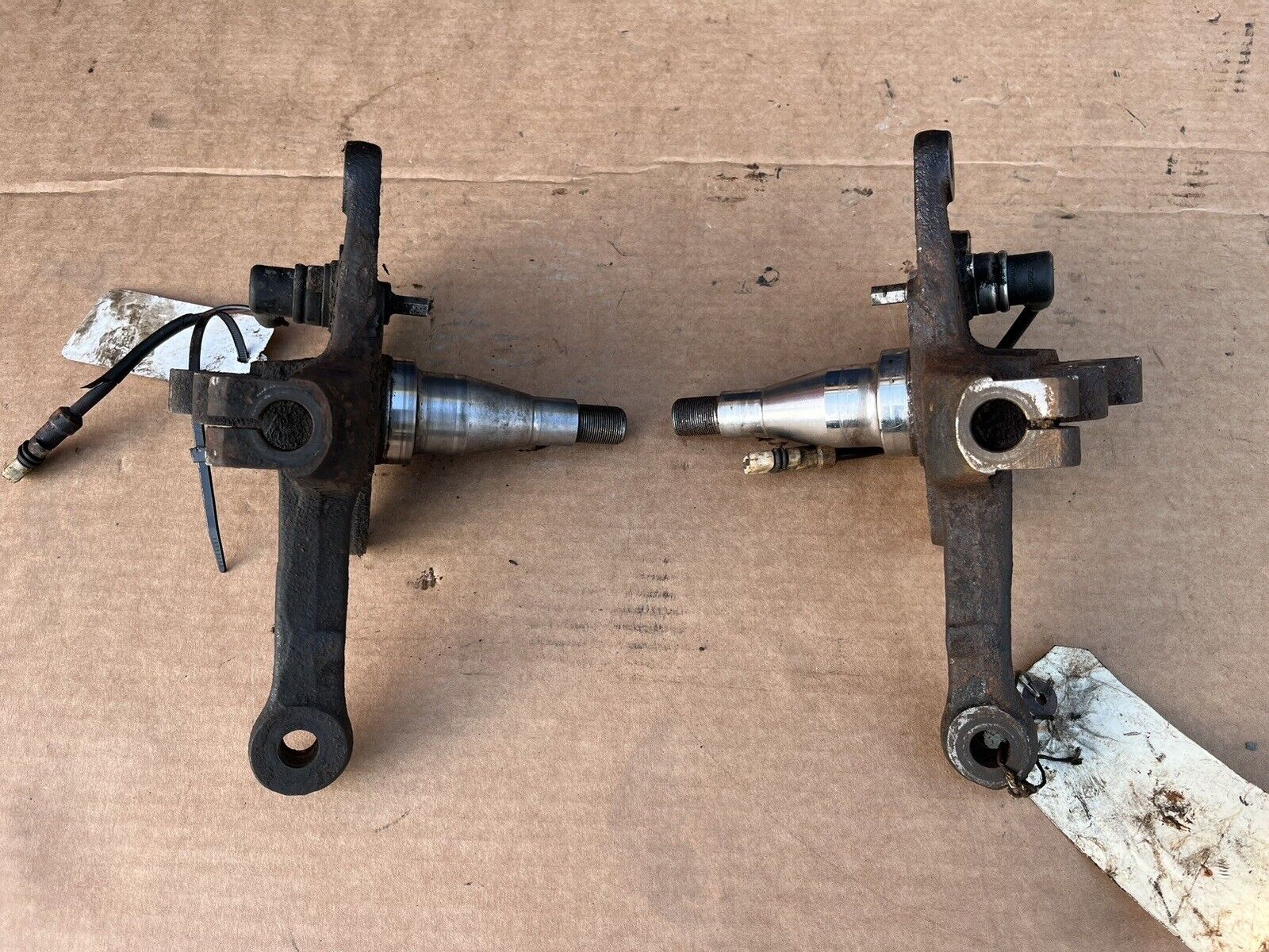

The plans and preparations worked out as hoped overall, but one unexpected issue came up. Right near the end of the day (actually after midnight) I went to install the brake calipers (for the first time) and then discovered that the spindles I had were in fact not turbo/S2 spindles, but just N/A ones. I had purchased them off of eBay years ago specifically as "late-offset turbo spindles" but they were not. I had already found a new home for the original spindles from the car at that point, so I was not able to do a direct comparison, which would have flagged the issue immediately. That said, I never took any measurements or tried to validate that they were turbo spindles, just trusted that they were.

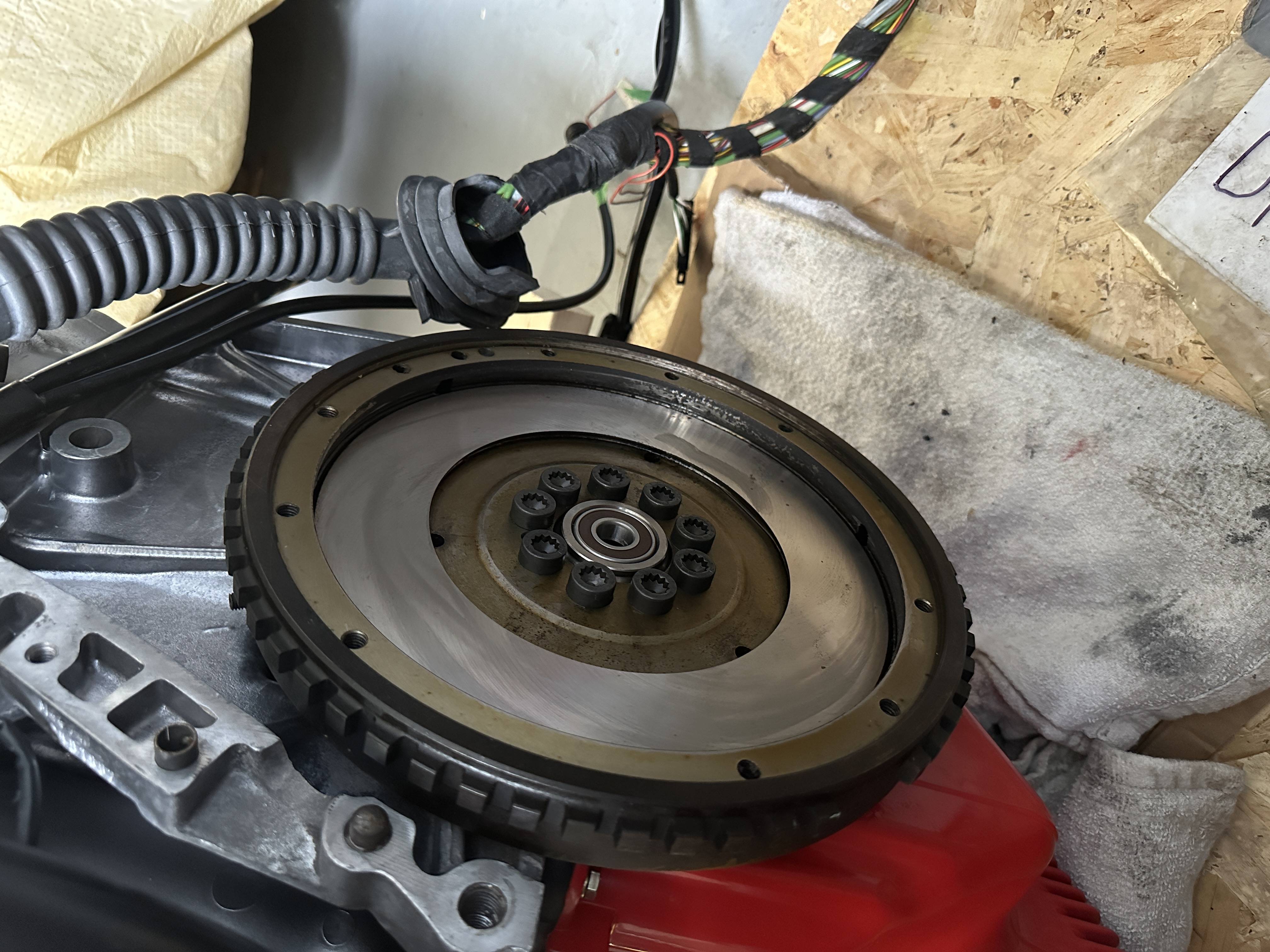

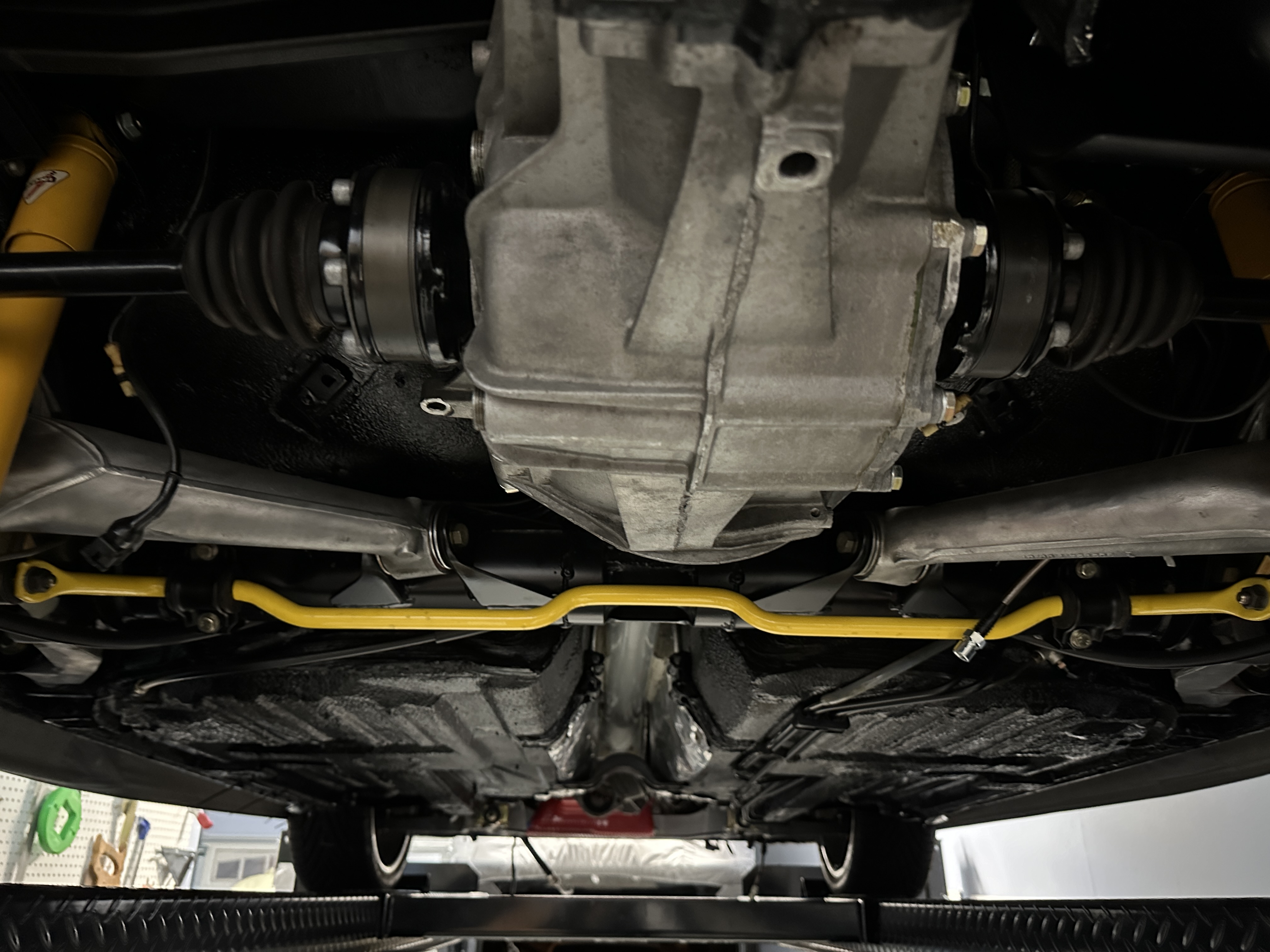

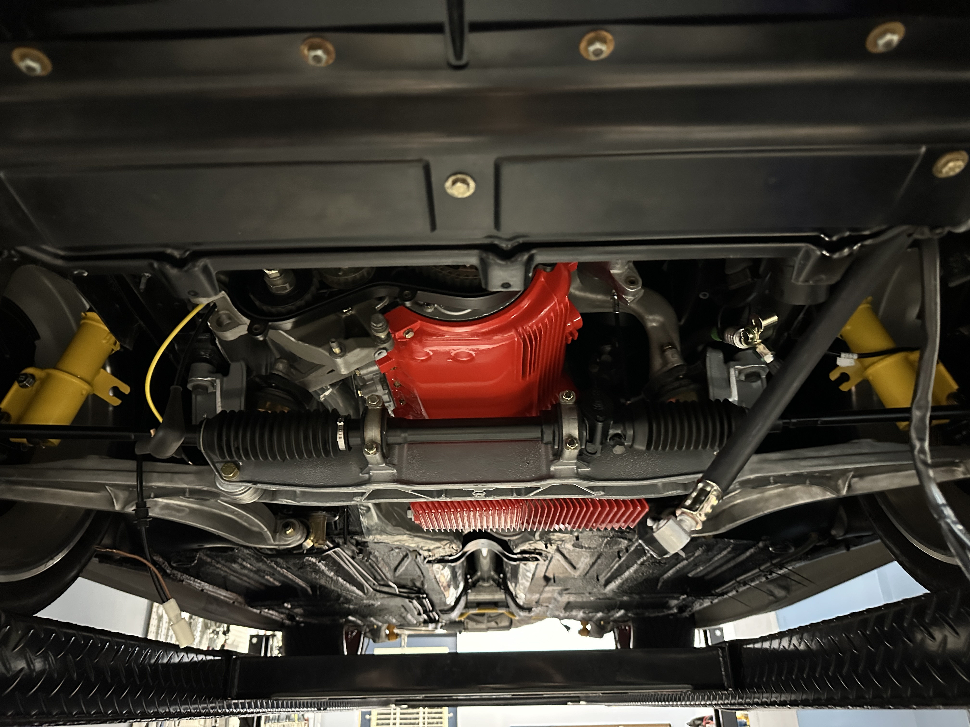

Not a lot of pics were taken. Got engine off stand and installed RMS, pilot bearing and flywheel.
Engine under car.
Ready to be lifted up.
Engine in, but nothing hooked up yet.

That is a huge bummer and I can understand making the mistake of not checking a part immediately upon arrival. There are very reputable sellers that can get you the spindles you need. I'm not sure if you are on Facebook, but Elliott at 944 Barn (Blairsville, GA) or Tim von Roretz (Canada) should be able to help if needed. I'm not sure if they are on Carpokes though.500 wrote: Mon Apr 22, 2024 6:42 am Right near the end of the day (actually after midnight) I went to install the brake calipers (for the first time) and then discovered that the spindles I had were in fact not turbo/S2 spindles, but just N/A ones. I had purchased them off of eBay years ago specifically as "late-offset turbo spindles" but they were not. I had already found a new home for the original spindles from the car at that point, so I was not able to do a direct comparison, which would have flagged the issue immediately. That said, I never took any measurements or tried to validate that they were turbo spindles, just trusted that they were.

Example of bubble wrap marks.
These marks will still be there after the dirt/grease is removed.
I will snap a photo after it’s “cleaned” and marks remain.

That bubble wrap really did a number... Wow...
Gruhsy, your words were at the front of my mind early Sunday AM as we finished up the job... Although my son and I were pretty tired (it was 2:30 am), we made sure to take all the cardboard and bubble wrap off before calling it a night!

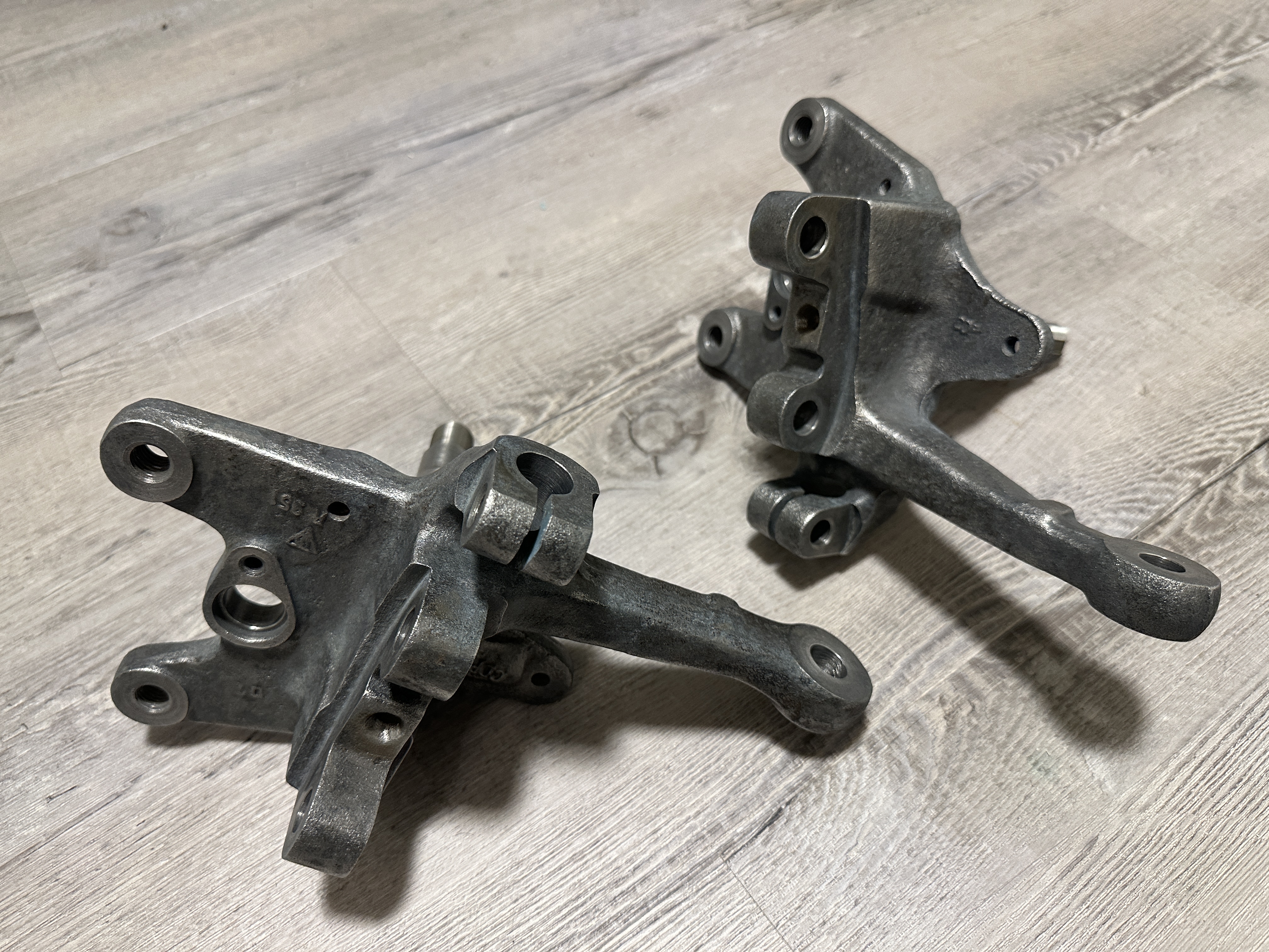

I had almost convinced myself that the knuckles I had were actually correct, after scaling dimensions from pictures of S2/turbo spindles on the screen and called off the hunt for replacements. I was thinking that I had just been too tired when I tried to bolt the calipers on and had misinterpreted the situation.
When I was able to get access again, I confirmed that, no, I was right the first time, they are wrong. The car is on a lift above another car, so the confirmation check had to wait.
So back to searching for replacements. I had previously started looking locally, but then a set came up online which were immediately available and showed no ridges or corrosion on the spindles, so I grabbed them, the price was fair.
Once received, I checked by bolting the caliper on and it looks like the 298 mm turbo rotors will fit, so I think now I have the right parts, although they look the same. I think the difference in the caliper hole locations is less than 10 mm.
I've de-rusted the outer bodies and they are ready for paint, which will be a combination of 2K satin black over 2K epoxy primer, which I will do with a bunch of other odds and ends over the weekend.

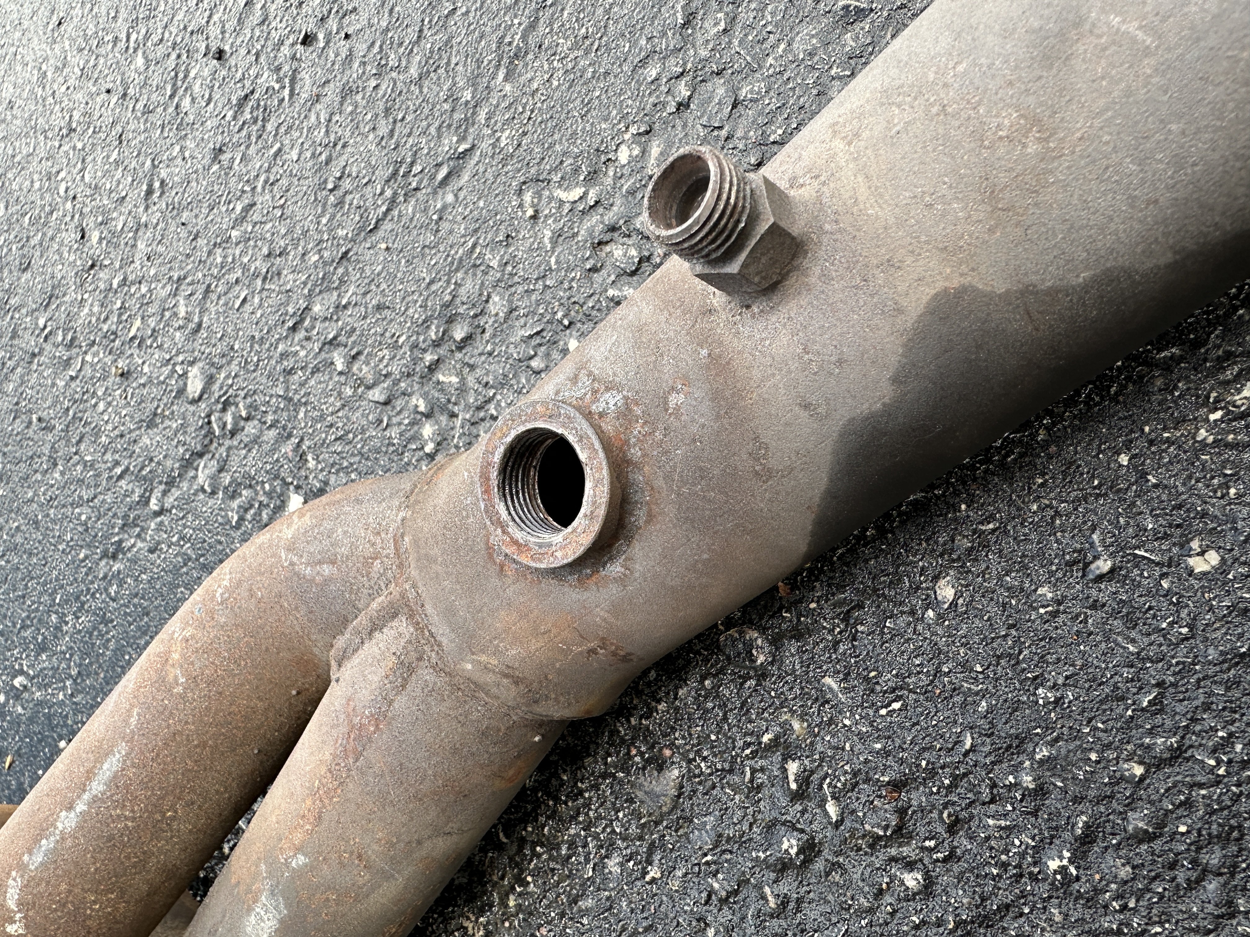

As stated in the prior post, have been mostly focused on the Subaru project. It is almost done.

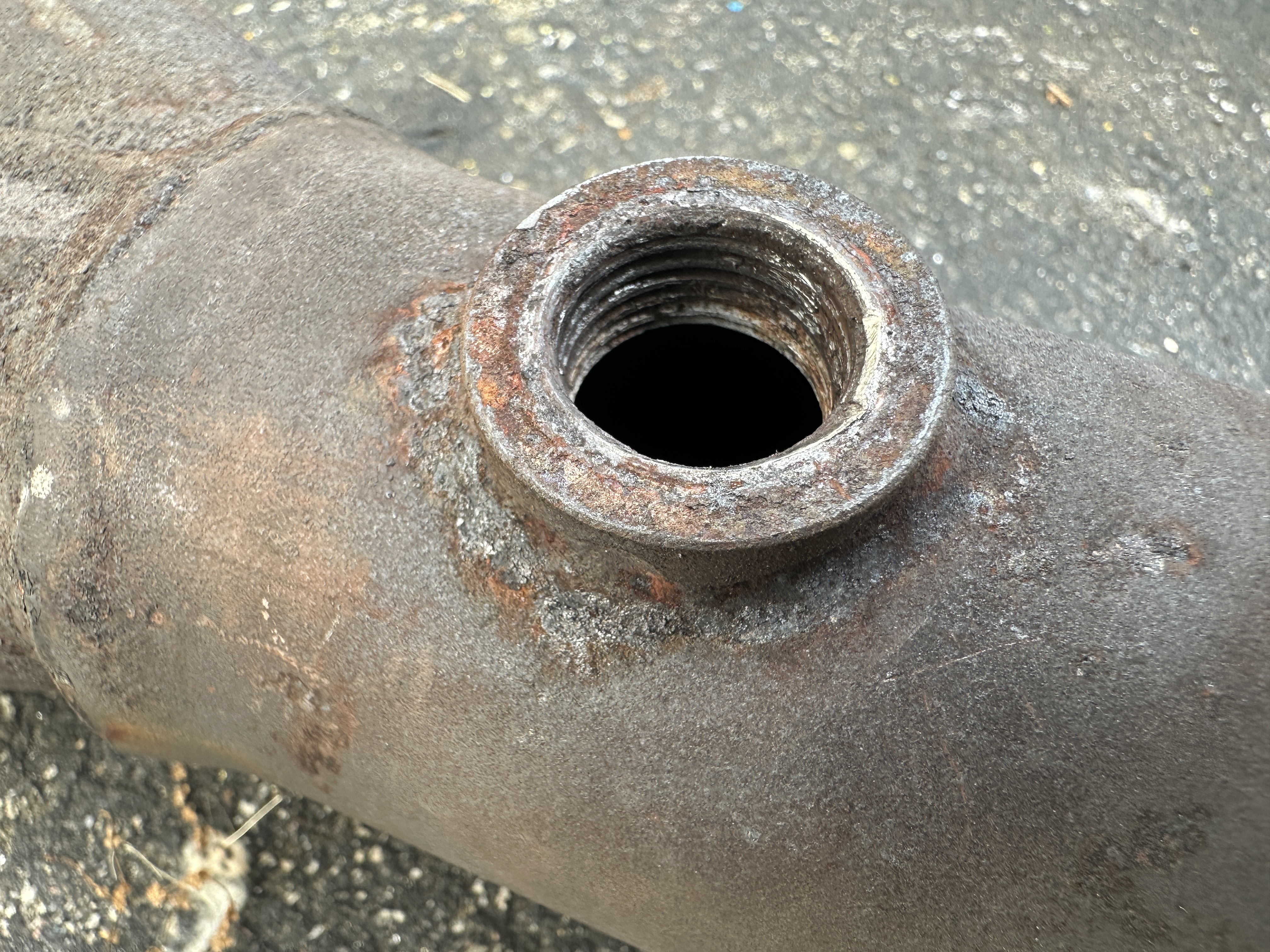

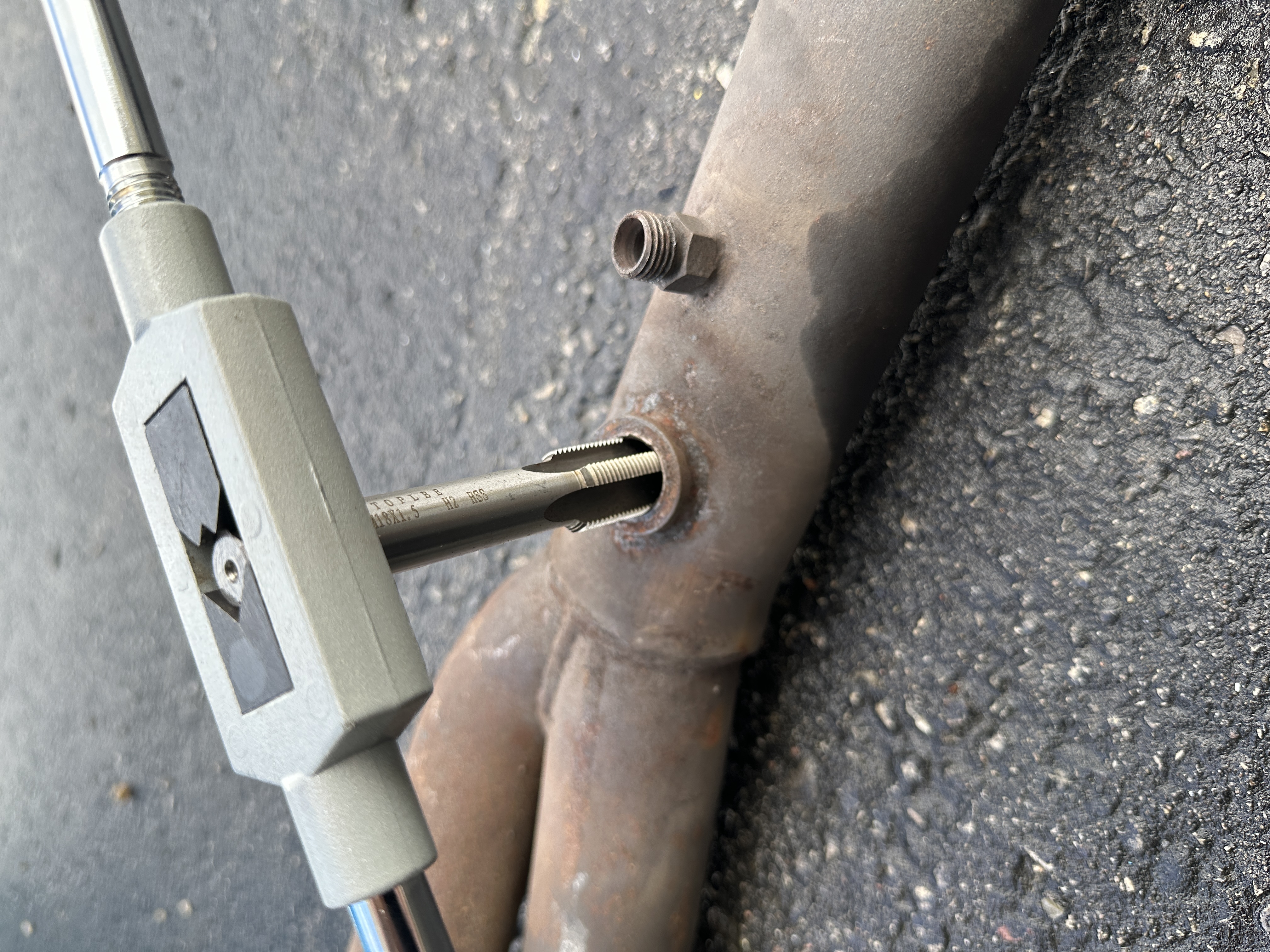

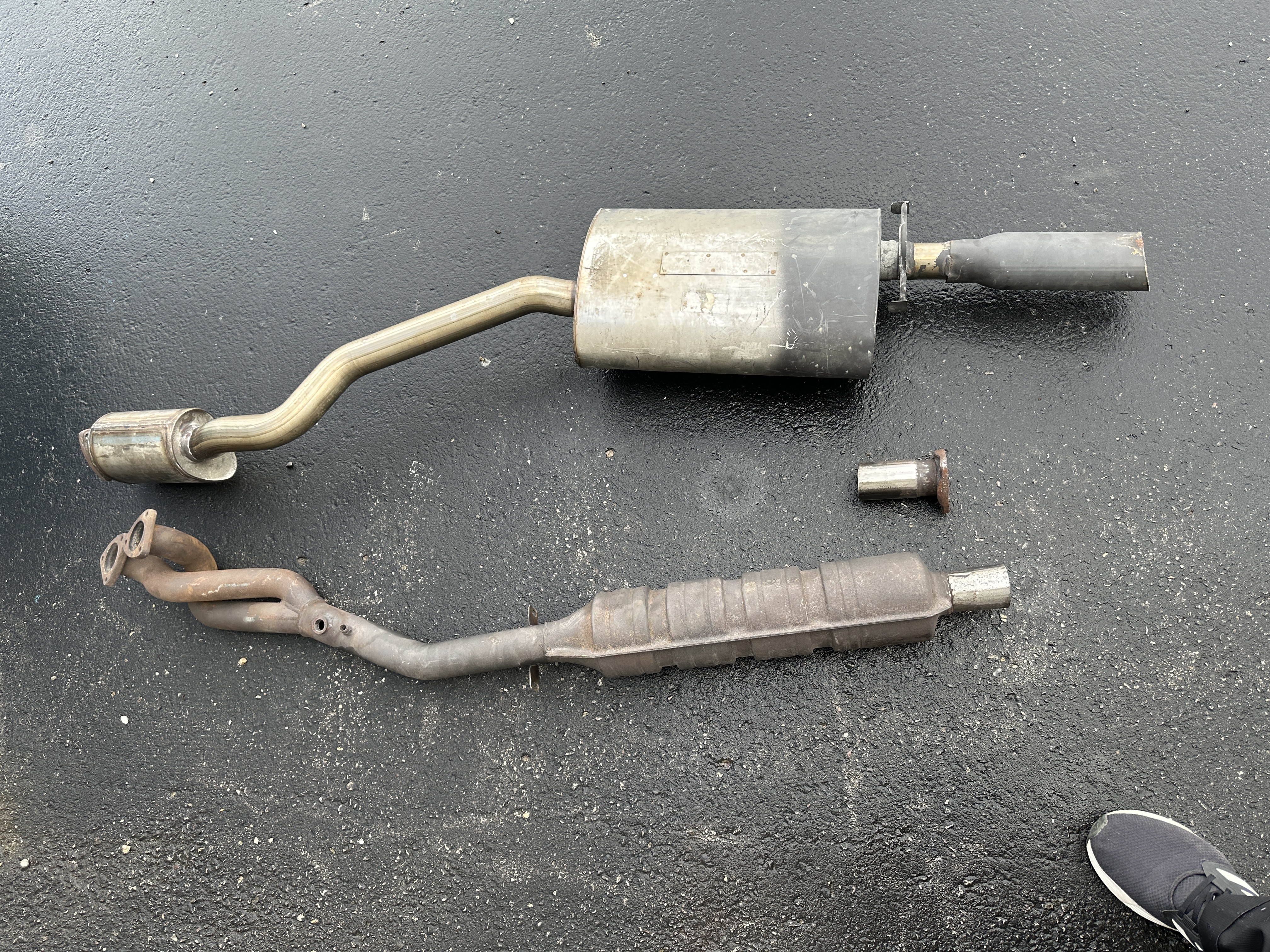

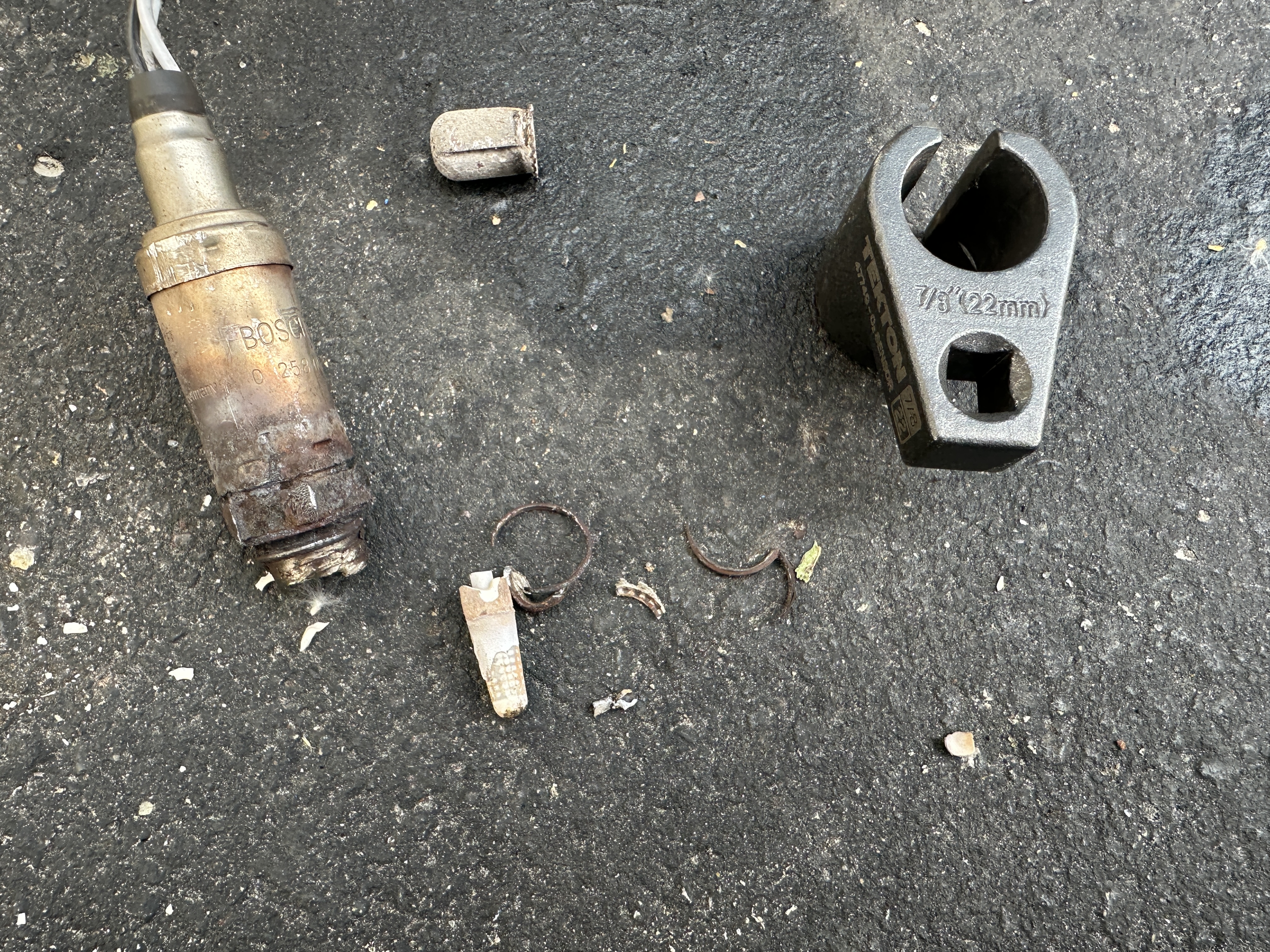

While that was going on, I managed to find what I believe is a decent OEM mid pipe. The old O2 sensor was stuck in, and despite lots and penetrant and some heat, the thing came out in pieces, with some sections of the sensor thread galled onto the bung's thread.
After removing those bits (not so easy), the thread looked a little ugh.
Thankfully an M18 - 1.5 tap was enough to save it.
next step will be to get the mid and tail pipes blasted and coated. I am probably going to go with Cerakote, which I used on the 911 and has been very good.
