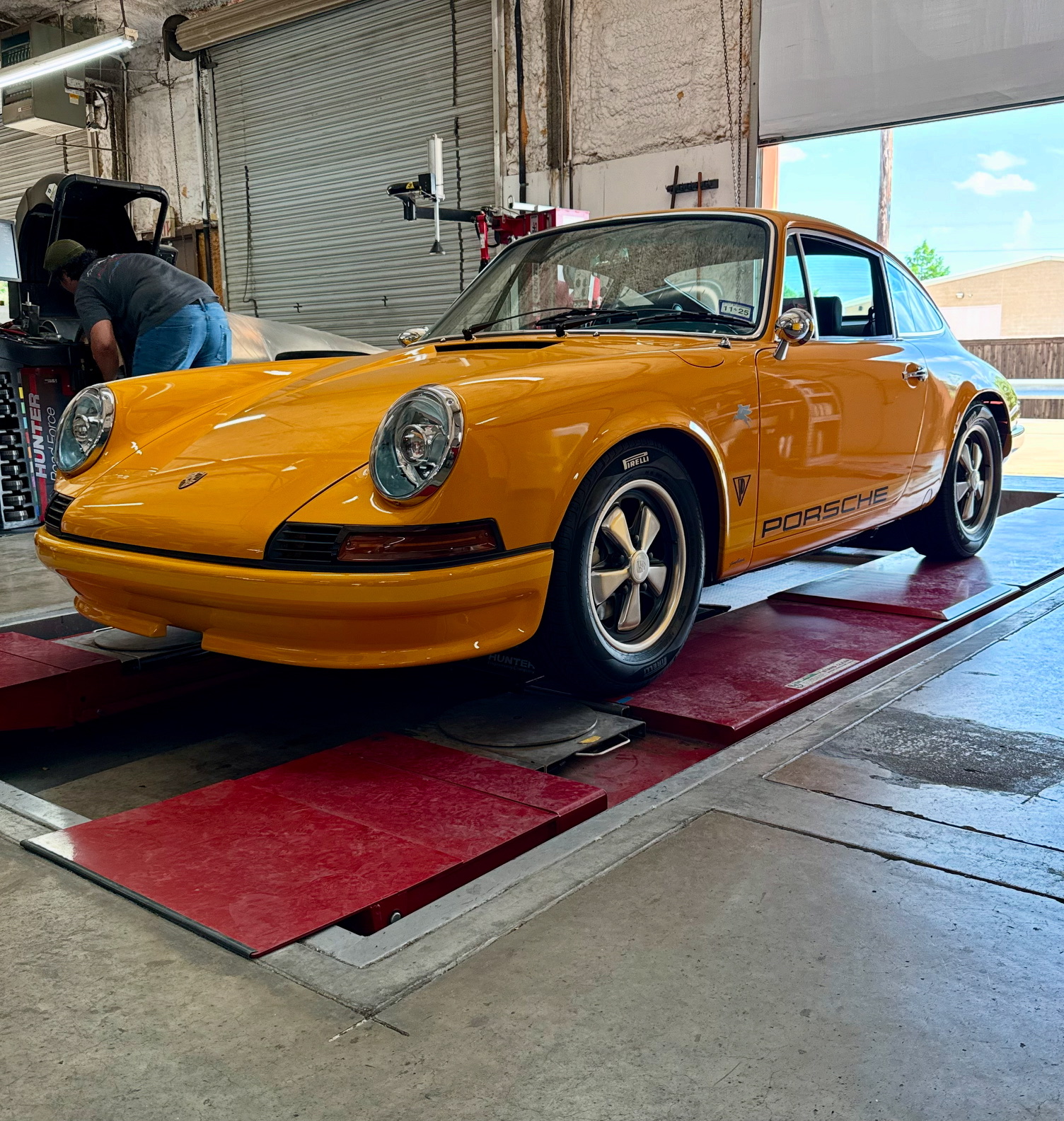

Ride height set and the alignment is finished.

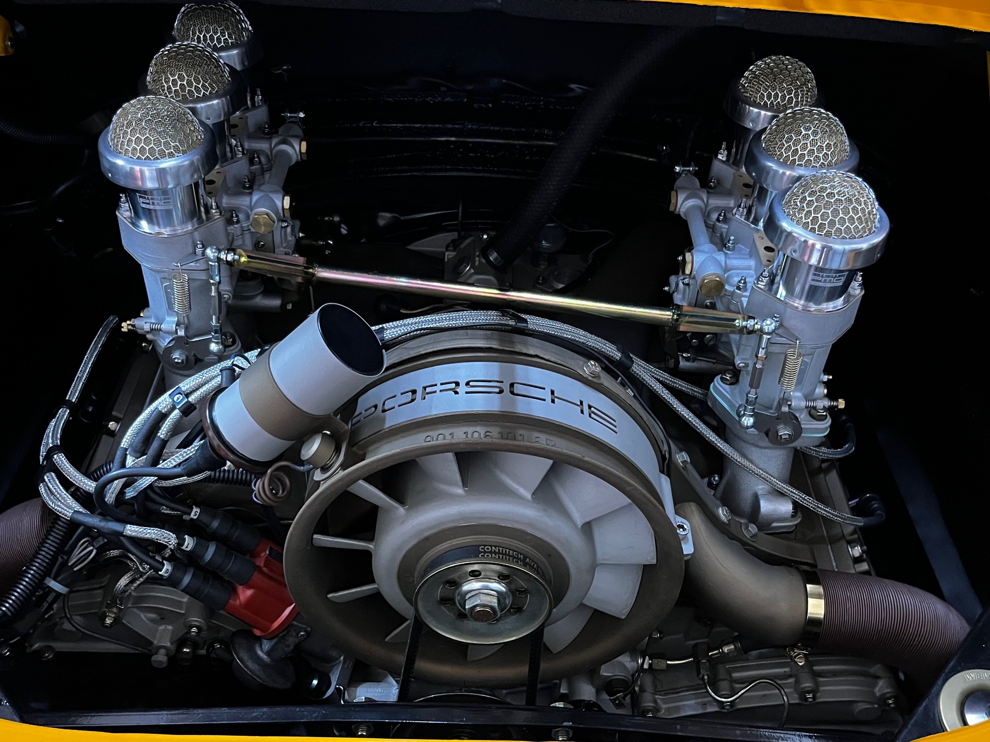

Engine 06.22.2025.jpg (821.93 KiB) Viewed 1686 times
Final Detailing on the engine. Built and balanced 2.7 with S and RS parts.
Magnesium Case (74) case split 4/9/24
Case vapor Blasted and Cerakoted.
Machine work on the case by Soren Anderson.
Pistons & Cylinders New Mahle flat top RS style. 90mm 9:1
Balanced Rods by Pauler Machine
Crankshaft work by Armando - Custom Crank Shaft
Head work by Pauler Machine
New main bearings, rod bearings and intermediate shaft bearings
Oil pump serviced for additional flow.
Supertec head studs
Supertec rocker arms
Port match heads and new PMO Intake
New modified S cams (Ed Mayo Spec)
CSF oil cooler
New PMO 40 Carbs
Turbo Valve Covers.
Wevo engine mounts
Engine assembled by Ed Mayo
Results are a very angry motor that loves 7,000 rpms

Looks fantastic. I bet that car scoots!
Armando was 'the' guy around here for years, then kind of disappeared. How does one reach him now?
