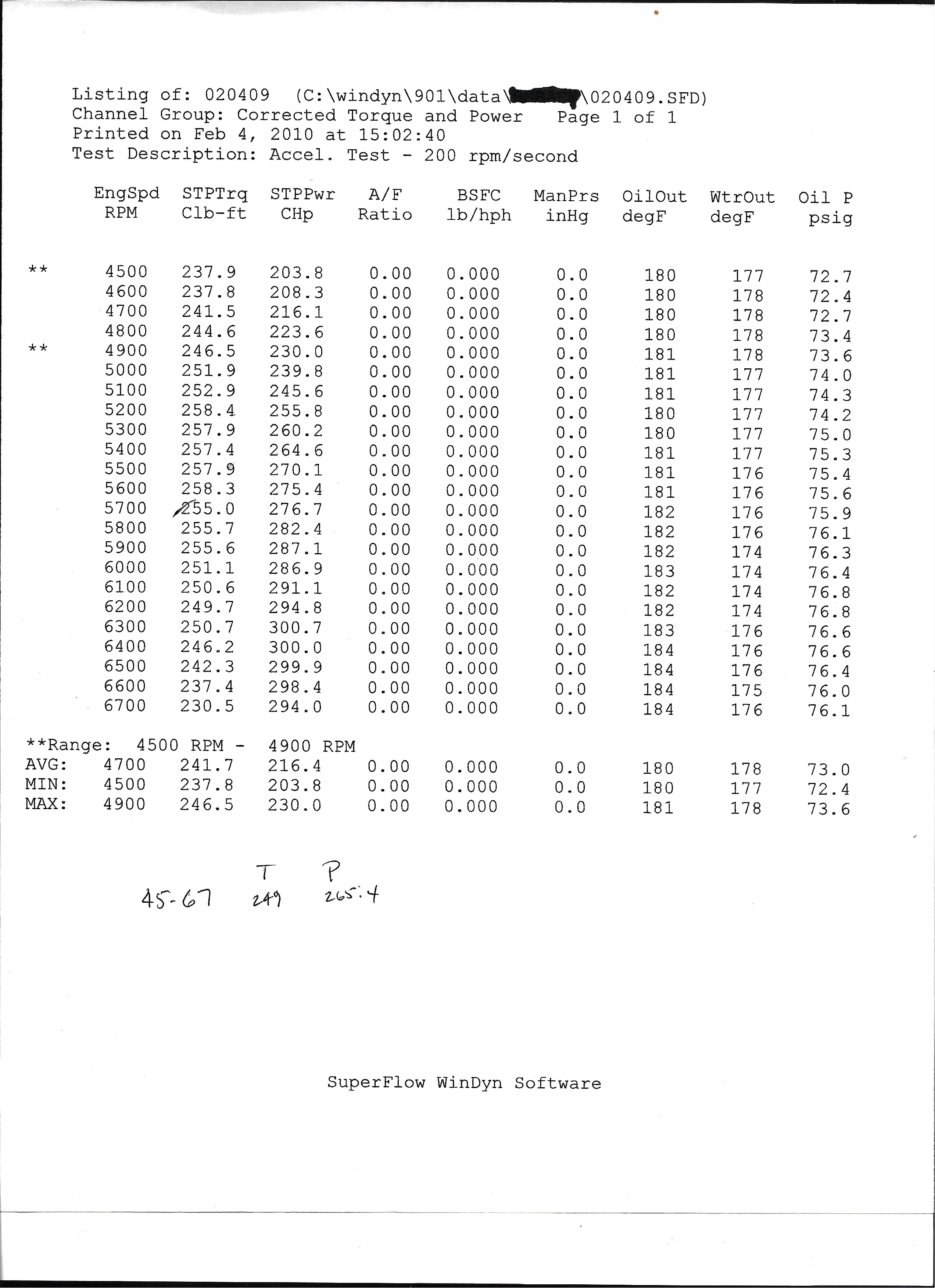

Here's a 3L that's relatively mild, but track only due to the compression ratio which required race fuel. It was a sleeved 968 block that was opened up to 4.125 bore (104.78mm) simply to make piston ring selection easier, custom JE pistons, stock 968 valve sizes in a ported and race-prepped head, big hydraulic lifter cams, and stock 968 intake/throttle body. A more streetable version with lower compression and perhaps a milder cam lobe would be lots of fun. I can provide more build detail if there's any interest.
Last edited by michaelmount123 on Tue Aug 08, 2023 1:31 pm, edited 3 times in total.
