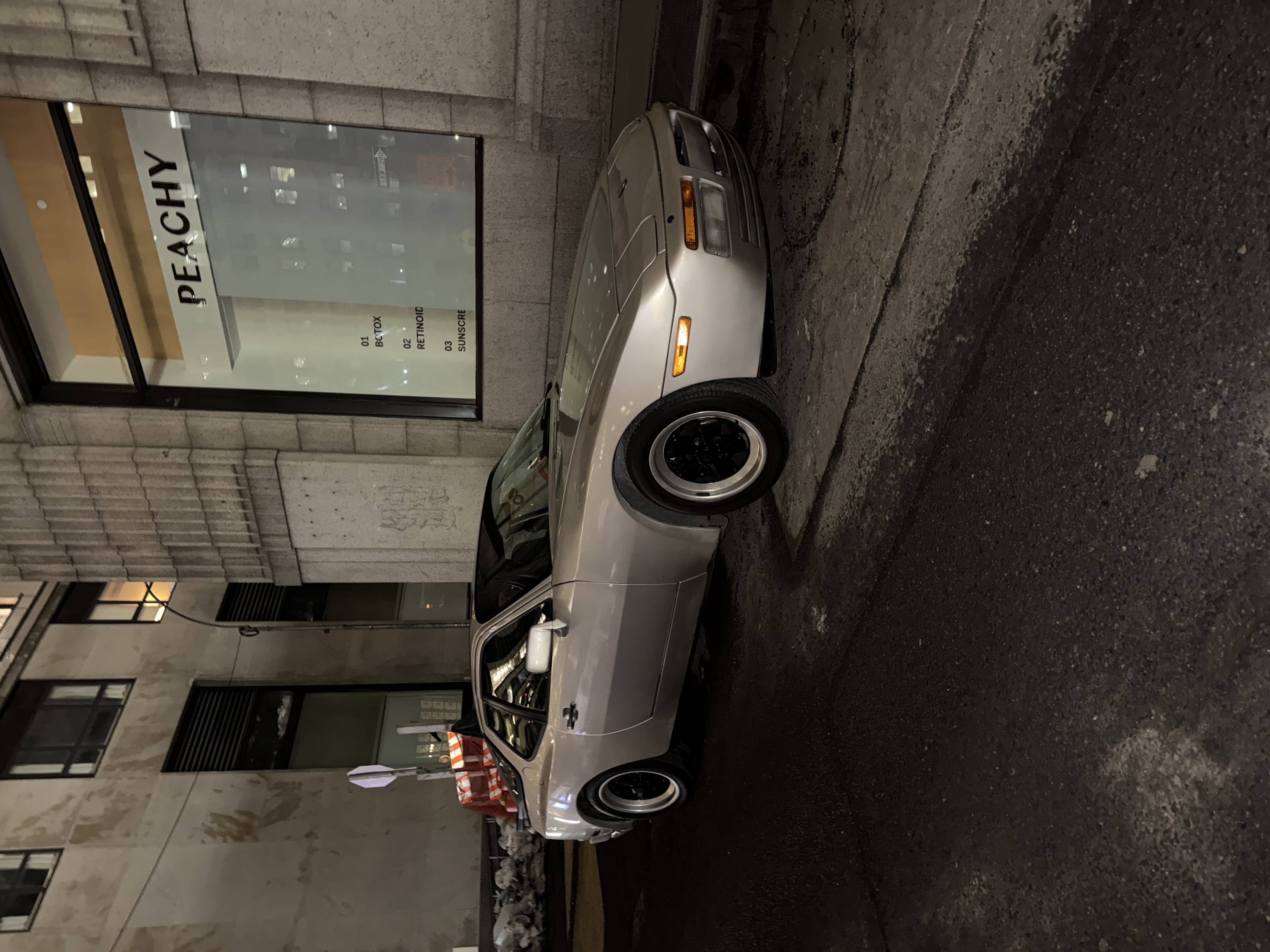

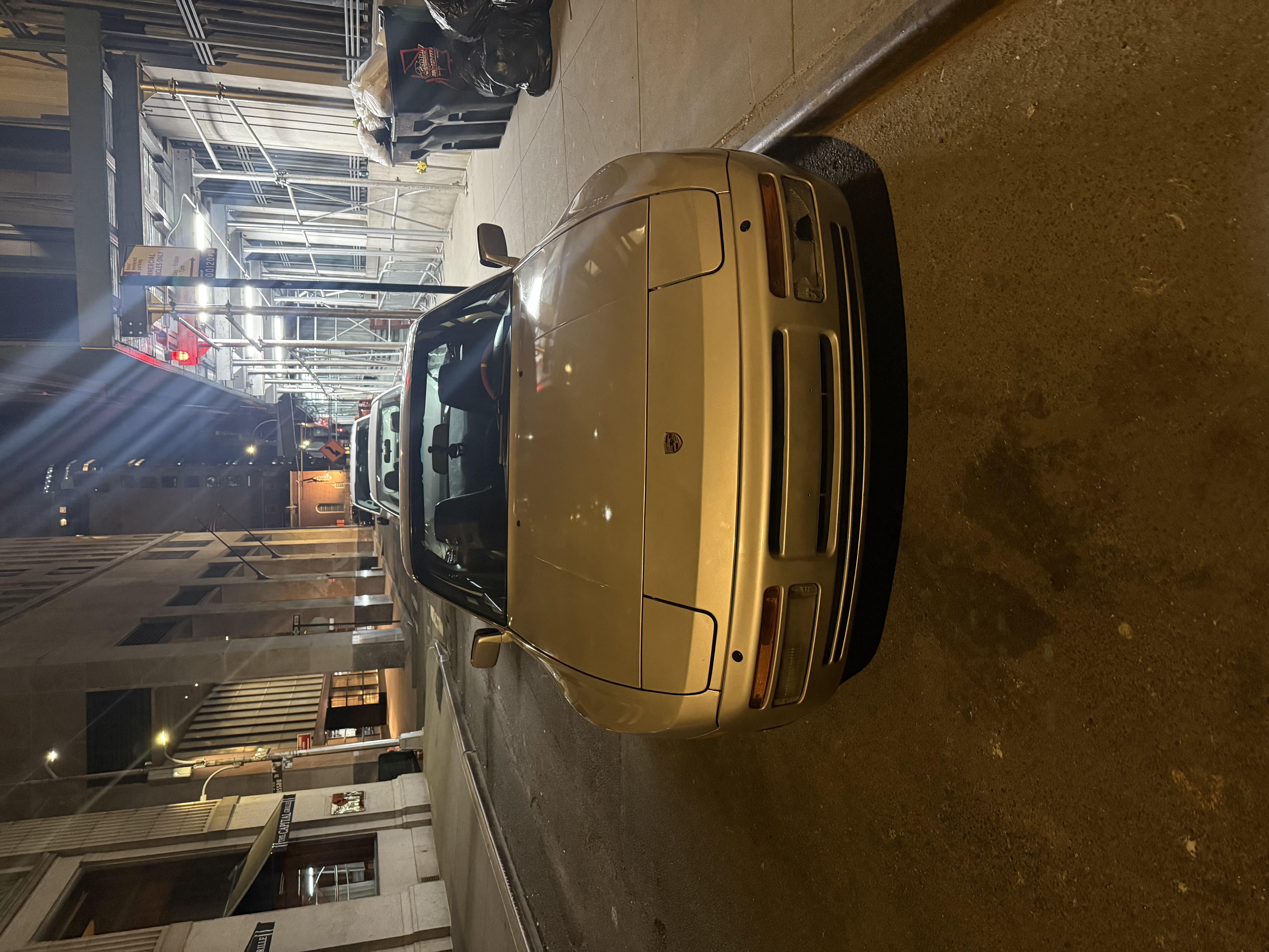

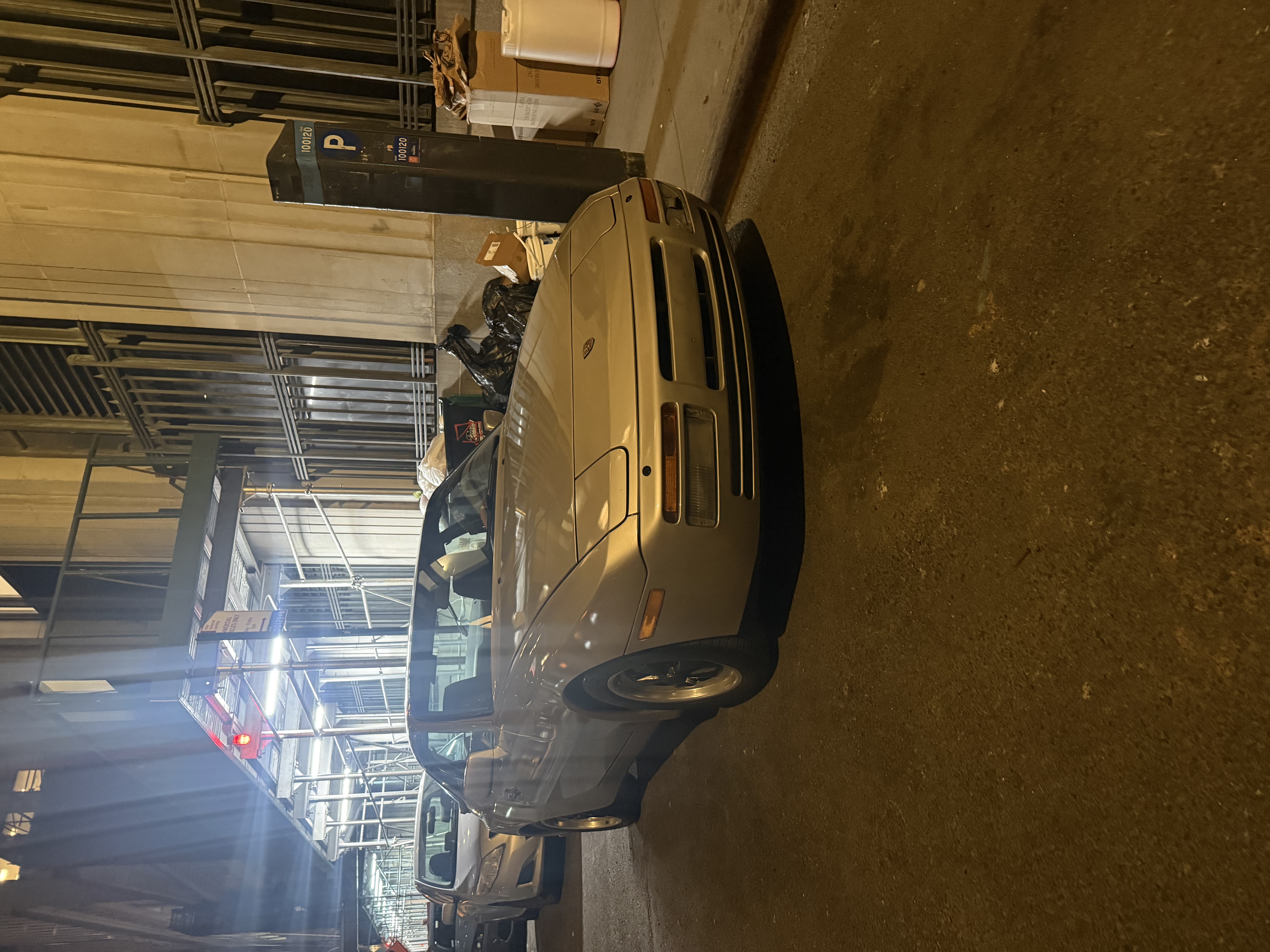

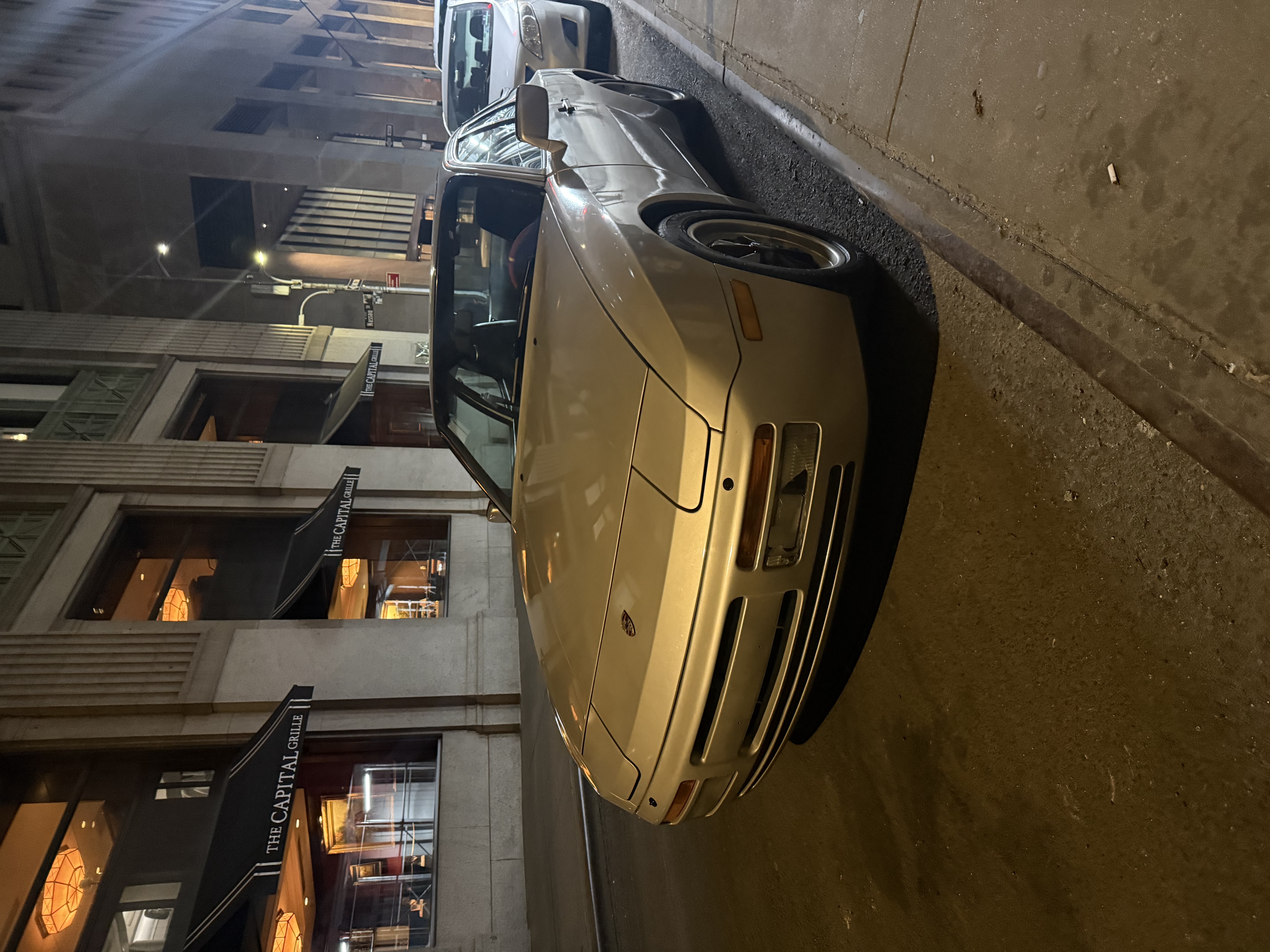

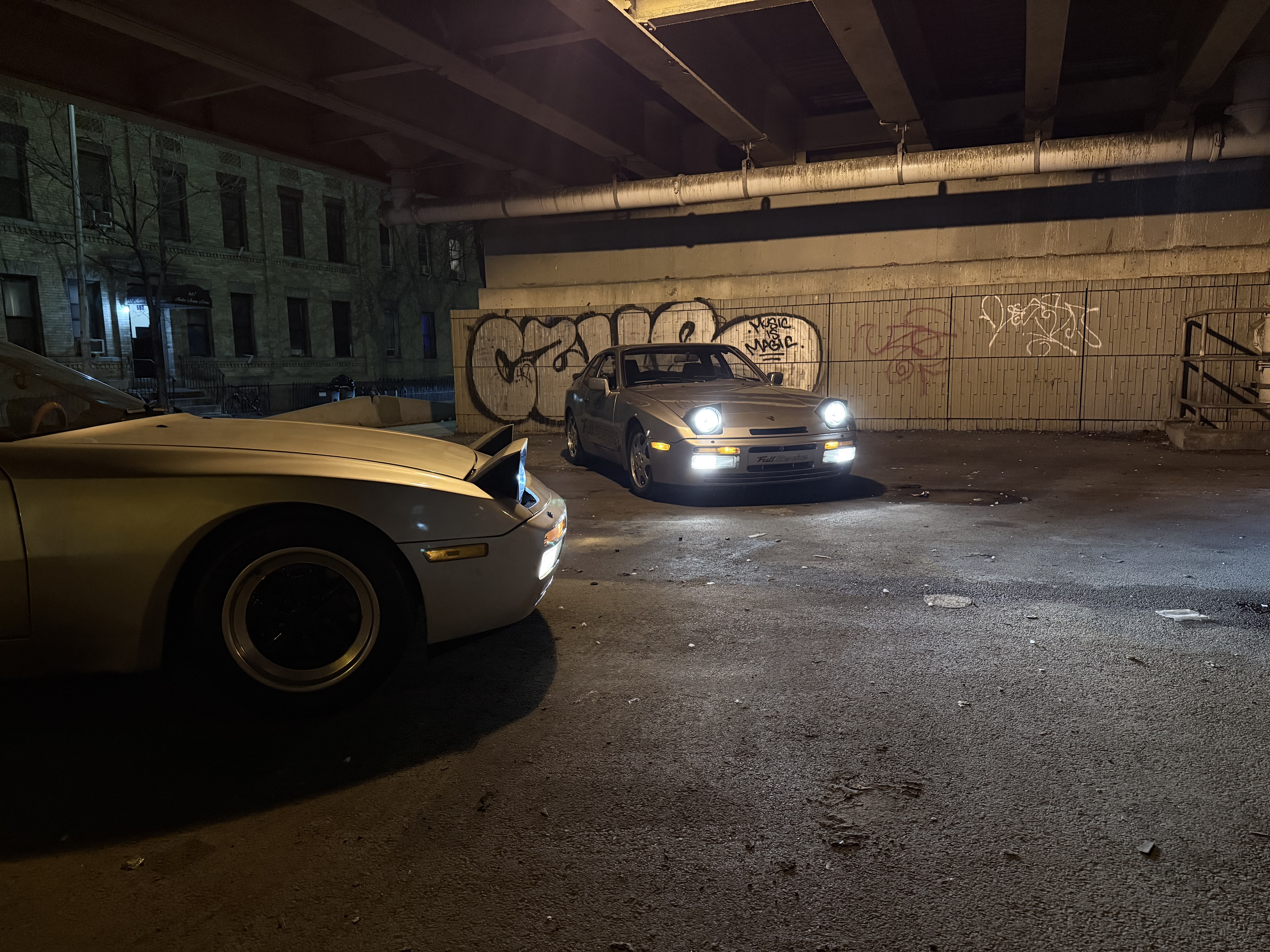

Over the weekend a friend with a silver rose and I took off our front bumpers and properly adjusted them.
It was quite annoying but I’m very satisfied with the result and learned more about the 951 and how it’s built.
It was bothering me the front bumper gaps were so bad. I ordered the bumper mounting strips since they were missing then followed the pelican parts removal video.
Major tip is, if your bumper doesn’t line up with the nose panel and fenders well, you can adjust the bumper shocks after removing the bumper and raise them so when the bumper is put back on it is in a higher position. Made a huge difference with my car and now everything lines up well.
Also make sure you buy the hardware kit either from eBay or belmetric or hardware store with proper bolts and screws and have the bumper retaining strips.
Leave things loose until properly positioned then tighten things up.

More intriguing night photos of your car as well as your friend's. Both cars are looking great!
