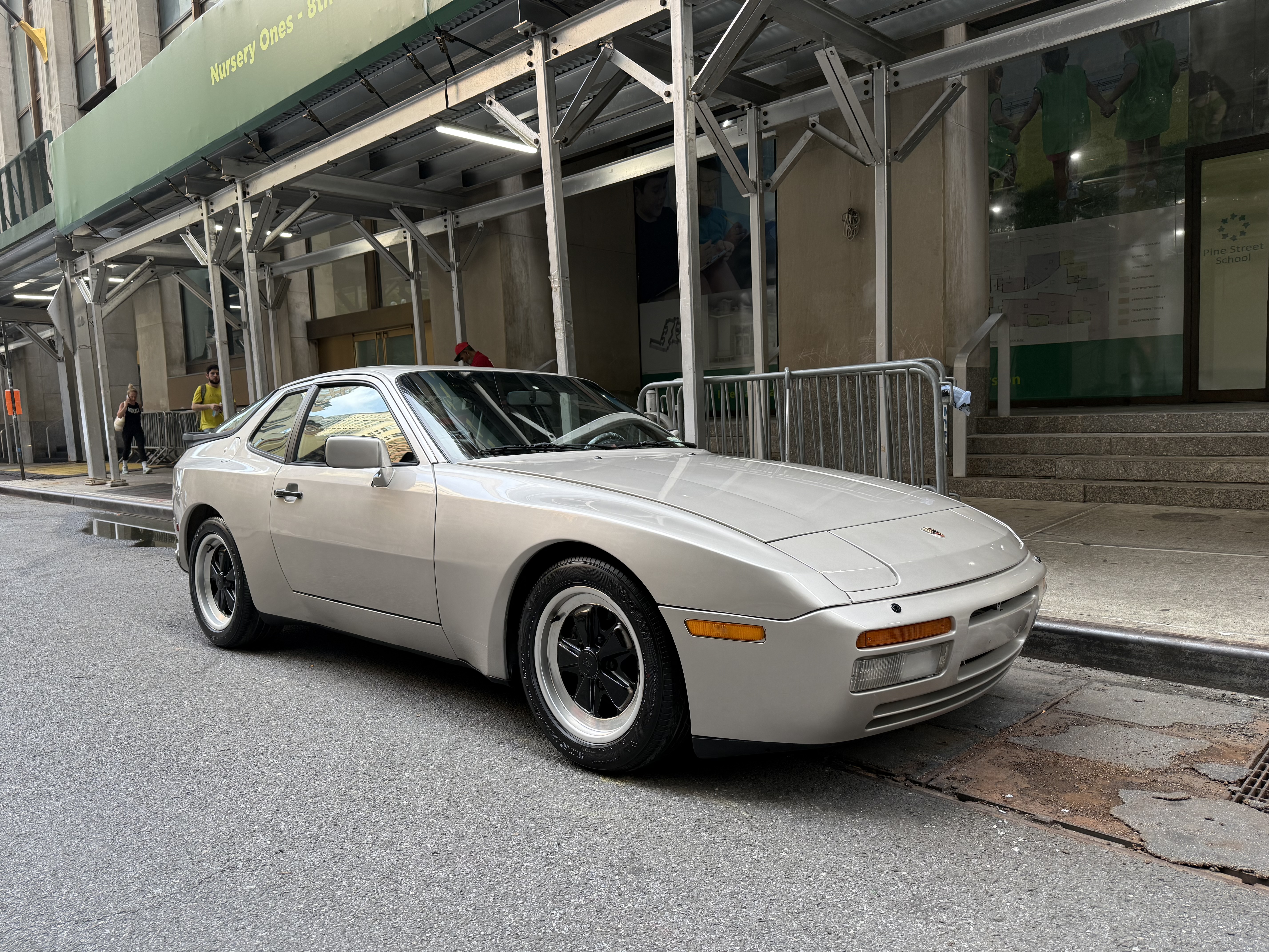

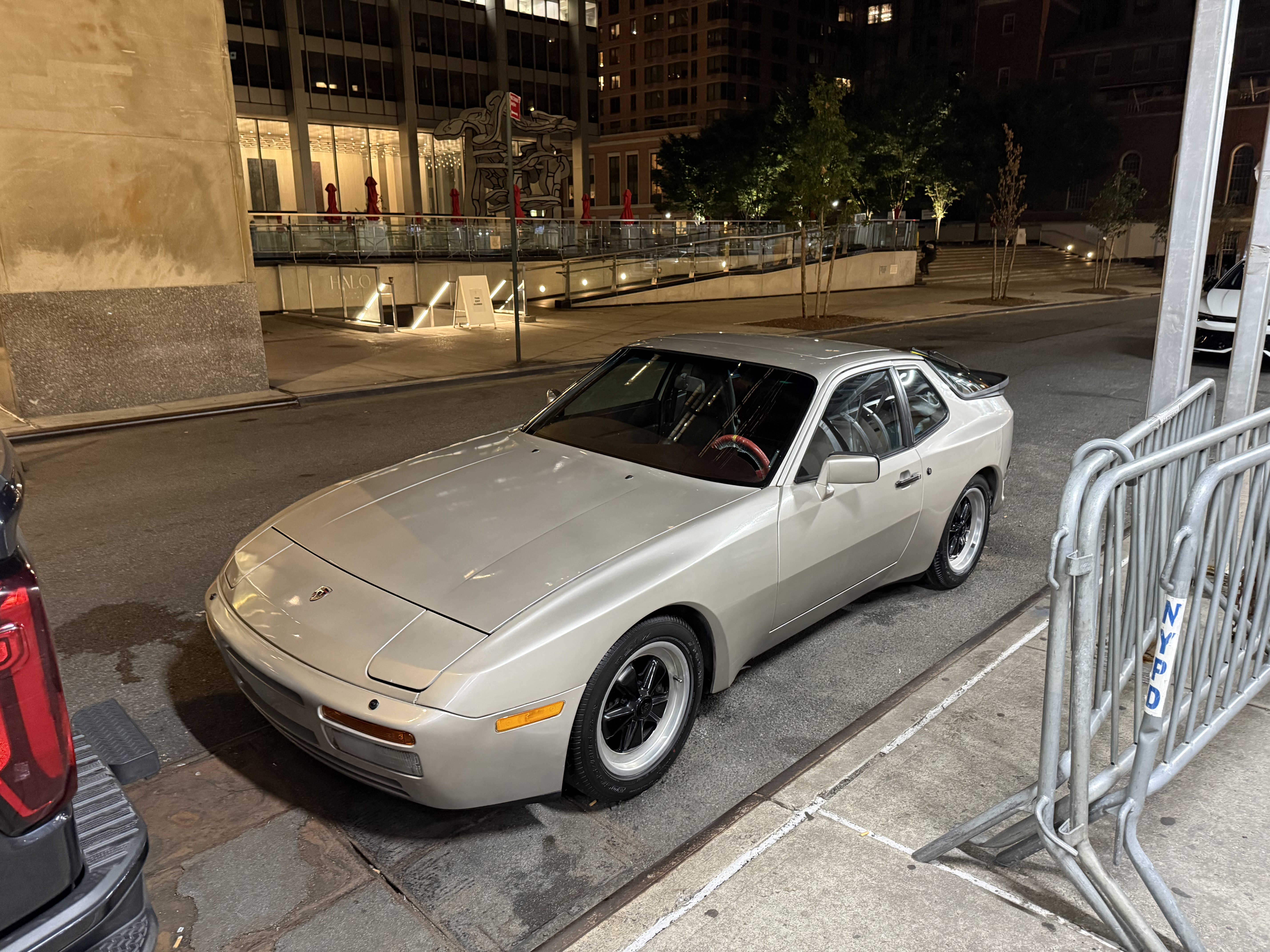

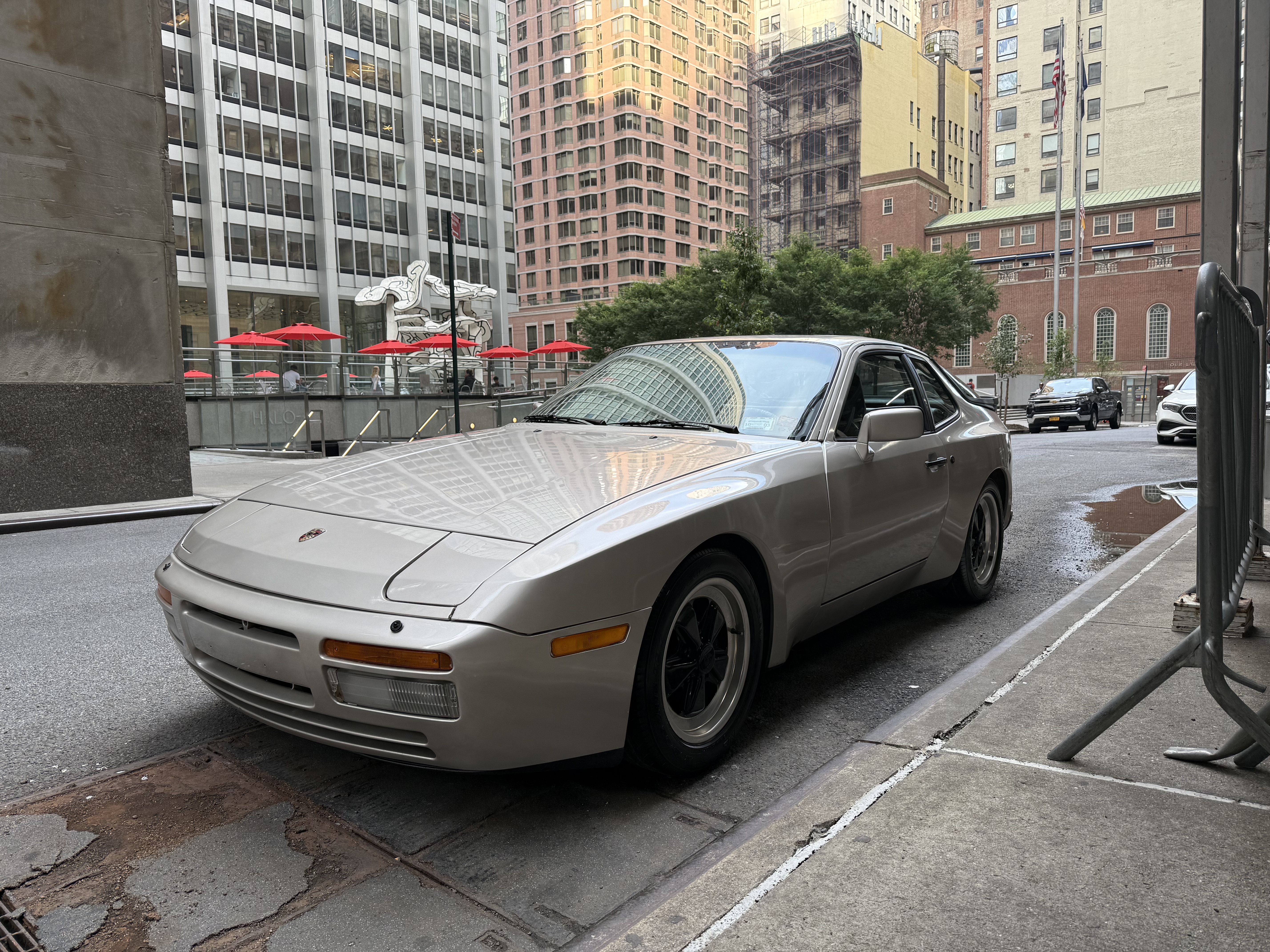

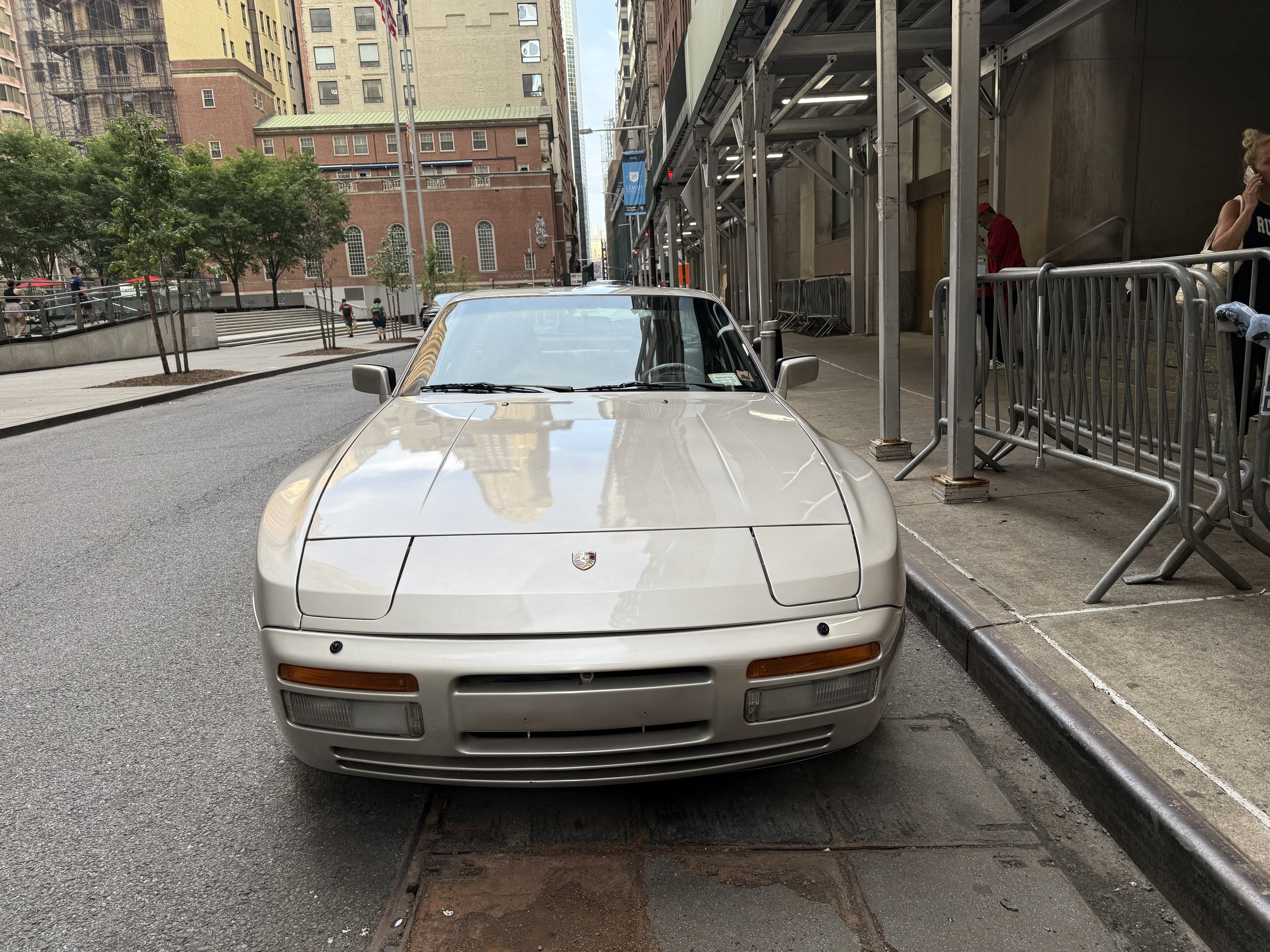

Pics:
Anyone in NYC area willing to help me get a 951 started?

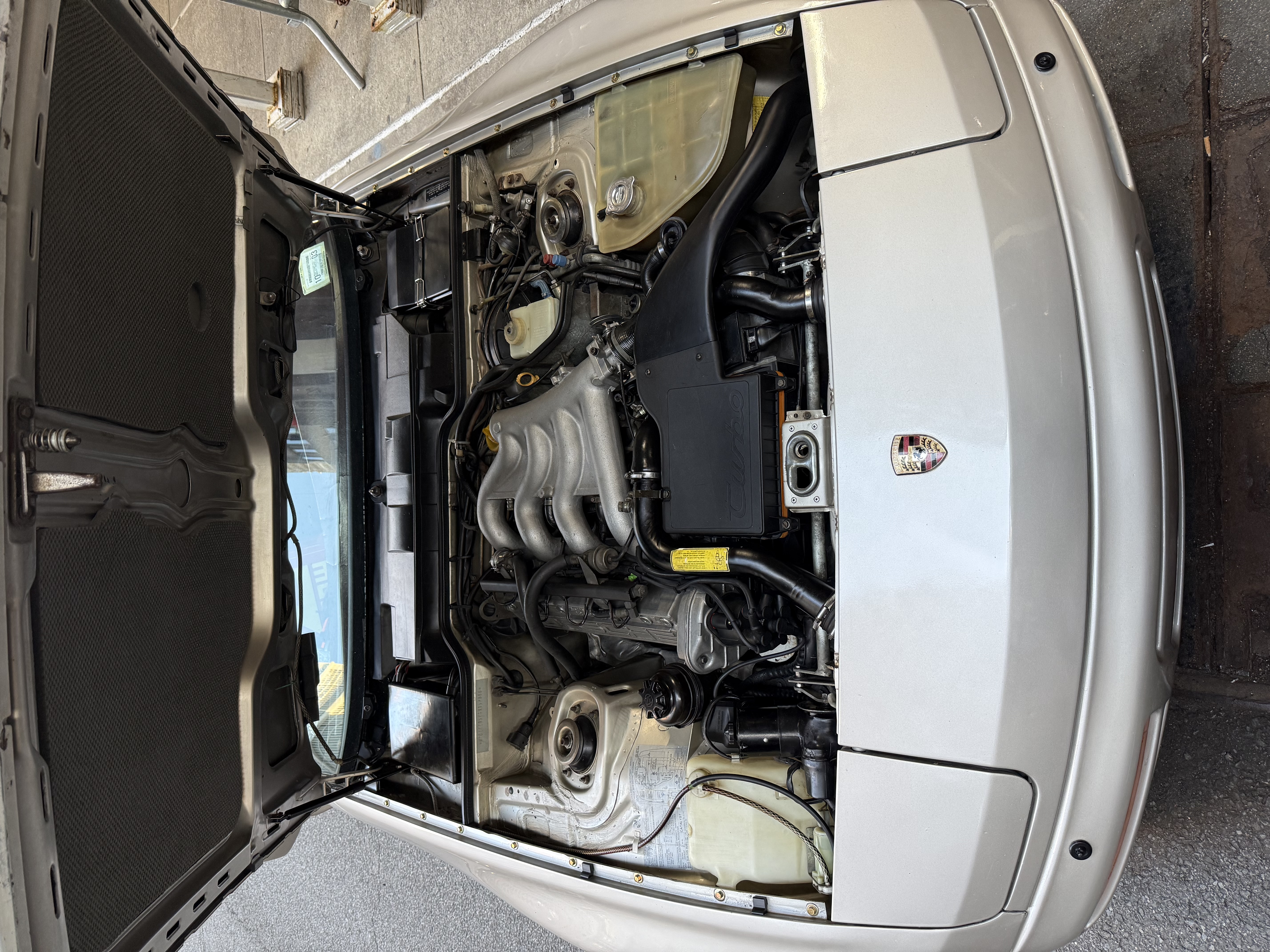

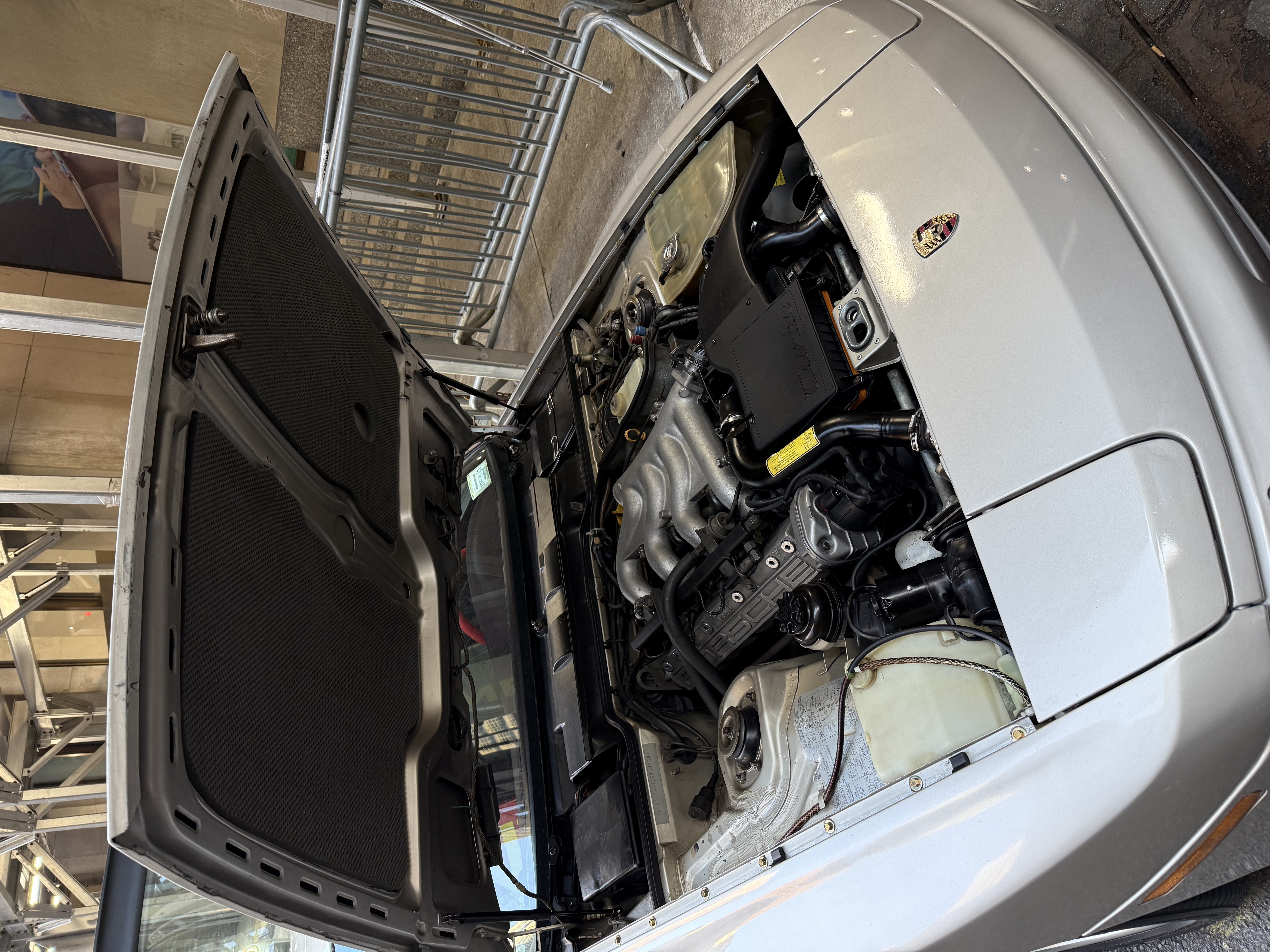

So far Ive replaced these parts to try to get the car running.
1. New F9T Sport DME
2. New F9T solid state DME Relay
3. New Injectors
4. New rotor and cap
5. New Beru cables
6. New Fuel pressure regulator
7. New Bosch Fuel pump
8. New Fuel filter
9. New fuel filter and fuel pump lines
10. New AGM Battery ( Now dead after so many attemps)
11. New Spark Plugs
12. Bypassed factory alarm system.
13. New speed and reference sensors properly gapped (has tach bounce)
14. cleaned intake manifold and throttle body.
15. Verified ignition coil is working.
There are other cosmetic things I've done to the car but for some reason after all these parts being replaced the car STILL WONT START. It cranks only. I had a couple of mechanics come help me change some parts and verify the ohms at the ecu. We weren't able to get it to start.
The harness seems ok, I don't know what else I could do and im puzzled as to why it wont start.
