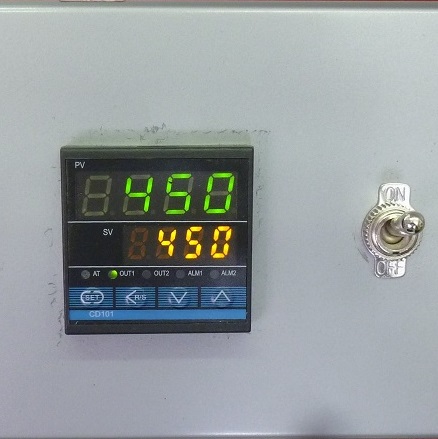

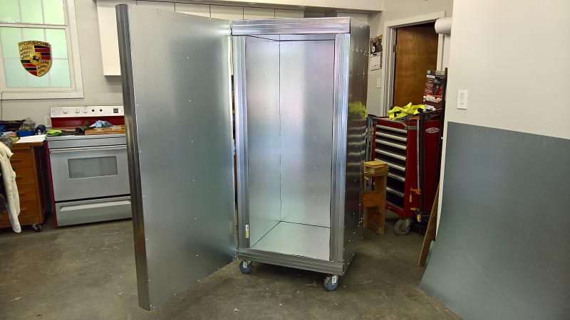

I got 2, a small one and a large one. I started with the small one, which was an old stove I converted.
Installed a digital controller It was OK for small parts, but I needed something larger, so I built one. 2 Coils and the same digital controller as for the small one.

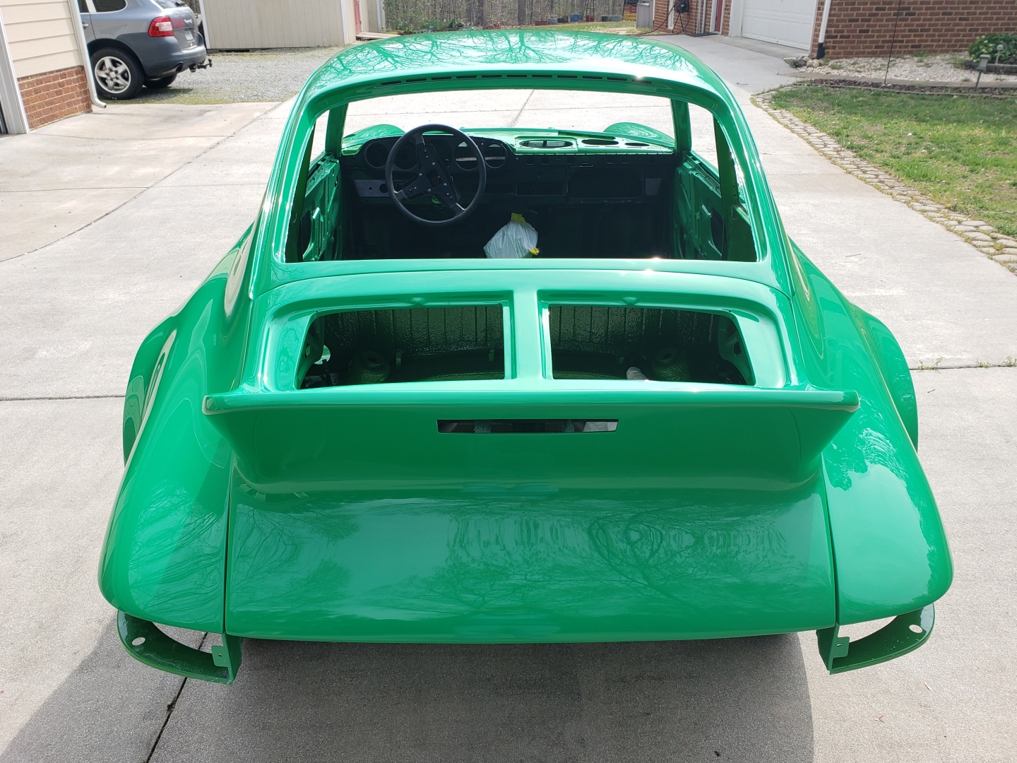

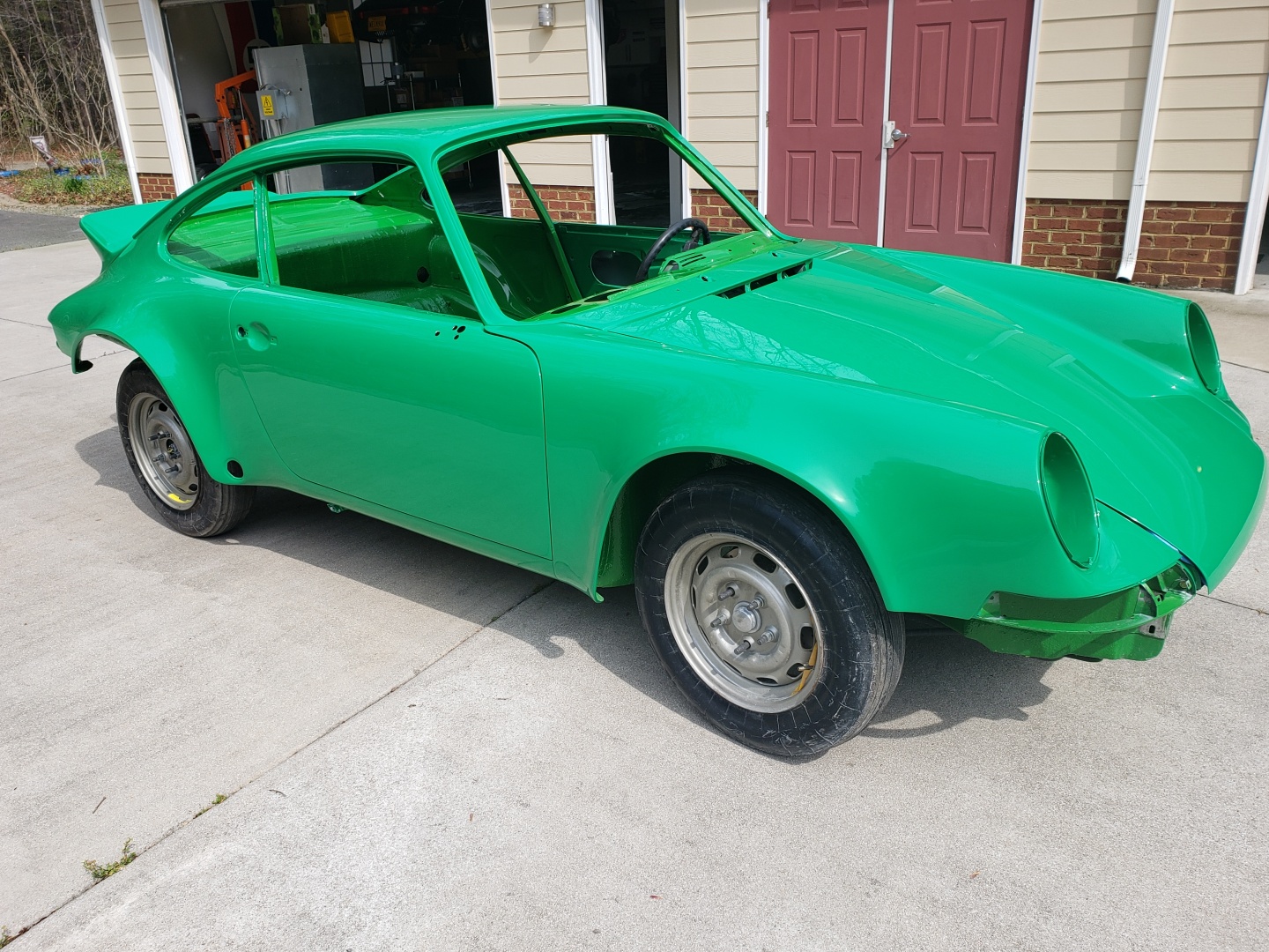

The car is back from painting. I will let it sit for a while, since I'm working to finish up the engine for the Targa and install it.
Here are a few pictures.
Cheers
Engelbert
Cheers
Engelbert

Looks great to me! That's a different green from before, correct? What is the color?
It's the same color, Viper green. This time with top shelf paint, and base color and clear, that's why it looks a bit different. I like the tone as it is now.blueline wrote: Sun Apr 09, 2023 3:59 pm Looks great to me! That's a different green from before, correct? What is the color?
