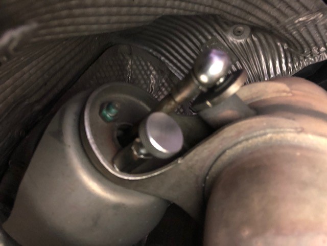

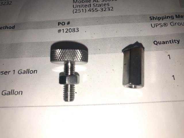

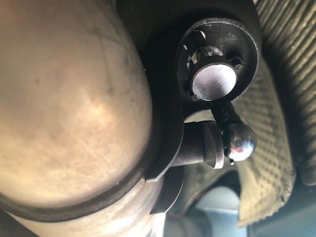

When I received my Cayman GTS 4.0 2 years ago, I did the "collar mod" on the exhaust valve actuator. It was a pain to install, and a bigger pain to adjust. On a lesser forum, a guy proposed removing one of the 3 nuts on the bottom of the actuator, and installing a threaded rod coupling, and into that a hex head bolt to limit the movement of the actuator arm. Instead of the hex head bolt, I used a large head, knurled thumb screw, making adjustment to suit very simple. It is working well and is very easy to remove if needed. All done in stainless steel of course.

J-Dub wrote: Wed Oct 25, 2023 8:31 am Bama,
I can envision what you are saying but to you have a picture by chance?
Edit: just saw your post on the other forum. Good work!
Pictures as requested.
