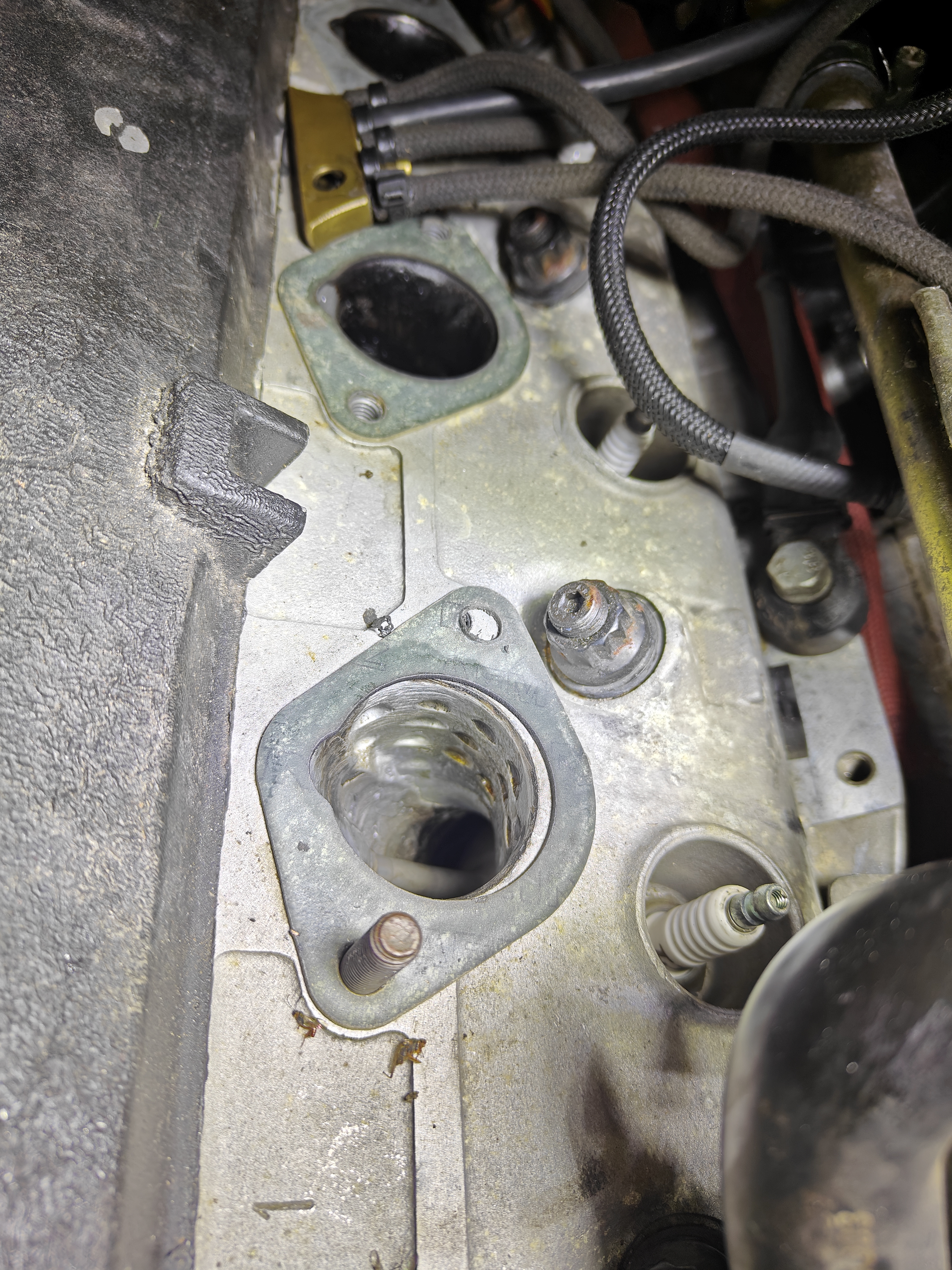

Epoxy liners in the head went ¯\_(ツ)_/¯.
07k swap incoming.

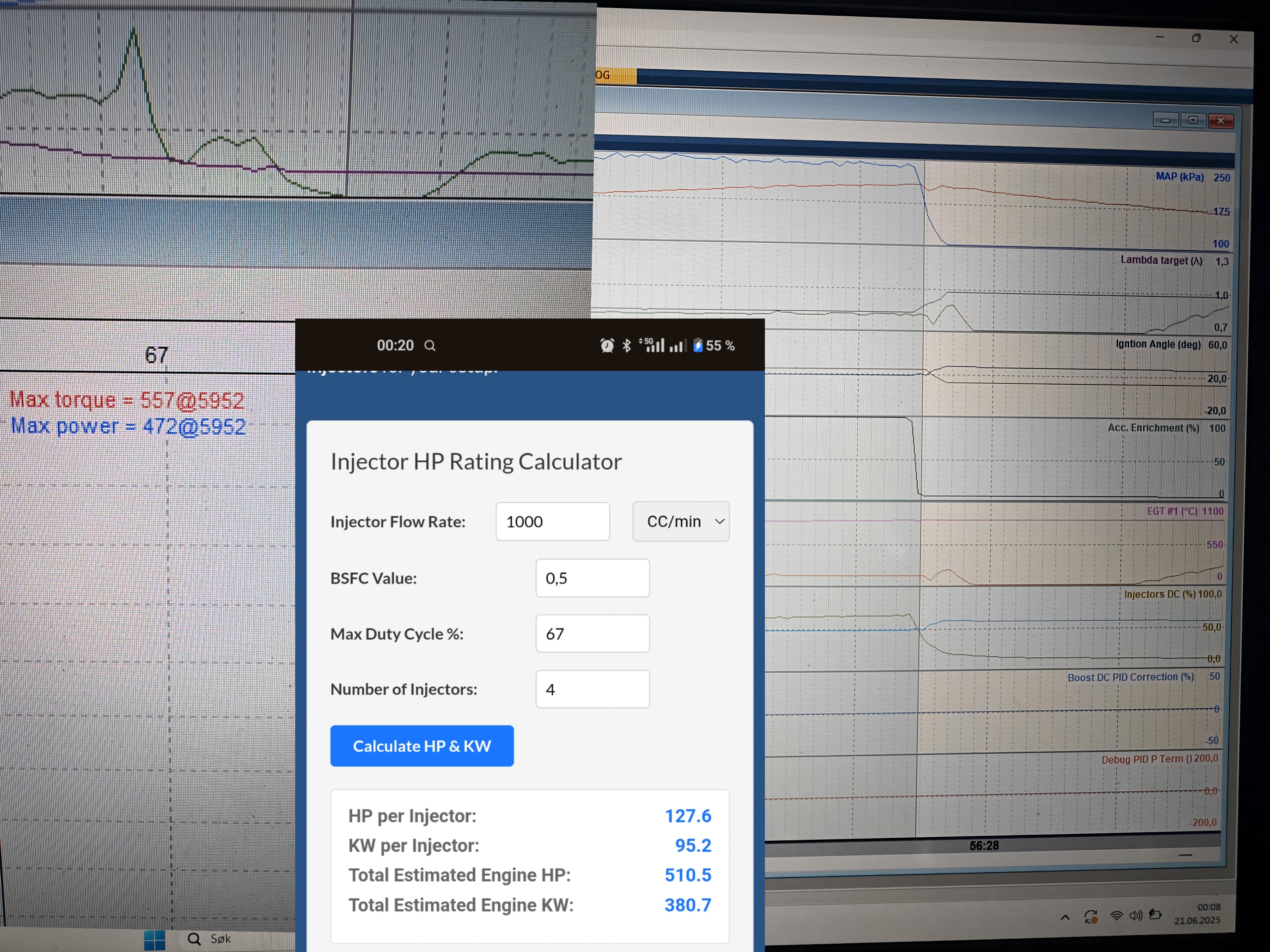

1.4 bar boost, all checks out good so far.
