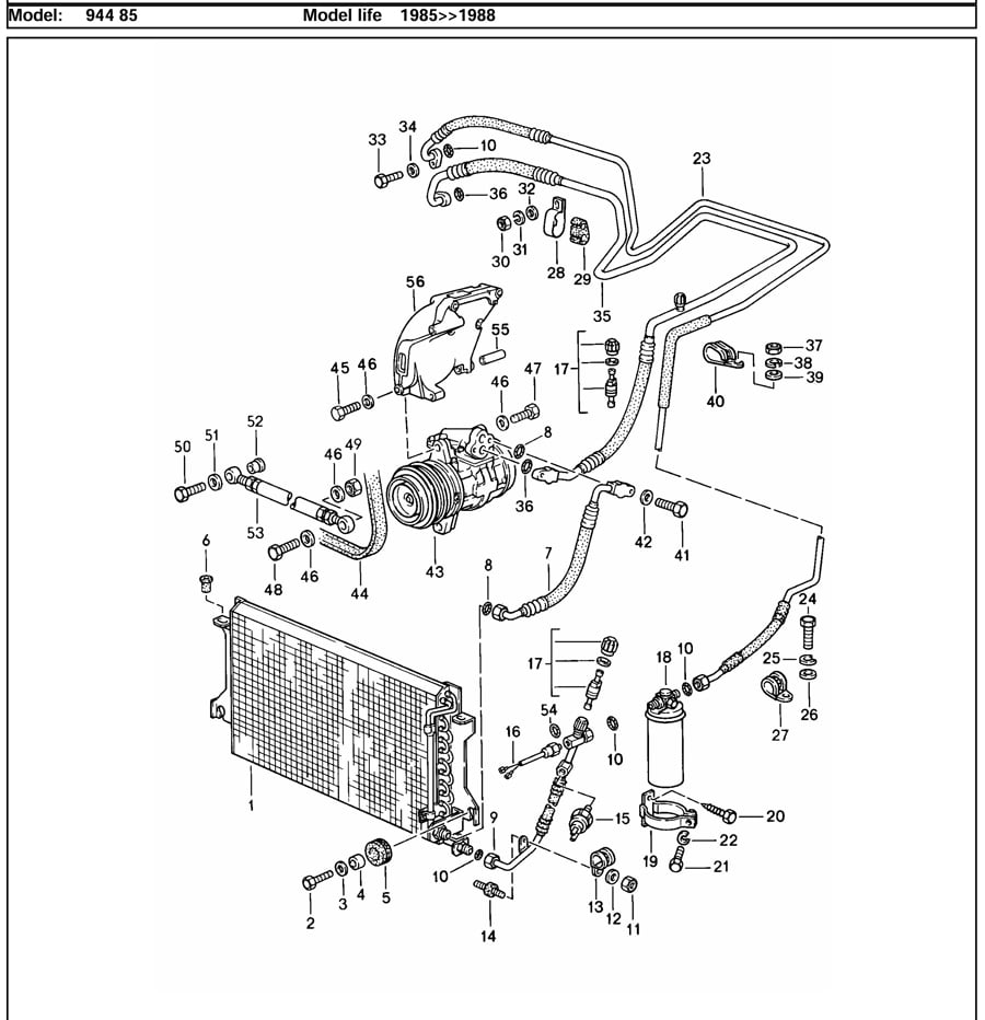

As I’m going purchasing parts for the conversion, is there a specific 90 degree low side fitting that won’t interfere with the compressor bracket? It’s an early model and I want to make sure I order parts that fit the first time.

You can just put one or both adapters on and pull a vacuum to test. If you decide to not convert at that point, you can just remove the adapters. I'm lucky with my car because both ports are up by the strut tower. On the early 944, in addition to a 90 degree fitting, some people get a slightly smaller diameter belt, which apparently allows the belt to clear the adapter.

Ah I see, do you happen to know if a shorter belt is a requirement for the 90 degree port to fit?

I'm no expert on the early cars so hopefully someone will chip in on that, maybe @gb951 ? I know others have said they needed a shorter belt, but I can't personally vouch for that. It may depend on the specific fitting you use, and how you position it. Napa sells one that looks pretty compact...

I have filled my early 944 AC using a 90 degree adapter. I did not use a shorter belt, but I did notice that the belt was pretty loose during the process. Once the refrigerant was installed, I removed the adapter and adjusted the belt and all was good.

The 90 degree adapter I bought requires me to remove the valve core so I won’t be able to remove the adapter after. Oh well! I’ll play it by ear and see what happens. My last two questions are ab some additives. Is it a good idea to add some UV dye to the system to make it easier on finding leaks in the future? Or will that be bad for the health of the system? The same goes for my 100 W ester oil. Is it bad if there are any additives in it or does that not really matter?
