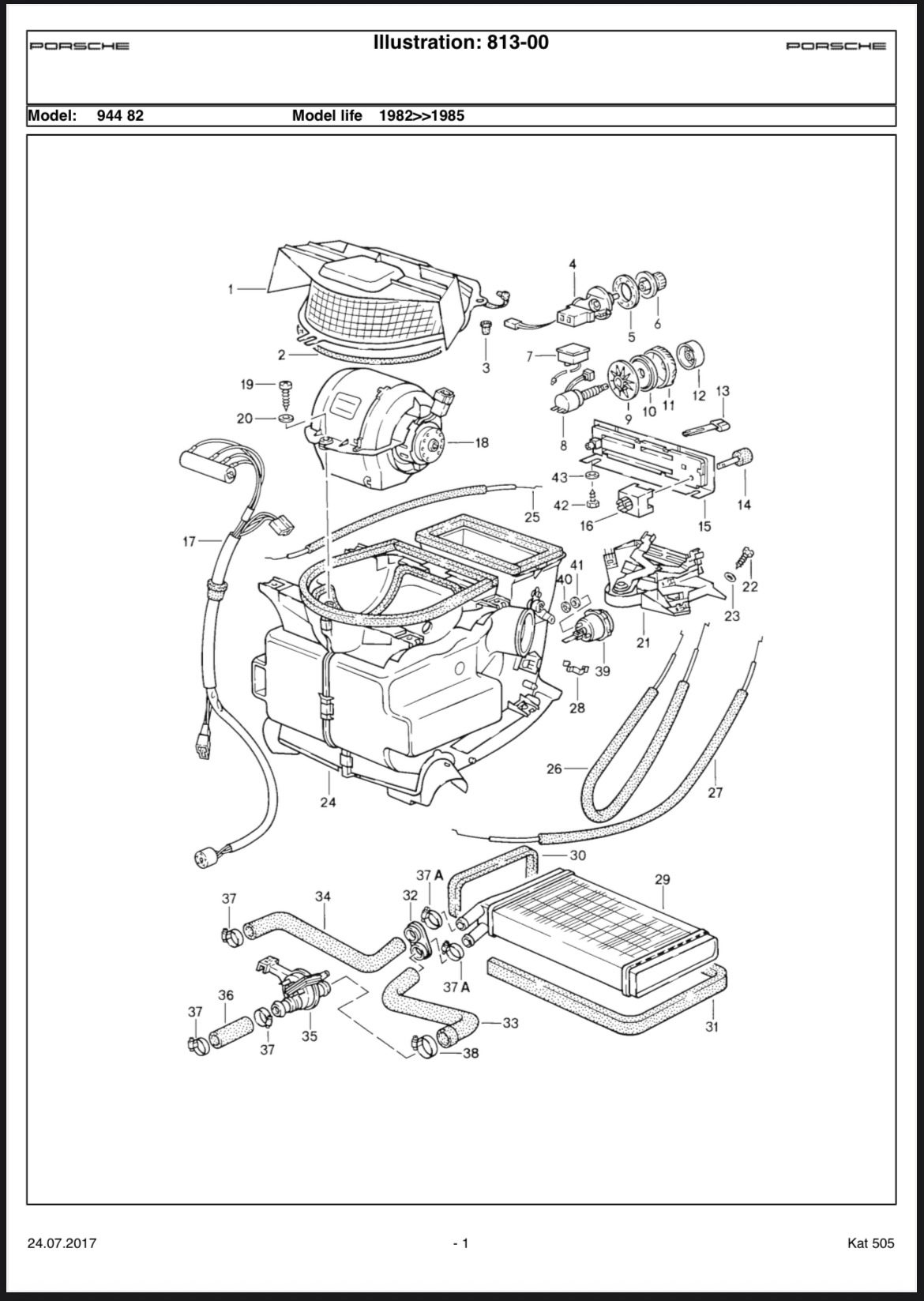

Hey guys, I’ve been trying to figure out what’s wrong with the ac in my early 944 and I’d like some help. My first thought was that I had ran out of r12, so I went and checked that. When I press the schrader valve on the high pressure side some gas shoots out so I can only assume that. I did also notice that the line for the vacuum unit (944 573 053 00, #39 in diagram) has snapped off so i wondered if that was the case as well. I moved the plunger to see if that would do anything but it made no difference. Where would you guys start looking next if you were me?

That just controls a vent door. Check all the hoses, compressor and condenser lines for any oil or dirt covered oil, which would indicate a leak. The evaporator is harder to check as it’s behind your glove box and requires dropping down to investigate. Mine was leaking from the shaft seal on the nose with the compressor behind the clutch pulley. It was obvious from all the oil and dirt. If all that seems fine it could be your low pressure cut off Switch kicked in because you’re low on refrigerant. You can test test this with an ohm meter. You can also jumper the compressor to see if the clutch kicks in bypassing the low pressure switch. Only to do this for a few seconds, however.

That was my first thought too. Also, look to see if the compressor clutch is engaging. If not, maybe put a set of gauges on it to see what's really in there. I wouldn't rule out low refrigerant just because it hissed -- it will make a good hiss well below the pressure needed to kick on the compressor.c5_pilot wrote: Fri Jun 13, 2025 9:41 am You can also jumper the compressor to see if the clutch kicks in bypassing the low pressure switch. Only to do this for a few seconds, however.
