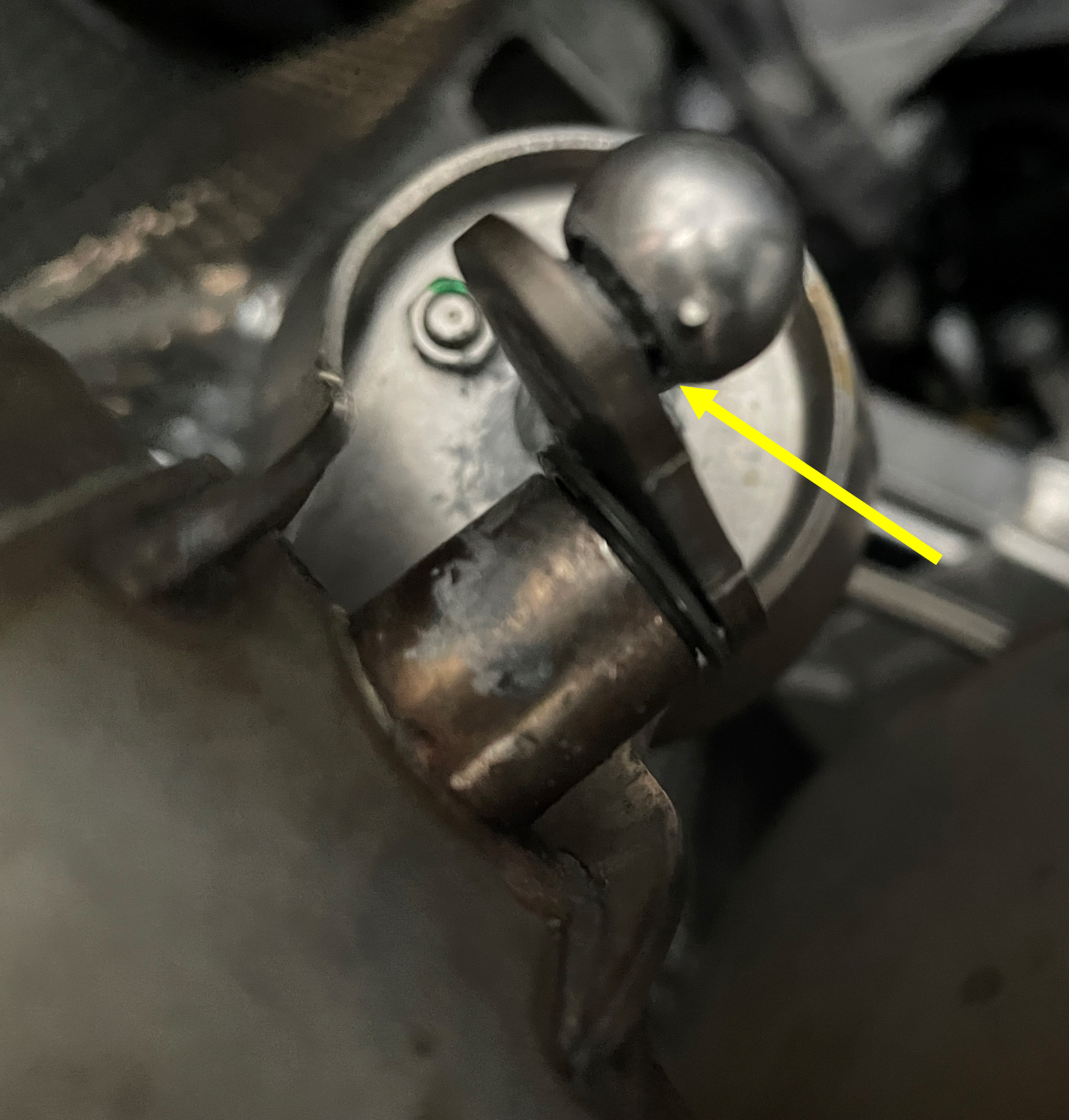

My solution I would say reduced it by 80% or so, but after time I could def hear it a bit again. I might try the wire.
But, I noticed something when I was faffing around with it again. Look at the picture. That little gap also has some play when you open close the value with your hand. I might try some wire there, because the clips I have on are still on and there is no play in the main gap.

I could envision a spring-metal clip that slips into both joints at once like a speed nut, and keeps gentle pressure on both... ?

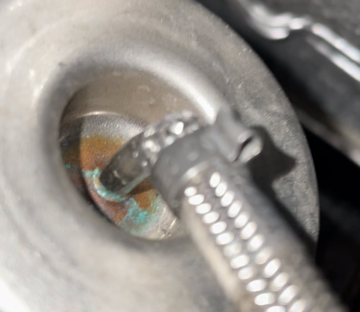

The rattle on my 718 was so loud. I installed 2 0.25” e-clips and it was still rattling… so I jammed 4 of them total. But they were kind of loose, so I wrapped them with an adjustable #6 hose clamp. I’m not interested in actuating it, as I added a small valve to the vacuum hose which is always closed, which keeps the PSE valve open all the time. I was thinking about welding the PSE valve open and be done with it, but this is doing the job so far. Absolutely no rattle.
