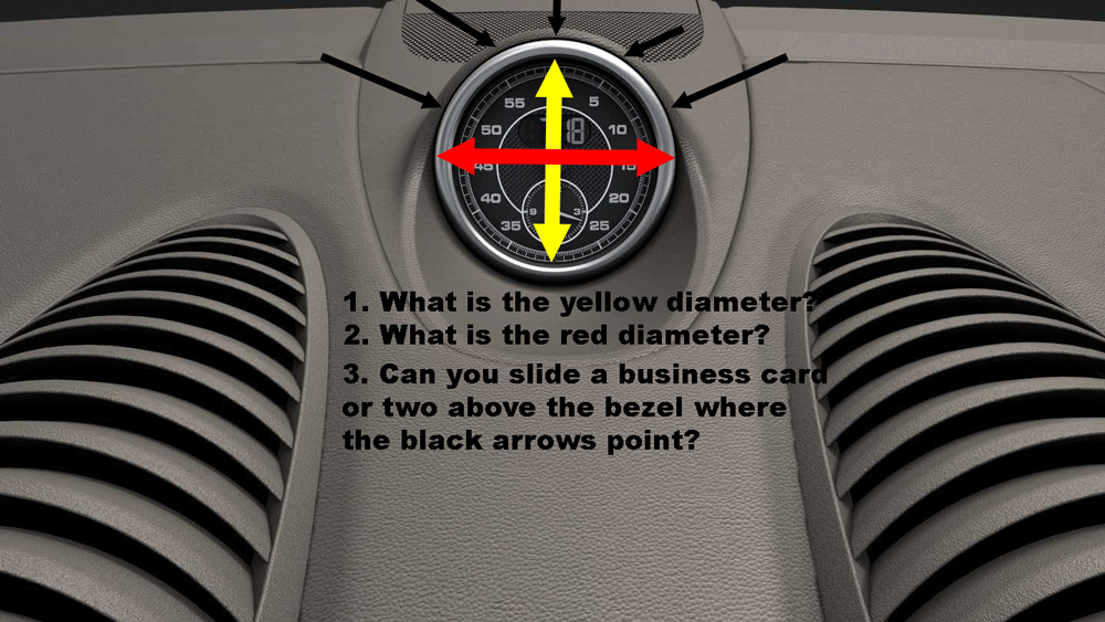

I had a cars and coffee at my house last weekend. It would have been so easy to check 718 v 992, etc.BzzzBom wrote: Fri Aug 27, 2021 1:56 pm Last night I looked at the sports chrono, on the Porsche configurator, for the 992 Turbo S, the new 992 GTS, and the base 911. I also looked at the chrono for the 718, Macan, Panamara, and Taycan. The 992 Turbo S has a unique chrono. The Panamara and Taycan have the same one as the base 911. The Macan has a compass instead of a clock / stopwatch. All the 718s are the same but different from all the other ones. From the configurator photos, I’m almost positive that the 718 bezel is different from the 992 Turbo S. Unfortunately, the only way to fabricate a 718 bezel cover is to have a local 718 owner come by your place.
FWIW, I also went by the Beverly Hills Porsche parts department. Each chrono has a unique part number. They were unable to provide me with schematic drawings.
Short answer - I think that your beautiful, fabricated bezel cover will probably only fit 992 Turbo chronos. If you are able to make bezel covers for 718s or non-turbo 992s, they will be fit many other cars.
As for the 718, if you wanted to try to come up with a design remotely, I'm game. We did these much more complicated speaker bracket over the internet:
viewtopic.php?f=4&t=67&start=70
Assuming your bezel looks like the one in the picture below, maybe we start with these three questions if you're game...

My car is being built in September with a port eta of Nov 19th. As soon as I get the car I’ll take all the measurements. If I see a 718 at my local dealer before then I’ll come up with some excuse to measure the bezel. Thanks for all your help. I’ve been retired for almost 10 years and I love getting into the weeds with car stuff. My wife calls it OCD.
