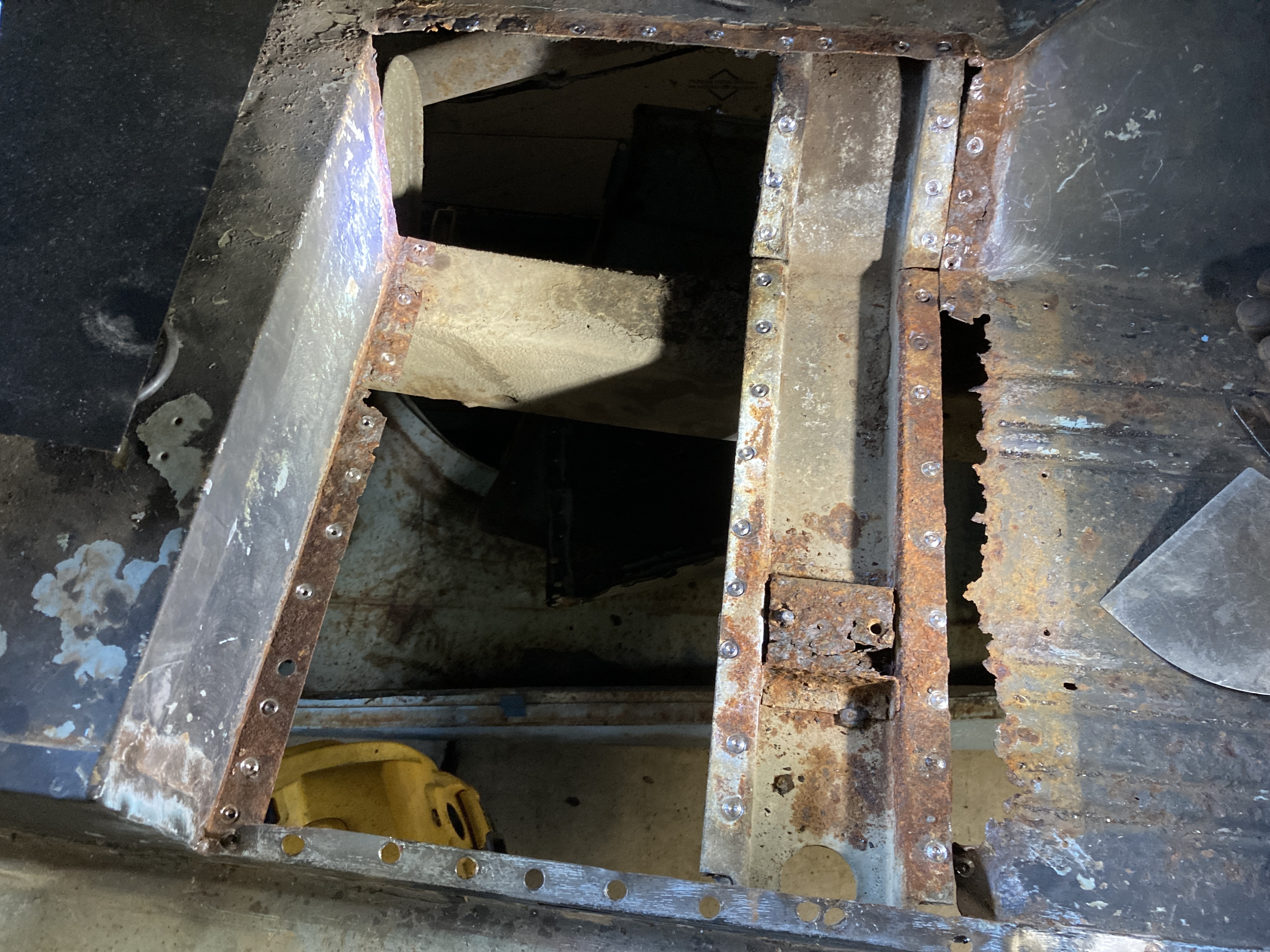

Rust repair has begun.

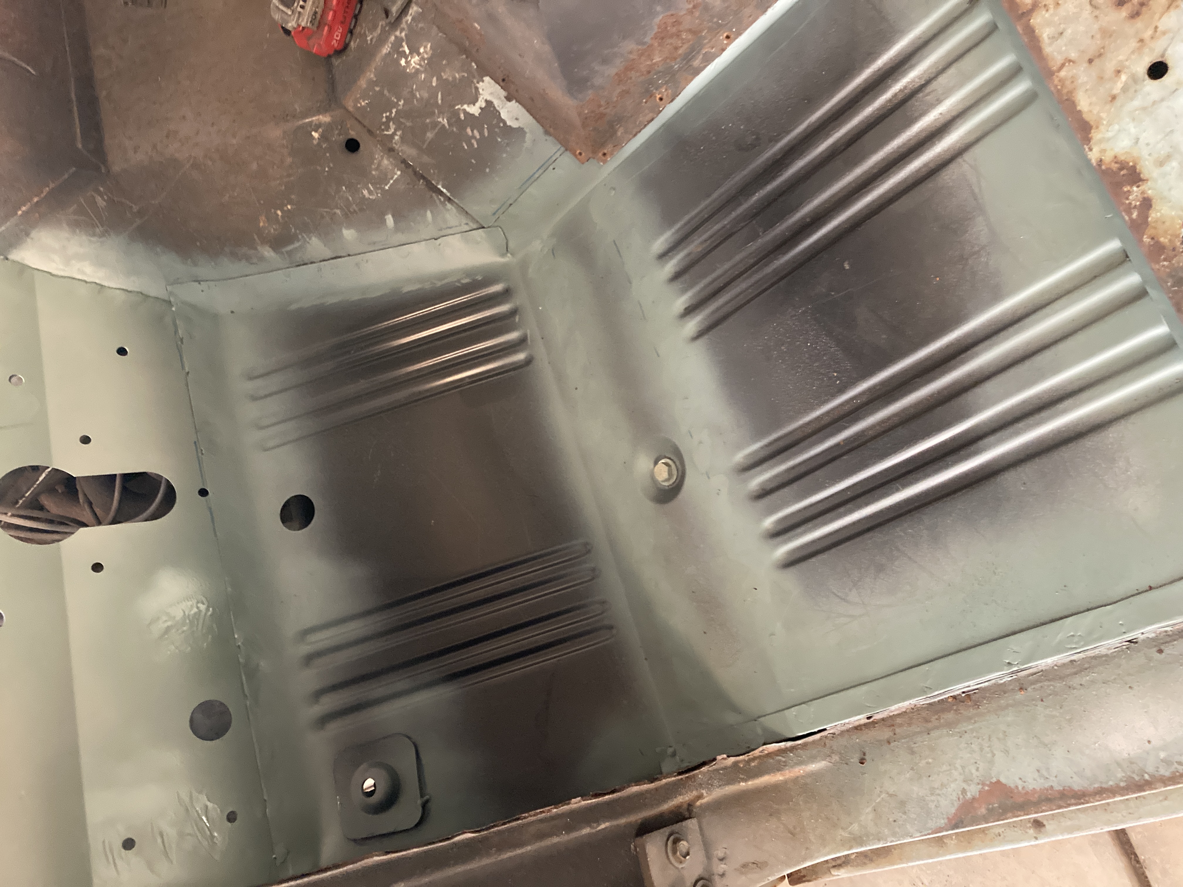

Passenger floor is all done, save the seam sealer which will be done after the driver's side is finished so I can do it all at once. Very solid feeling, should be good for many more decades.

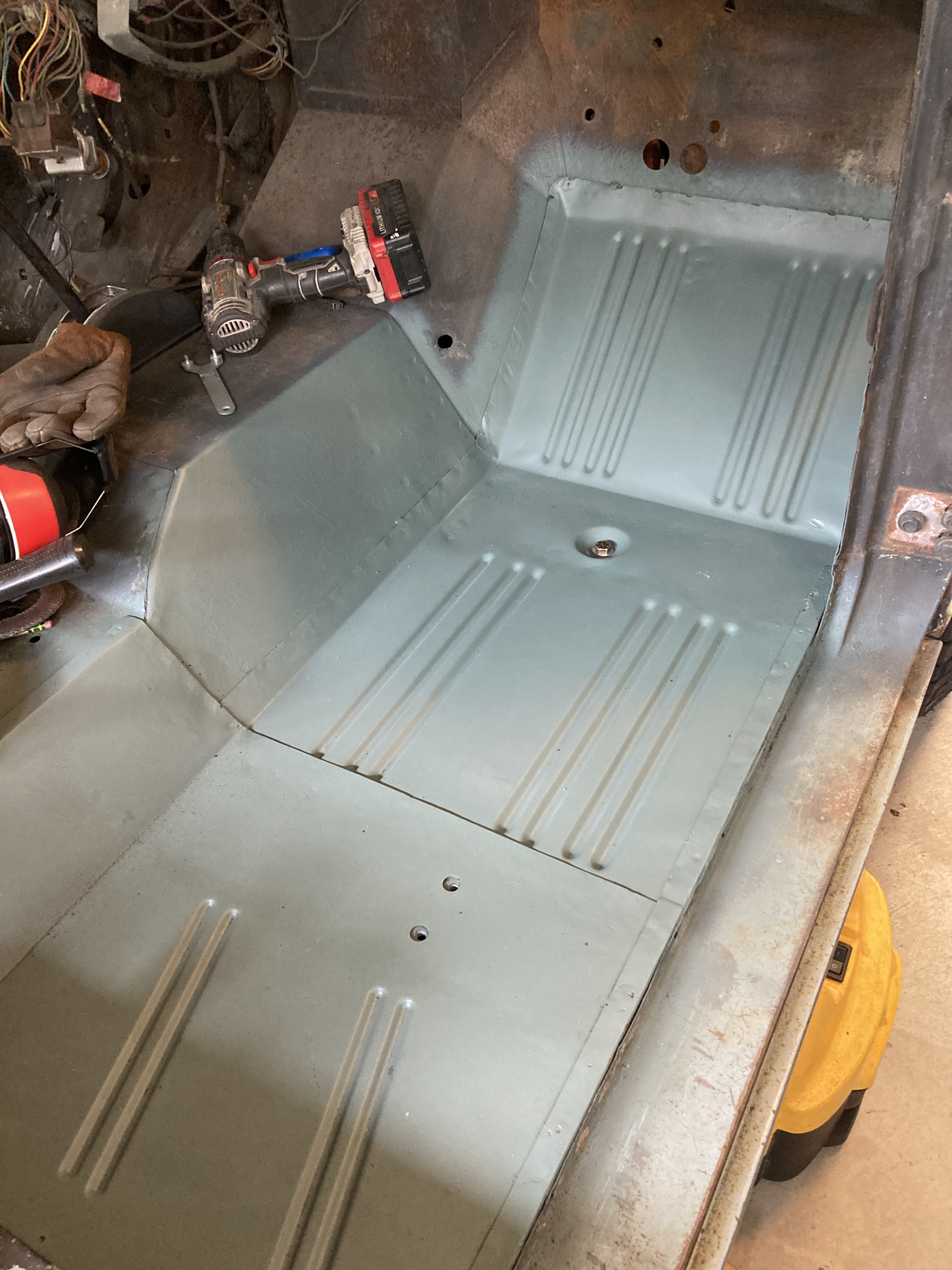

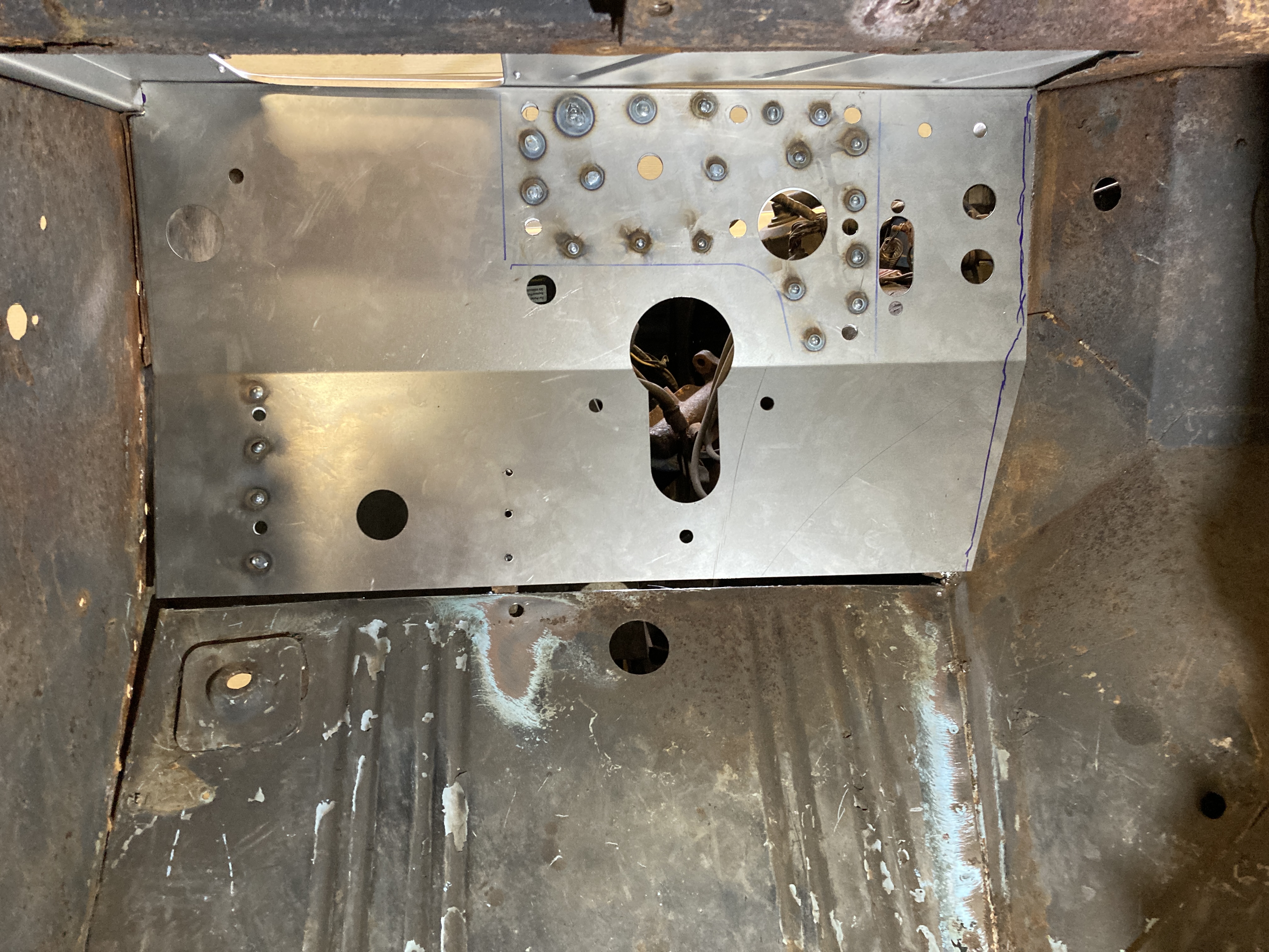

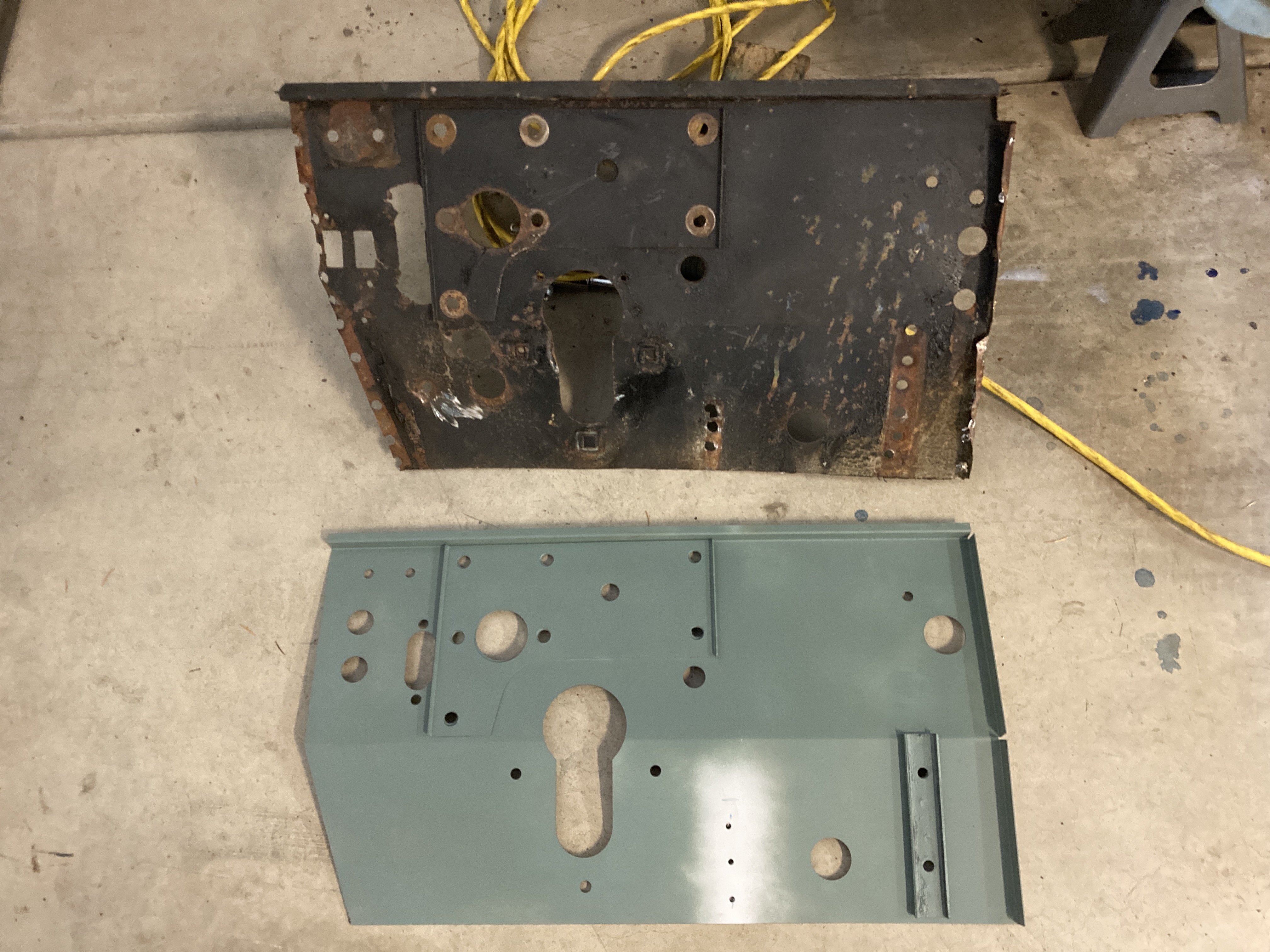

And now the driver's side is complete as well. This side needed a repair panel for the firewall too. Now working on replacing the rusty cowl assembly so I can weld on the new windshield frame. New doors are also on their way, which (I hope) will be the last of the major sheet metal.
