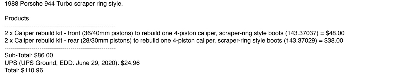

I did this job a year ago when I powder coated the calipers on my old 88T. I bought all of my seals through zeckhausen. I can't find the seals on their website anymore but give them a call and see if they can still source them.
Image 7-19-22 at 5.58 AM.jpg (77.11 KiB) Viewed 531 times
https://www.zeckhausen.com/catalog/index.php
I ended up having a lot of damaged pistons (some sizes are very hard to find and expensive), this project became a money pit.

I found their pages on their site for it, and they're Centric and back ordered. Still at square one.
I ordered a caliper compression tool, I'm just going to go ahead and change my pads and rotors, and also inspect the brakes and see if it's truly needed today.
Still figuring I can probably find the right seal a similar brake if I look hard enough. Dust caps though? Probably not, I just need the actual fluid seal.
