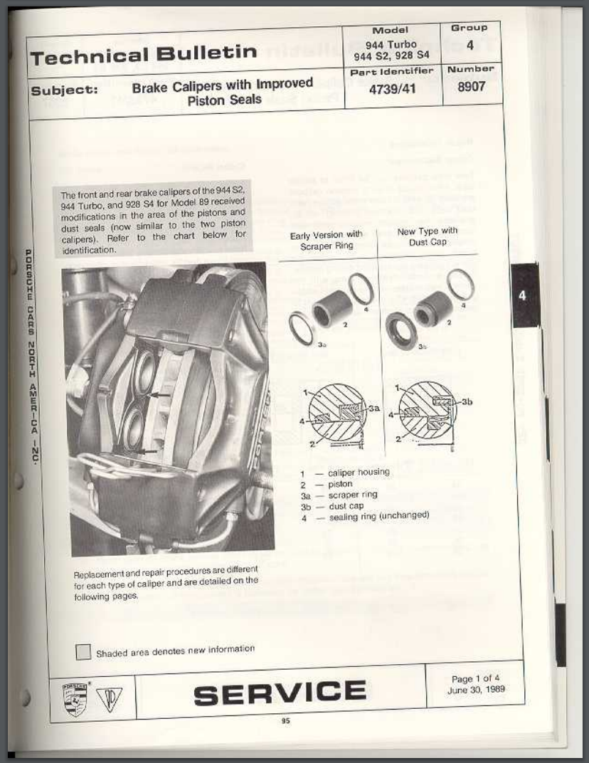

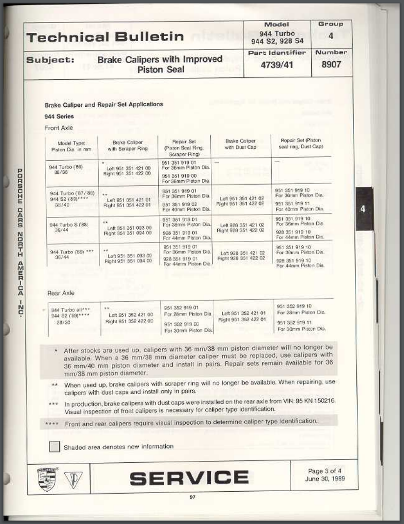

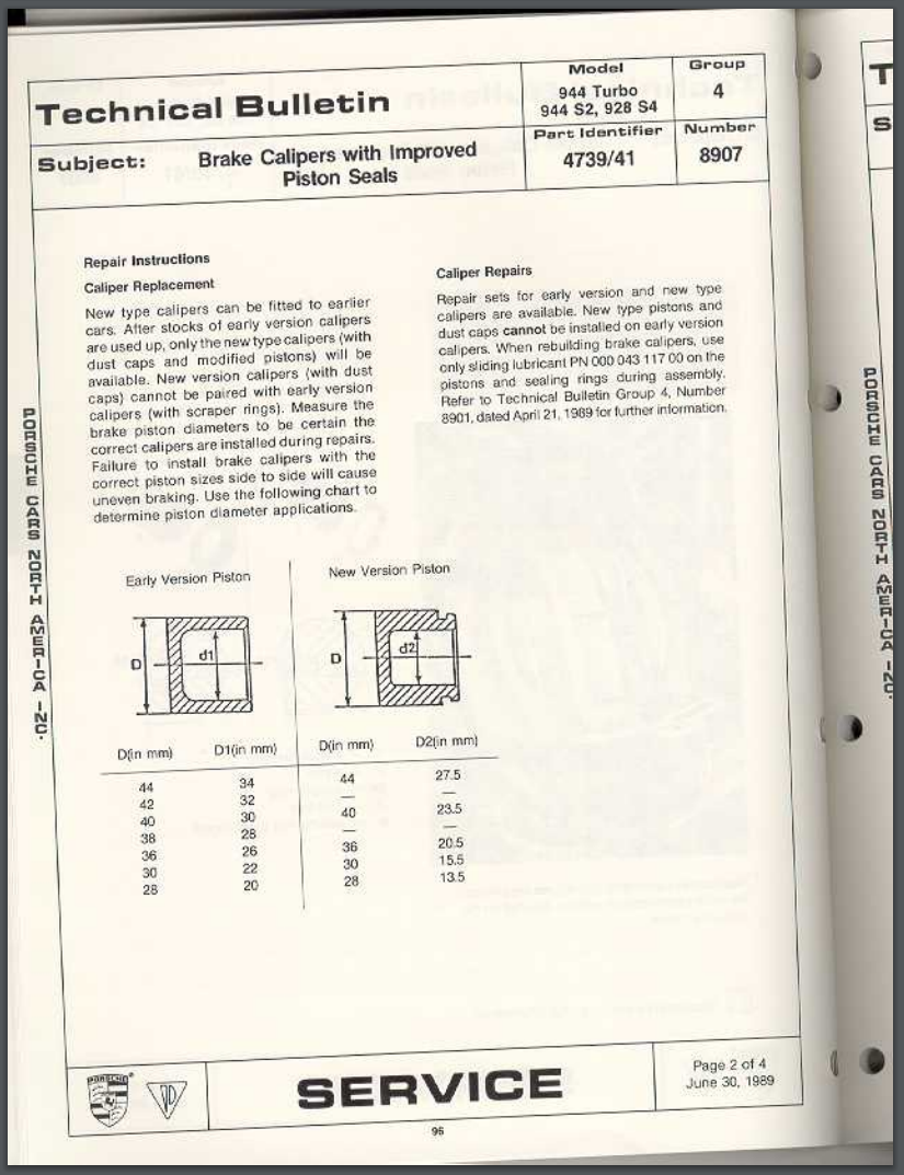

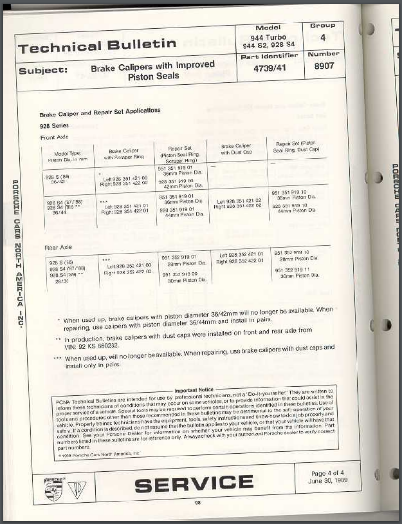

Those are for the 'scraper ring' style brakes. I have protection cap style brakes, which started in 1989. I attached pics of TSB 8907 which was about that changeover.

When I got the '86 kits from the dealer, they came in Brembo packaging.... I do remember them being pricey but I'm guessing the parts Paragon sells are the same things that PCNA sells.... Thanks for the TSB -- it's all coming back to me now (kind of), just remember it was a pain to get the right ones for my brakes, and that I needed one kit per piston (so 4 kits).....
