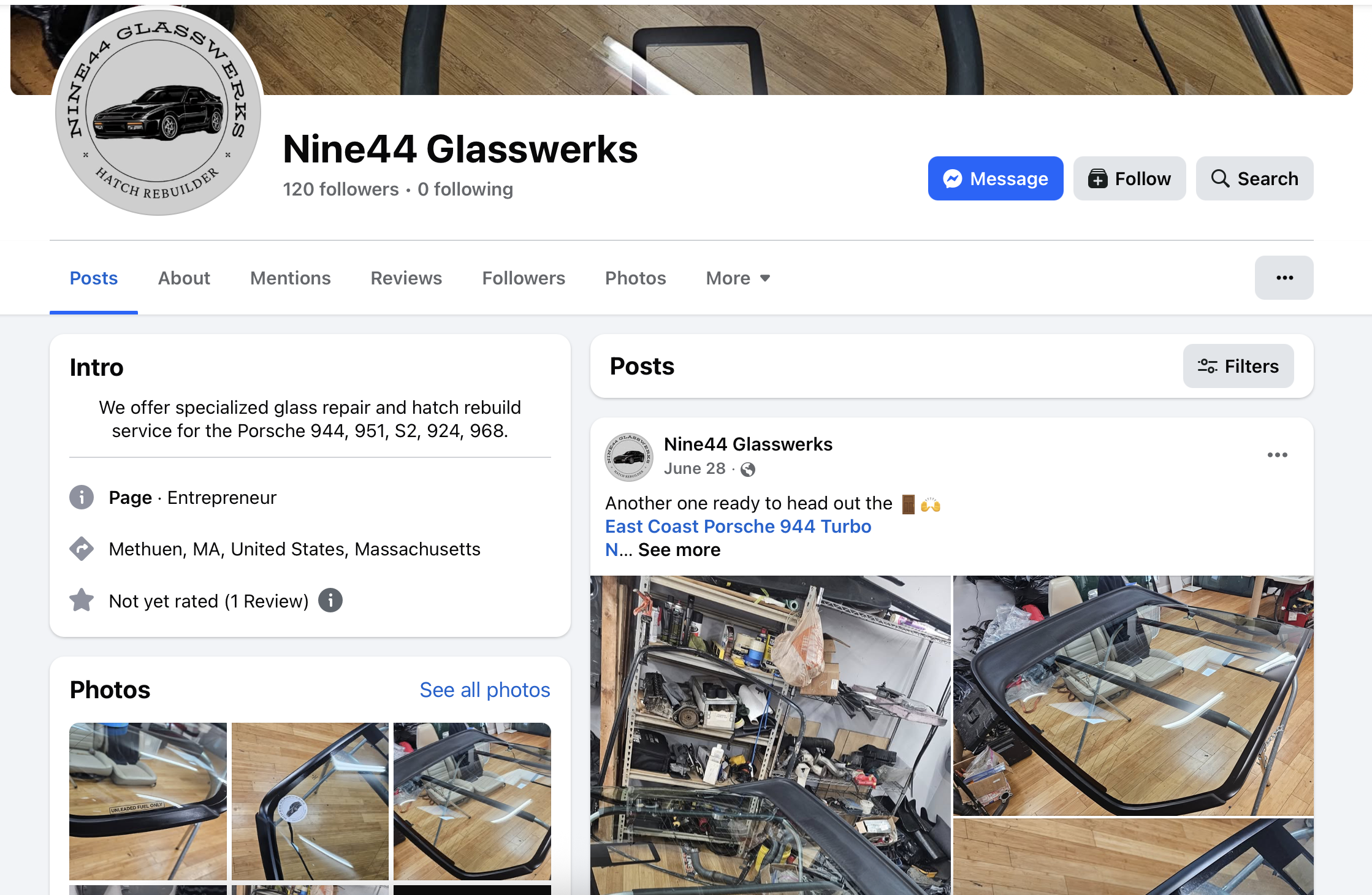

For repair, there is Jose Cacaro on the east coast (Boston?) who has worked out a system to refurbish hatches and repair delamination. Here's a screenshot of his FB page.

Can you post Jose Cacaro’s contact information please? I’m not on Facebook

We should get him over here on carpokes if he isn't already. :)

Group buy / pricing!

Tom wrote: Mon Aug 11, 2025 8:18 am We should get him over here on carpokes if he isn't already. :)
Yes we should! I have chatted with him on FB a little. Last I heard he was trying to figure out a secure way to ship. Seems he is our only hope for a properly repaired hatch. If there was a group buy, I'm in ;)

And I thought fixing hatch delamination was a mandatory requirement to 944 ownership! Glad to see someone is willing to fix these.
For now, after having done this job already, I’ll just leave my struts disconnected and rely on an assistant to load the groceries while I work on my biceps.
