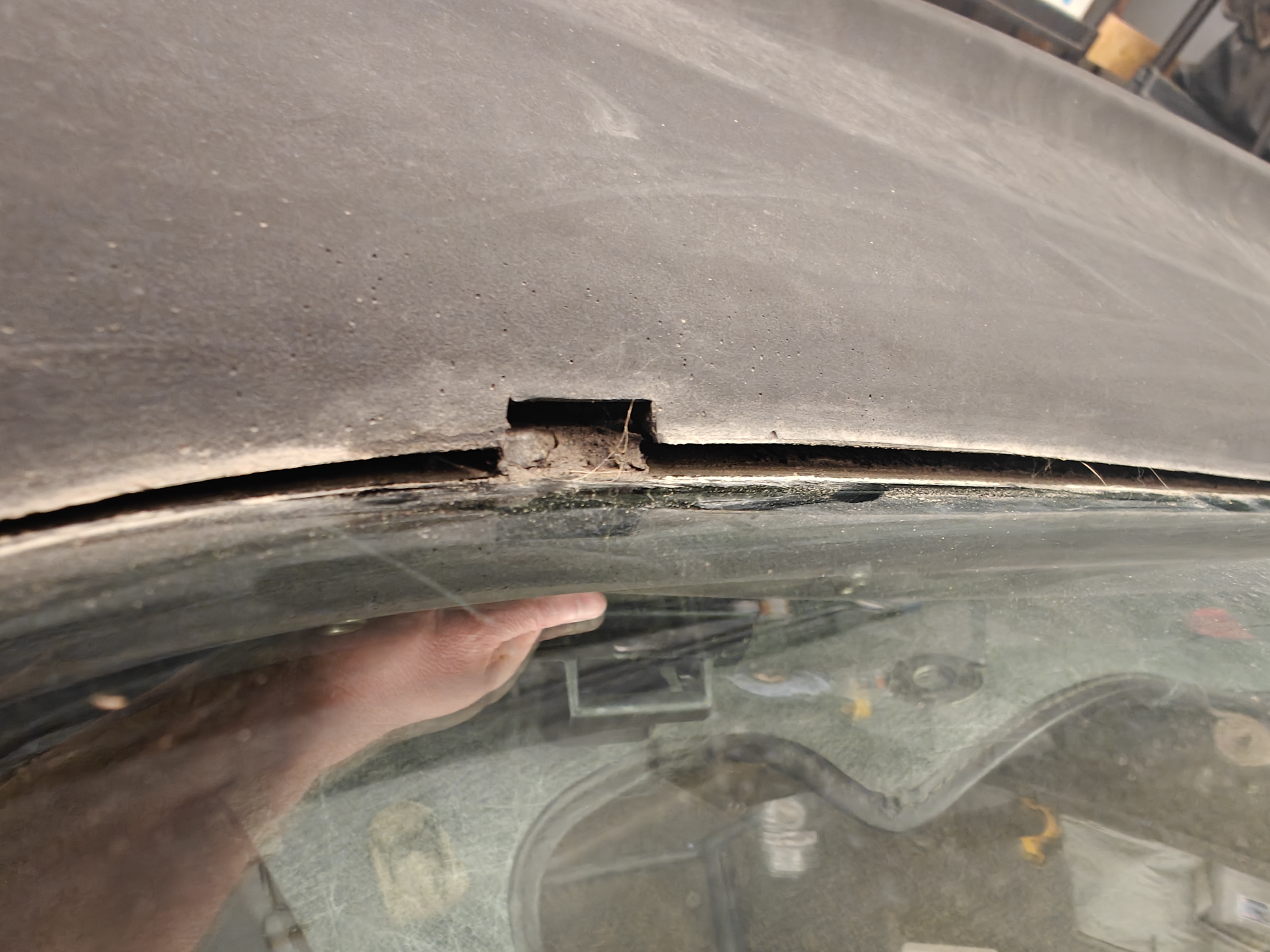

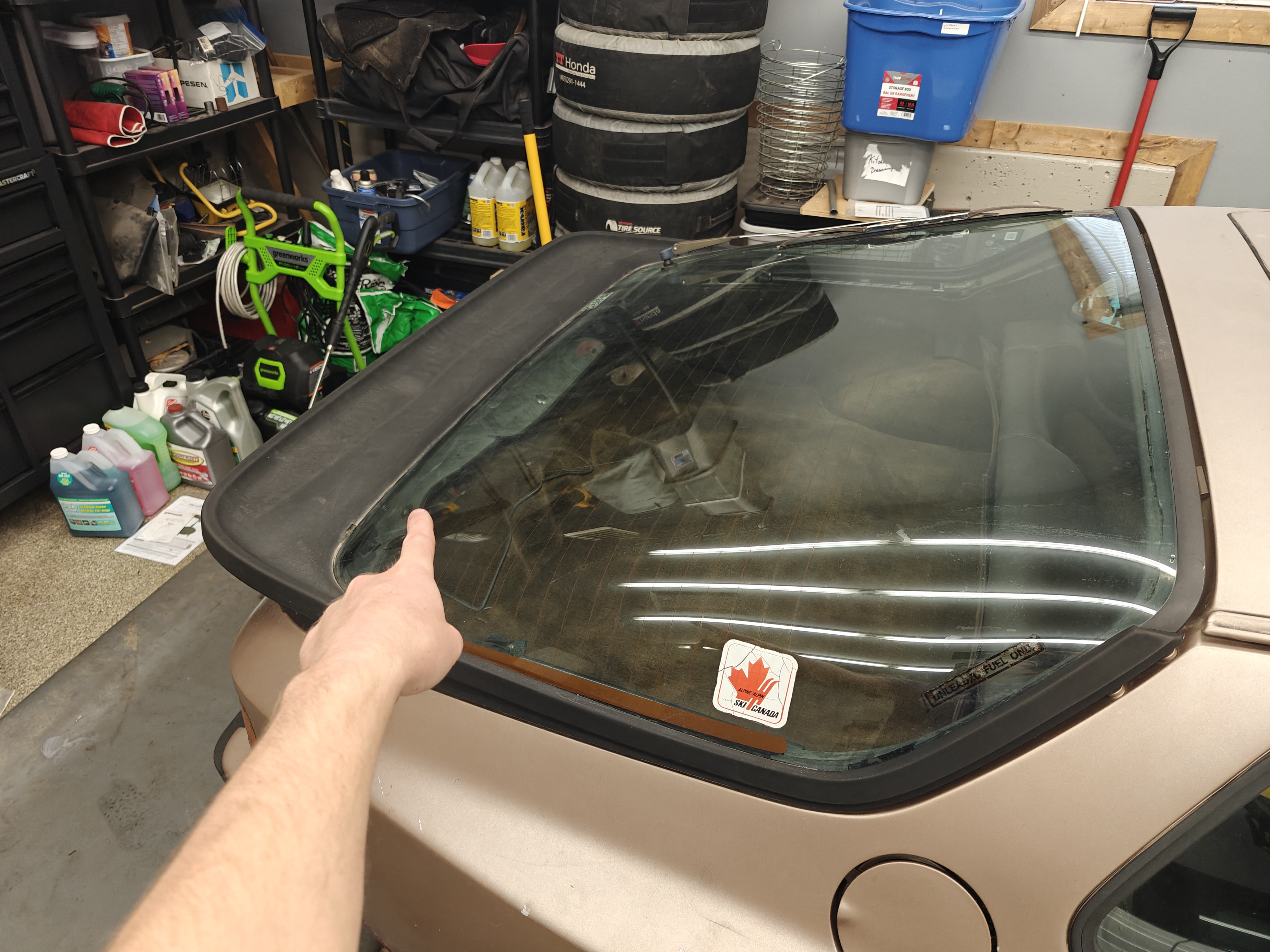

Mine isn't leaking at the top, it's leaking at the bottom, where I'm pointing here:

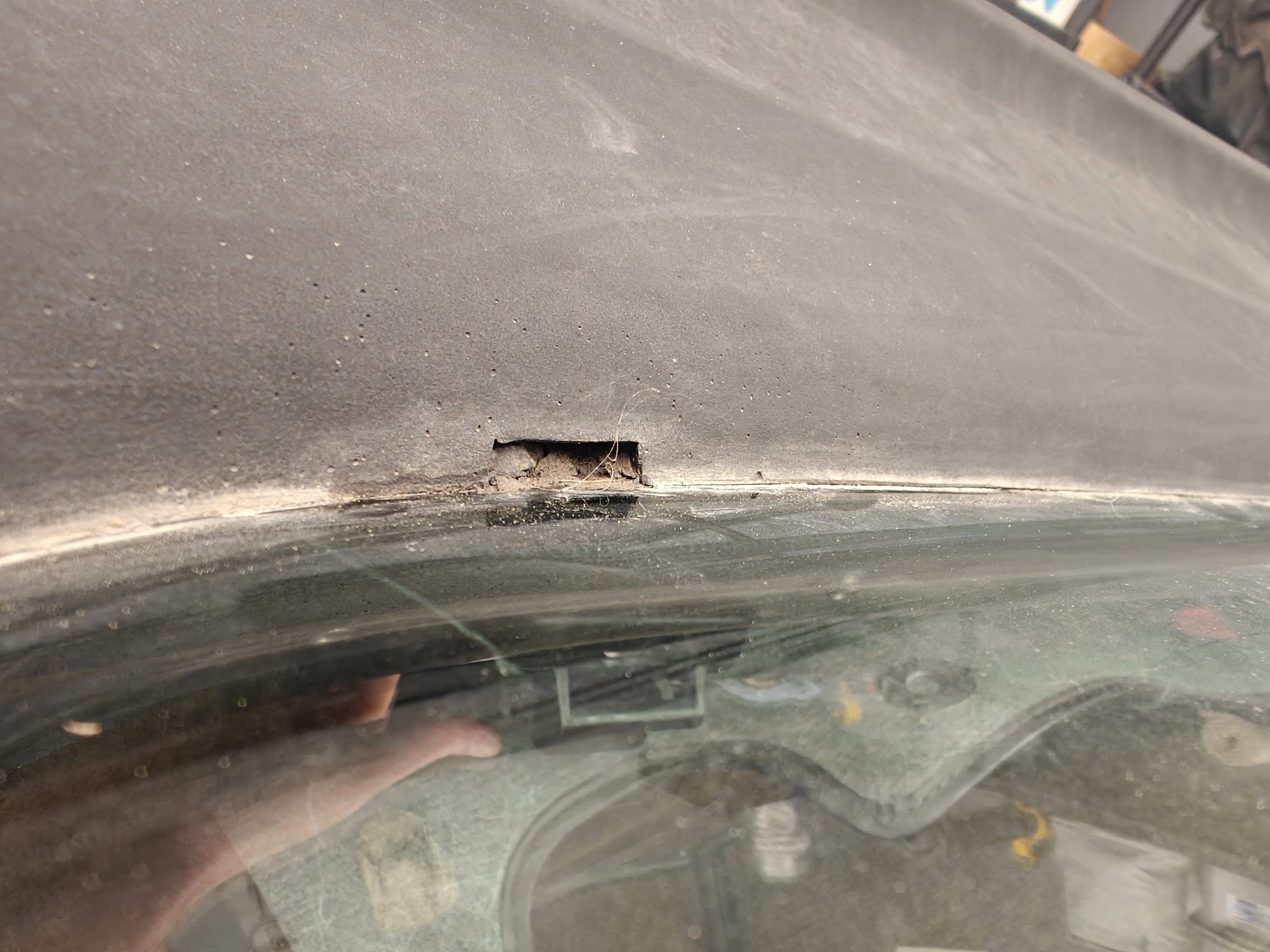

This is a close-up of the area, is this hole supposed to be here?
And this is when I apply downward force at the rear of the spoiler. Is this normal?

For the bottom half you’re pointing to, fingers crossed, is only dust & debris. If all checks out rust free I’d preserve what’s there with a quote for a new rear seal and/or respray while it’s apart.
The determining factor being on how long you’re planning to keep the car.

Those holes are for water to drain. Looks like yours are full of junk. Whenever I wash my car, I stick a wire or something through there both from the bottom and top to make sure it's cleaned out. If water is pooling on the spoiler that might be why it's leaking. If it can drain out, it might not get inside.Deemar wrote: Sun Jul 27, 2025 12:28 pmThis is a close-up of the area, is this hole supposed to be here?blueline wrote: Sun Jul 27, 2025 11:44 am There is some discussion on a Carpokes thread here:

This. I had water leaking into my hatch carpet from the spoiler area and it was because the drain holes were blocked. Easy fix with a coat hanger or the like. Hope this works for you.mulsannetexas wrote: Mon Jul 28, 2025 8:20 amThose holes are for water to drain. Looks like yours are full of junk. Whenever I wash my car, I stick a wire or something through there both from the bottom and top to make sure it's cleaned out. If water is pooling on the spoiler that might be why it's leaking. If it can drain out, it might not get inside.Deemar wrote: Sun Jul 27, 2025 12:28 pmThis is a close-up of the area, is this hole supposed to be here?blueline wrote: Sun Jul 27, 2025 11:44 am There is some discussion on a Carpokes thread here:
