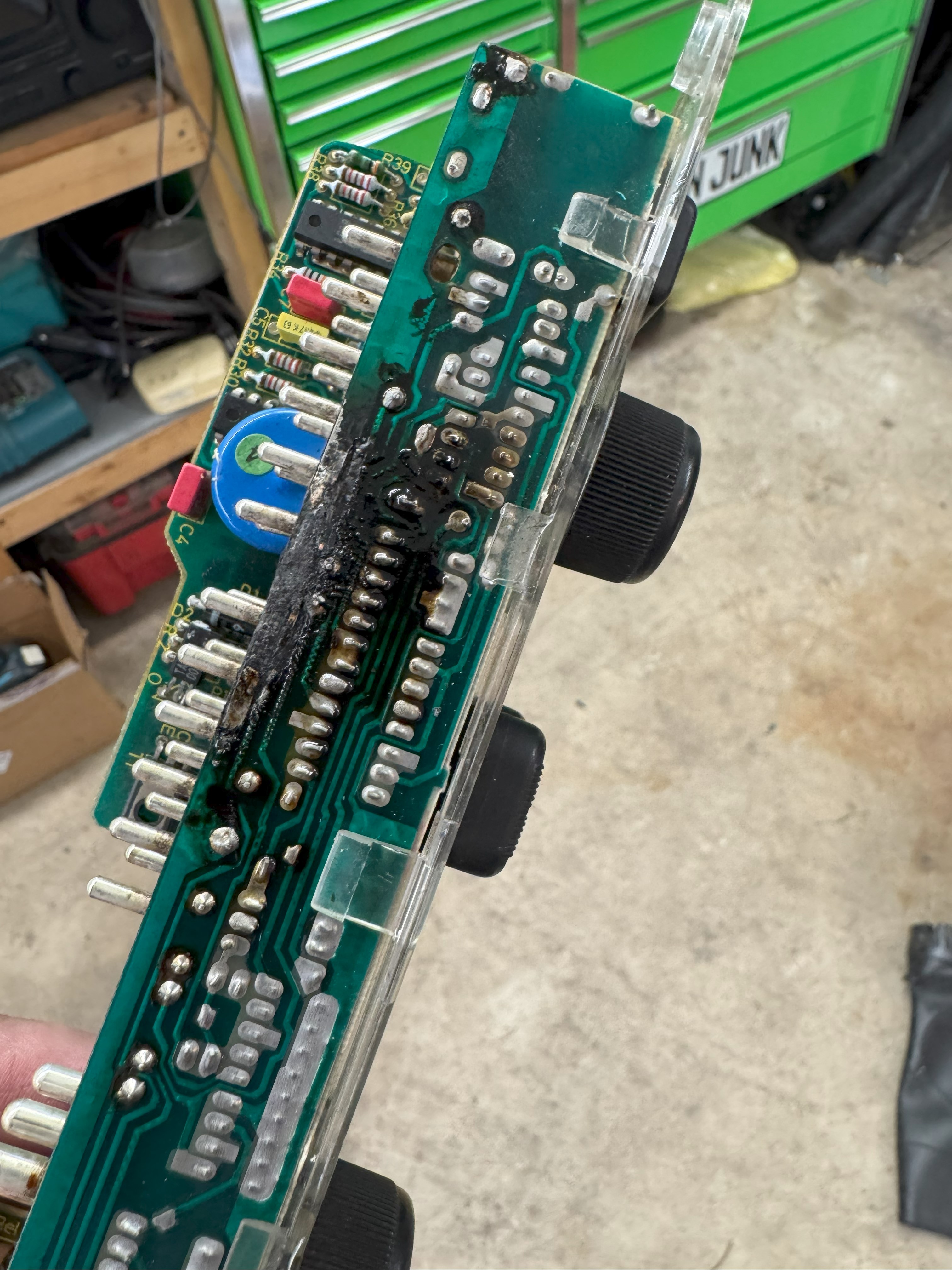

Ok So back at testing. While the car was running both #6s one to the body and one to the lower bell housing were carrying 23-26a. The #2 had like 2-3a to the factory spot. I moved the #2 to the cam tower just to test and it started carrying the load at 26a. and the 2 #6s were down to like 11. So something is up with that factory ground point.
But on other news with this I was working on the AC and the clutch is bad and smoked my climate control panel.. So theres that too. The AC clutch was pulling 60a trying to engage when I tested it. Can you buy a clutch kit alone?
