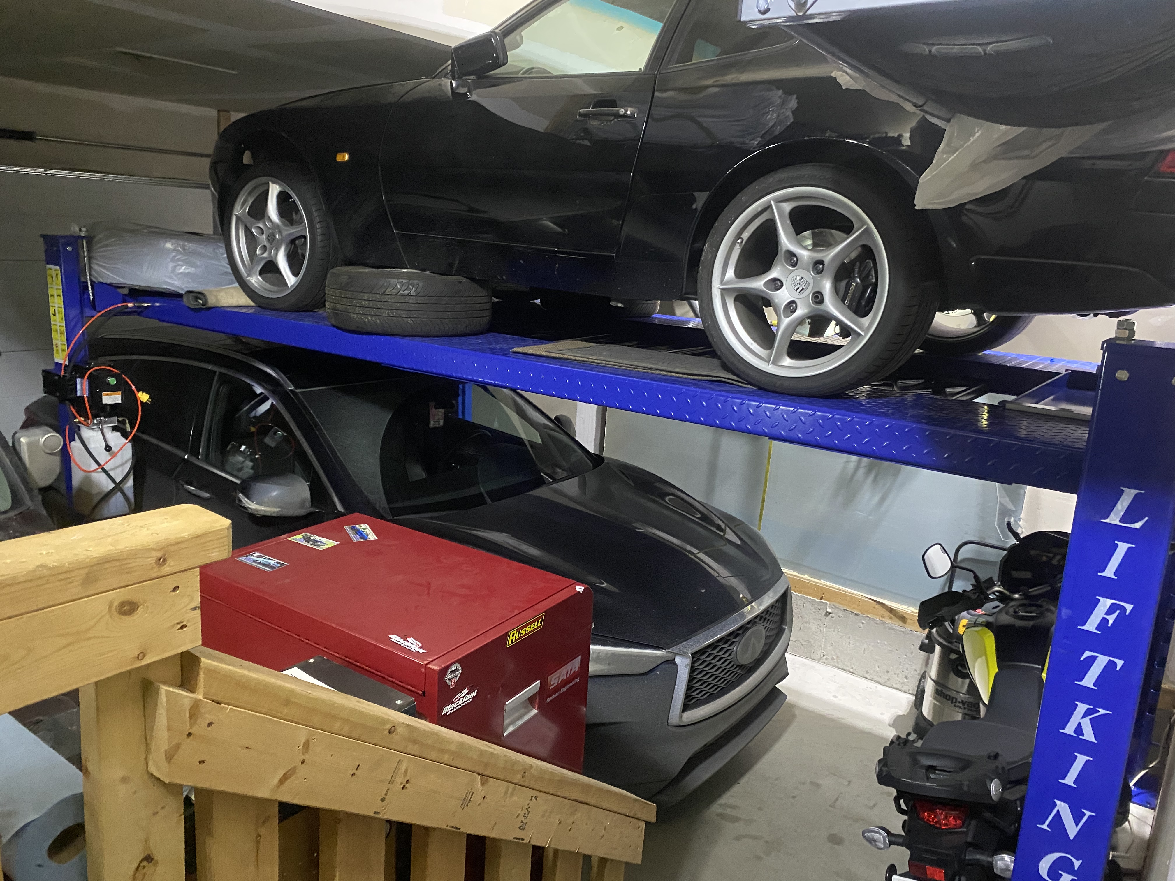

Done!
Posts: 9098
Been thanked: 4085 times

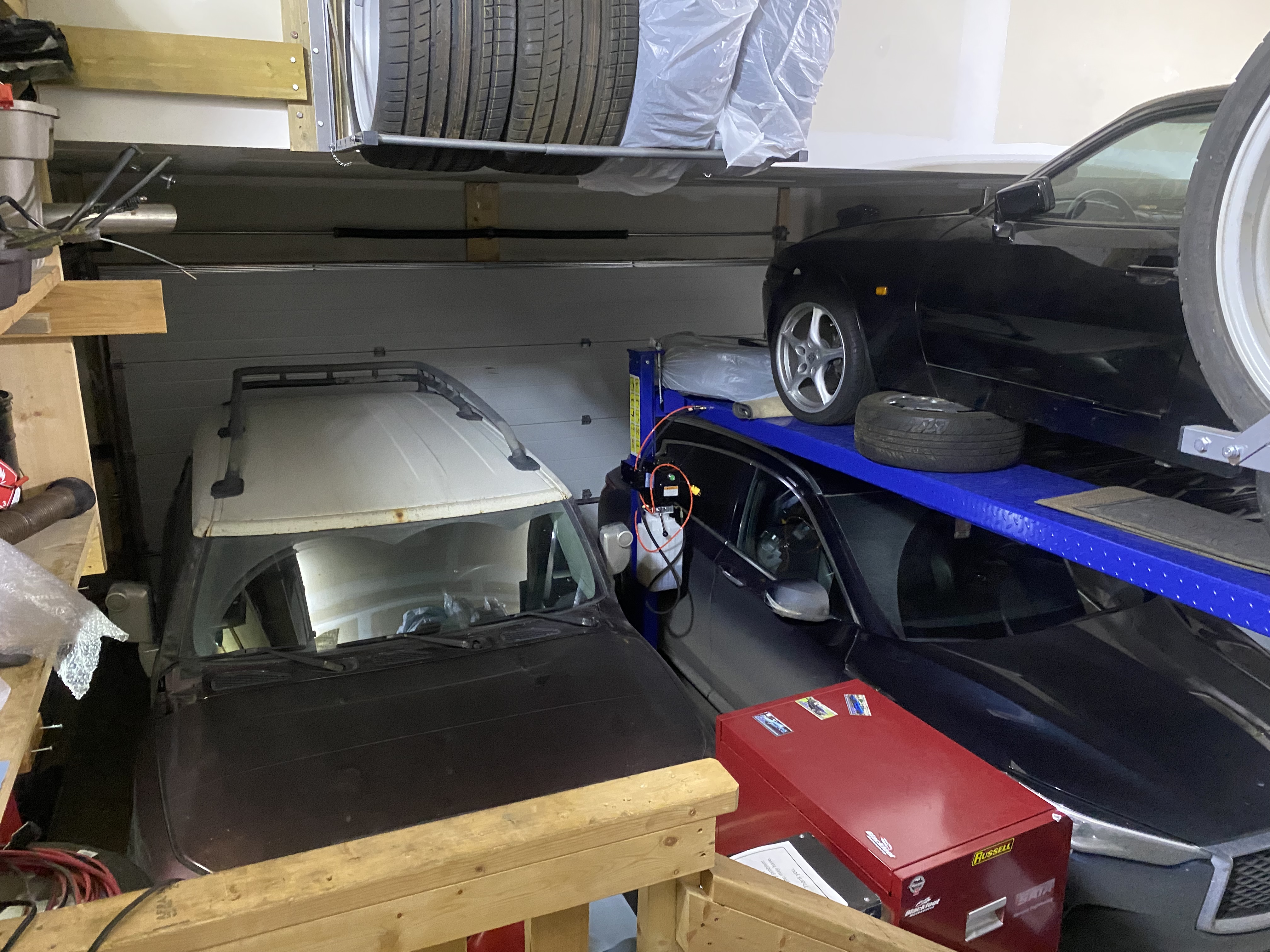

Now that's making the most of the space! How wide is that lift? The SUV looks like it's touching the post -- or is that just the picture?
gruhsy
Posts: 534
Has thanked: 48 times
Been thanked: 83 times
Just the picture
It’s a little tight but everything fits
I will have to put the FJ outside when working
I still have to move the tire rack in the photo as far to the left as possible then install my third rack beside it.
Total rack space is 100 inches which luckily fits in that space. Hence the loose tires that you see on the car lift
Here are the dimensions of the lift
