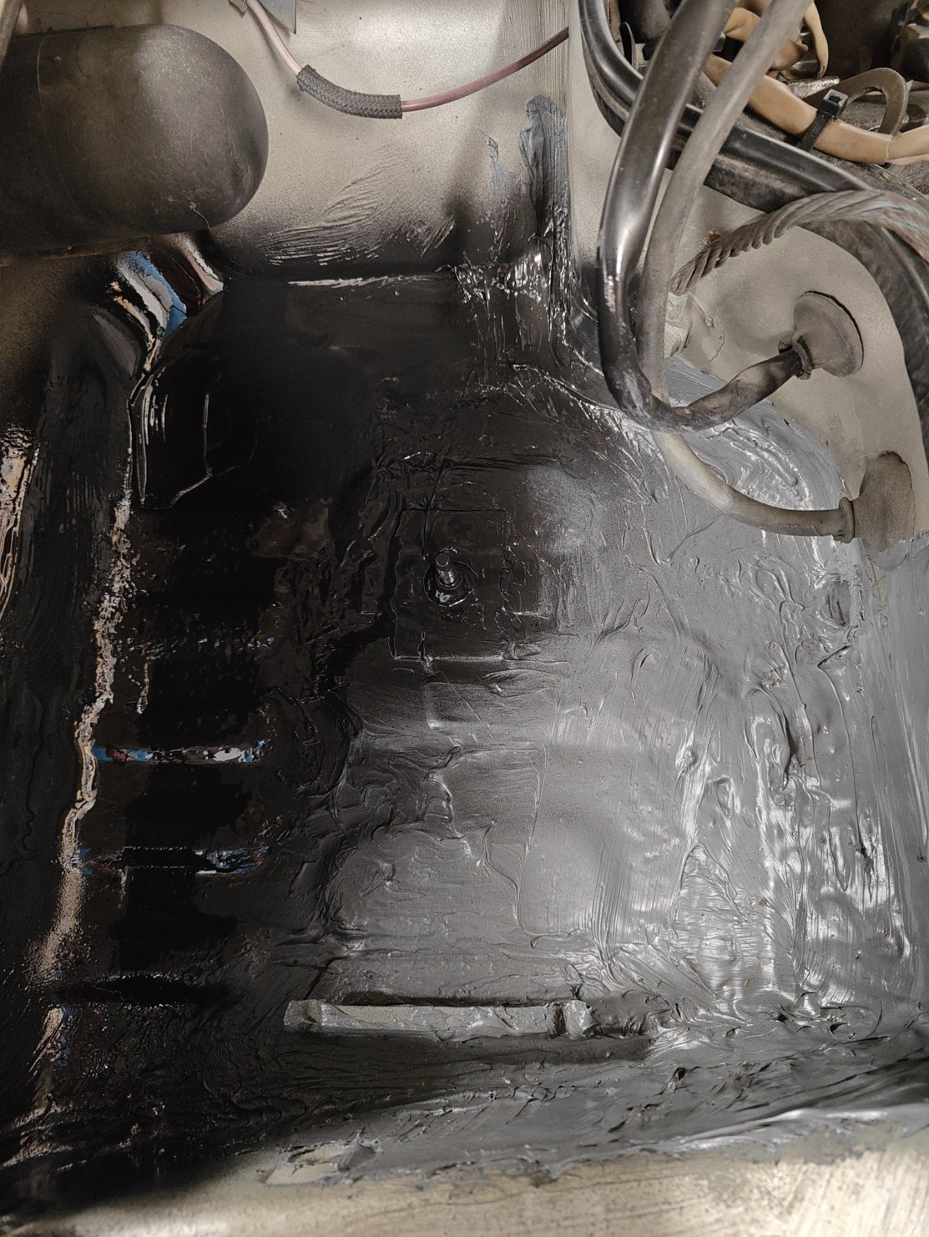

First up was 'fixing' the battery tray a bit more presentably. I used some cold-galvanizing paint and brush-able seam sealer.

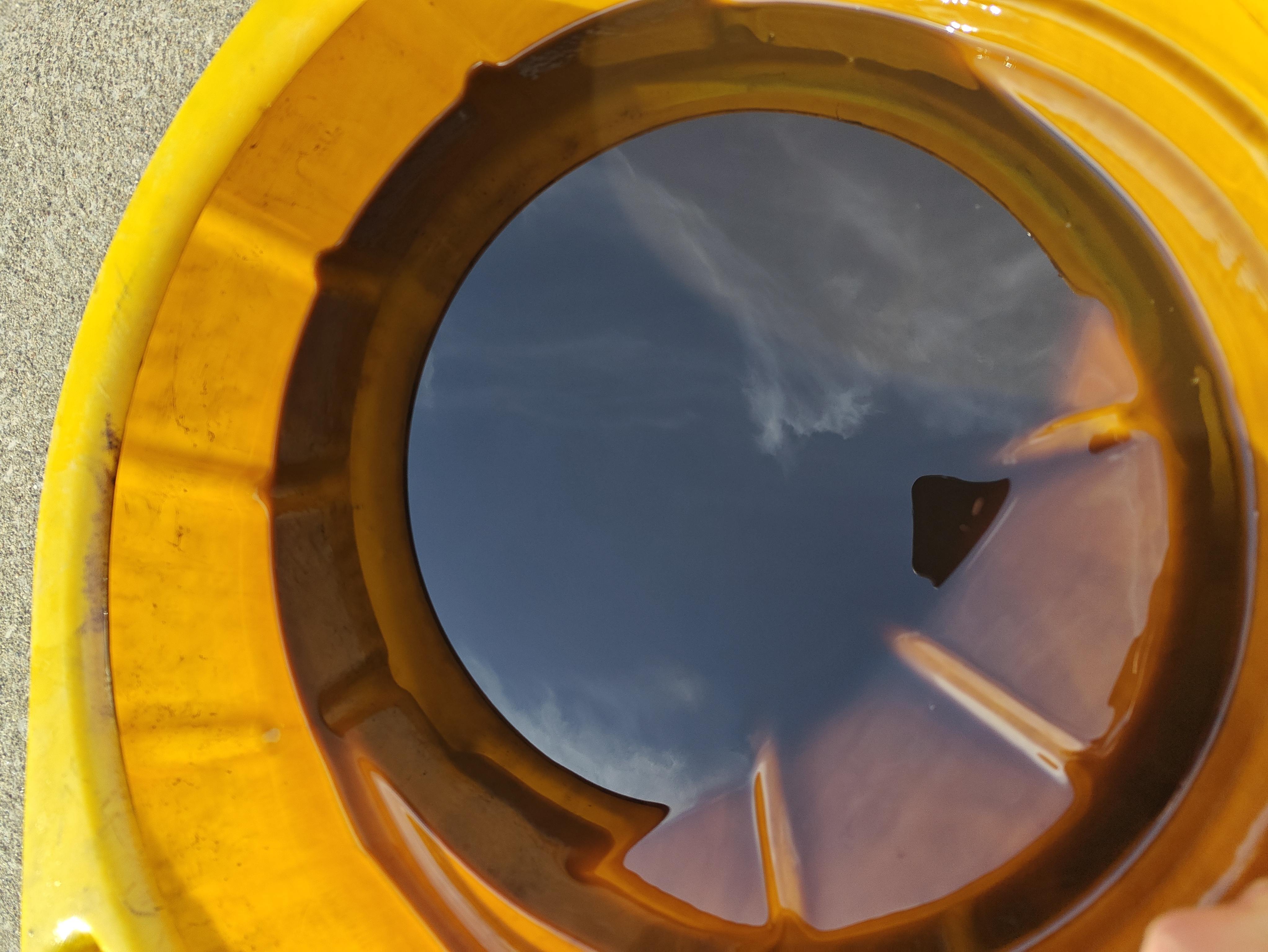

There was still a significant speed related whine from the rear so I got the trans nice and warmed up before dropping the fluid. It came out worryingly dark but didn't smell burnt. I didn't get things warm the first time I change it months ago so I'm hoping it's just sludge that was left behind. I filled it with some fancy Motul Gear 300 LS but didn't really notice any improvement.

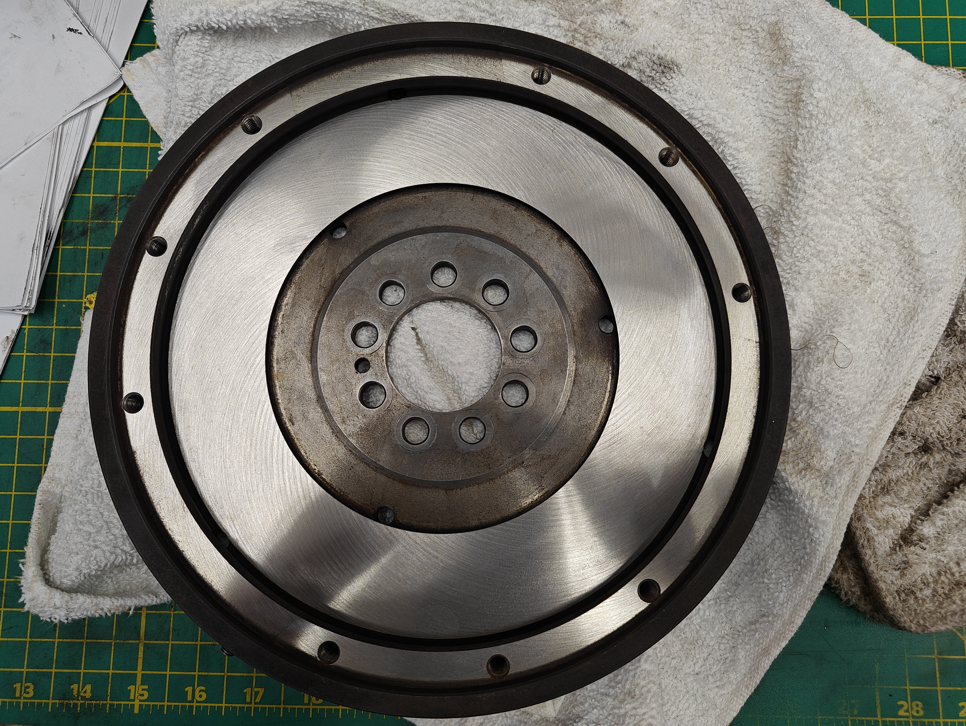

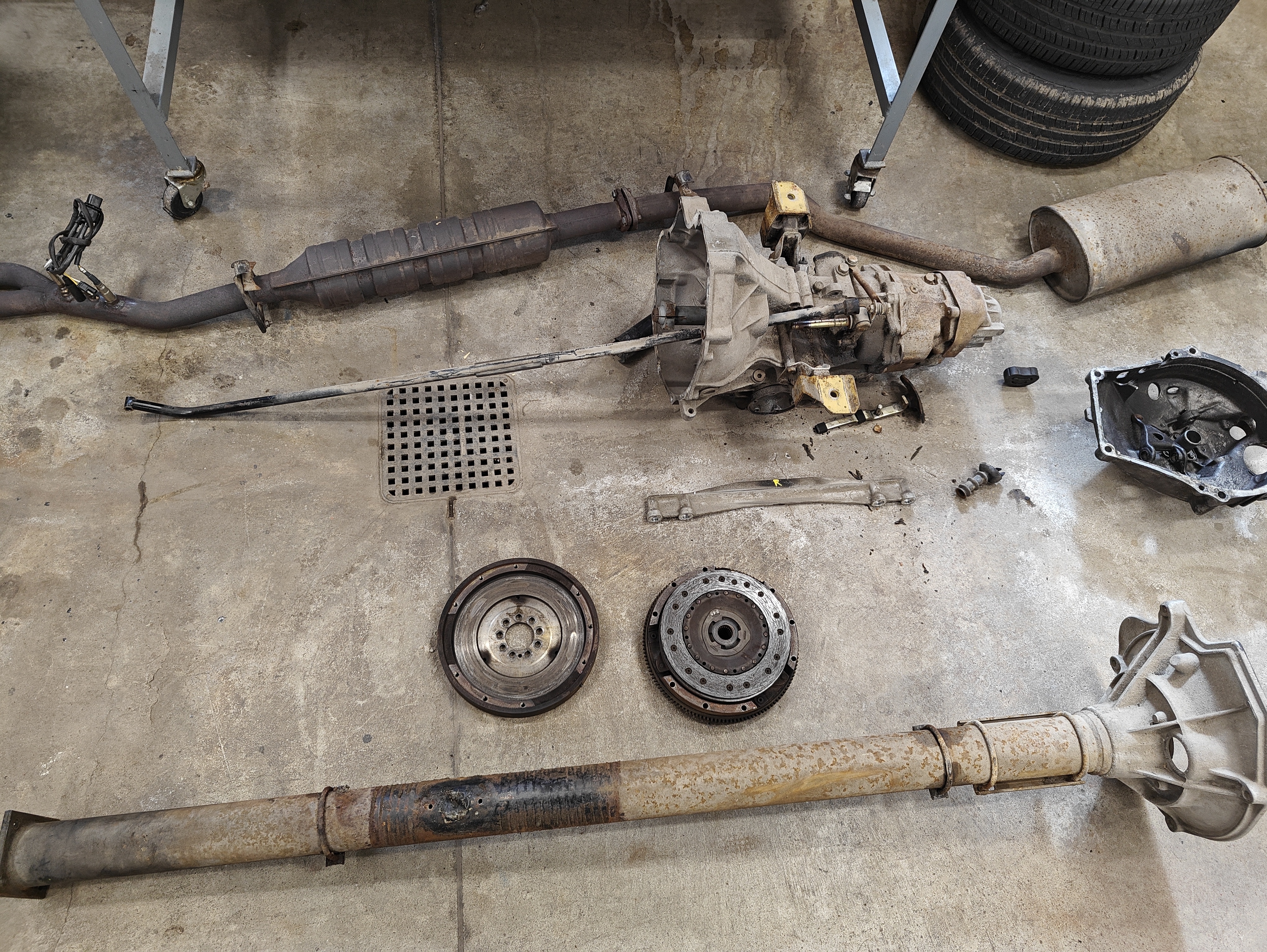

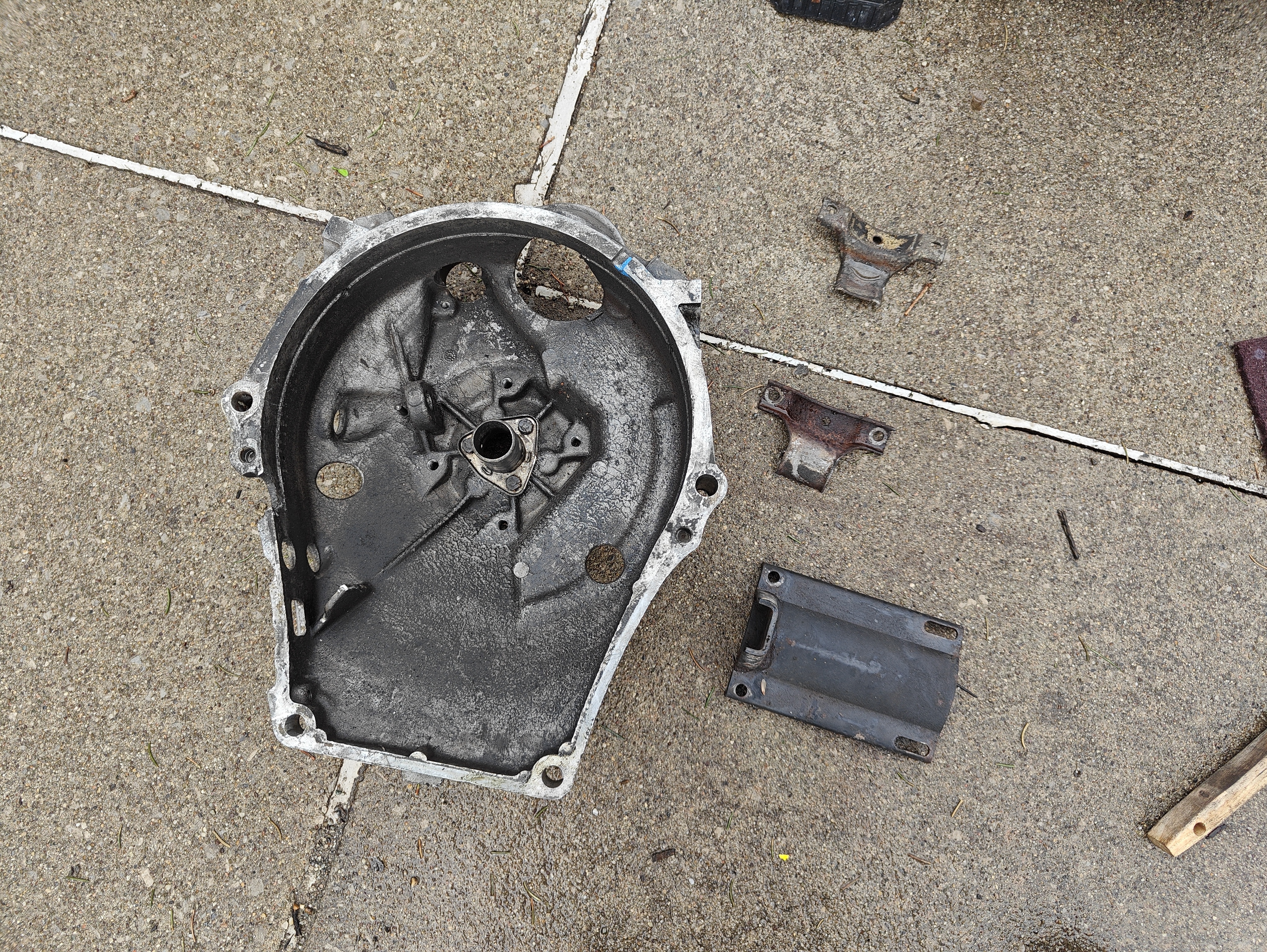

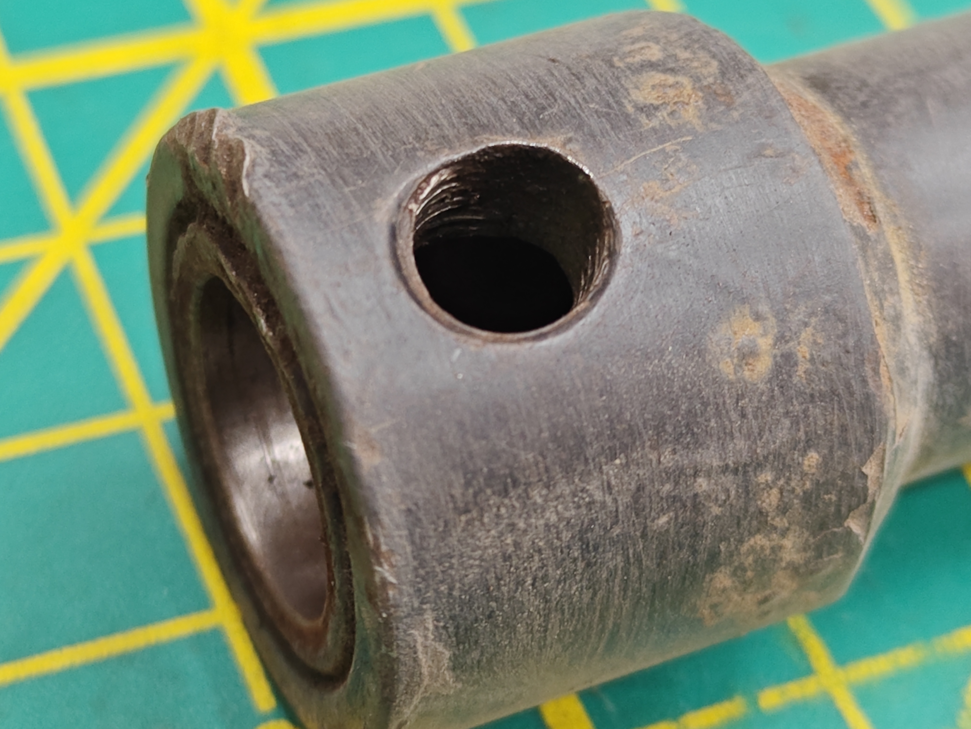

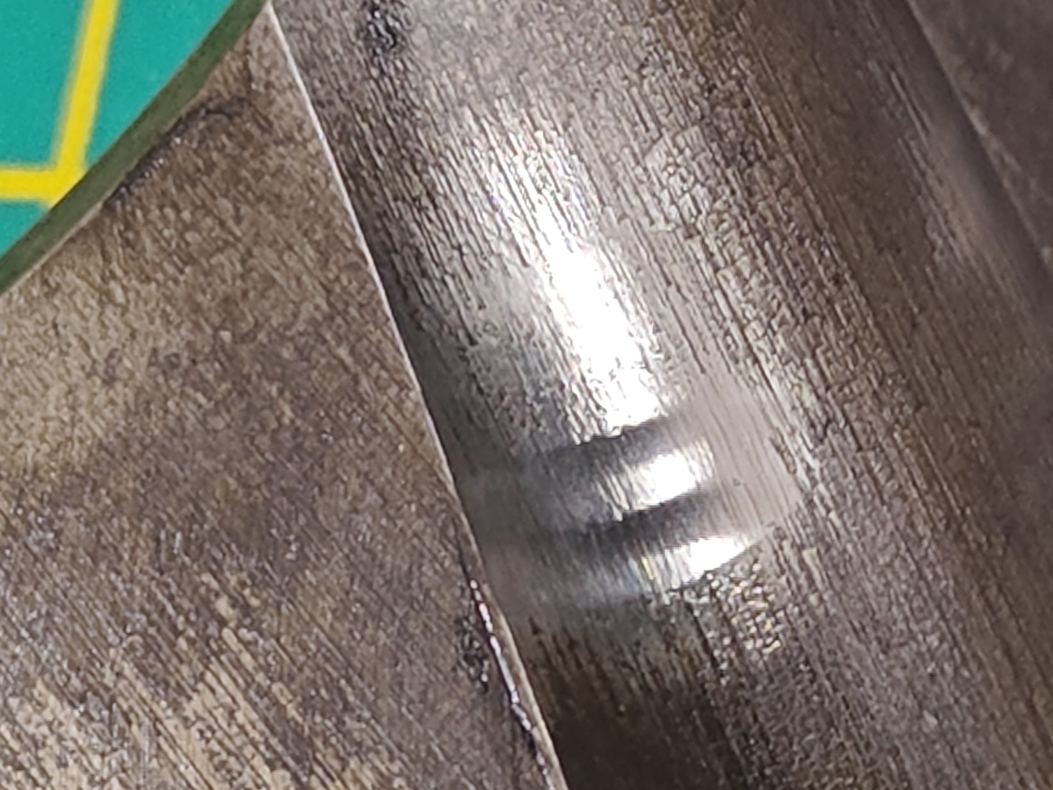

Whenever sitting in neutral with the clutch out there was a moderately alarming whirr. Given that the clutch chattered a bit and would slip if you abused it enough, I bit the bullet and pulled the drivetrain apart. In addition to finding a mouse house in the shifter foam, the torque tube bearings were indeed shot.

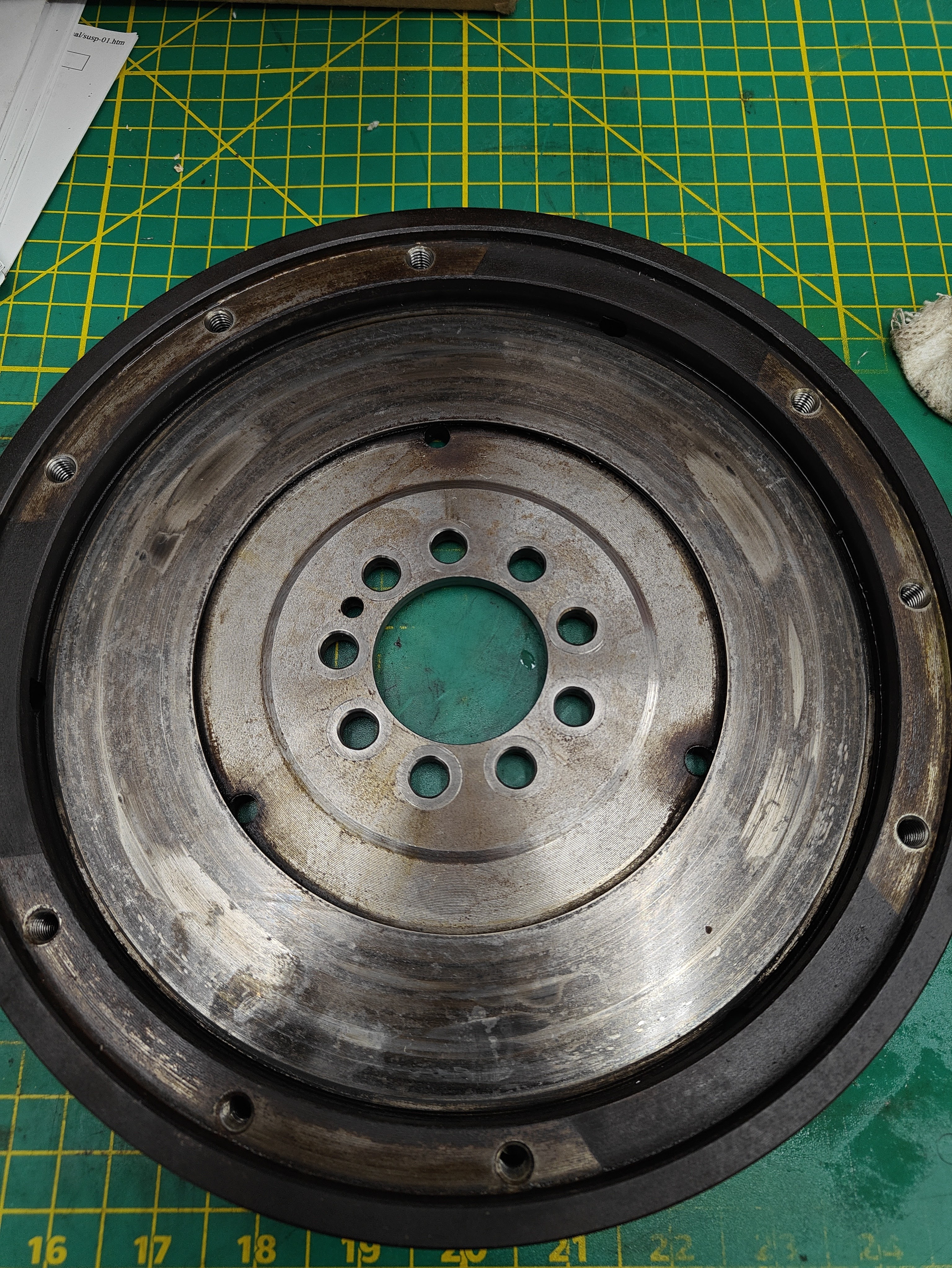

The flywheel had a couple hotspots but a local machine shop was able to clean it up.

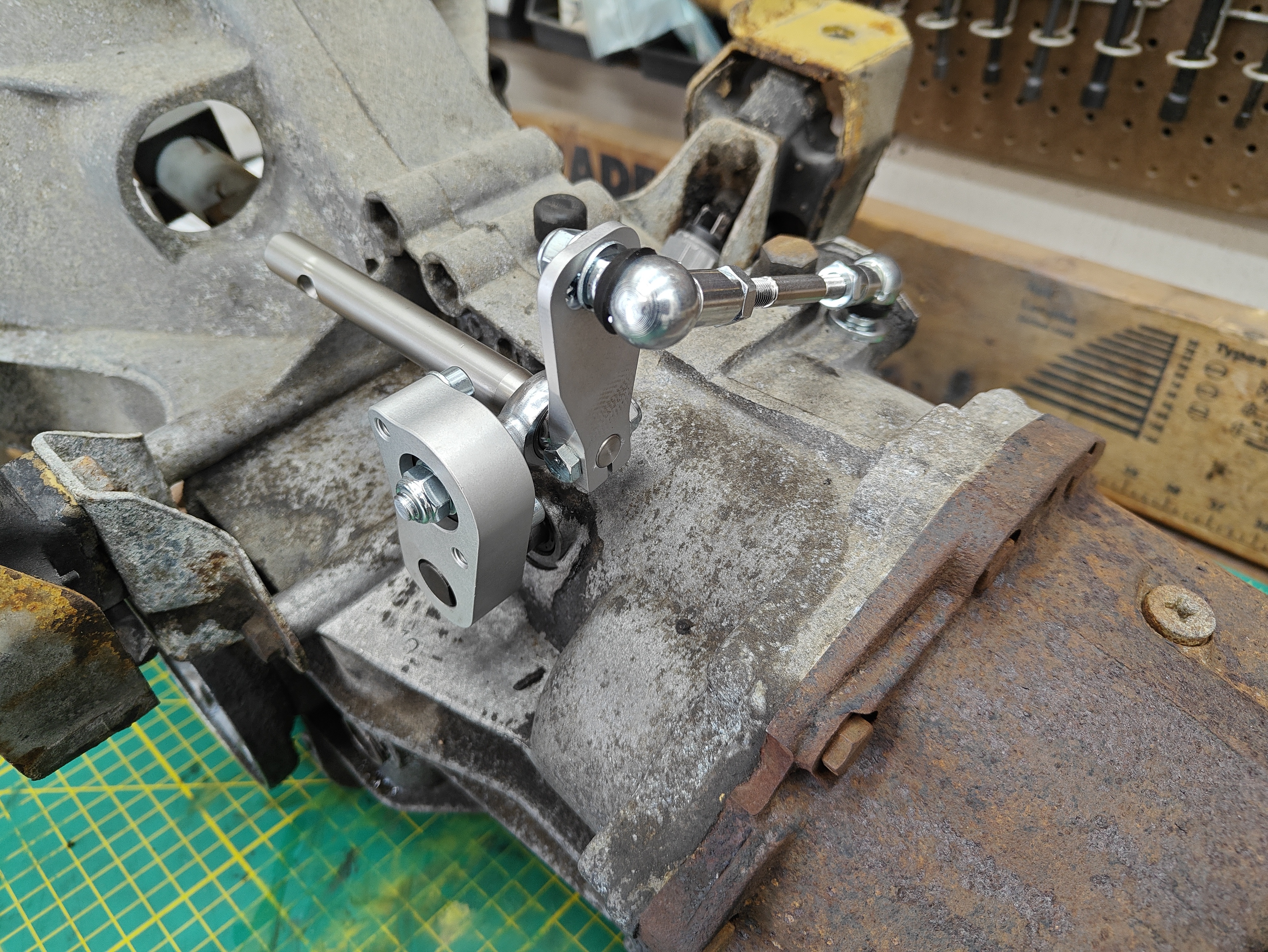

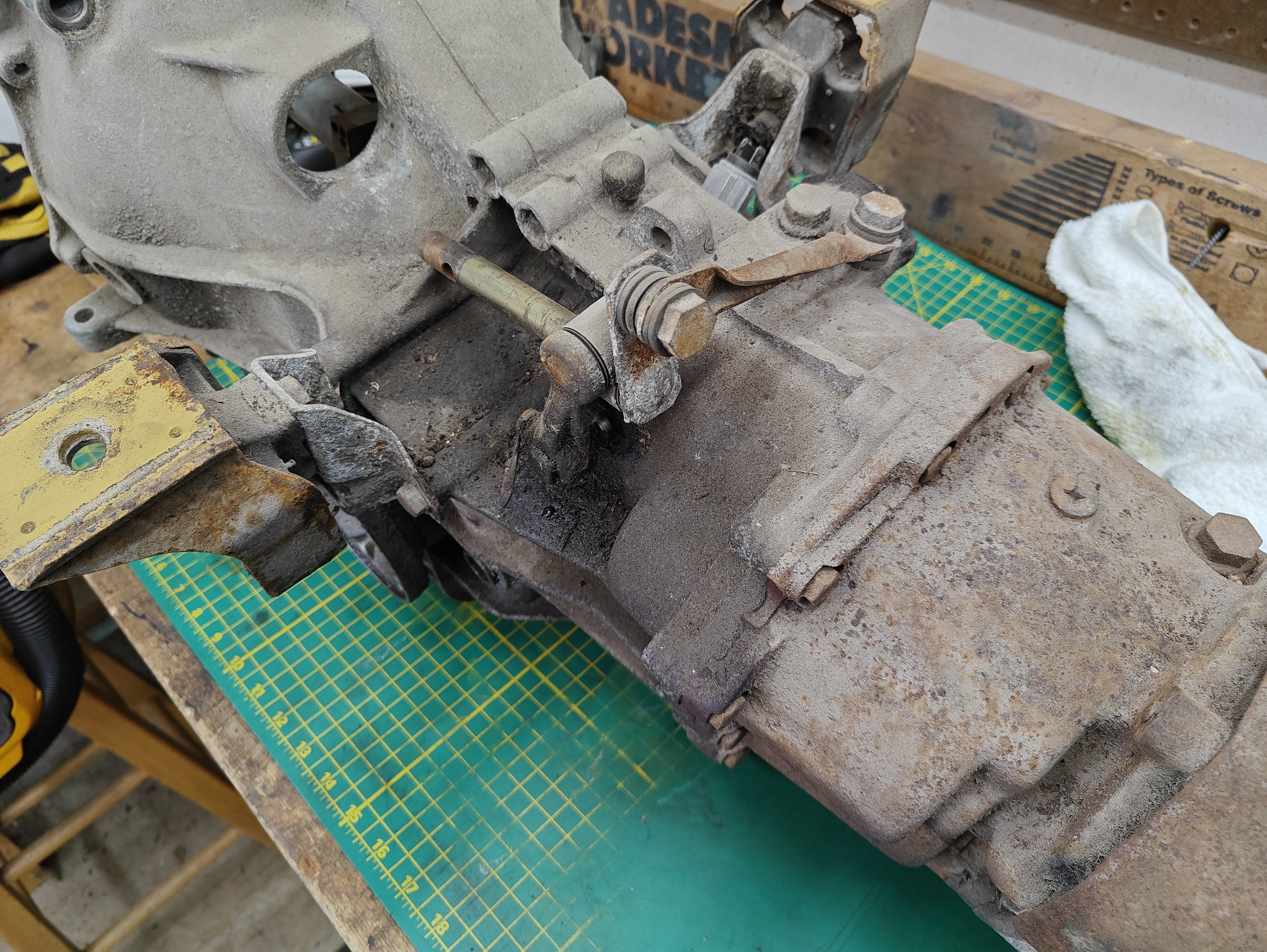

The transmission selector shaft evidently had a bad seal so I popped in a new one. The shifter was not what you'd call precise so I put the full Only944 shifter kit on. Not sure I'm a fan of the throw reduction but it's certainly a lot snappier.

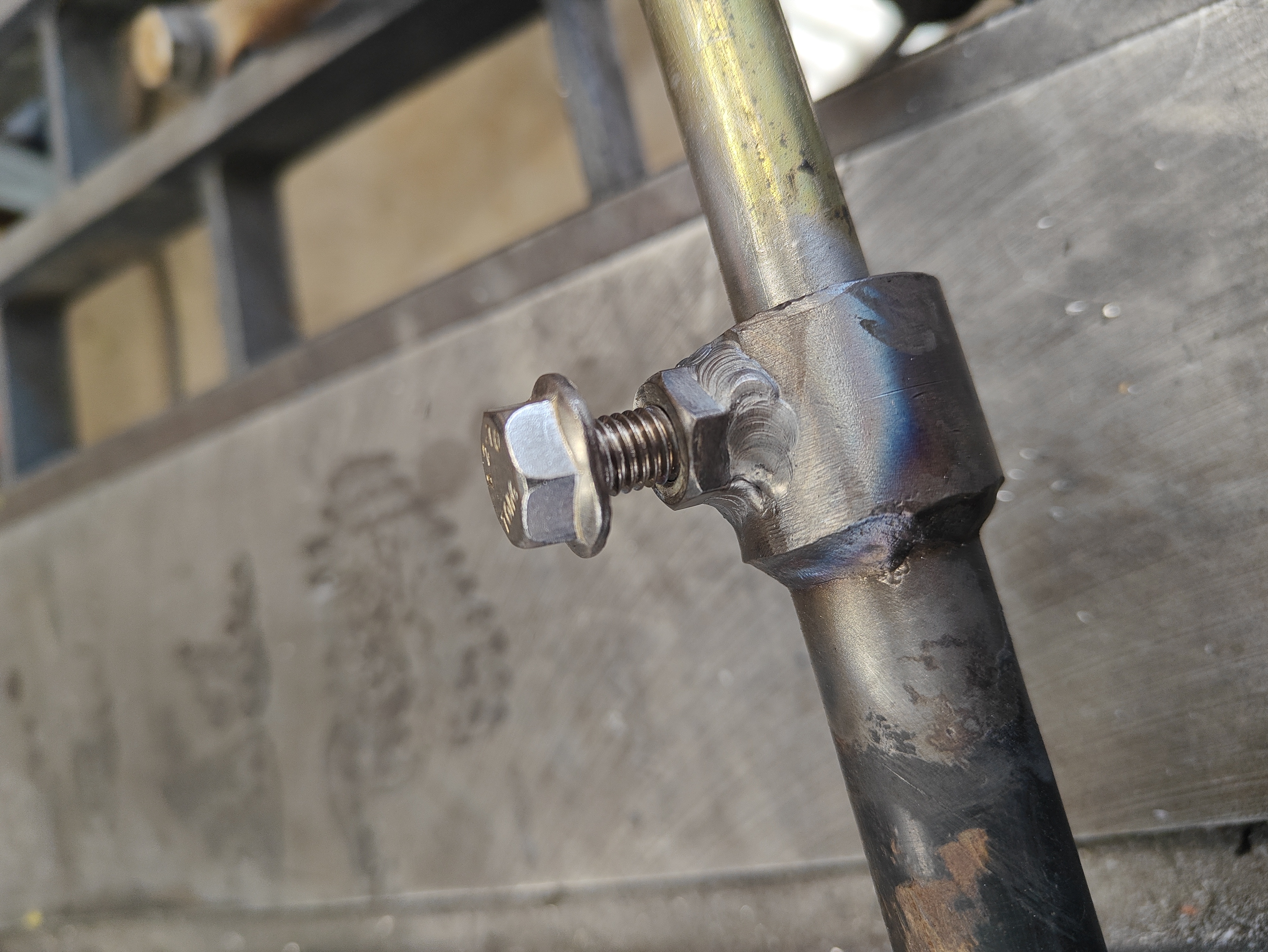

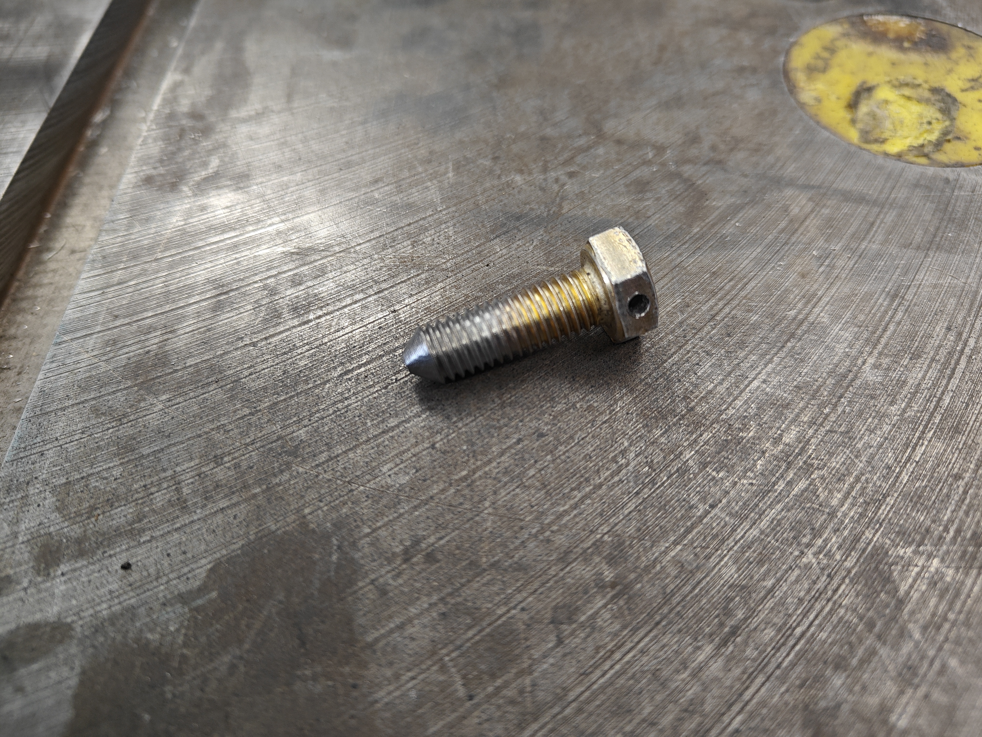

The shift linkage retaining bolt didn't come out without a fight so I drilled out the destroyed threads, welded on a nut, and made up a new bolt. Drilling a safety wire hole through the head of a 10.9 bolt was interesting.

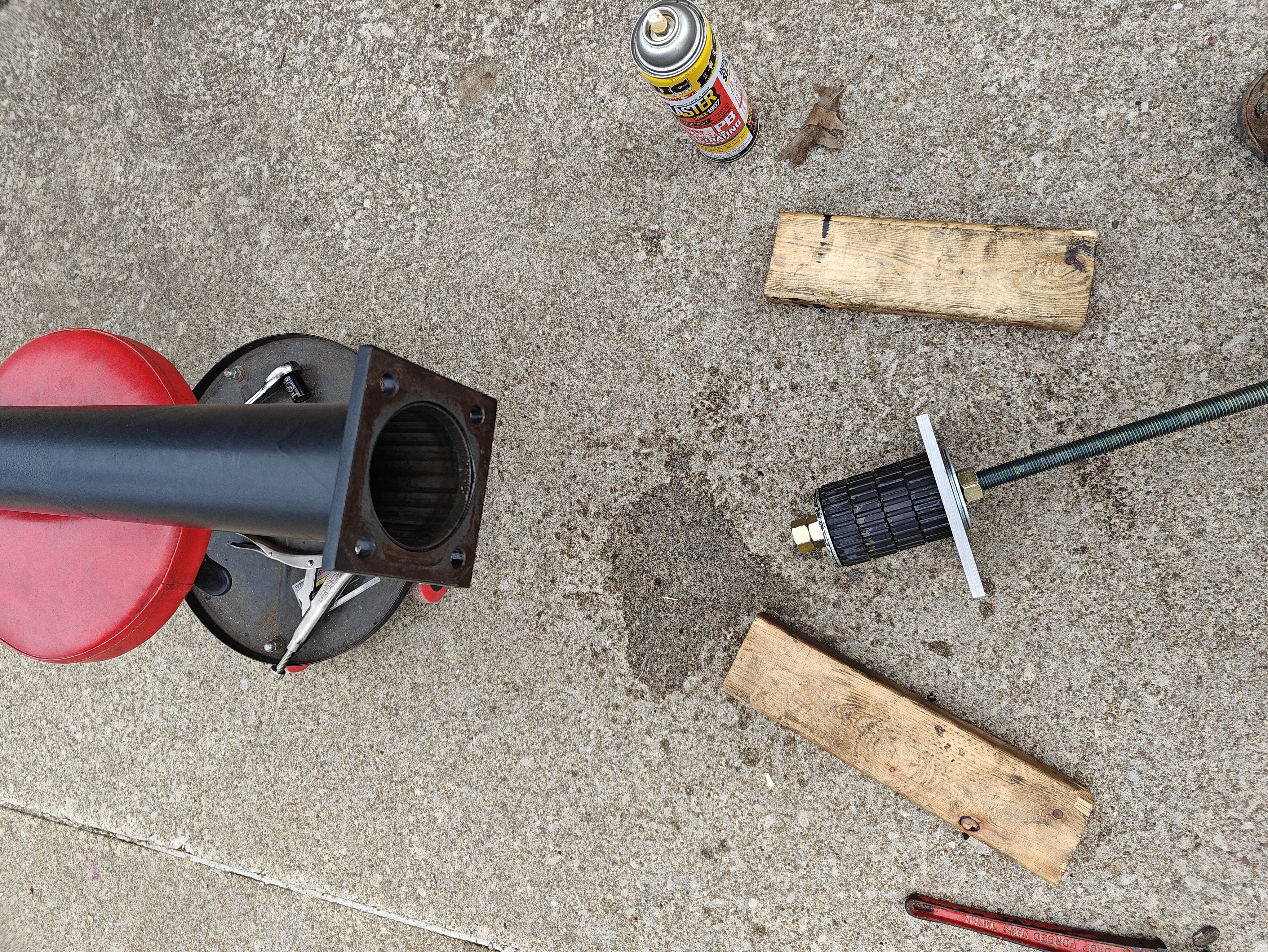

The threaded rod setup worked a treat and the old torque tube bearings popped right out. After a quick clean the new ones went in just as easily. I can barely move my arms now.

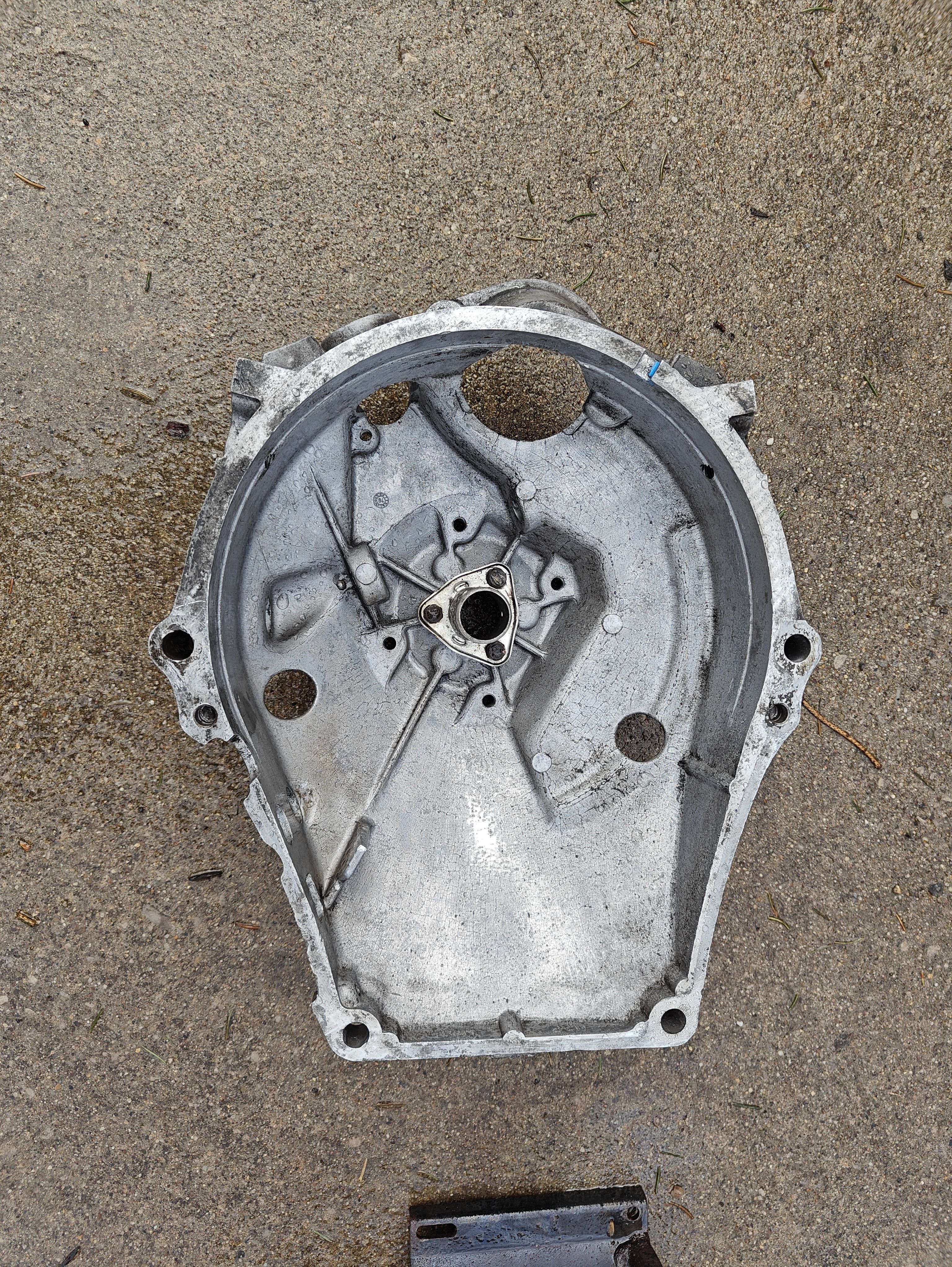

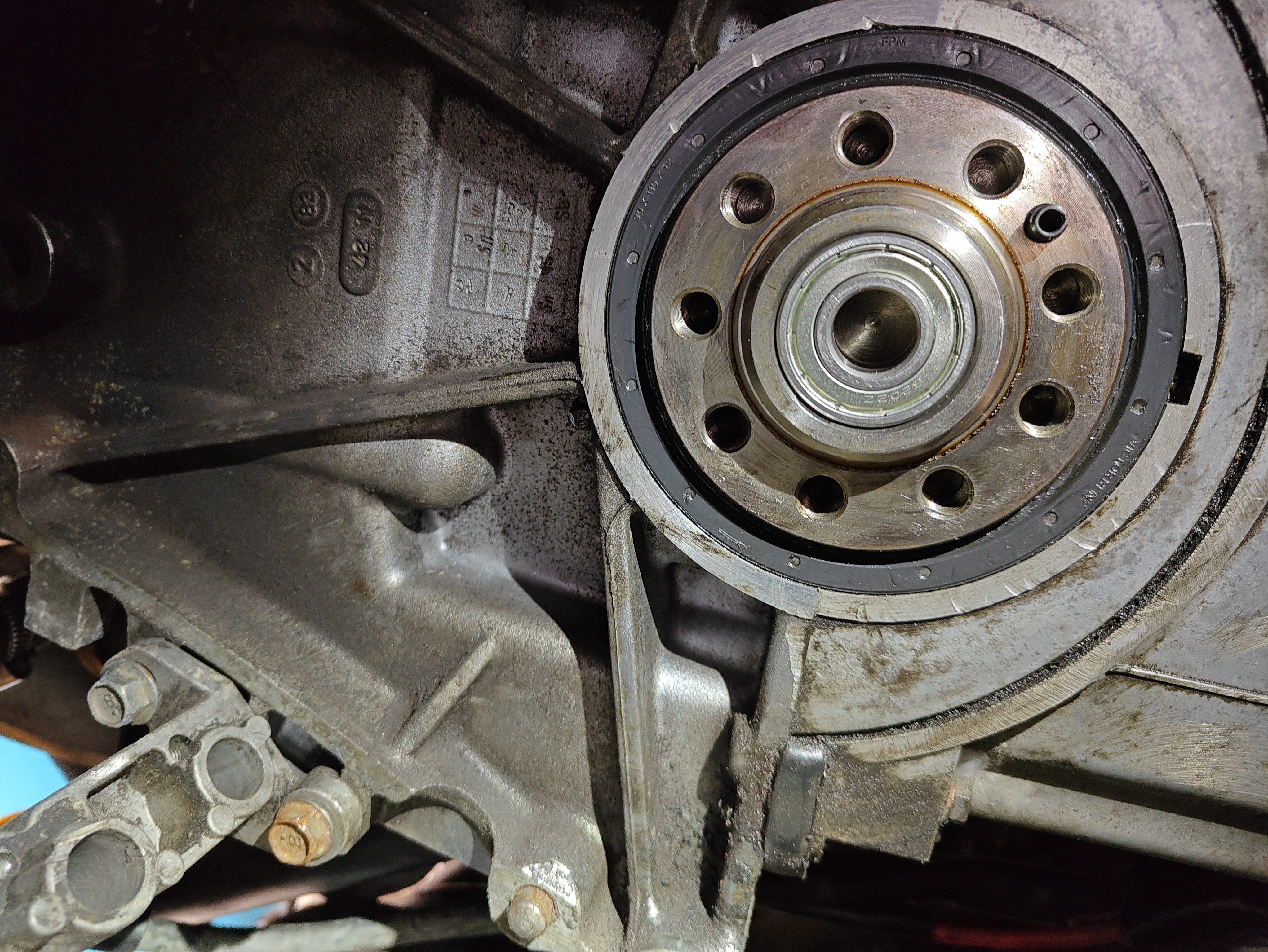

Engine got a new rear main seal and pilot bearing. The markings on the back of the block seem to indicate it's a 1983 engine. Given a bunch of other goofy-ness I've seen, I'm confident this is not the original engine. The clutch slave was weeping a little so I replaced it along with a new soft line.

I installed a complete Sachs clutch kit; new clutch disk, pressure plate, throw-out, fork needle bearings and shaft, hardware, etc. During re-assembly the torque tube shaft shifted a bit out of place. I apparently went a bit heavy on the grease. I think I pushed it back into the correct position. It's engaged with the pilot and there's a gap between it and the transmission input shaft. If something eats a thrust bearing then I guess I know where I screwed up. Everything seems happy so far.

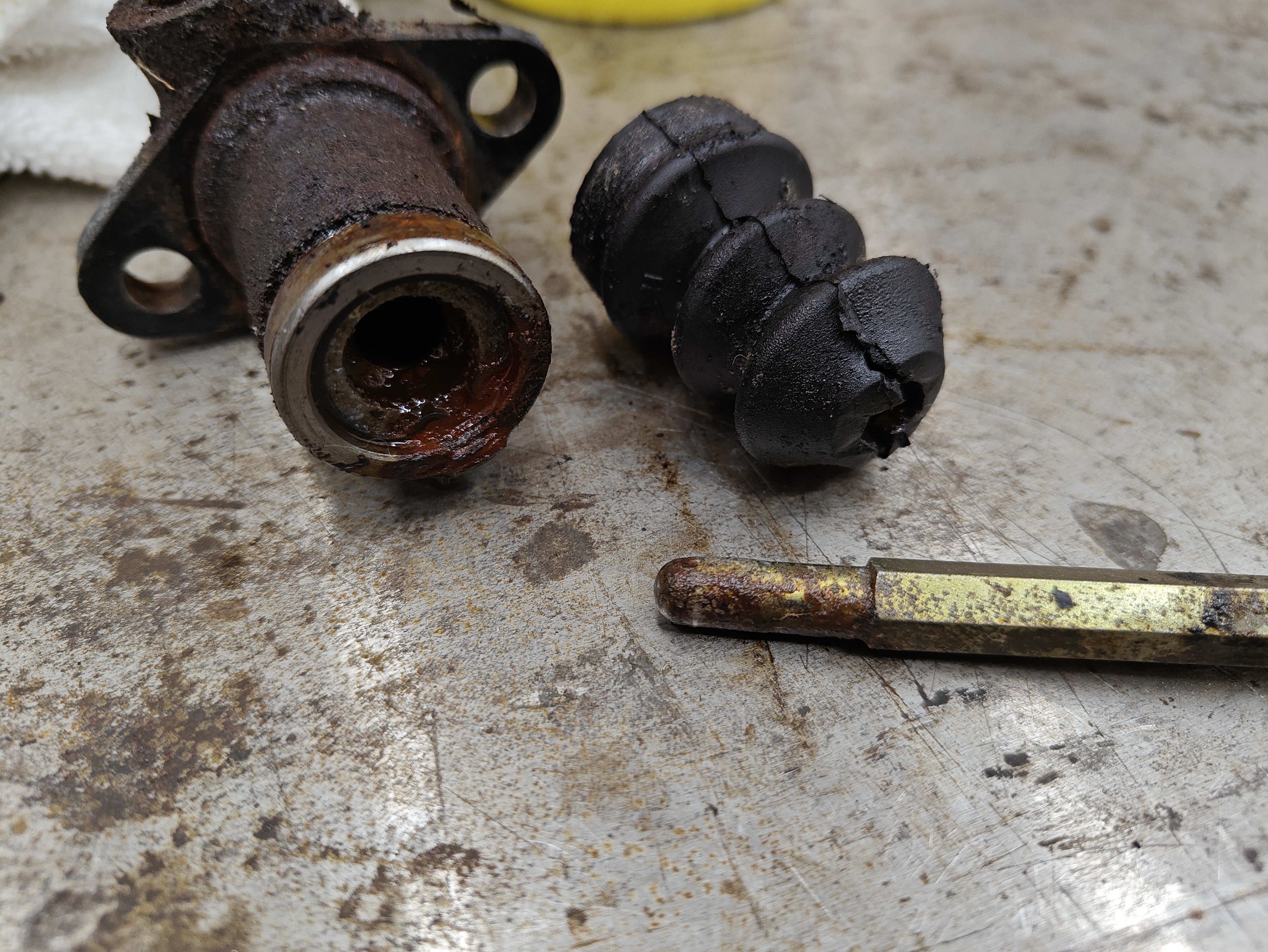

Unfortunately after just 50 miles or so the clutch master started weeping on my shoe. Pulling it apart showed what I can only assume is moisture damage. A new one was easy enough to install.
