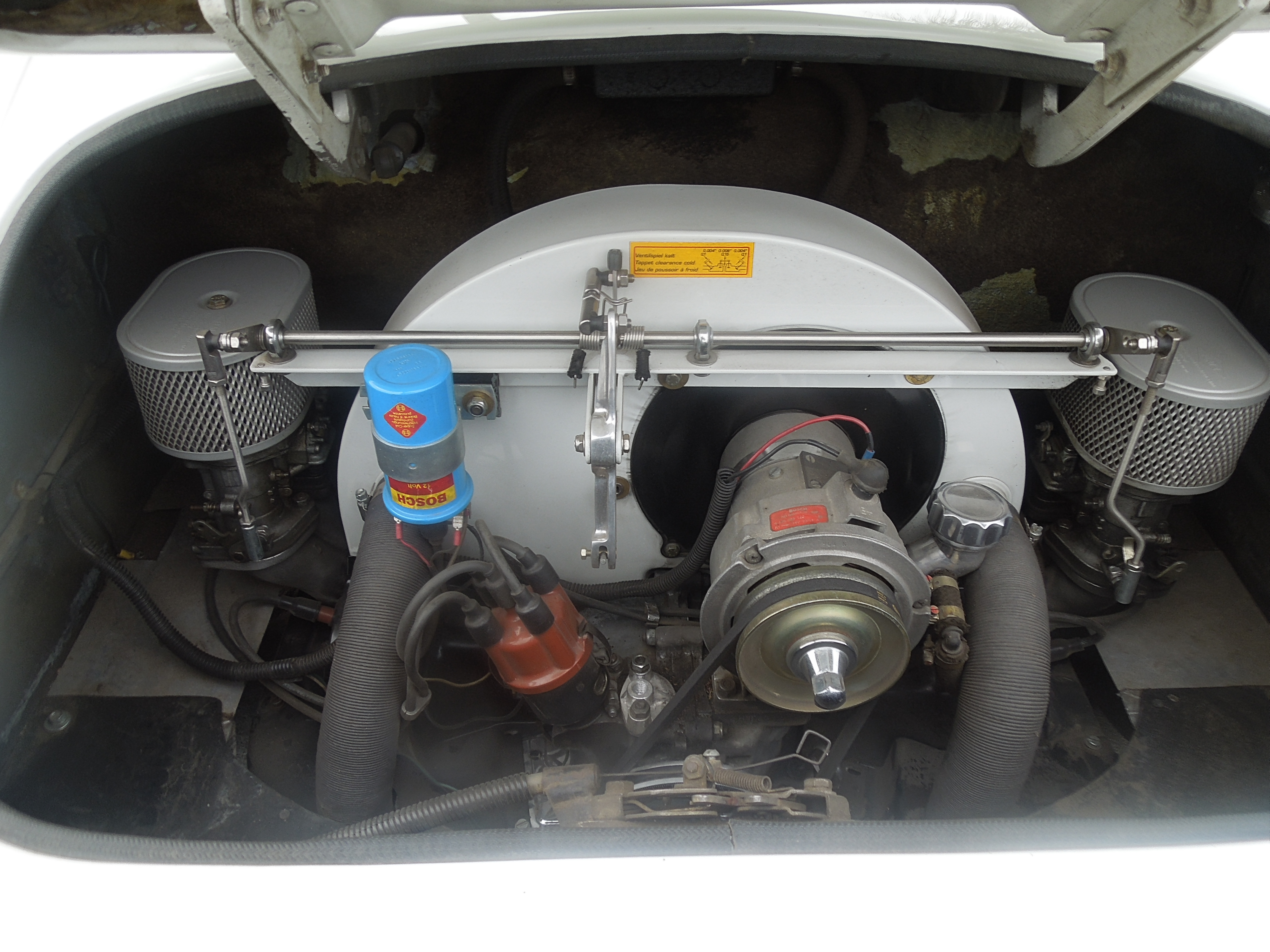

ah, the dying art of carburetor adjusting. Seriously, the folks that could, are literally dying off. SAD !!!! I think I saw a pretty decent video on You tube, about adjusting IDF's. TON's of 356 owners have converted their worn Solex's for Webers. The "best" ones are NLA, made in Italy, next best are the Spanish made ones...after that, I am not so sure of the original quality being replicated in Asia....???? I have Spain built IDF's, and, they are fairly easy to work on. You can pull out the idle circuit and make sure it is not clogged. You can mess with the mixture screw, and listen attentively, for the 'sweet spot'. It really is sort of magic...or blind luck... ALSO. be sure your linkage is opening the carbs exactly equally. Sloppy linkage can mimic 'carb problems'.

I think the problem so many of us have these days (one, at least, of many) is that modern life is getting to be such a non-stop, constant overload barrage of sensory demands and distractions that we can't give our undivided attention to dealing with such crucial issues as carb tubing fine points. That's certainly my case, although my situation is further complicated by being plagued with life-long ADD (as well as advancing senescence issues). I can't even relax enough these days to be able to fully focus on my machine's mechanical subtleties and enjoy dealing with them. [That's a "lovely" engine compartment in that 356, BTW. Nice set-up, Darkbeer.]
