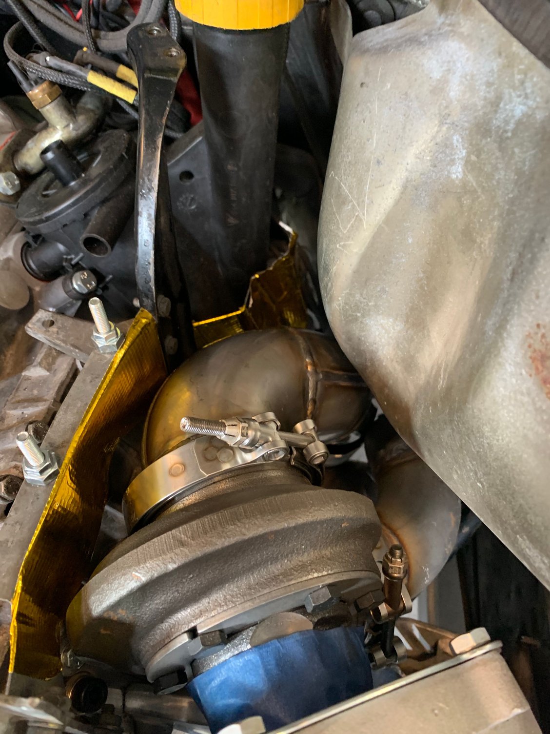

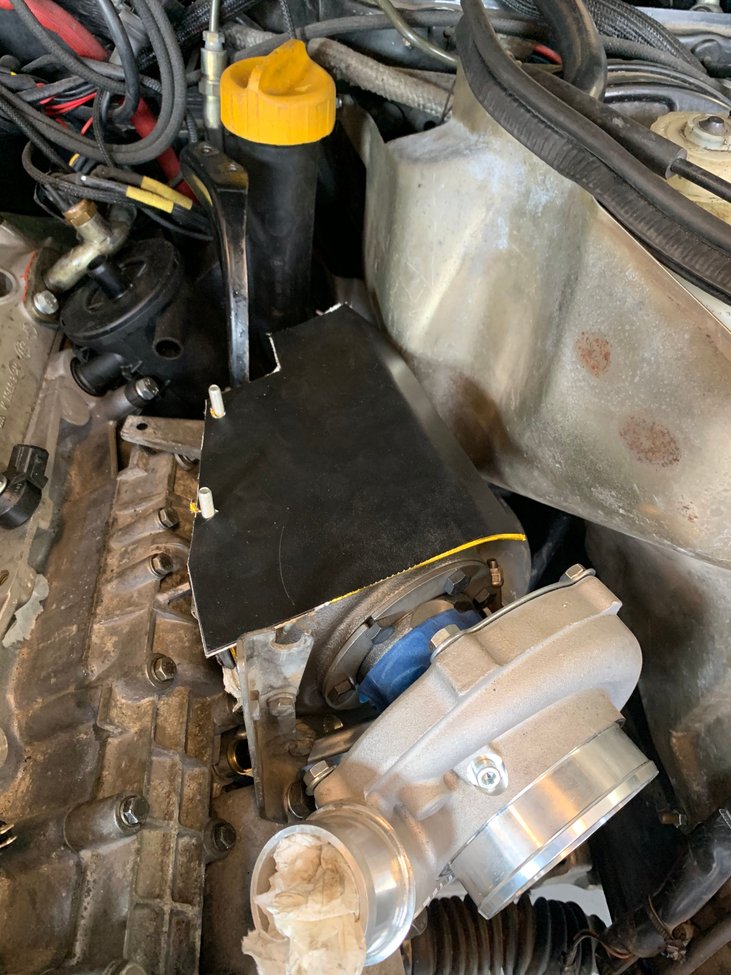

i built a heatshield in between my turbo and intake, dont like turbo blankets in tight spaces.

Do you have a picture of your heat shield that you can share?
ealoken
Posts: 100
Has thanked: 44 times
Been thanked: 51 times
Here you go :)

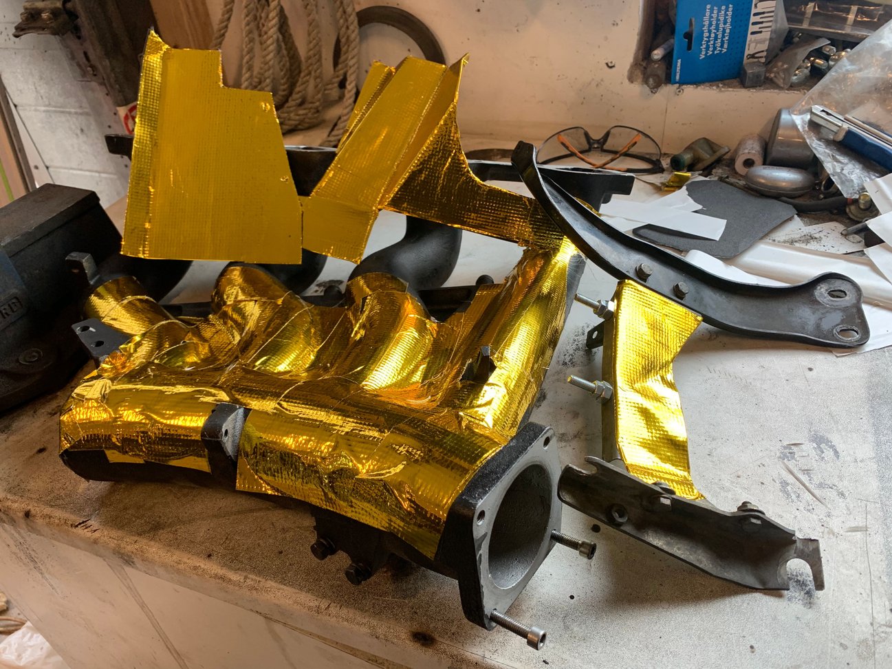

Thanks, I did the same thing with my intake manifold and the brake booster shield.
