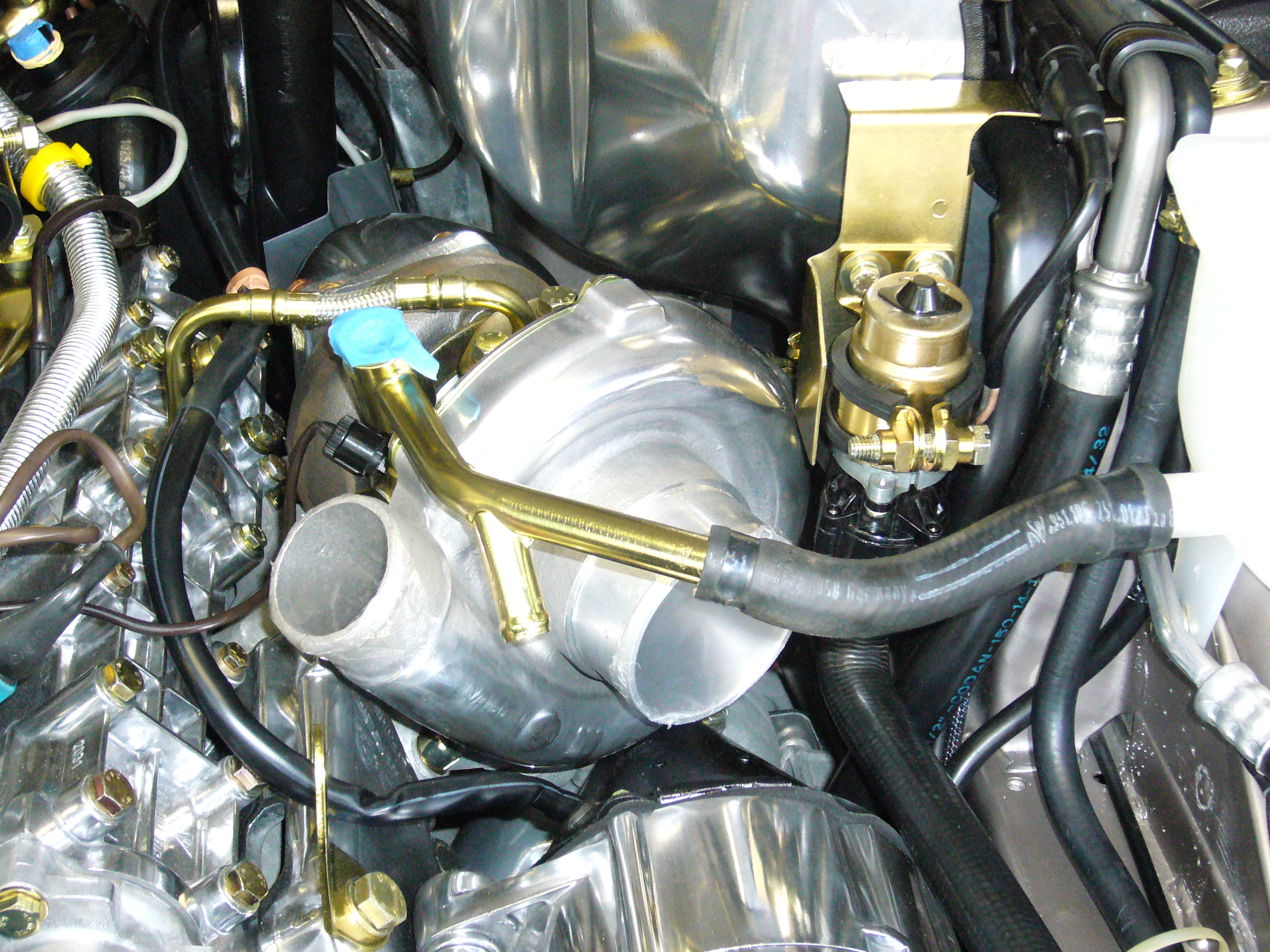

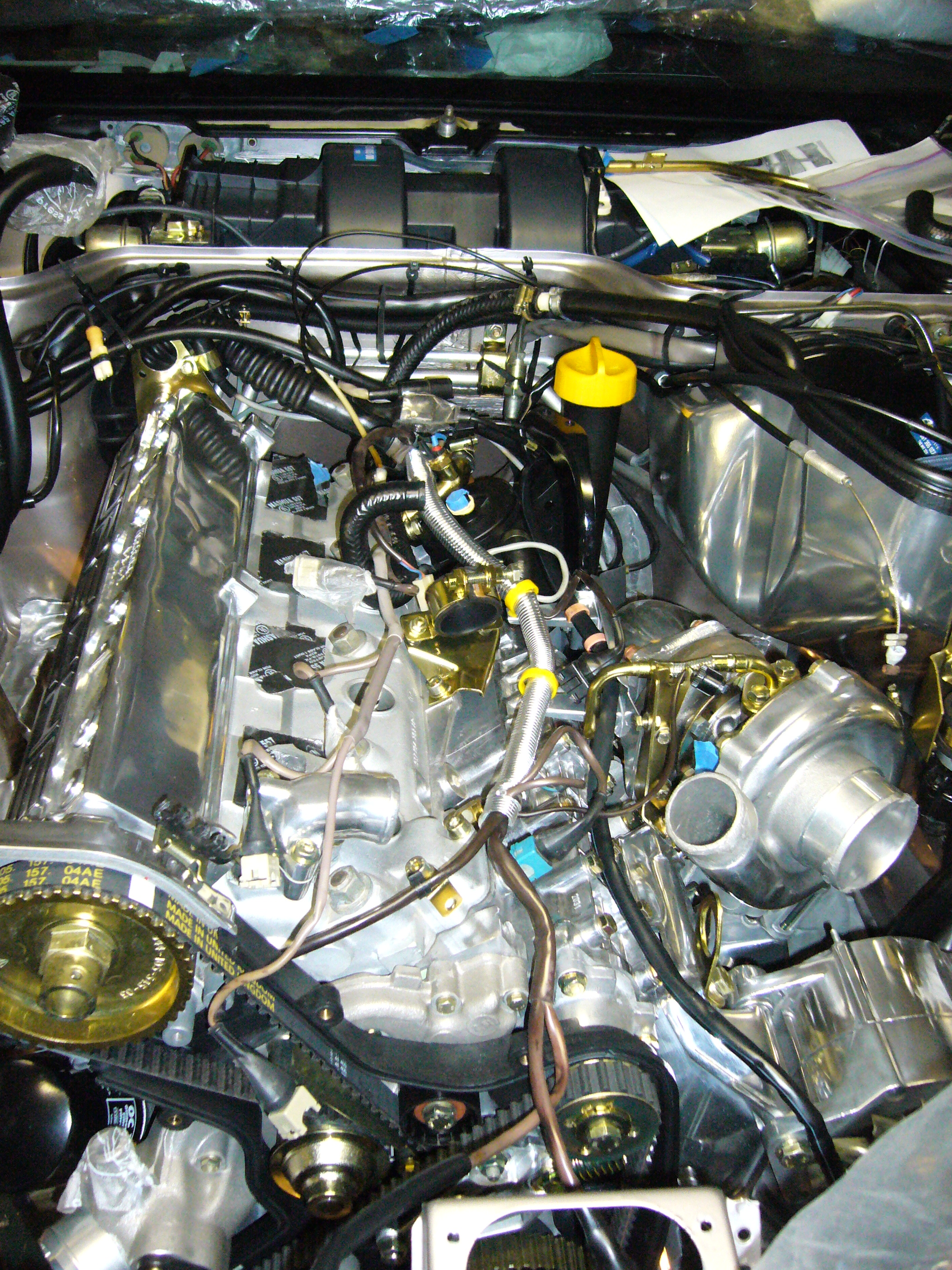

I'll post some picts in a little while ... I honestly spent about two hrs .... digging into 10 yr old picts ... sadly I'm not very well organized when it comes to finding these picts :-(

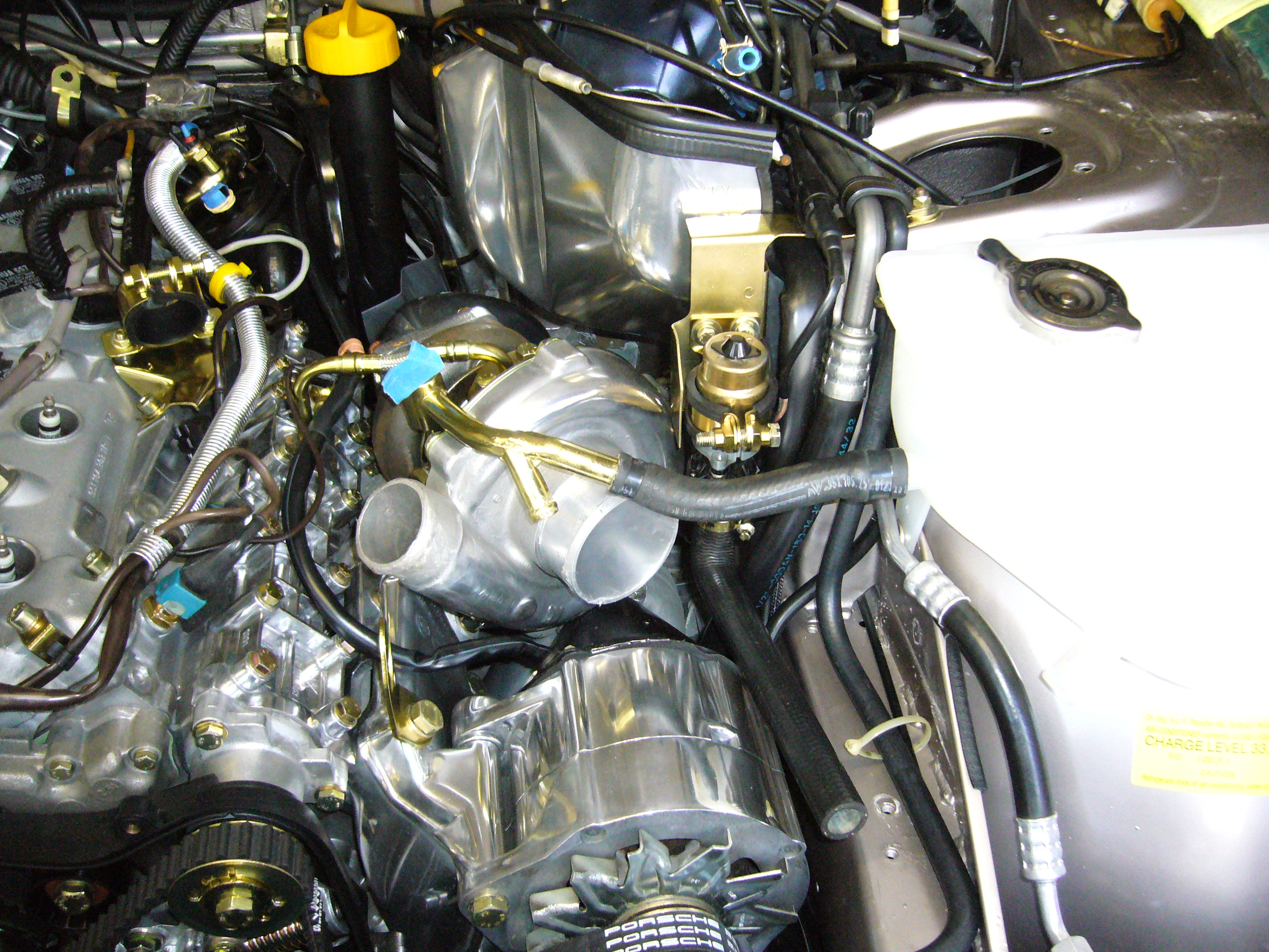

Hope these help ??

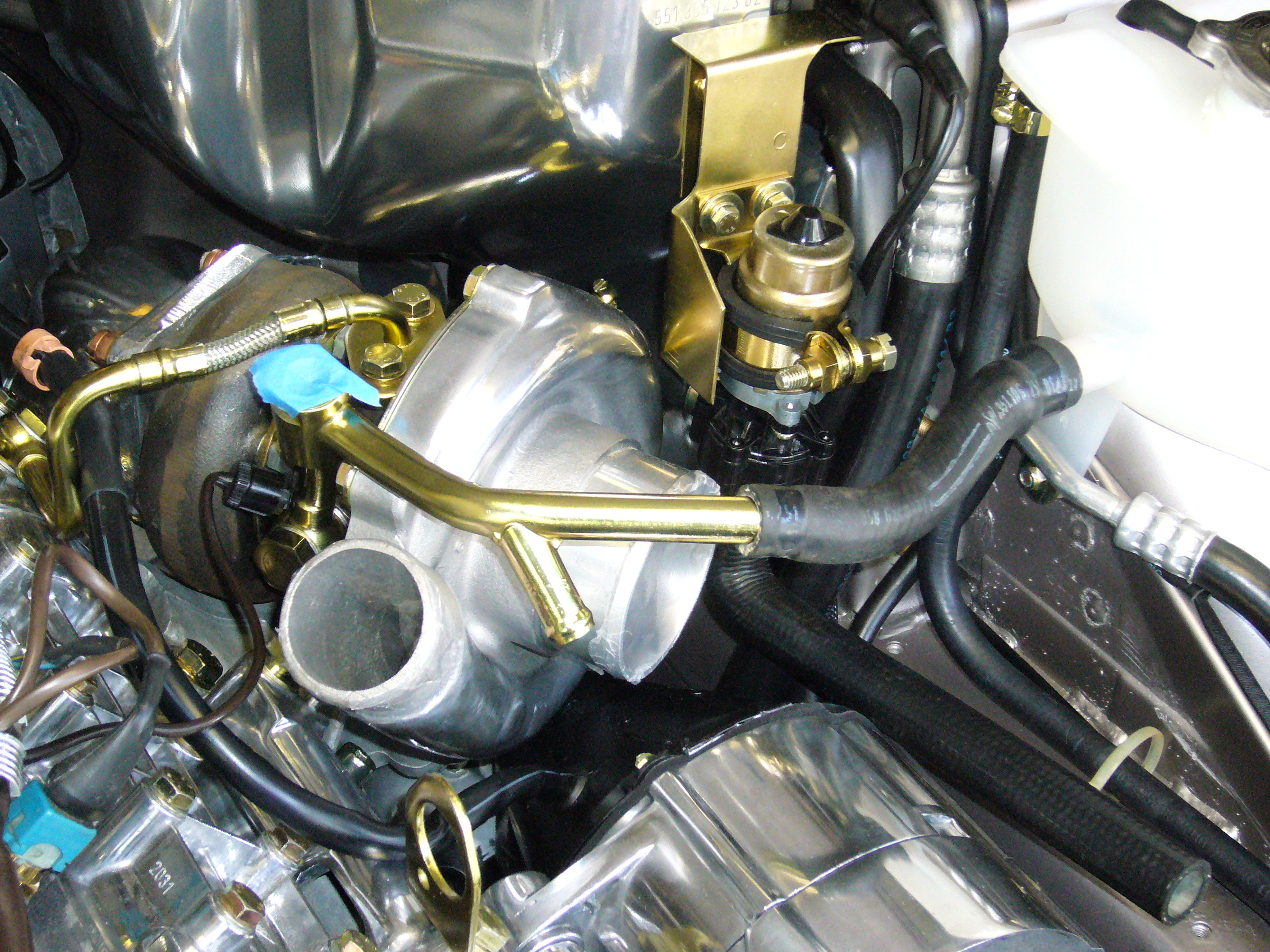

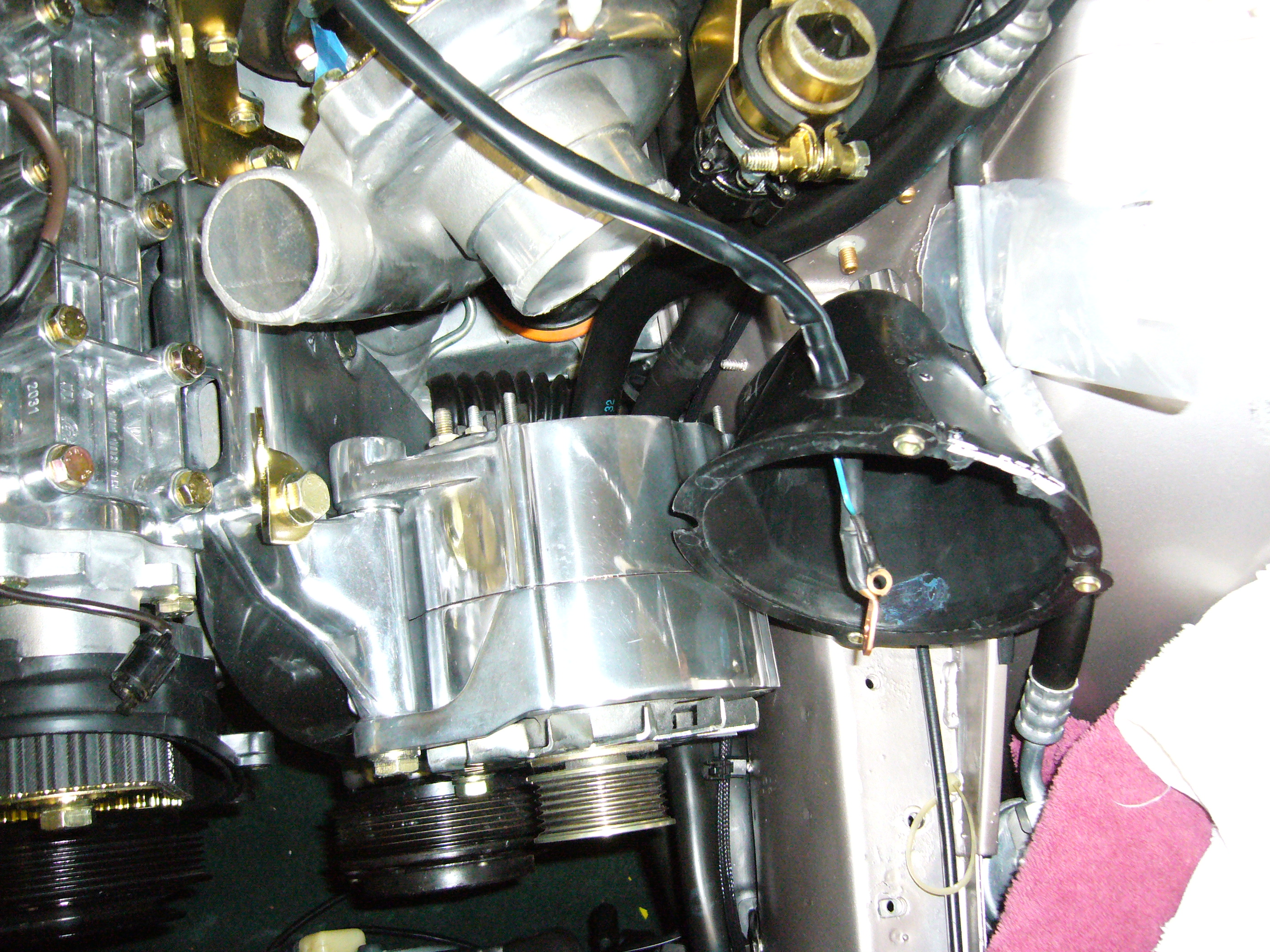

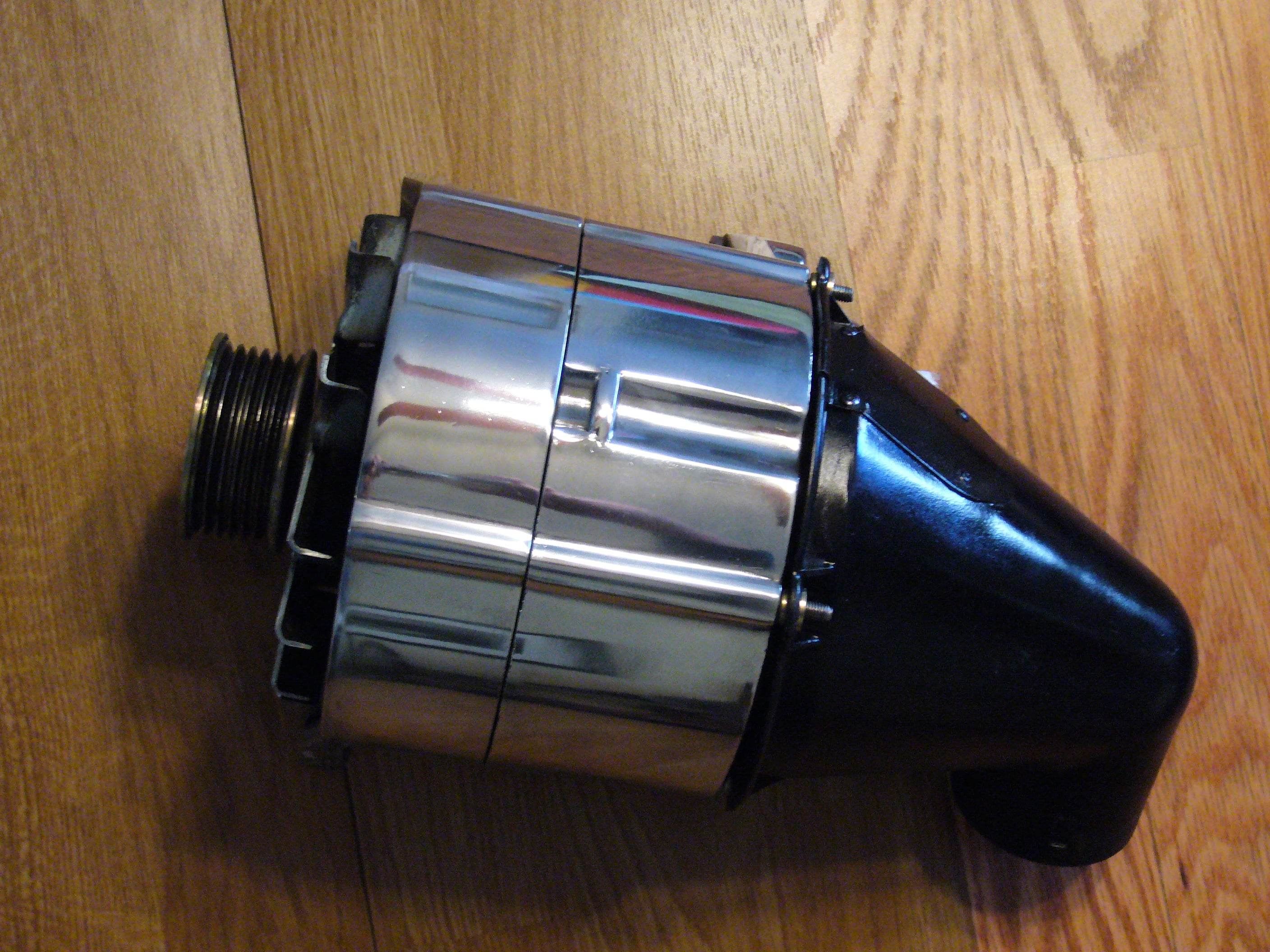

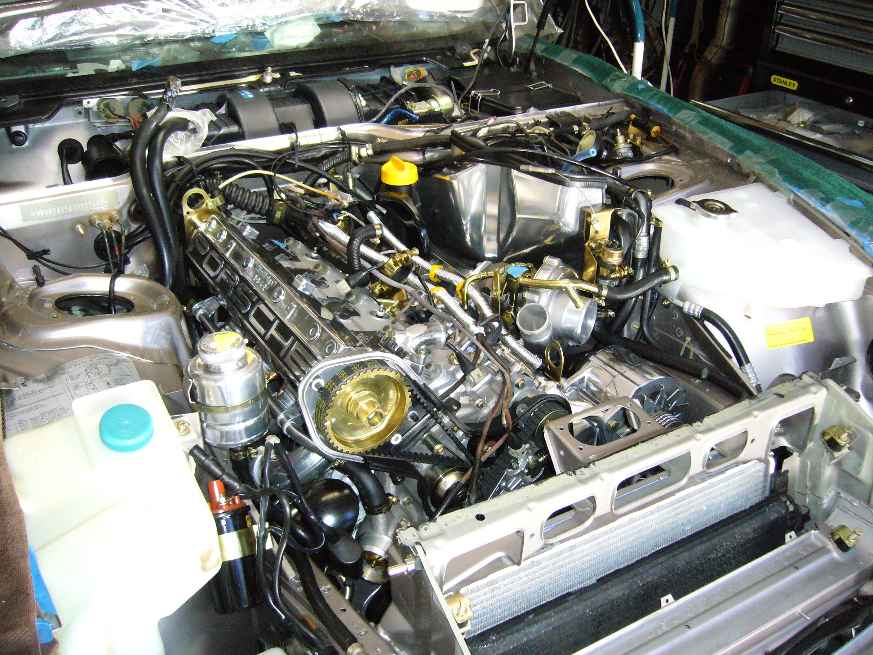

Here are a few more ...

Thanks alot Eddie for taking your time digging up these exceptional photos!
Very helpful pics and always a treat to see the massive work you put into your Silberrosa👌

One important note … you might have noticed that I had to move the wire going into the back of the alternator shroud, as I was using a bigger turbo with wouldn’t allow the orig position of the stock wiring set up. So I capped off that orig wiring port and moved it to the side using a grommet and restraint …

Thanks Ed, I also have a bigger turbo but this gives me the picture on how to best route the wiring 👍
