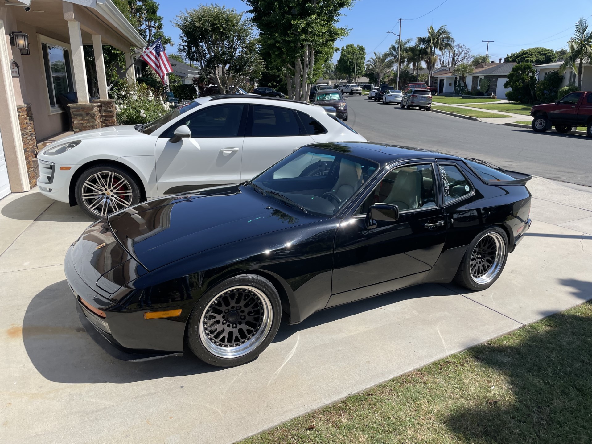

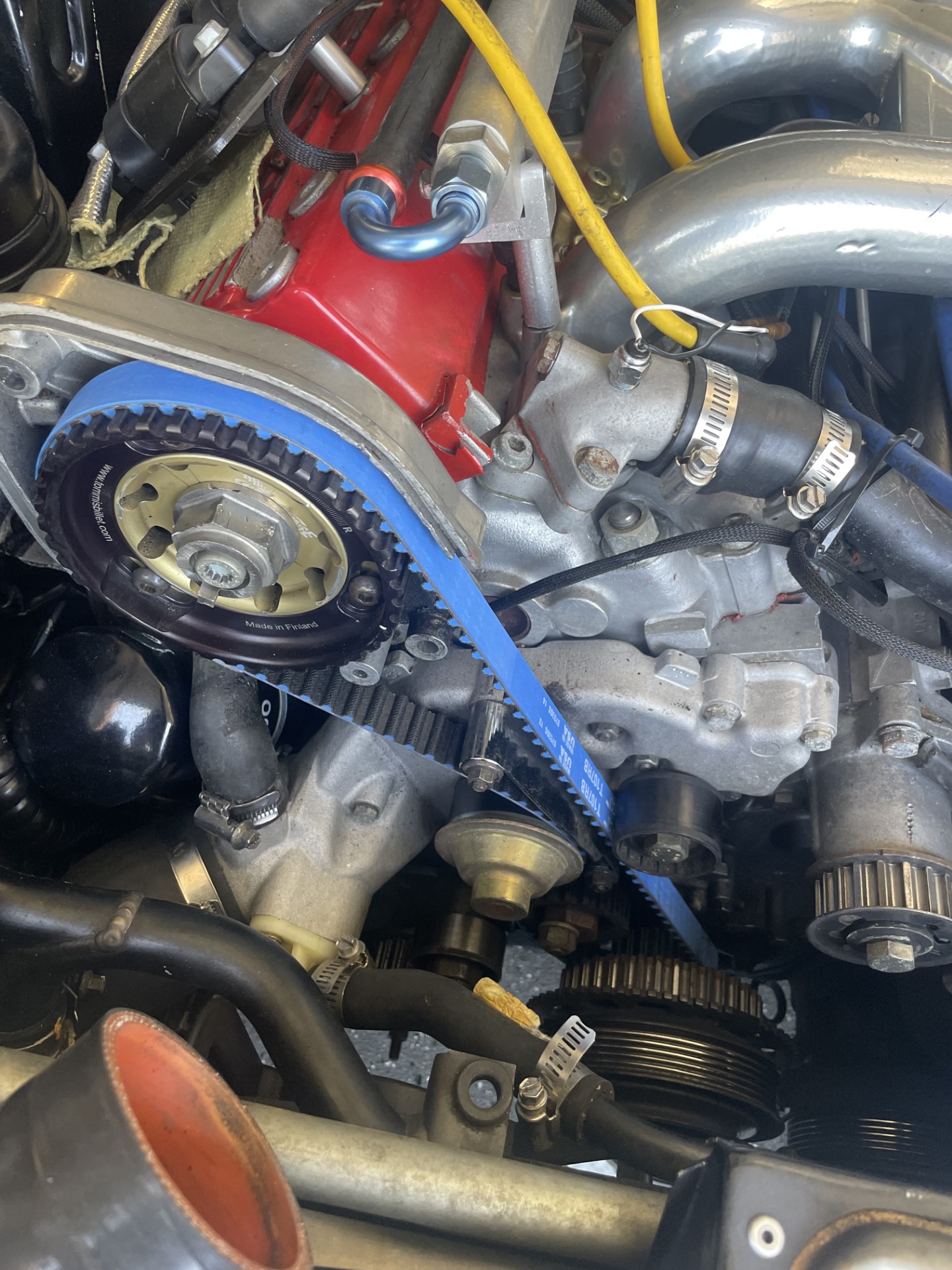

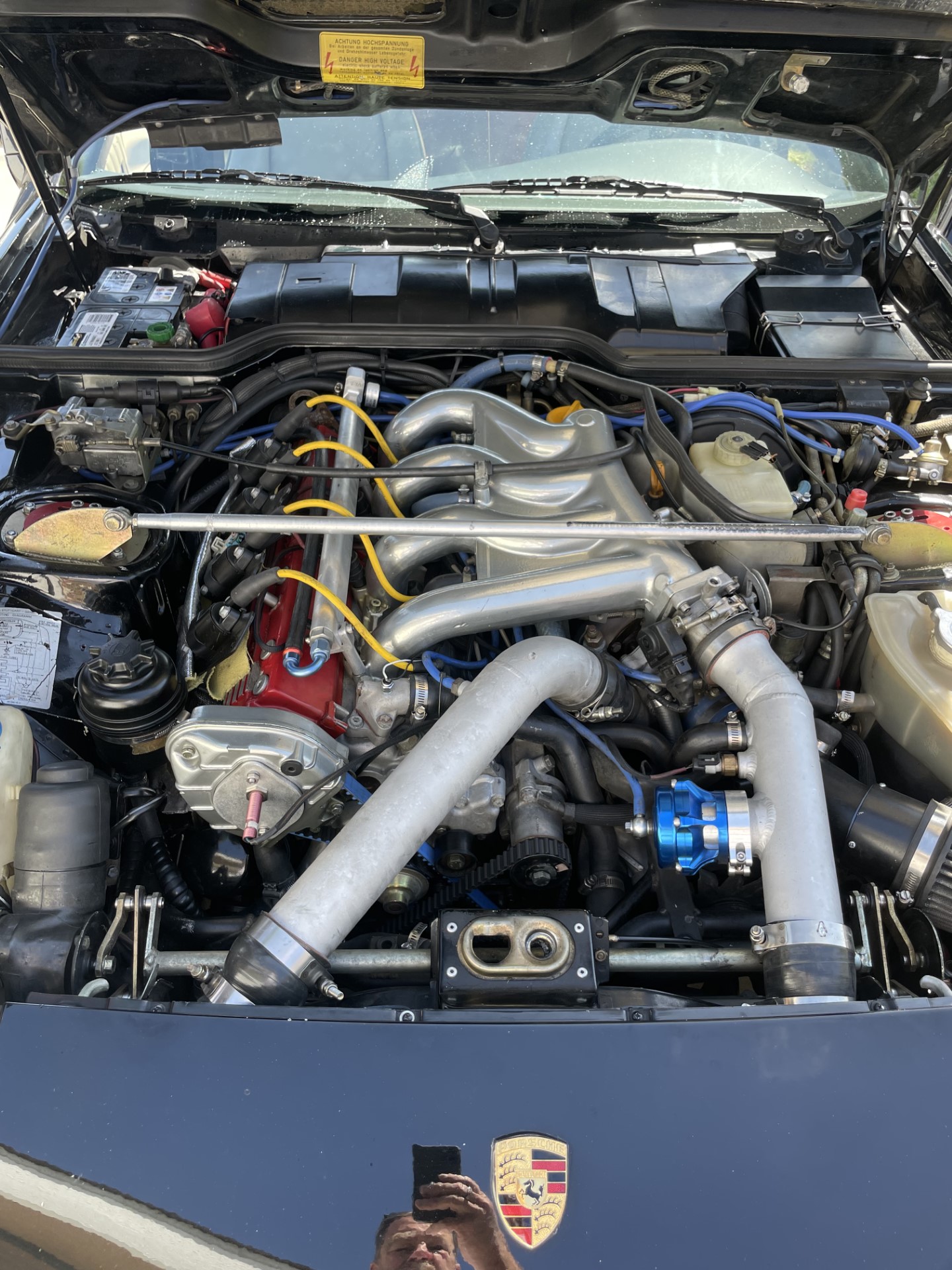

Here is the car today, I really appreciate all this info. It might be the Evans coolant, it appears he really didn't do to much after the first year and the last 8-9 it pretty much sat in storage getting started a couple times per year (non op registration for the last 6 or so) Looking at Lindsey Racing they have a stock radiator and one with the built in oil cooler as well, is it better than the wizard or really just go separate units? And Hugh explained the 5 presets in Boost and to not go over 18PSI WO race gas.
