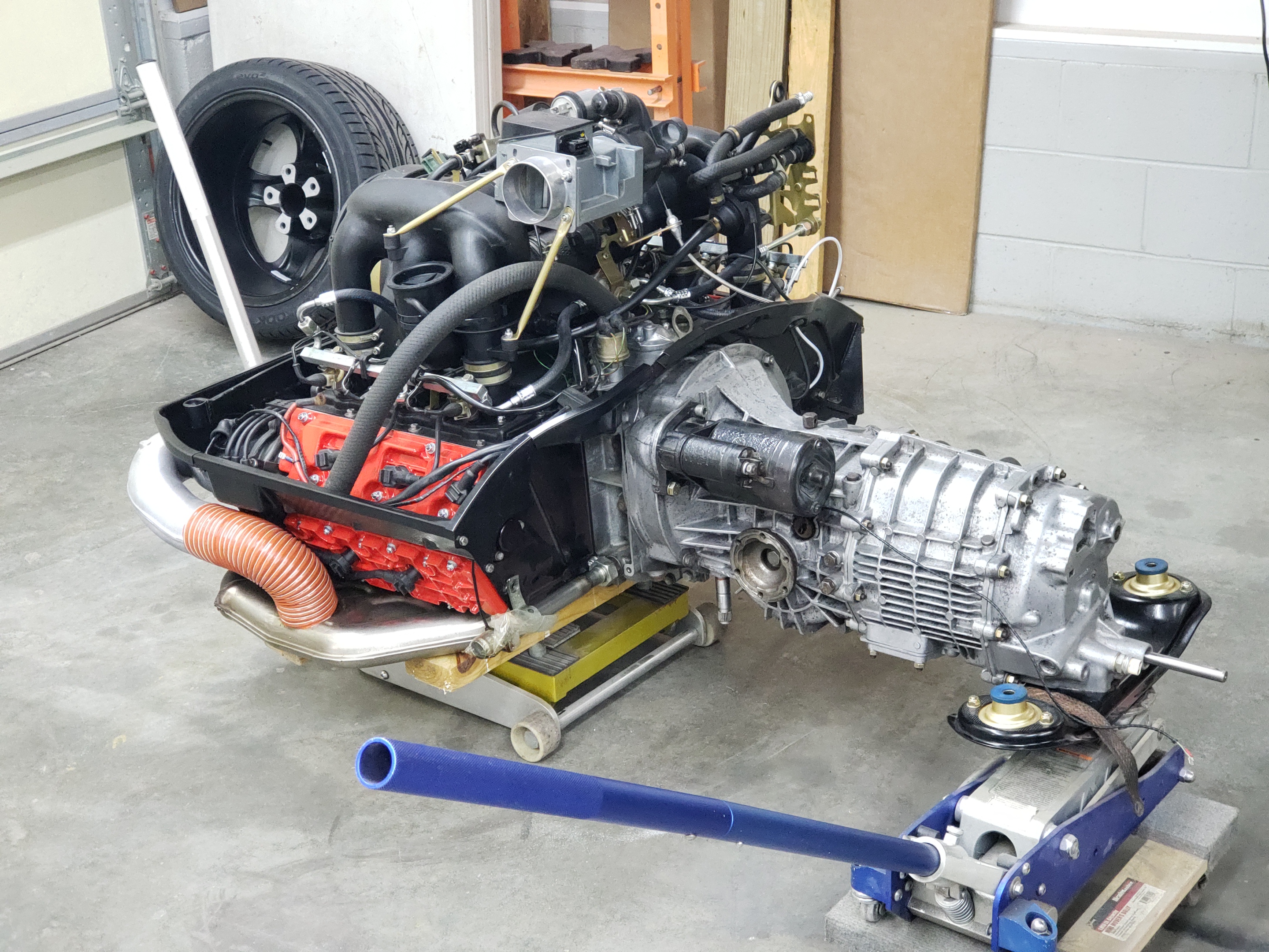

There is a difference how the engine must be supported between using jack stands or a lift where the car sits leveled. When the car is jacked up at the rear end and on jack stands, the engine is more or less level. By using a lift and the car is level, the transmission need to be jacked up so you can slide in the engine.
Since I have a lift, I'm using a motorcycle jack and a small floor jack on a furniture dolly, so it will slide in all directions, and I can rise or lower both ends as needed.
Here is a picture.

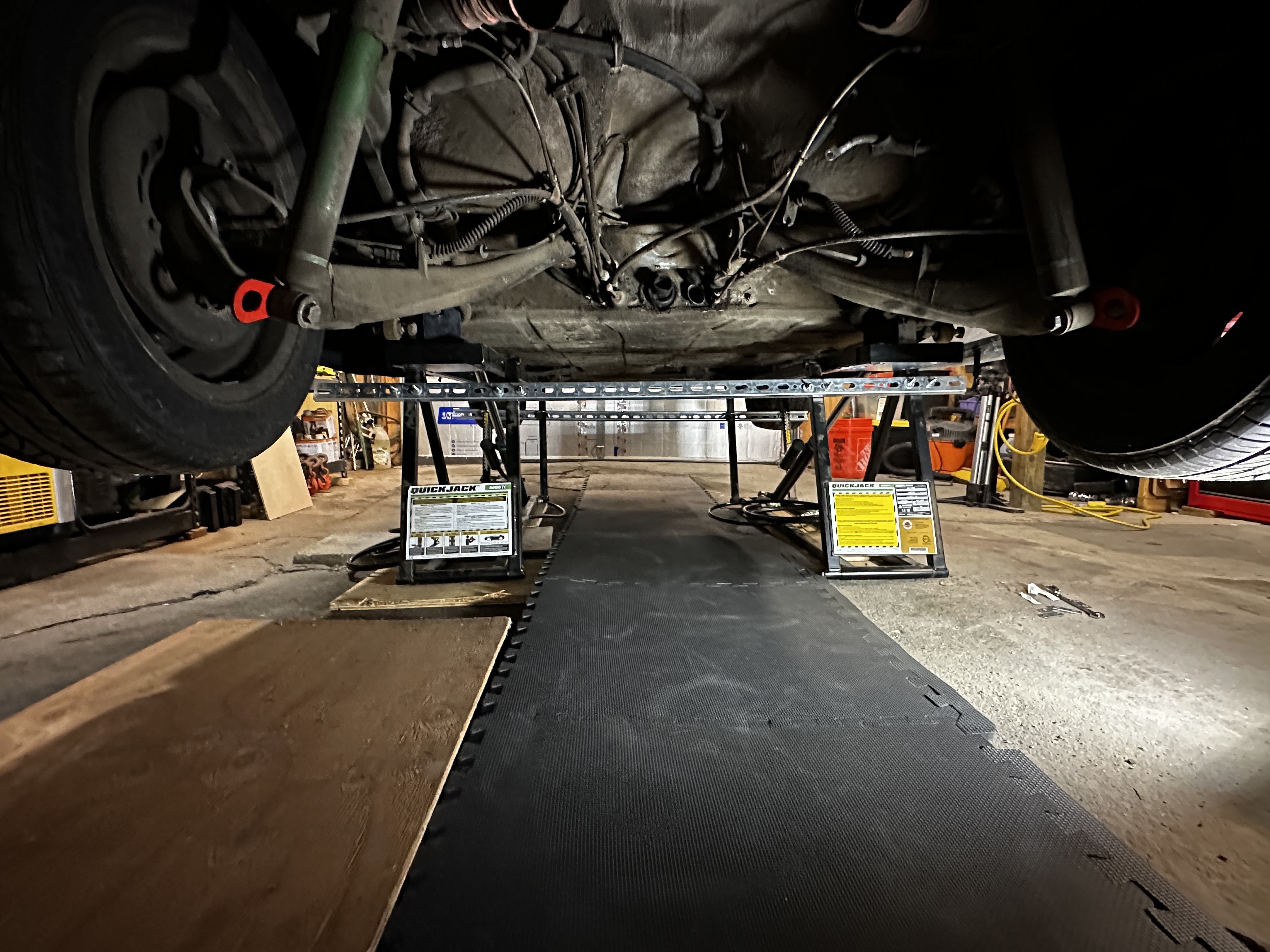

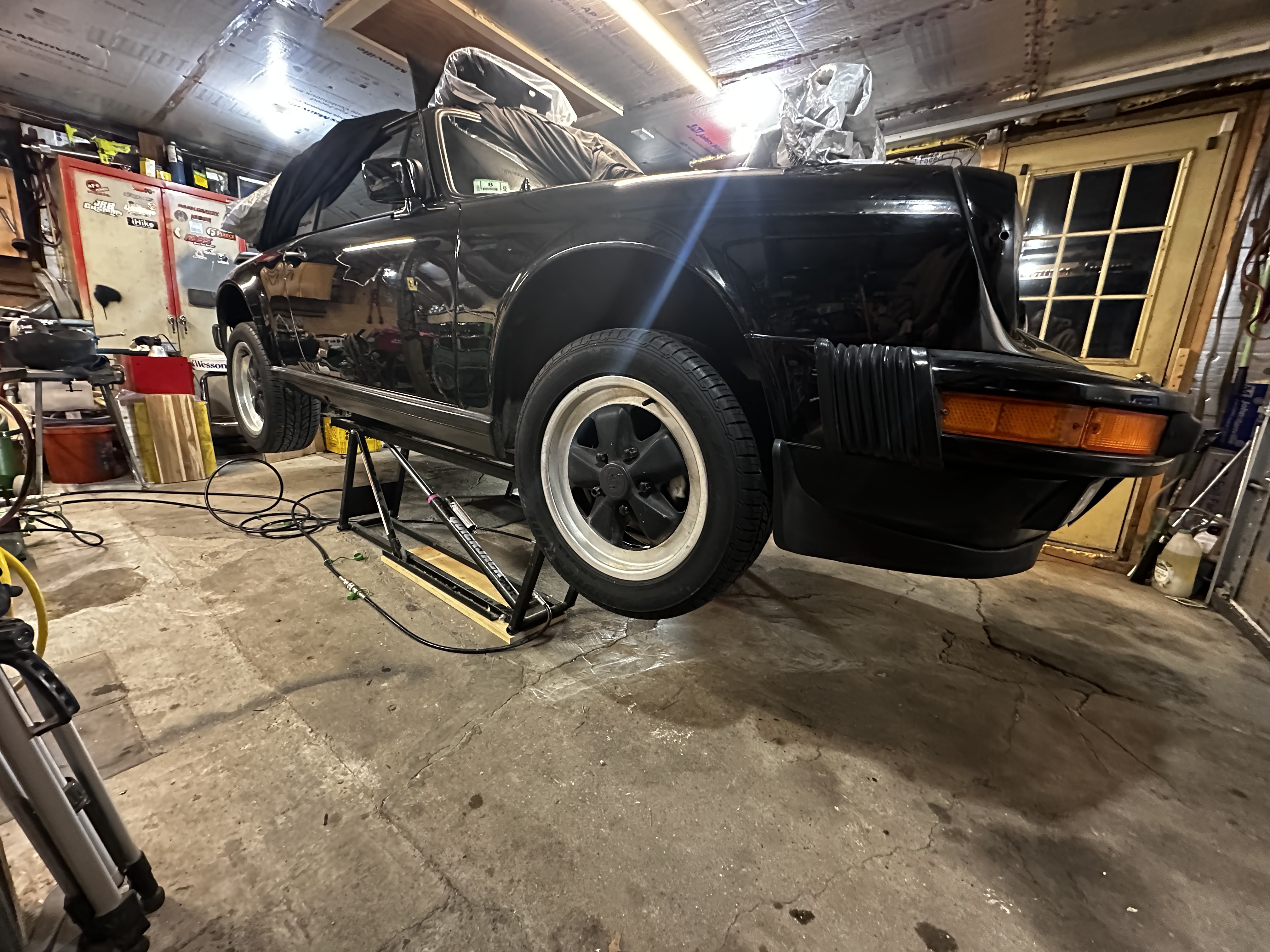

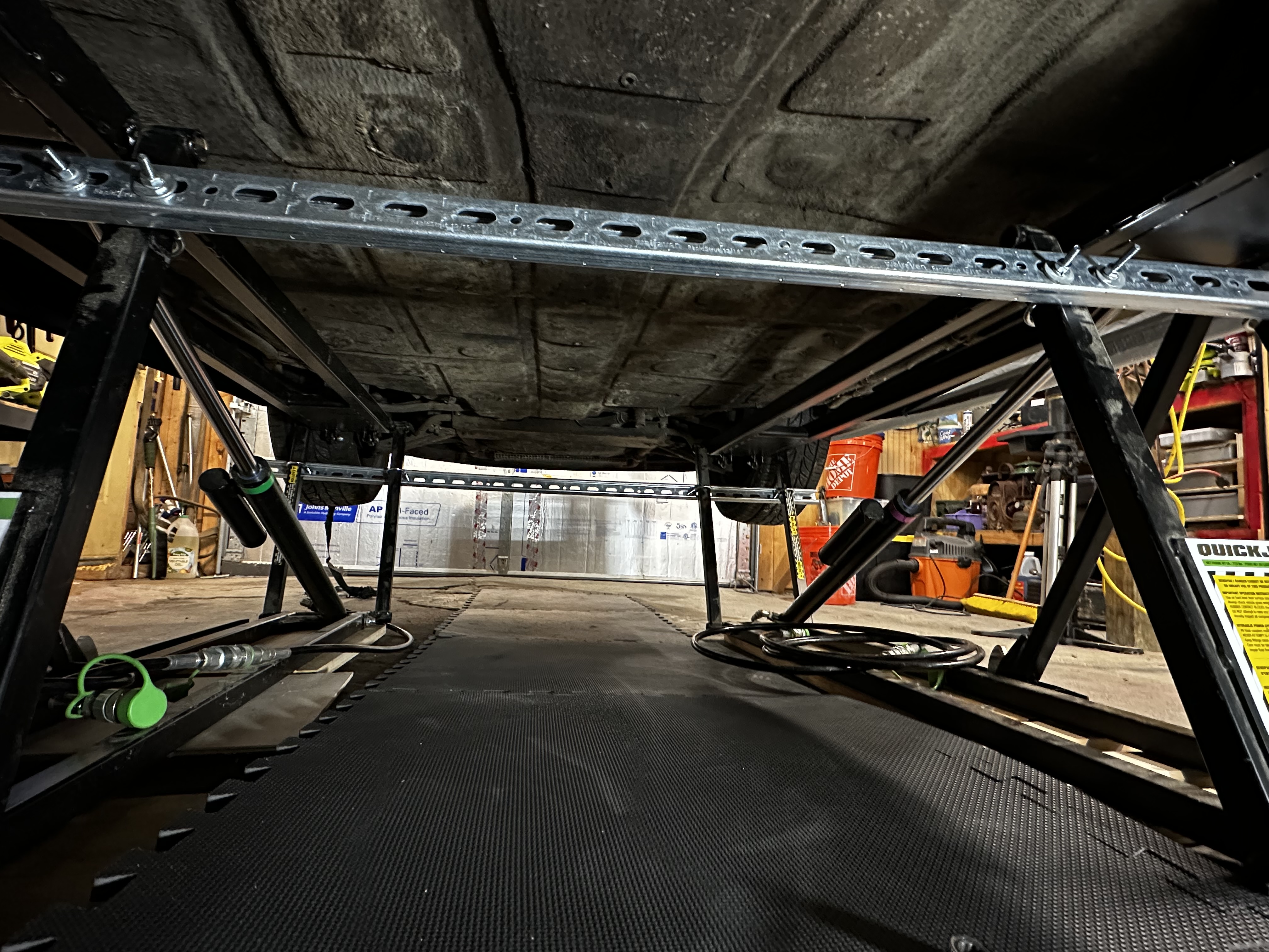

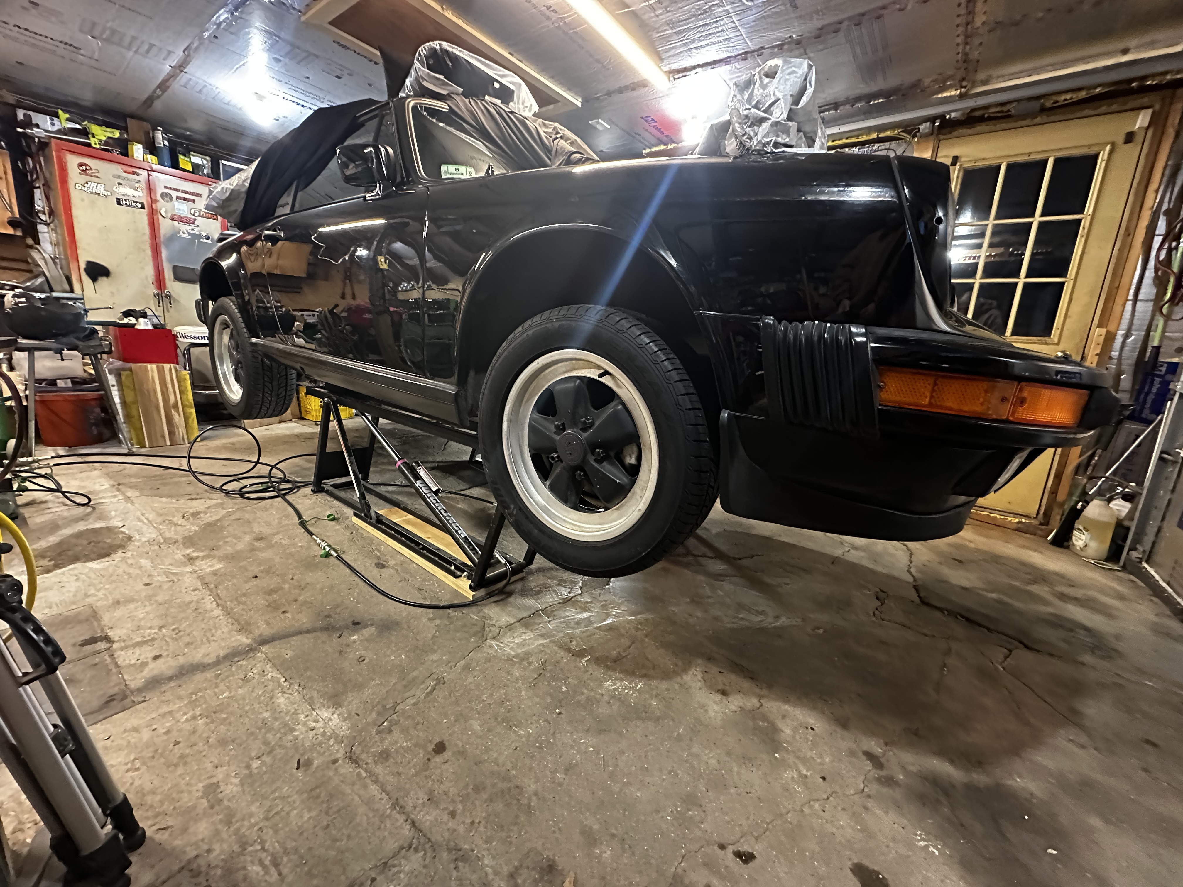

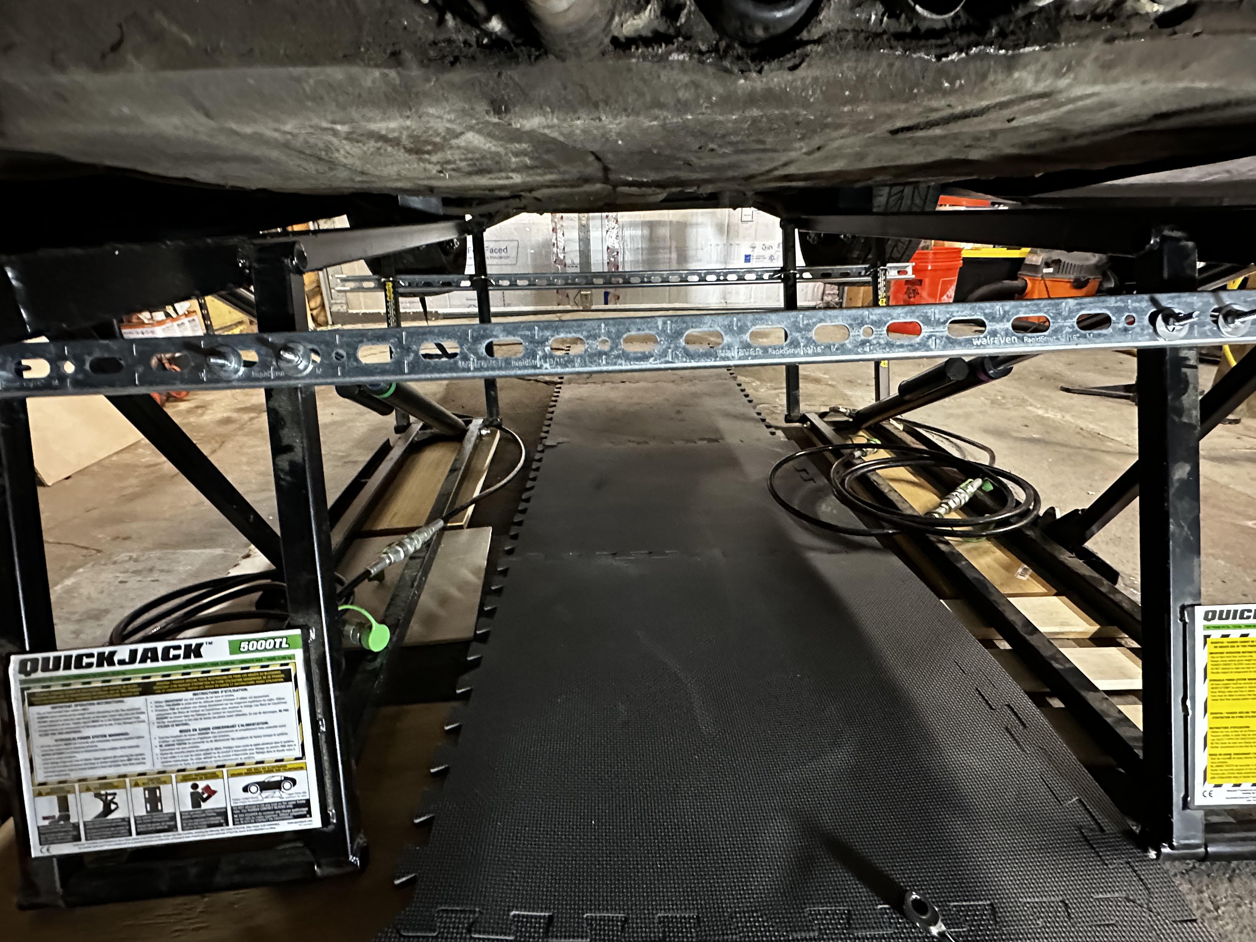

So I have enjoyed having the quick jacks now for over a year now. My 84 911 is up on them right now and I pulled my new fuel lines. Replaced the fuel pump. Have all 4 brakes to rebuild. All with the engine at the rebuild shop. I added some cross pieces made from UniStrut. Makes them more stable so I don’t have to worry about side to side movement. They are secured in place but Ubolts so not damaging the quick jacks.
