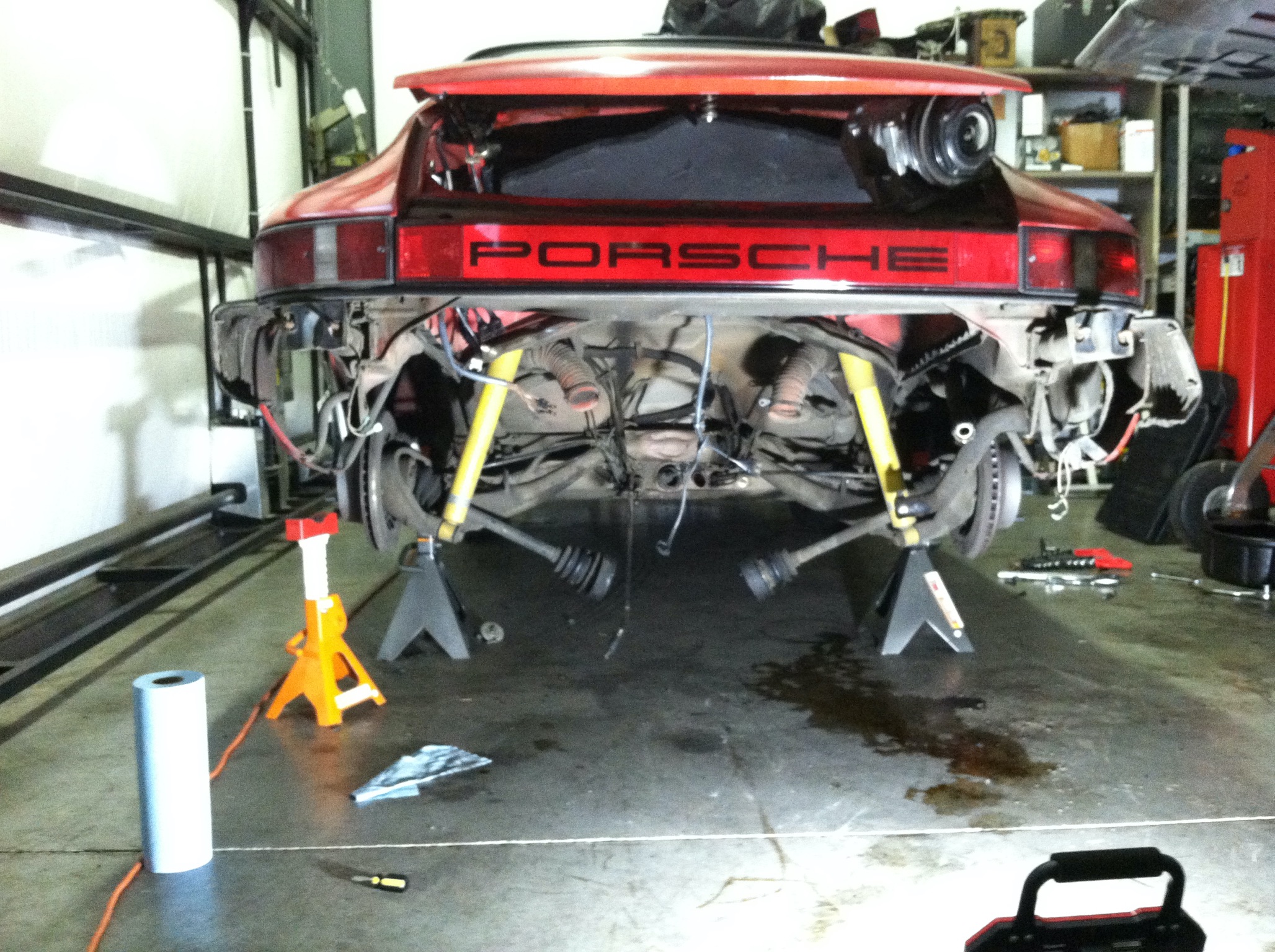

From what my 911 mx buddy, and buddy with a 914 and 911 have said, just use a floor jack and stands to drop the motor. I believe there are adapters for floor jacks out there, that help balance the motor/trans assy for ease of removal and install. At least I know there is on the 914.

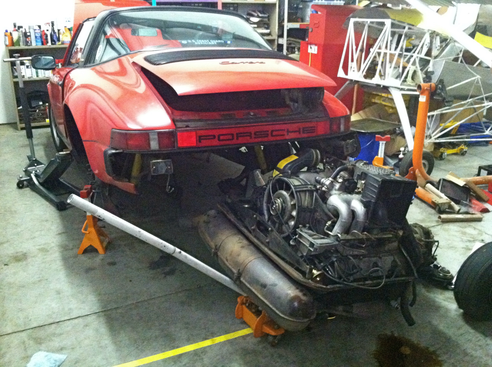

I’ve done the removal with the floor jack and jack stands. I now have a set of Quickjacks. I haven’t done an engine removal again yet but the Quickjacks lift the car higher than I got with the floor jack and jack stands so I expect it to work. In either case it is necessary to remove the rear valence and bumper. FWIW, even with the jack adapter things are a bit wobbly and scary. That’s part of the reason I got the Quickjacks.

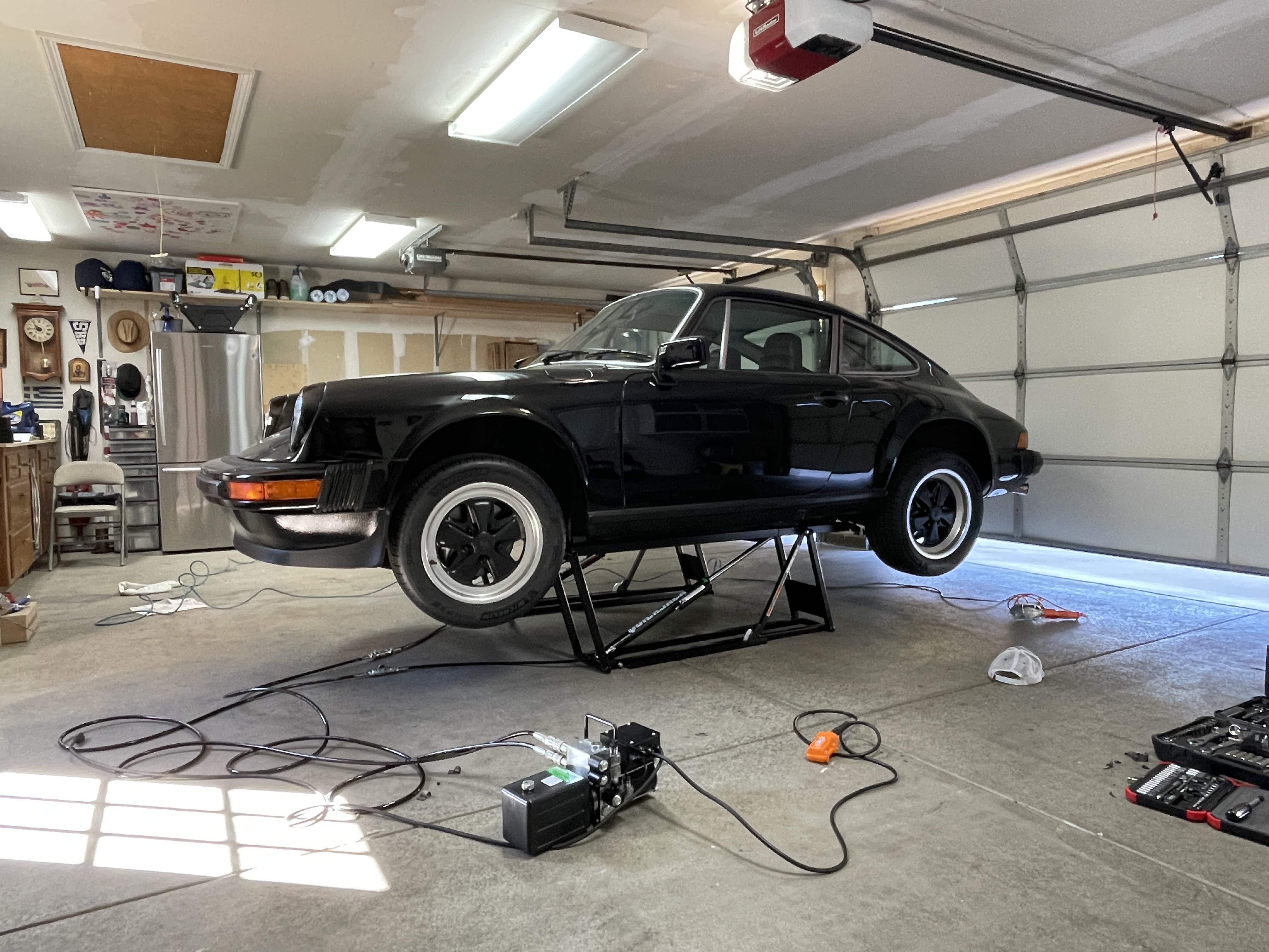

Hey Jim,
I bought the 5000TL back in Oct. 2022. I have not done an engine drop yet, but I plan on doing that soon.
I have done an oil change, and it's an absolute breeze with the car up on the QuickJack. It also makes detailing a lot easier.

That is great! I can’t wait till they get here! Thanks for the pic too. Great looking car!

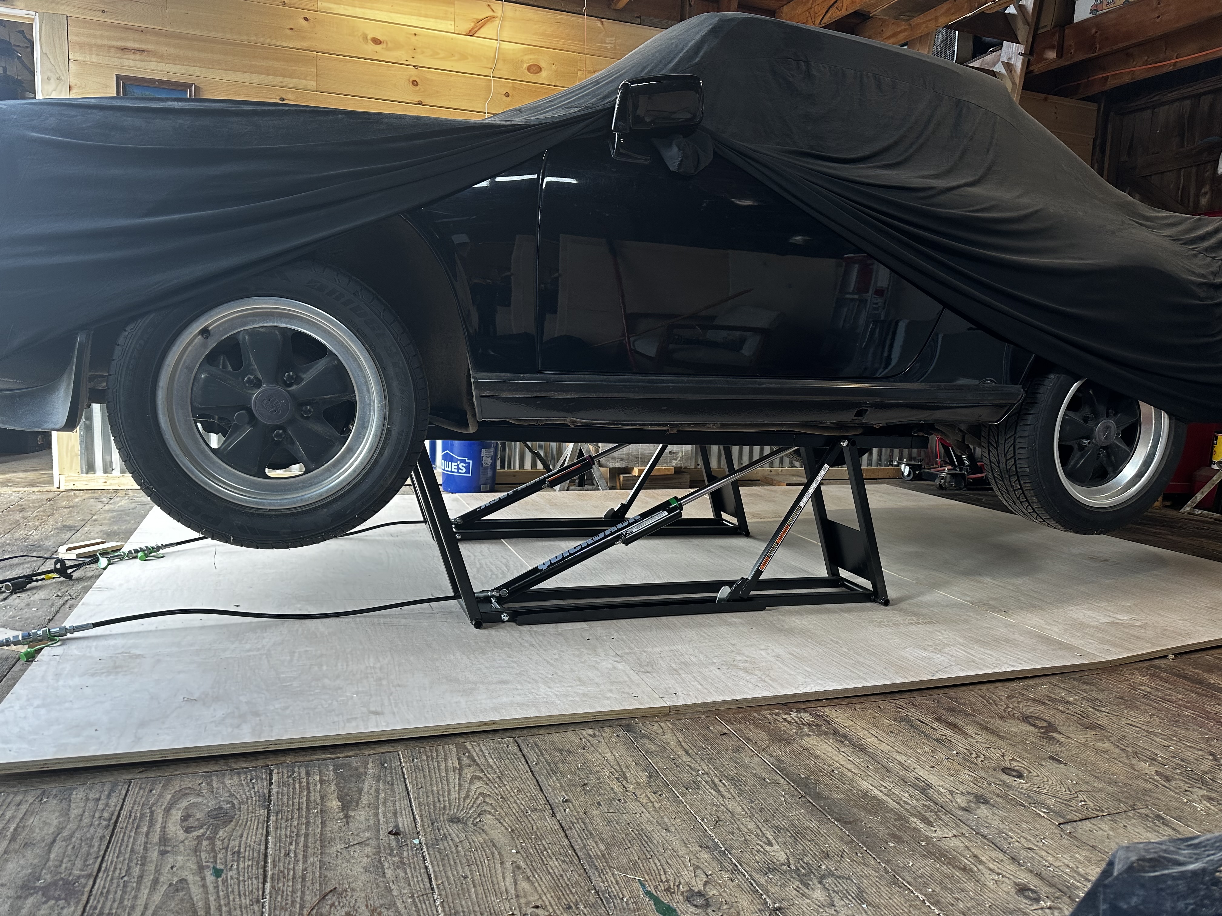

ImageHere is mine up finally I need to figure out what hose’s underneath I can remove since I removed the non working old AC
