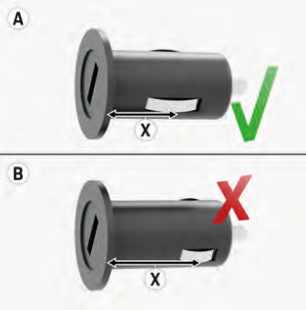

This on p262 of my 911 manual:
"− The 12-volt plug socket and the connected electrical
accessories function even if the ignition is
switched off or the vehicle key is removed."
And then this:
A - Suitable charging adapter
B - Unsuitable charging adapter
Danger of damage to the electrical system.
Only use suitable charging adapters
(A): Distance X between the ground connection and
the upper edge of the charging adapter must be
less than approx. 0.63 in. (16 mm).
Unsuitable charging adapters (B) with a distance
X greater than 0.63 in. (16 mm) between
the ground connection and the upper edge can
damage the 12-volt plug sockets"
Unlikely, but is it possible that the lighter adapter you were given was incorrect?

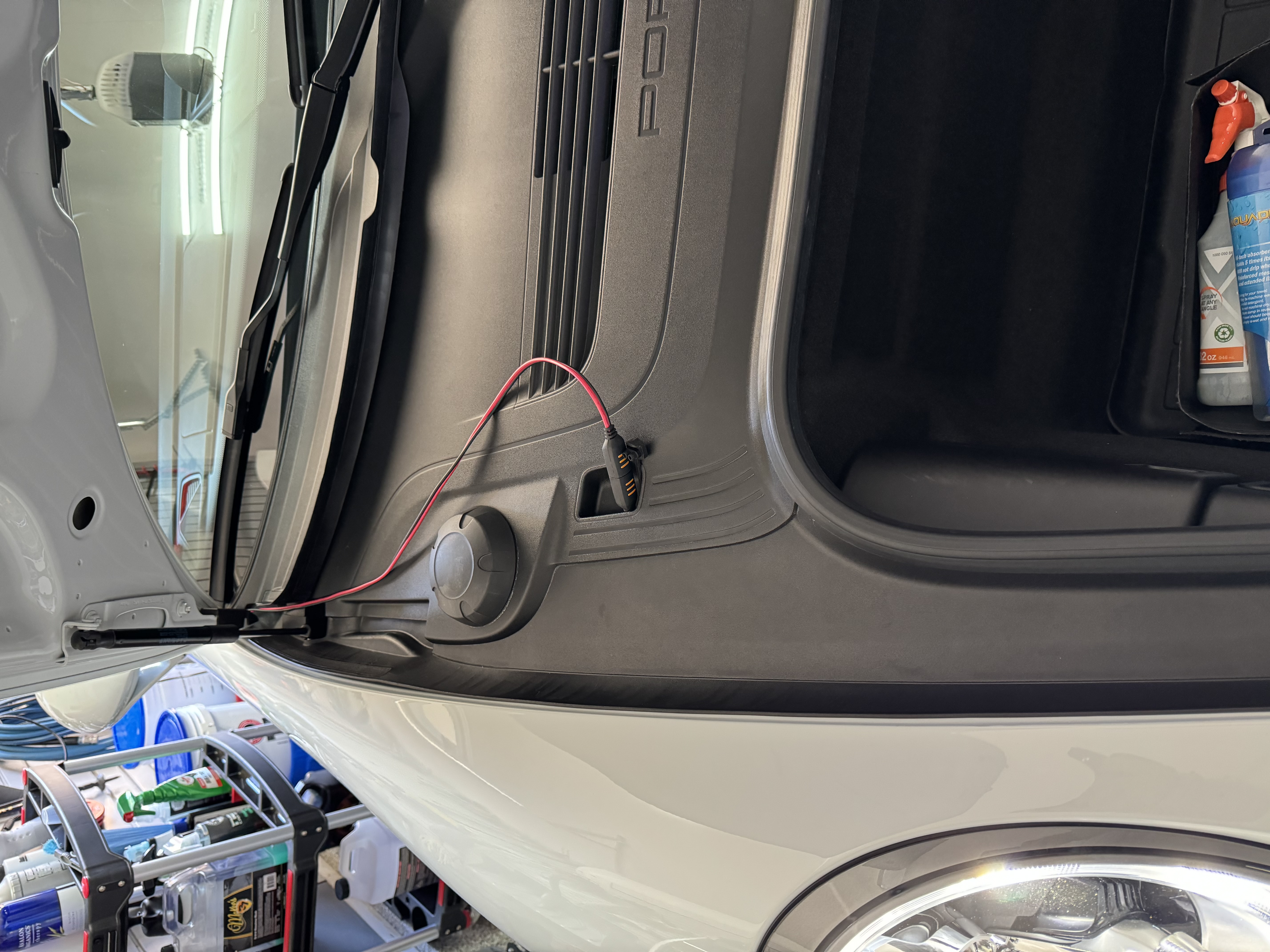

I connect mine on the frunk, positive to the pos post of the battery and the negative on the stud by the strut tower. You don't have to buy another tender if you already have a few. As long as it is no more than 3A-5A is ok to maintain. I bought a Porsche one, because I didn't have an extra one laying around. And if you have the rear steering, you do have a Li battery.

I use a CTek with this pigtail attached. I open the frunk to connect or disconnect, keeps it hidden but easily accessible.
